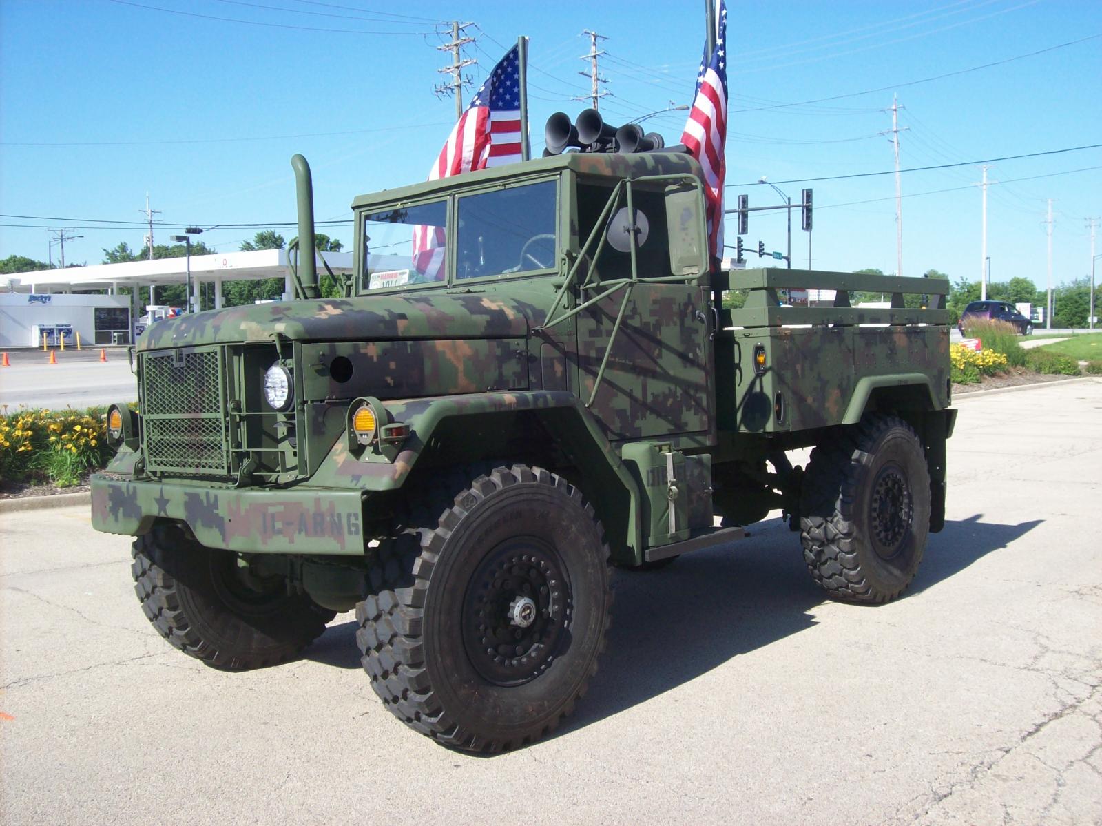

I've put my search for an old Mack on hold for now, so I figured I'd post a few photos of the trucks I currently own. I bought these at auction a few years ago for no reason other than they looked fun. Turns out they are! The trucks are great off road, easy to drive, and will travel 55 + on the highway safely.
Although they look similar to the classic M35A2 Deuce and a half, they are an entirely different vehicle.
The M939 trucks were produced from 1984-1992 in various configurations (cargo, road-tractor, wrecker, etc)
A few features:
Cummins power (NHC-250 on early trucks, 6CTA on the later A2's)
Allison 5 speed transmissions (MT 654 CR)
Full air brakes (wedge type)
ABS added on most trucks
CTIS (central tire inflation) on A2 trucks
Here are a few photos of the 2 I own. If anyone is interested, I'll add more.
Have a good day and stay safe on the road!
Semi tractor - 1991 M931 A2
Cargo truck - 1991 M923 A2

Thanks for flipping the pics. Couldn't get them to upload correctly from the I phone.
