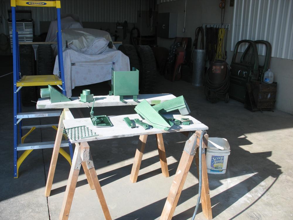

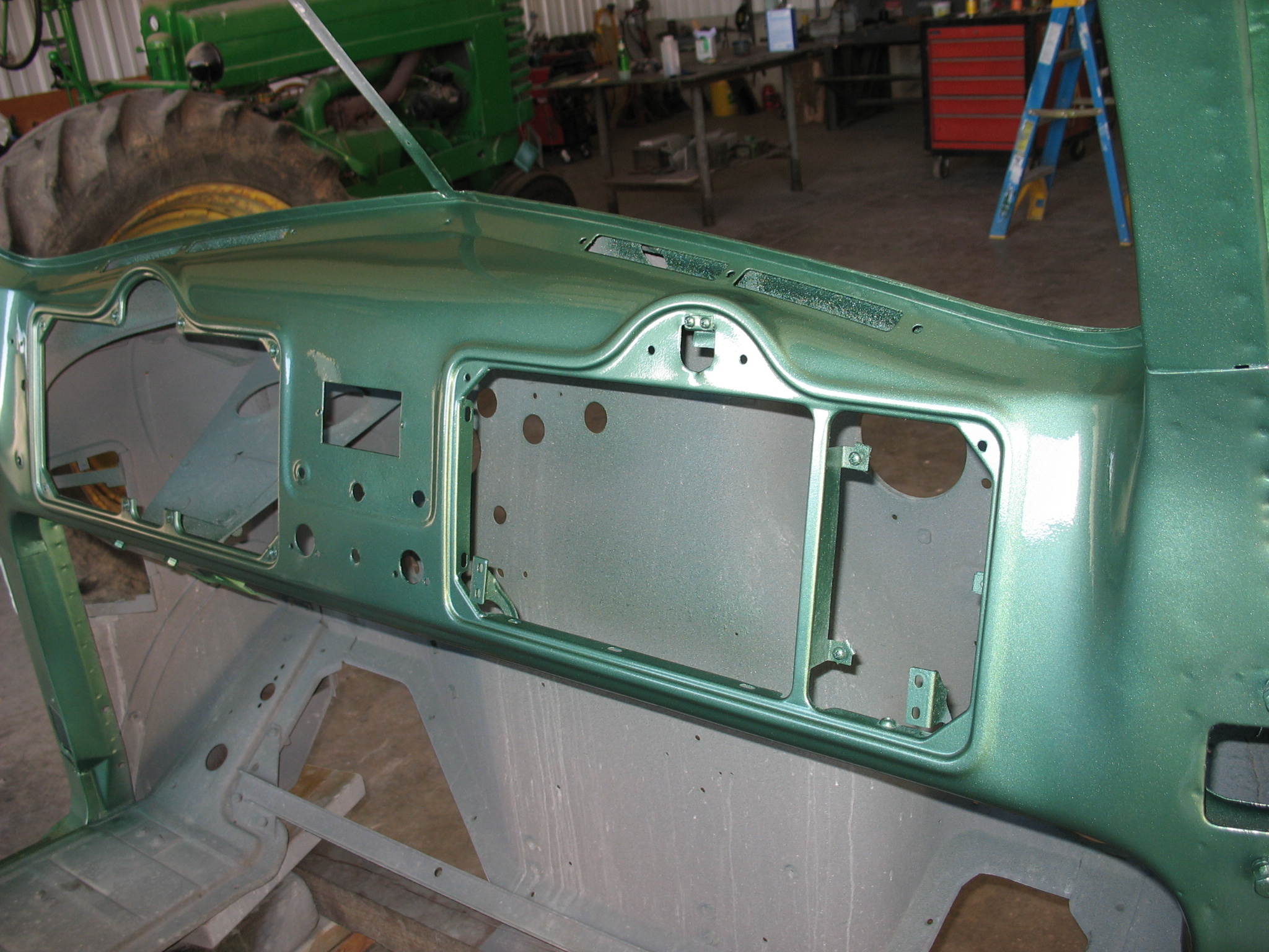

Painted the inside of cab and parts today.  Used OMNI 45735 and Ma-Hyde Wet Look Hardener. This is supposed  to the correct color but looked as if it had to much metallic in it. I wonder if the original paint was a metallic at all.
I think it's real close. You are seeing it in the sun with out the shadows and interior parts to break up the "look" . Only thing I do see is the high gloss, that pops out the light metallic more then  the OEM semi gloss.   I like the high gloss.    Paul
keep in mind the original paint was probably in 55 gallon drums and maybe not mixed continually. I have some very original B's with no metallic and some with metallic. the earlier ones were more metallic. some end of production ones had no metallic in them.  one thing different is the modern paint. remember the original was shot in straight enamel and had little shine

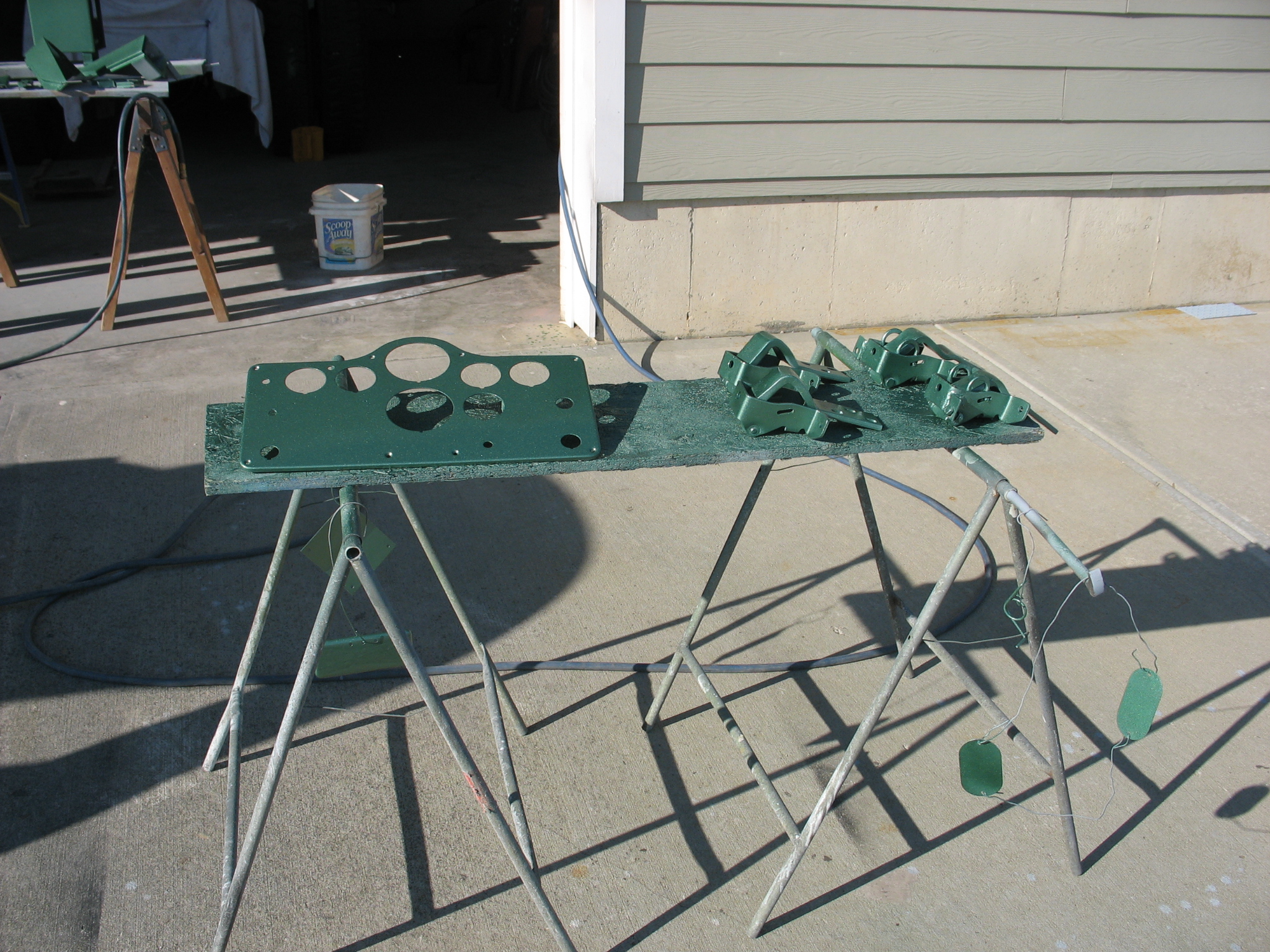

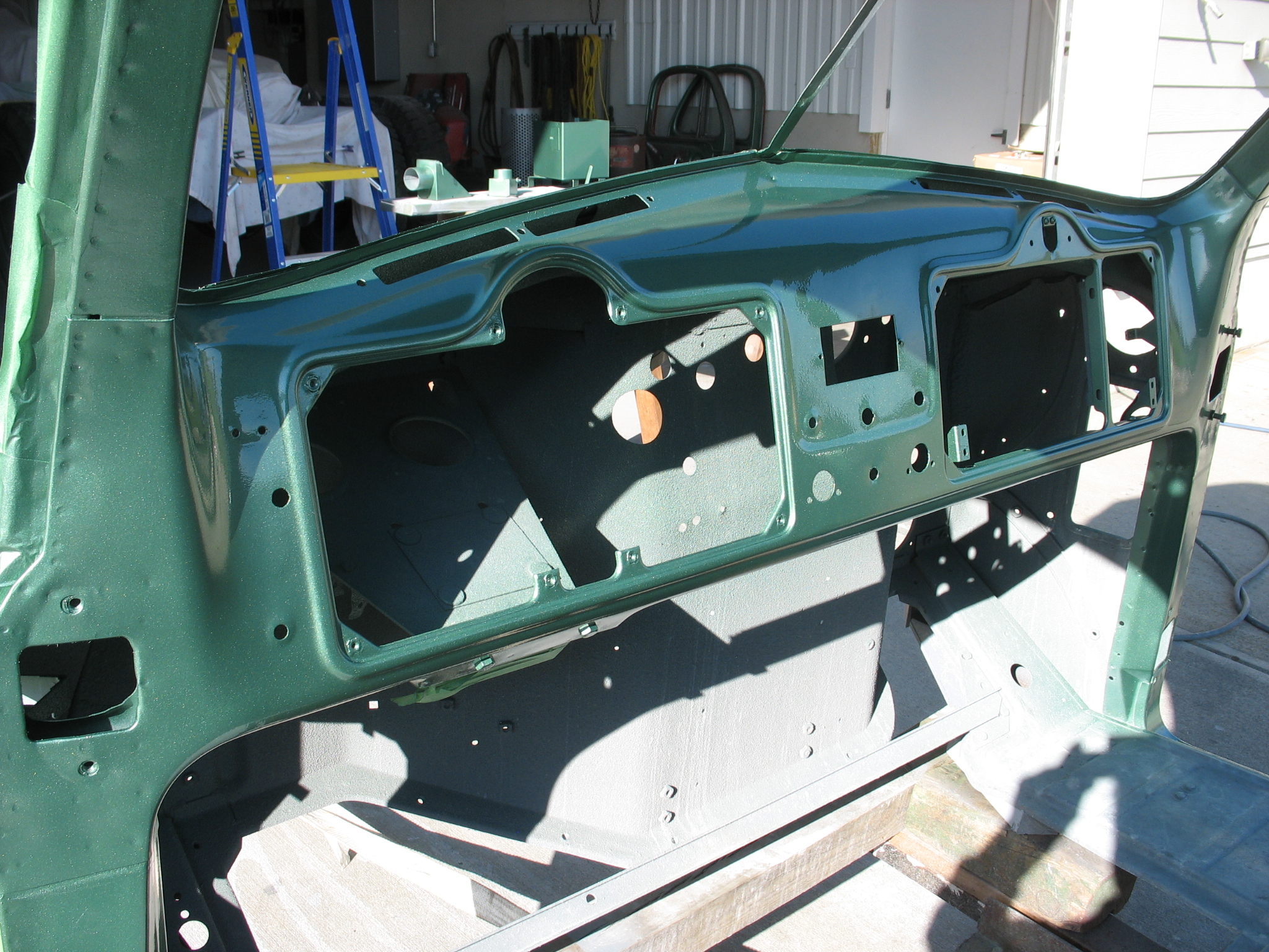

BTW, here's a couple of pics of the two interiors I painted. The first two pics are the B81 and second two are the B61:
Looks clean. Nice job!
