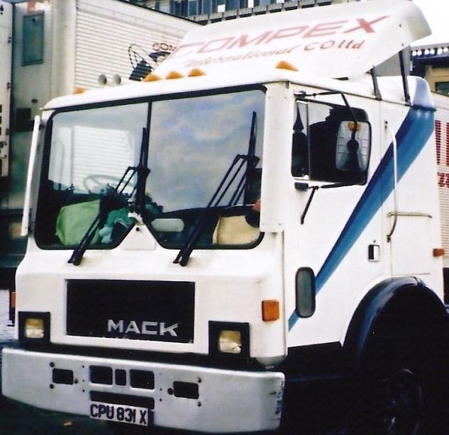

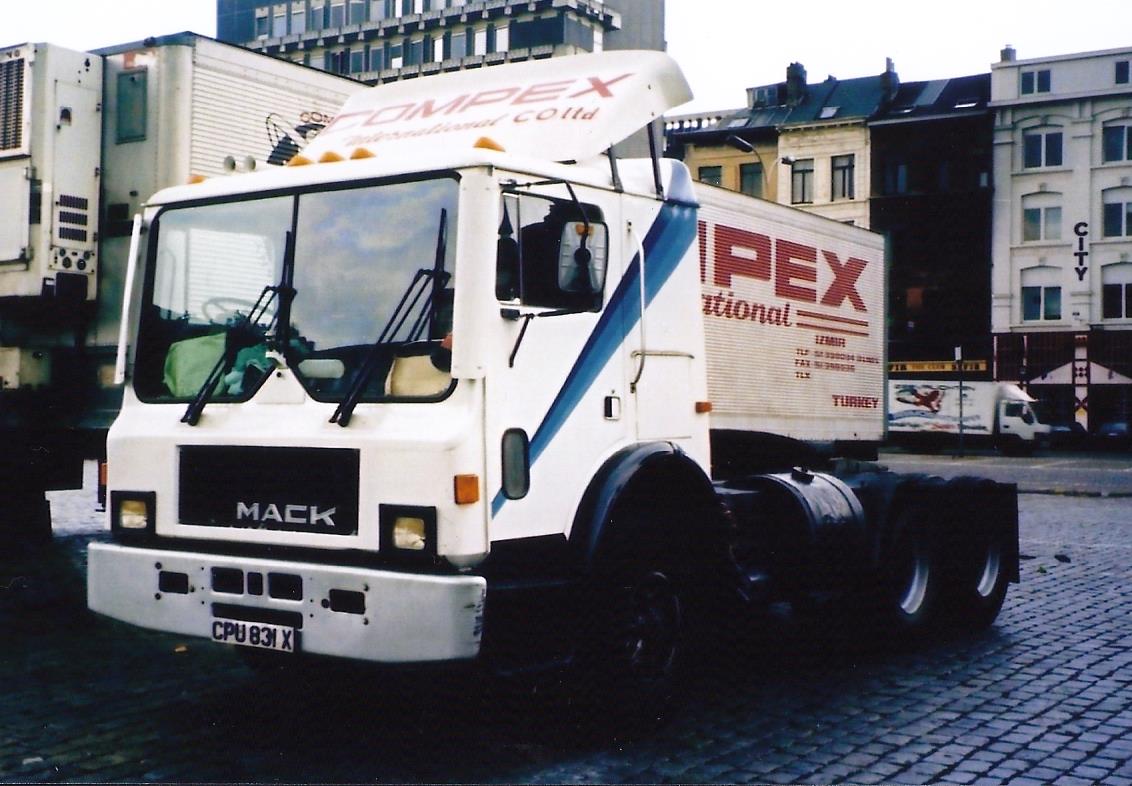

Wish I had some pics,but a good friend of mine had a MC685  tractor he ran for quite awhile,hauled livestock,grain,flatbed and tanker with it. The local Mack dealer ordered it as a single axle tractor and it sat on the lot quite awhile,Larry was needing a new truck and had a couple old F models in the weeds,took the tandems out of one of those and made a twin screw MC.
I've only driven one "compact" tractor it was one of those godawful international cabovers with a 5speed column shift.!! Was for Wilson freight off the local 249 extra board. Was wondering why you want one! If you need a short Cabover sleeper the dealers are giving them away! The freight companies have a buyback arrangement with the dealers, usually at 3 yrs so their trucks are always under warranty.The 0/0's want big power "large cars" so the short Cabovers go cheap.
Hook  n ladder 1, I agree with teamster Grrrl wouldn't be an economical road horse.Plus you know how they ride!! If you must have a  Mack,there are a lot of MH Cabover around which are well built and comfortable.However, as Dirty Milkman says there are a lot of "cutoffs" around with any combo you want around, saw a couple on Tampa Craig's list today.
