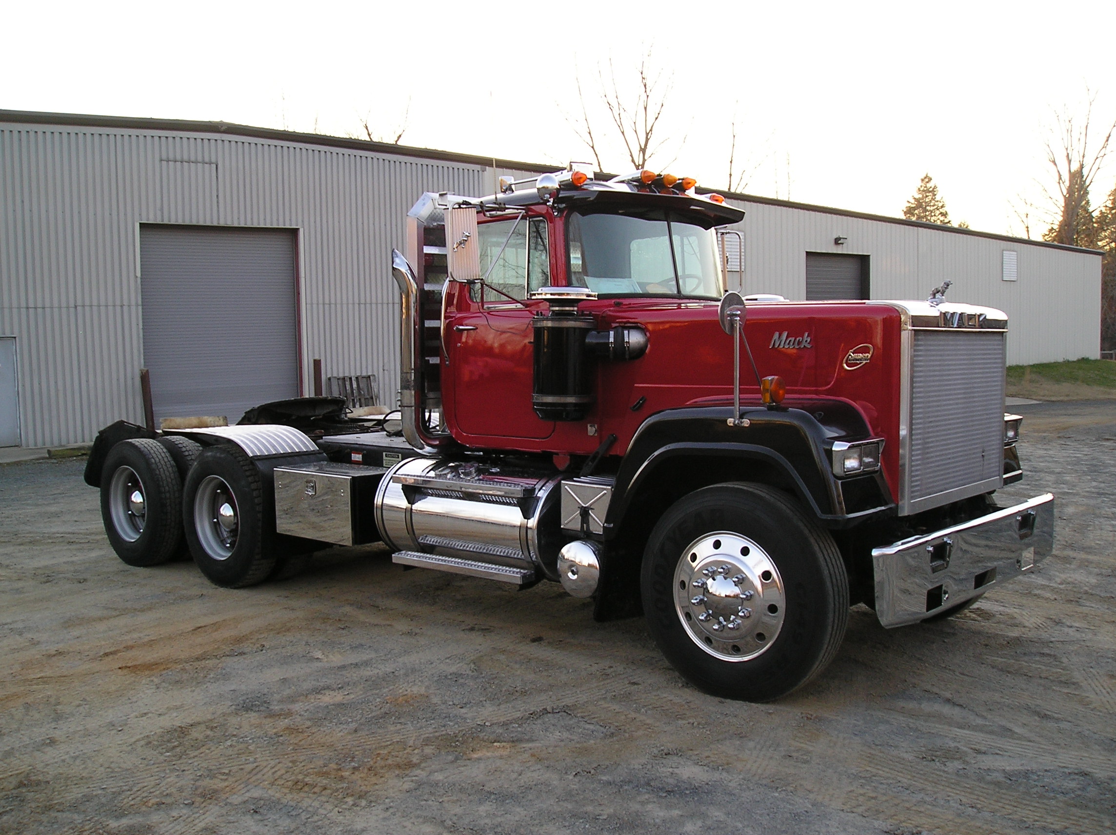

  20. I am trying to post a pic dunno if it will work , 1 is The 89 E9, 1 is the 73 865, the other is the 77 Brockway.. If they don't show up. Somebody tell me how to post pics, Thanks Rob..BTW the New stacks are on order and I gotta get rid of those fenders and get somethin better.
