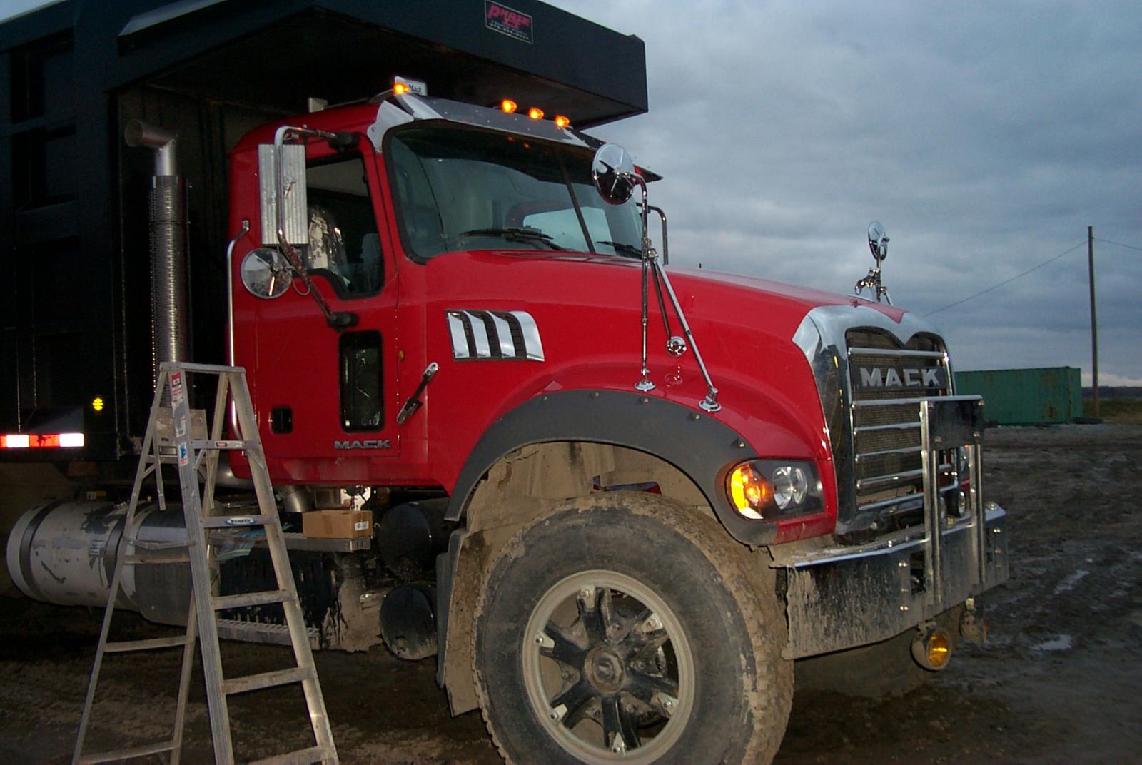

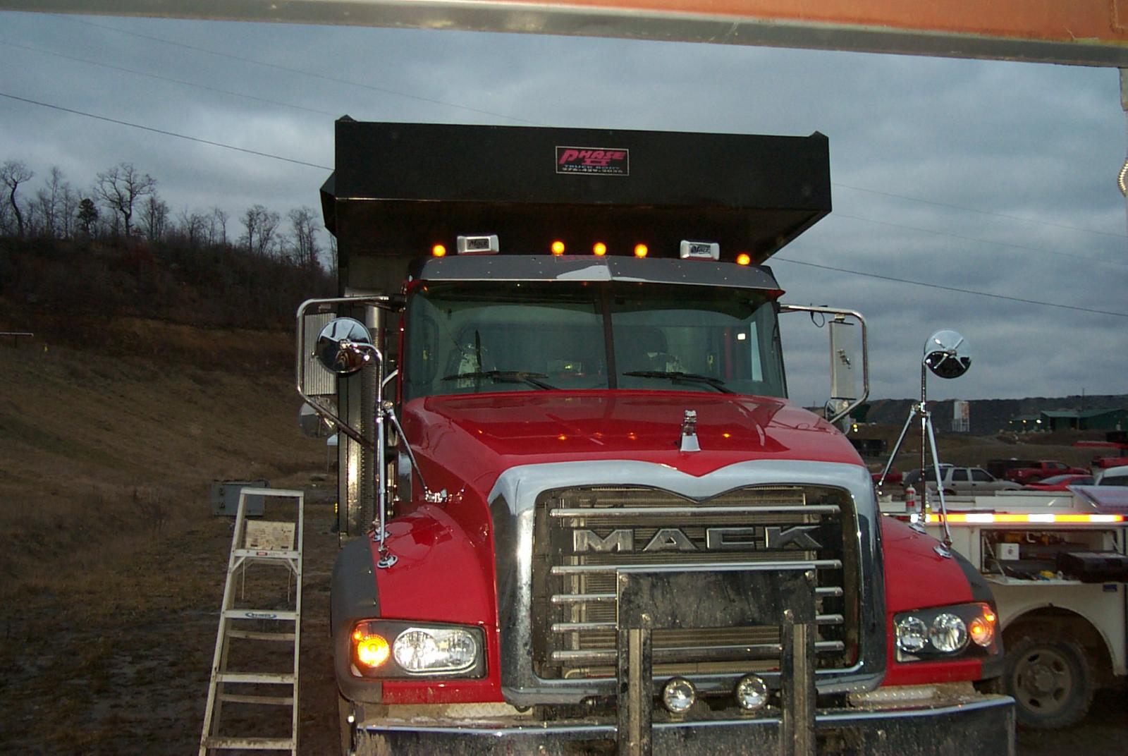

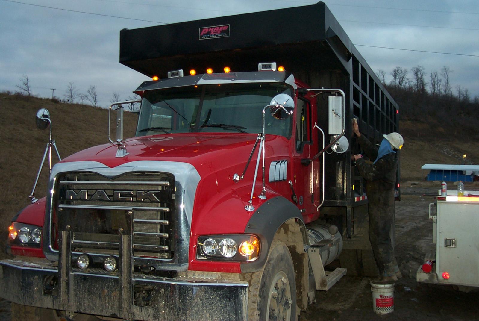

  11. this is the newest of my stable of dogs!! MP8 505m Maxidyne, 18 speed roadranger, 60 boggie camelbacks mack w/ 8.27 gears.
