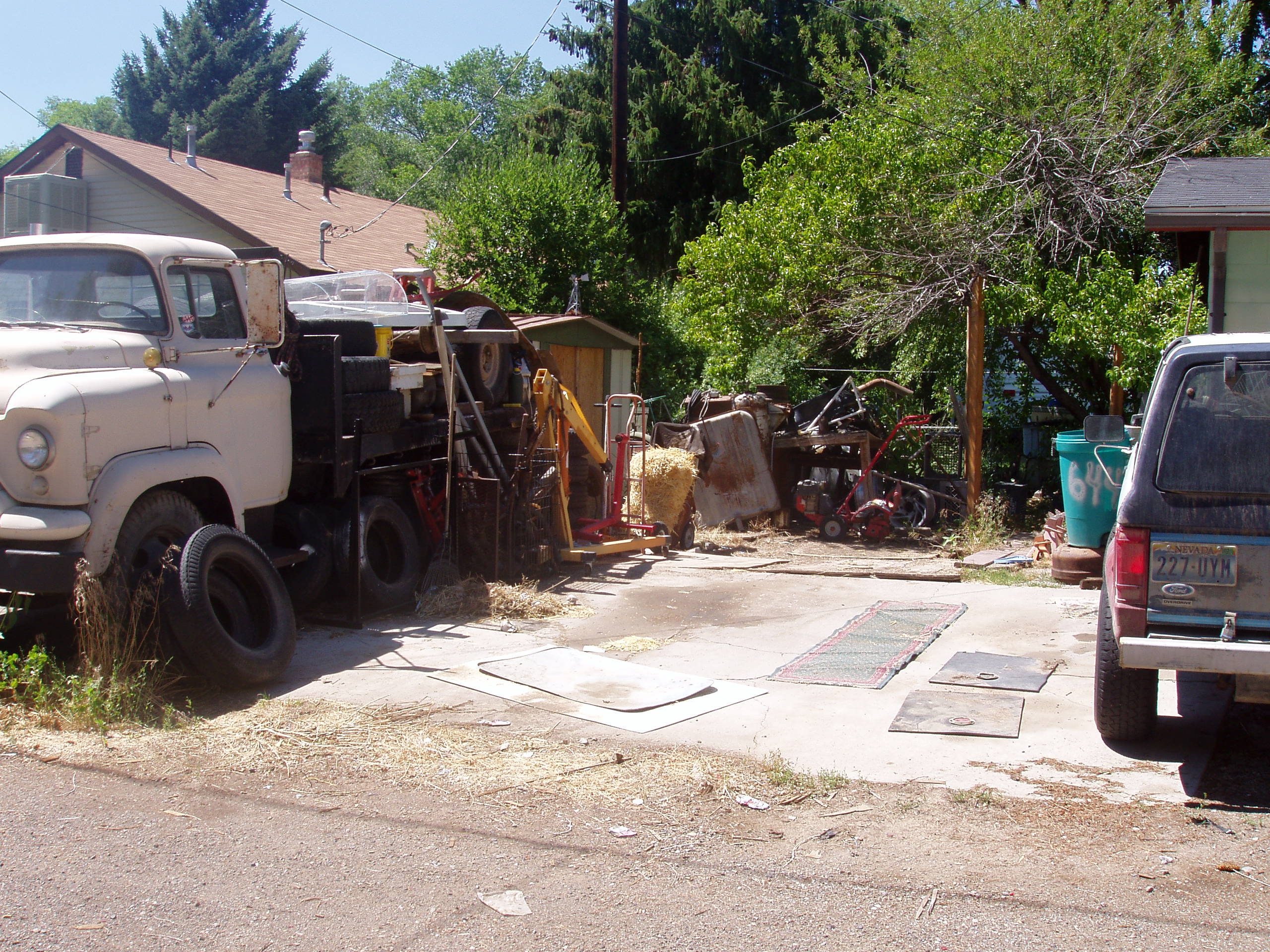

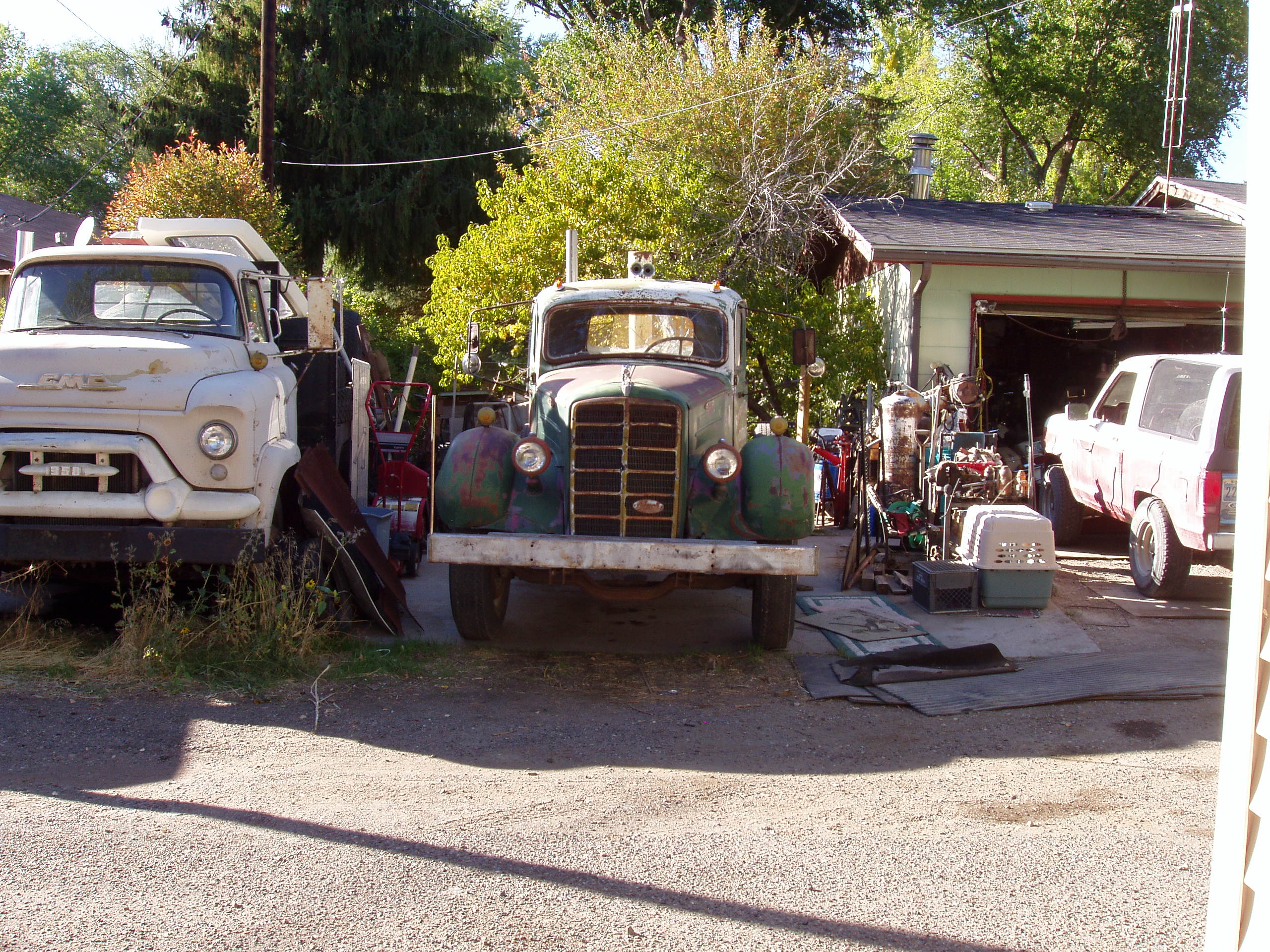

  21. Hi all; Okay-the '54 is home. I got a couple of pics once it was here,just don't have 'em downloaded yet. One of these is where I'd created enough space to park it,the other is on the road coming into town with it. Some things I discovered about it: STILL no brakes. On my list to work on that problem. Carb appears to be freshly rebuilt. very clean inside. Not much torque evident;Probably more fuel pressure,a tune up and some back pressure on the exhaust will help a lot. It has a Clark 5 speed;is there a difference in the shift pattern between the DD and the OD? I think I was told that 4th and 5th are reversed in the shift patterns,but that was 20 years ago,so The Brownie is a 5531,which was originally in an IH truck. The wipers don't work. It's tempting to put one of those hot rod wipers kits on my want list,but I'll probably just re-plumb it and rebuild the vacuum wiper motor,and add a big-ass vacuum tank. Stiff clutch-needs to be adjusted. Or replaced. Runs good-stays at around 165 degrees,holds 60# oil pressure cold,45# warmed up. Need to run a compression test. Generator isn't charging. Don't know if the generator needs to be re-polarized or the regulator points need to be cleaned. Fuel pump isn't pumping. Manual pump is missing,electric pump is going but no volume or pressure. I plan to use the manual pump off my '57 GMC dump truck since I'll be switching it to a 292 Chevy anyway. Heater blower works,both speeds. Horn works-sounds like a WWII Jeep horn. Gas gauge will likely work if I replace the toggle switch that switches from main tank sender to saddle tank sender. Parking brake works well,but is very sudden and really hard to reach and use while moving. Feels and sounds like all the boxes are dry. Another thing to check out while under the truck. Speedometer cable is missing,will have to be custom made,due to different trans. and aux. trans. Feels like the steering is fairly tight,steers good on the road. A little grease will make it a lot better. It's very LOUD! Only has about 3 feet of 3" headpipe,no muffler. I have a glasspack header muffler for it though. And I'll have to give it a stack. No knocks in the engine,no excessively noisy valves. Engine has a miss,but after sitting for over 10 years,it's probably a plug or wire,or both. A full tune up is in order. No coolant leaks,noticed the heater's bypassed. Rides and steers just like my EH,but with a softer seat. Come to think of it-it STOPS like my EH,too! Could really use an electric 2 speed shifter ;the dash mounted switch is going to be awkward to split gears with. No title. Not a problem,really,just a $240.00 expense I could do without. All in all,not a bad deal-I'm happy. Speed

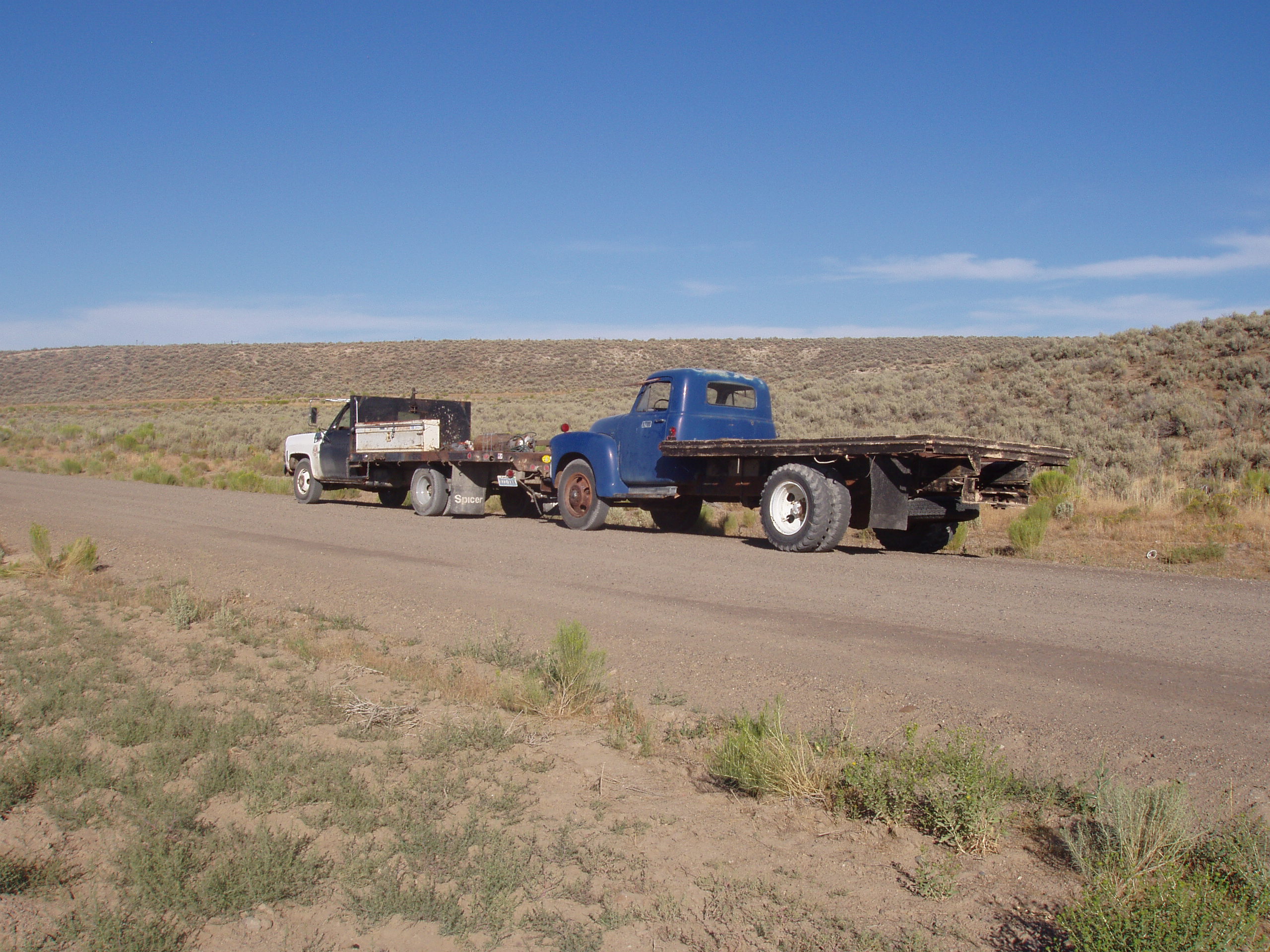

  25. 07-27-10 Hi all; Well,I went back out to the GMC today with plans to pour some Marvel into the cylinders,try to get the brakes working,and do some serious cleaning on the truck. The plan was to let the Mystery oil have a few days to soak before I tried to crank it over,then do a one-day thrash to get it running and bring it home. I decided to move the truck to a better place to work on it,about a quarter mile down the road. I hooked my tow strap around the hitch on the BroncWorth and hooked the other end to the tow hooks on the GMC's front bumper,locked the hubs in and put it in 4-Low and it pulled the GMC out to the road,I stopped as soon as I had it pointed straight,put the GMC transmission in 3rd and the Brown-Lipe in high,tied the steering,and pulled it to where I could work on it without all the sage brush and goat heads to contend with. Since the engine turned over,I won't have to wait for the cylinders to un-stick. Next thing I wanted to do was get rid of the mouse crap off the floor,out of the glove box,and out from under the seat. The first two areas weren't as bad as I thought,but under the seat-it was PACKED with mouse crap and padding out of the seat! I got most of it out,once I have it home I'll wash it out with the garden hose and a scrub brush. In the process found a lug wrench that fits the lugs,two tail lights,two spare fan belts,half dozen reflectors,couple of screwdrivers,a ventilation fan,a spare starter and the most recent plates off the truck,expired in '92. The brakes didn't get much done to 'em because I couldn't get the master cylinder cap loose,but I do have a plan for next trip. It's a 3/4 inch square head,so I'll use my 3/4 to 1/2 adapter off my big ratchet,tap it into a 1/2 square socket,and break the cap loose with a hammer and impact driver. I'm about 80% sure if I can fill the M/C up and pump the brakes a while,it'll have brakes. There's still a little work to do on it to make it run, (The battery cable ends are junk,the fuel filter is missing,and it needs a couple of quarts of oil and some coolant)but I'm hoping to be able to drive it home next trip. I might even try to get a little video of it actually moving,if it runs. I decided,assuming everything is serviceable,to leave it pretty much as is,except for maybe some better tires,re-decking the bed and,of course,a stack,with a short glass pack just before it. Then,all that's left will be getting a title for it. I'll try to get more pics as I get more done. Speed
