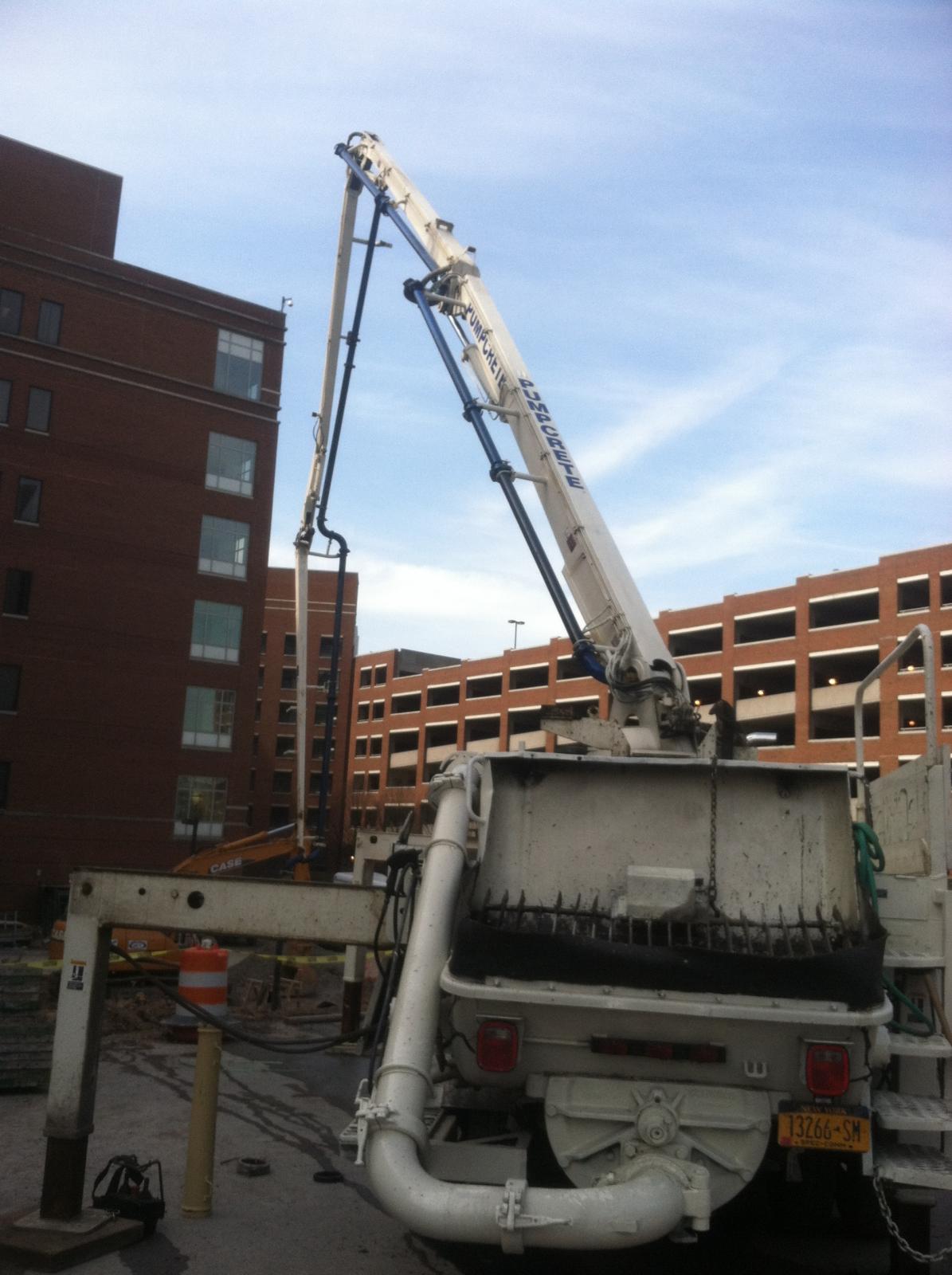

  7. Well that is good news indeed then! I just recently started running this truck, so i wasnt sure what the normal pressures were. On my other Mack, the oil pressure is higher, thats just why i was worried. Heres a few pictures of her
  8. I run a 1994 Mack Truck with a Schwing Concrete Pump mounted on it. I am wondering what the normal oil pressure is supposed to be, HOT while idling. currently its hovering right around 30PSI which seems too low to me. When cold its at or above 60Psi, but as it warms up it gradually gets lower. If i am throttling the truck, the oil pressure is OK. The engine has 21750 hours on it and it has 550,000 miles on the chassis. The Engine Brake works great all the time if that helps? Any input would be greatly appreciated.
