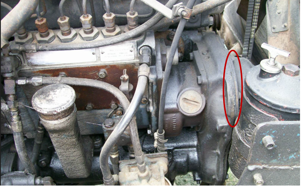

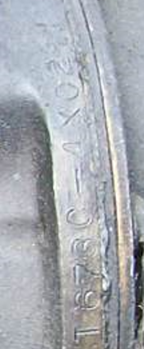

  2. Is there a number stamped on the accessory drive case on the engine?

  5. Yep. Need the number. Could be 673. Could be 711. Was there a 707 too? Brain just stroked off there for a minute...
