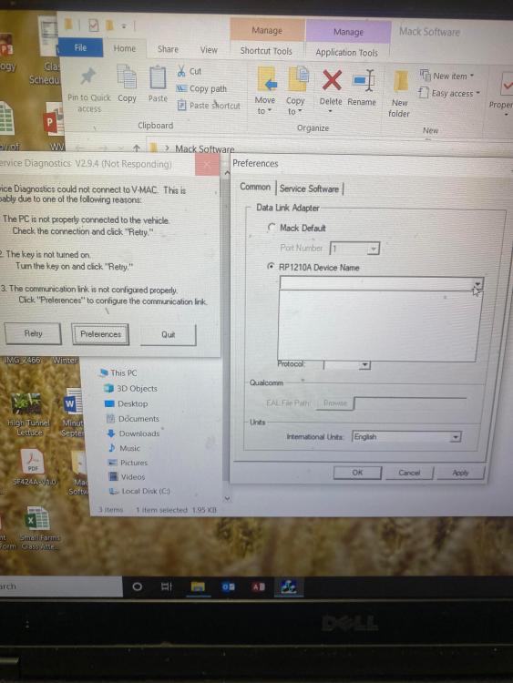

  5. Replaced both crank and speed sensor. The engine is still derated. Was looking on the passenger side and found the harness coming out of the firewall is melted. I'm trying to repair it and see if that fixes it. I still can't get the Nexiq to work with VMAC software. Not happy with only being able to read codes with it.

  7. I'll try and uninstall Nexiq drivers and see if that makes a difference. I tried uninstalling VMAC but that didn't work.

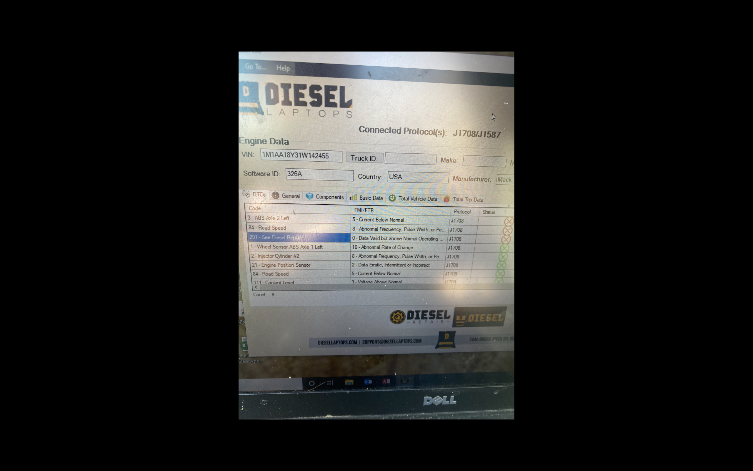

  8. 2001 CH613 E7 with 10sp Eaton I'm getting 4-1 code.
  9. Here are the codes diesel explorer gathered. Not sure what code 291 is for. The truck is only making 7psi of boost and feels derated. IMG_2775.HEIC

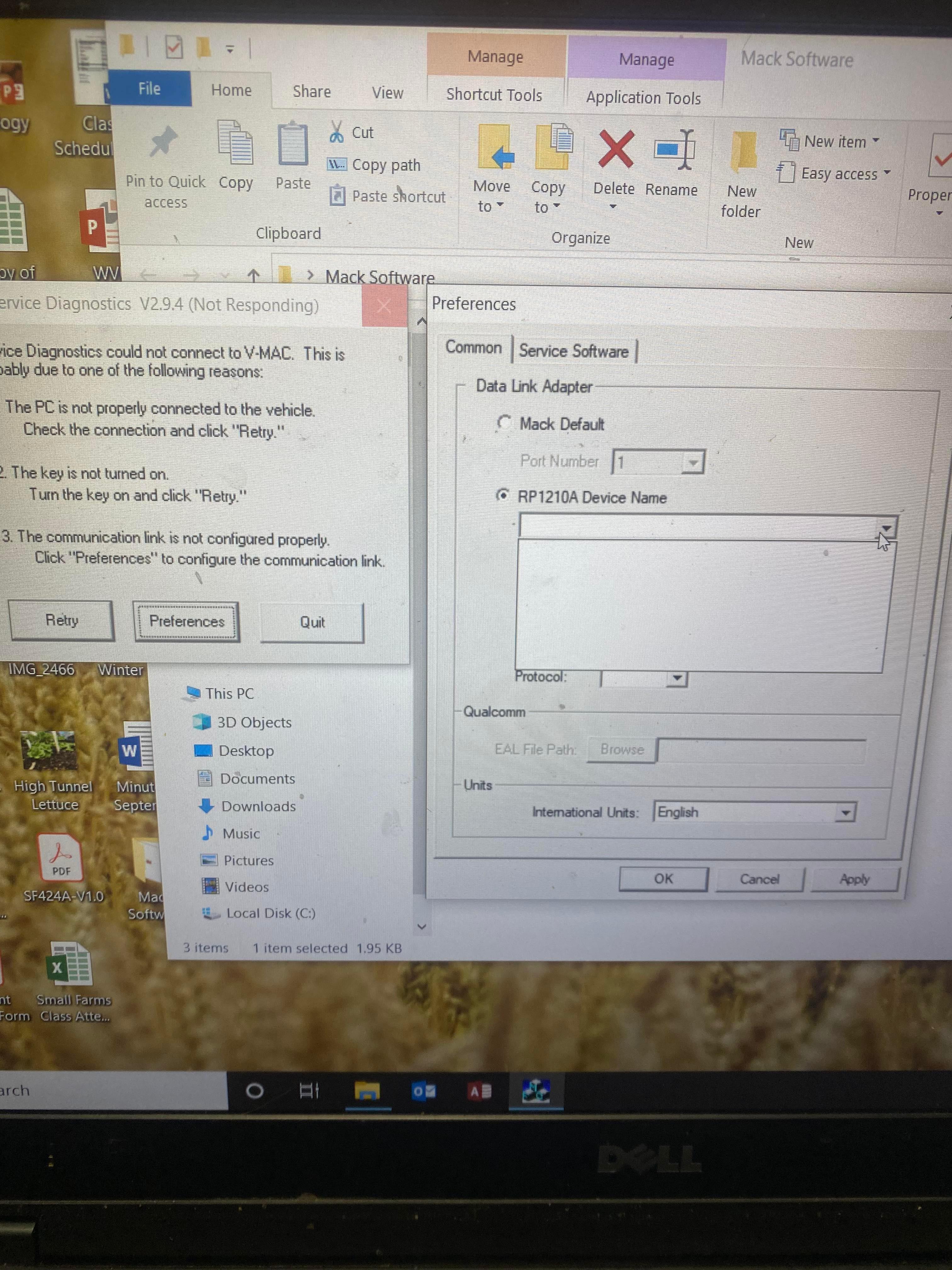

  10. It's a 2001 CH truck. When I use Diesel explorer it shows multiple ECU's (engine,ABS, and one or two others). What does the rocker switch look like? I also can run a test connection through Nexiq tester app and can see all ECU's. It's like the nexiq drivers won't communicate with VMAC. I get the prompt seen on the left in the picture, then I click on preferences to choose nexiq but nothing is listed.
