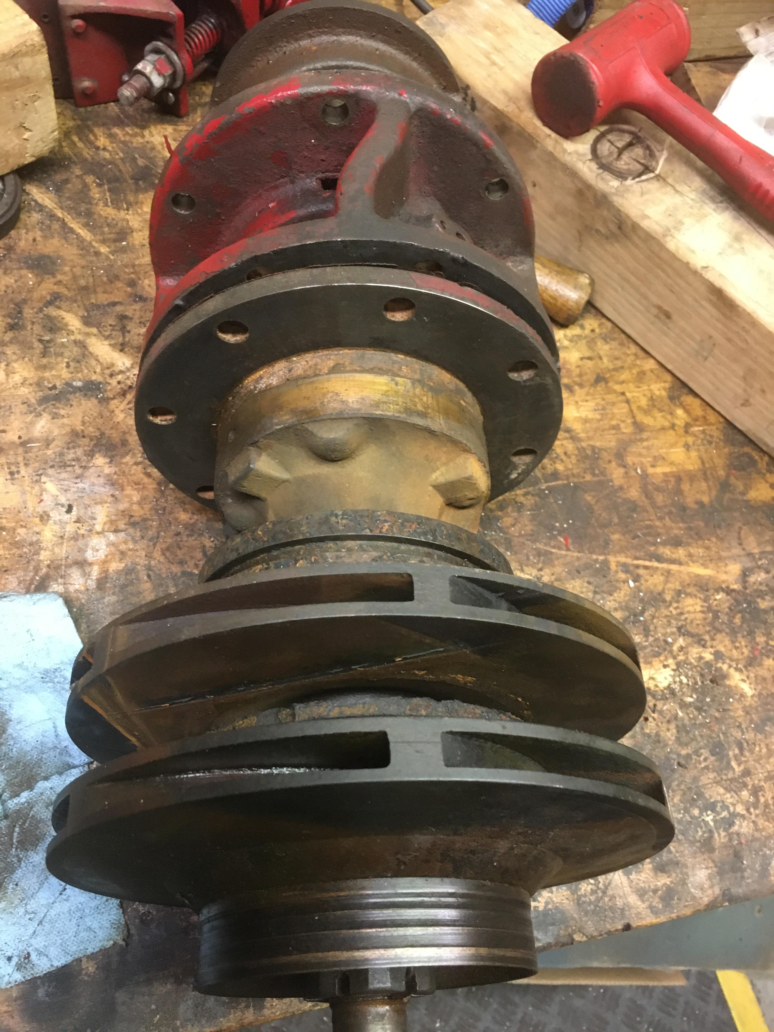

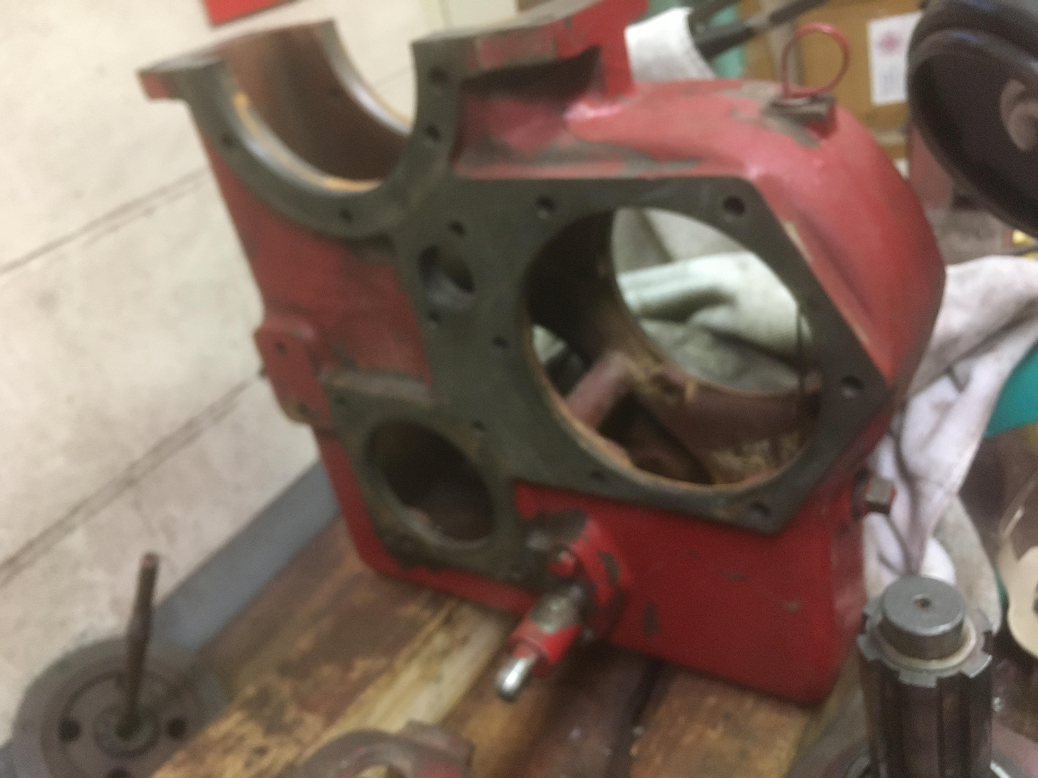

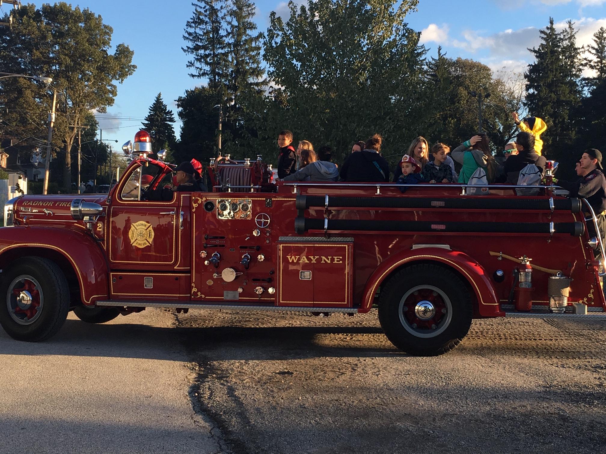

I got a call from an old friend earlier this year that asked me if we would bring the Radnor B75 to the Wilmington Delaware Fire Departments 100th Anniversary Parade and Muster. For fun during the Covid break I tore down the Hale pump with some help from The Famous Supplee Brothers -Dan and Bill from Oreland. It took longer to rebuild the pump than it took to restore the whole truck, but got it wrapped up in time for Memorial Day. During the pump rebuild I had time to clean and paint most of the frame, pump and running gear, so most the hard work was complete to detail the truck for the Wilmington Parade. The night before decided to take my dog Gambit to the Parade- he is a large sheltie but makes a good imitation Dalmatian! Wilmington had 4 B75 pumpers and 4 B95 pumpers. 2 were in the Parade and muster. Over 100 trucks attended and a total of 6 B model pumpers were at the Muster! Had a great time at the Parade and Muster. We have to congratulate the guys from WFD, they did a great job organizing the parade and muster. We were honored to be awarded first place 1950-1969 Fire Company owned Truck and Gambit won the Mayor's Choice award. We

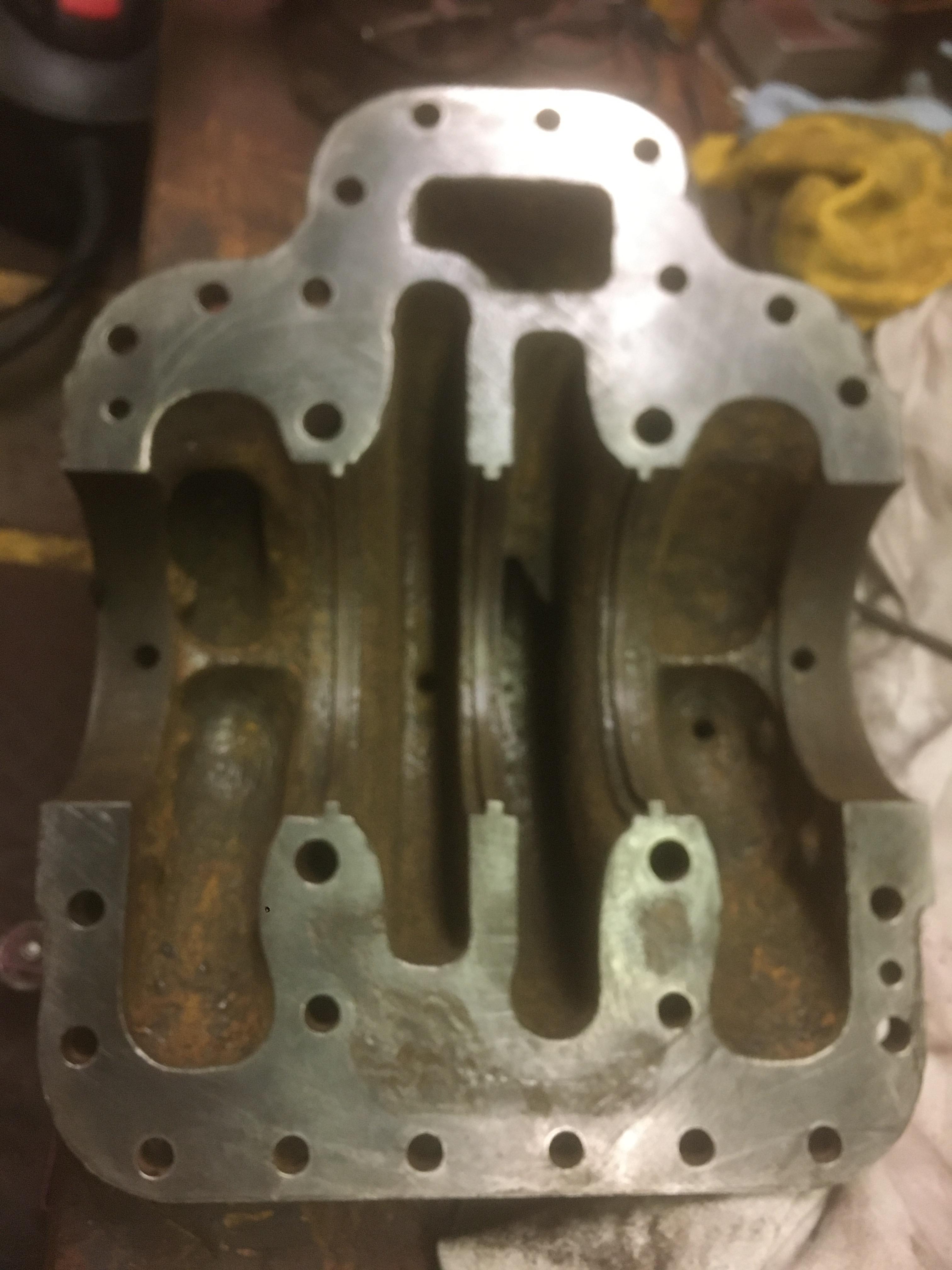

Glenn I am rebuilding my QL-1 (QL 75) pump and transfer case now on the 1954 Radnor B75 Mack (464 engine Hale 750 pump). I have the original Hale book and parts list and just purchased all of the bearings new (stock parts) the only part not available is the center bushing between the impellers, the front bushing is the most important and still available, I left you VM if you want to call and discuss. Firemack

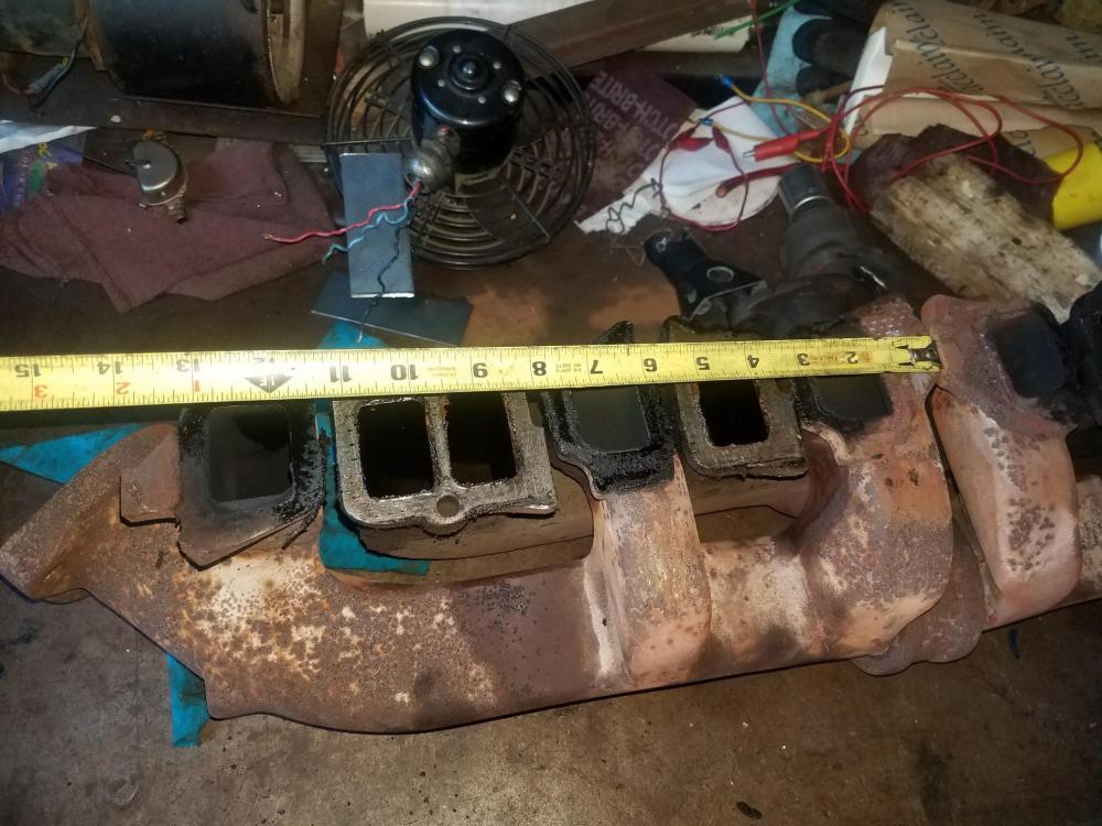

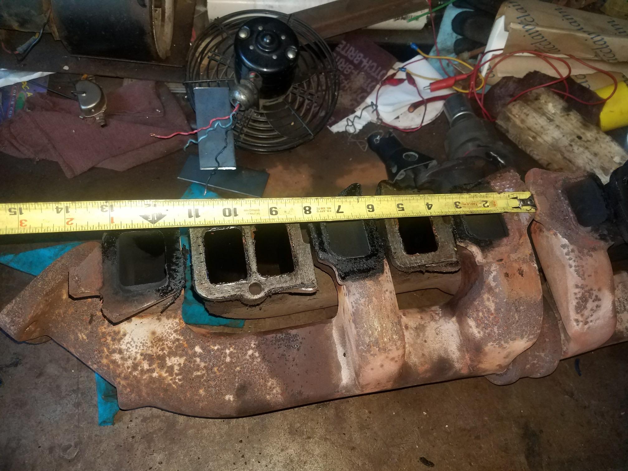

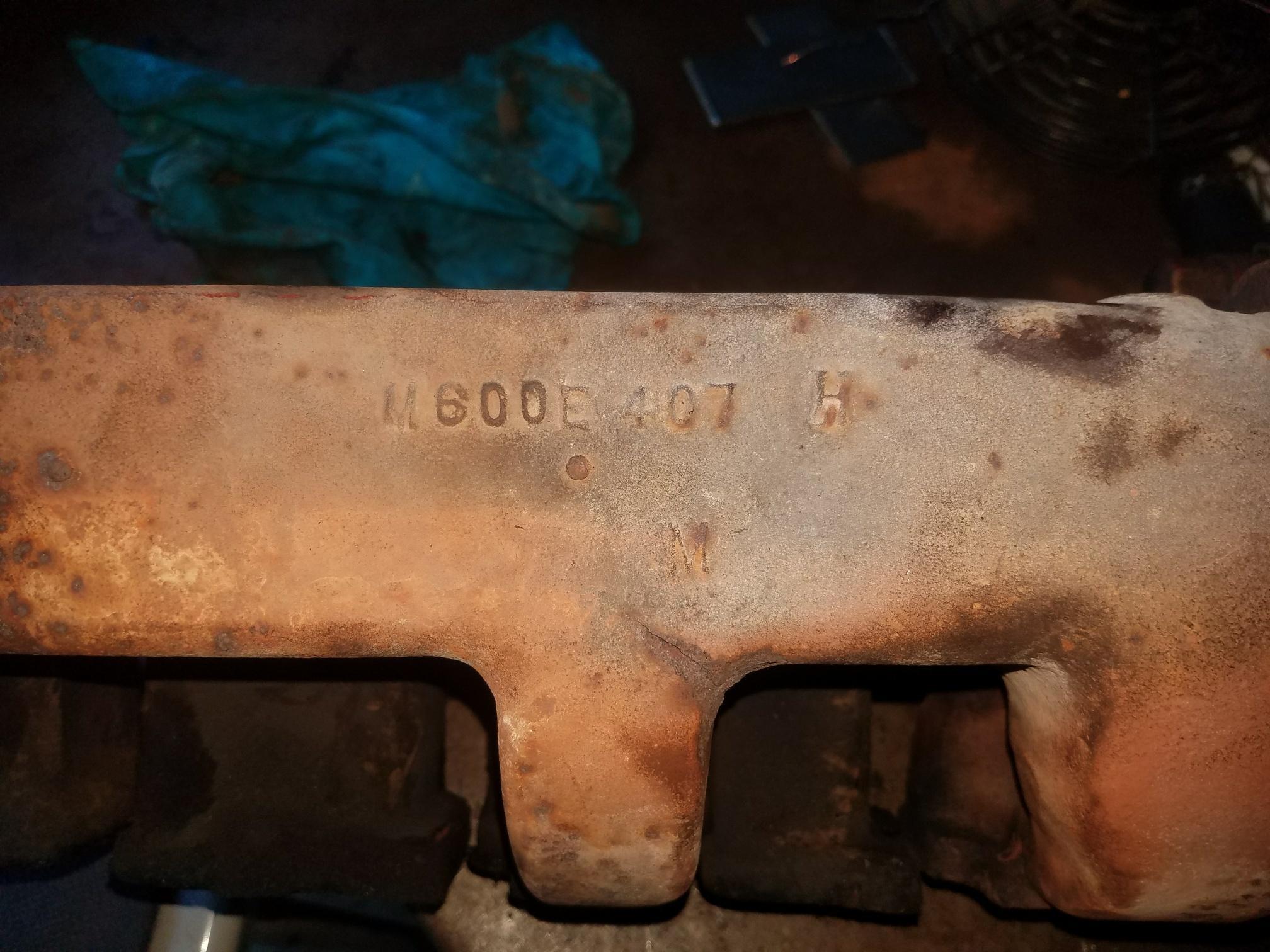

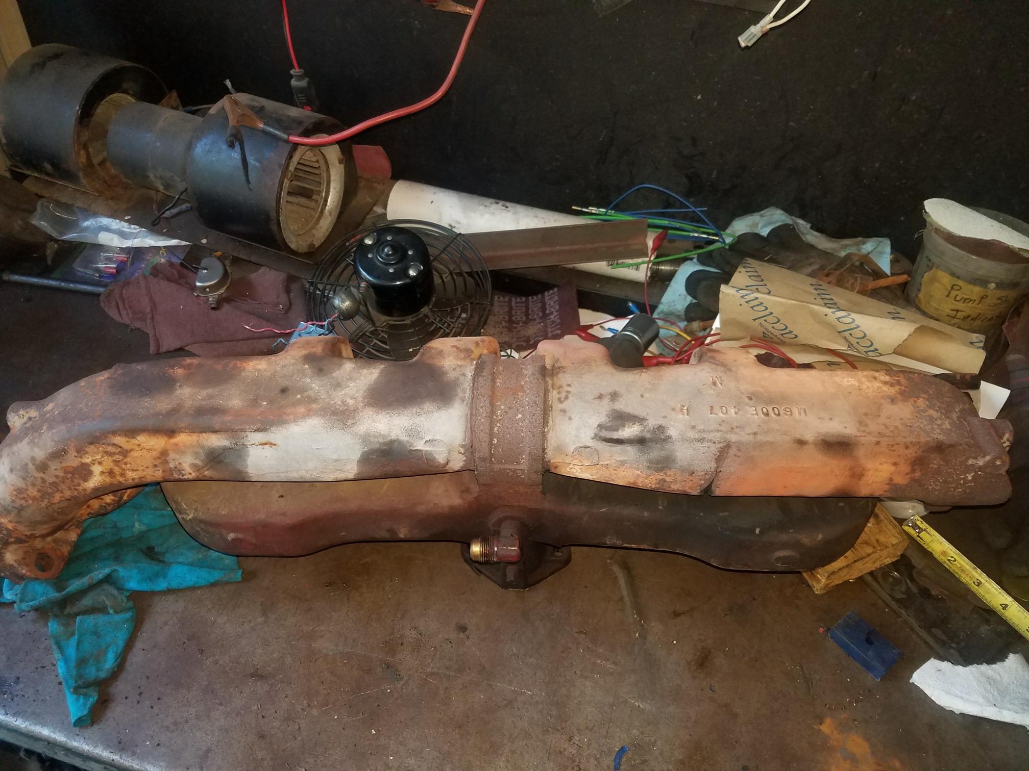

Have a friend working on a 1945 Mack E series Fire Truck with the Continental engine and needs an Exhaust Manifold. The front section has cracked and needs a new section or complete manifold if anyone has one available . Could either be a 290 or 330 CI. Part number cast in the manifold is M 600 E 407 H. Message me if you have one or know a contact that may have one. Worst case if needed we can weld it up, but if possible would like to get an original part in good condition. Thanks Firemack

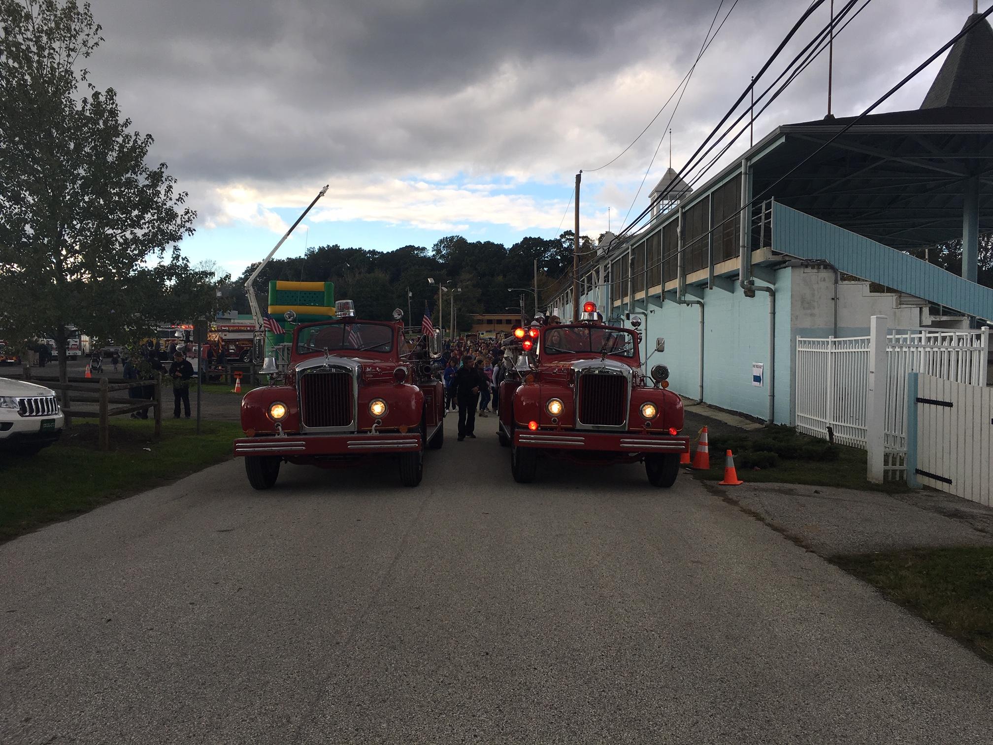

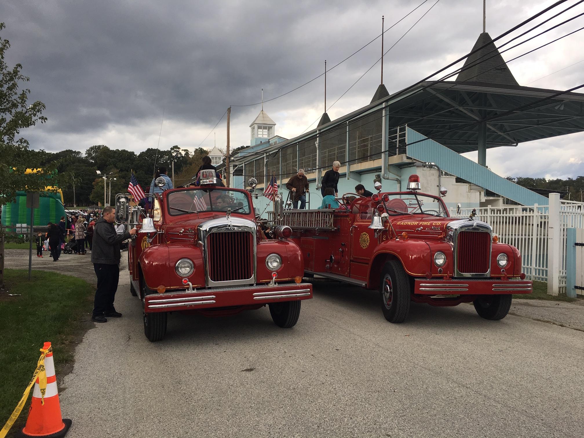

Pair of 1954 B75F Fire Trucks still working together 64 years later

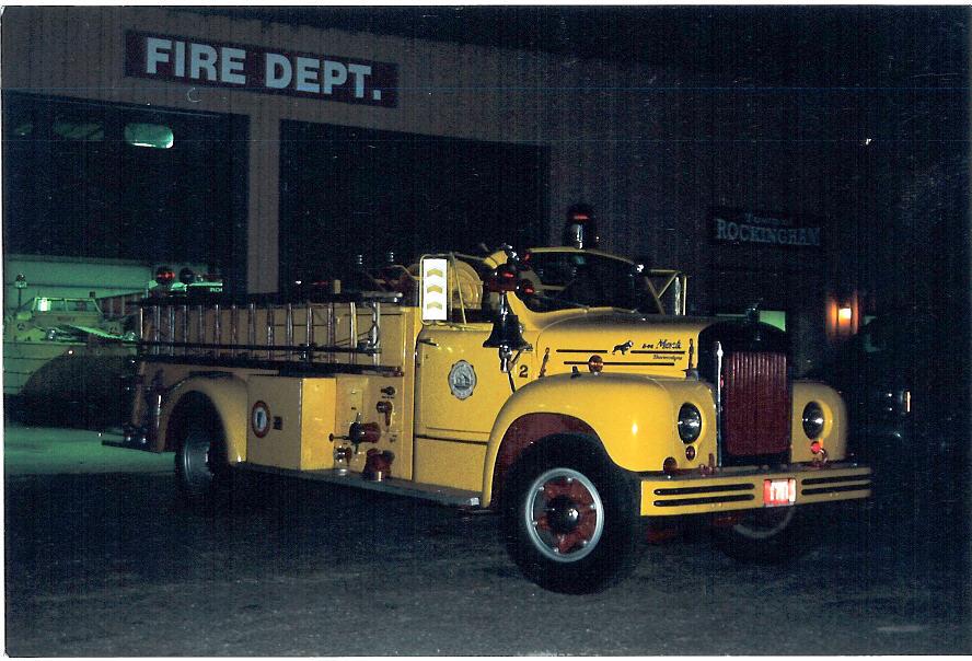

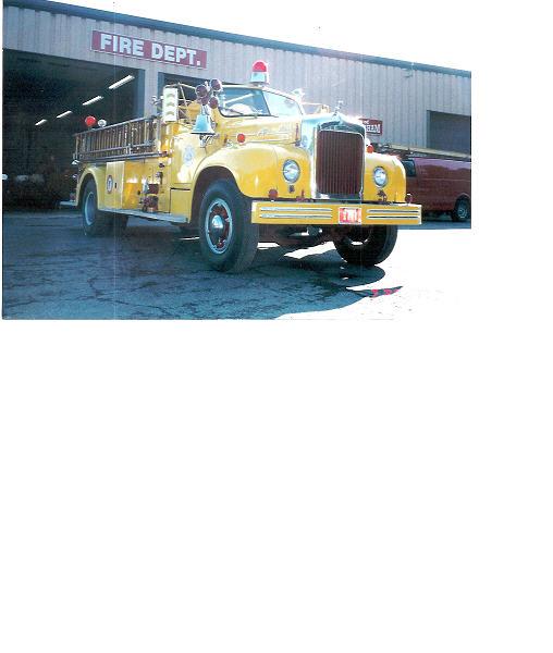

Yes it was painted yellow. That was a good reason to do all of the work to repaint the truck, so we bead blasted the whole truck back to bare metal, repaired or replaced all of the rusted panels, then painted each piece individually and then assembled, as well as rebuilt all of the mechanicals, used 21 gallons of red paint, plus primer, clear coat and silver. The paint was donated to the Fire Company by Sikkens. We drove it back from Vermont on July 20, 2002, started the restoration in November 2002 and was in the first parade in May 2004. -
Malvern Fire Company in Malvern PA has Mack B75F0001, the first of the B75 Fire trucks delivered in July 1954, Radnor Fire Company (a neighboring company) must have liked the truck, so they ordered a twin B75F Pumper in July 1954. Radnor B75F0011 was delivered in December 1954. They responded to many fire calls together over the years. The Radnor Mack was in active service for 48 years until 2002. Both trucks are now in semi-retired status working at parades, shows and other events throughout the year. Big Mack Website members may have seen the Radnor Mack at Macungie or Lititiz this year. This past Saturday, October 13, 2018, both B75F pumpers they were together again at the Main Line Fire Prevention Expo in Devon Pa, providing fire truck rides to over 550 participants. It is very cool to see a matched pair of Mack Firetrucks still working together after 64 years.

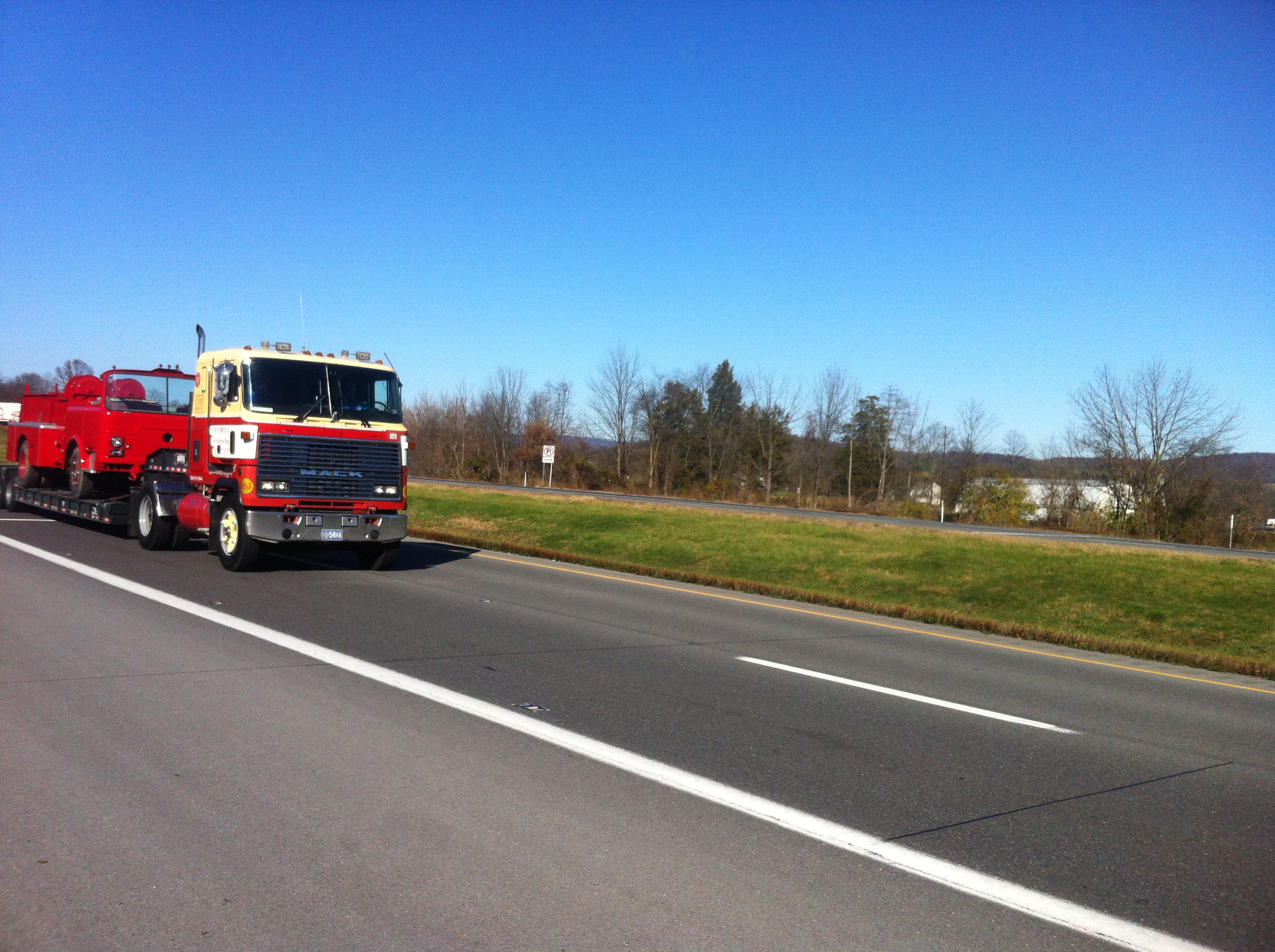

Yes the MH was a Ralph Smith Tractor- Ron Smith has the 39 Baby Mack- he is on the this site and was one of the original owners that cared for the MH over its first 25 years and 1.2 M miles. It has been hauling the Radnor B Model and Radnor Hahn on the lowboy to shows more than 50 miles from Radnor. It was tough on the B model going 50 on the turnpike and getting blown off the road by modern trucks that are doing 75 and not paying attention, almost got hit several times. The B model gets about 1 MPG around town and 3.75 going downhill with a tailwind, the MH gets about 5-6 with the lowboy attached and B model on the trailer at 73 MPH. Check the garage for the picture of the MH as it was set up with the stainless horse trailers, hope to someday buy the Ralph Smith Horse trailer and make it into a travel trailer, if I can ever get the wife to get on board! Ron that was a typo, 1.72M Here is the the picture with the original stainless trailer. That was great looking combination!

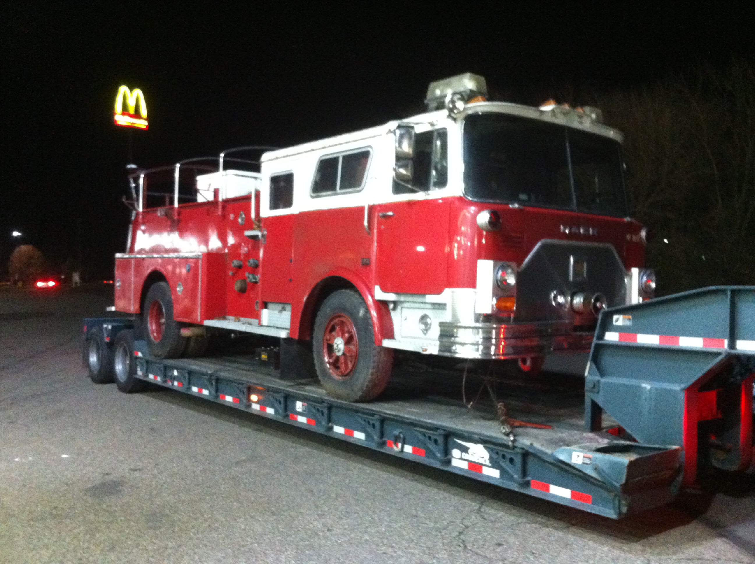

FDNYMACKCF Great job on rescuing another one! Here is another one of the few Open Cab CF's, this one is a gasser and had a blown piston, this was taken coming back from the paint shop in PA, hope yours makes it back to NY so you can show it with this one. This was a week before rescuing a FDNY truck last year (night shots). Both are safely stored and hopefully the open cab is getting ready to make it Harrisburg pump primers this year. Firemack
