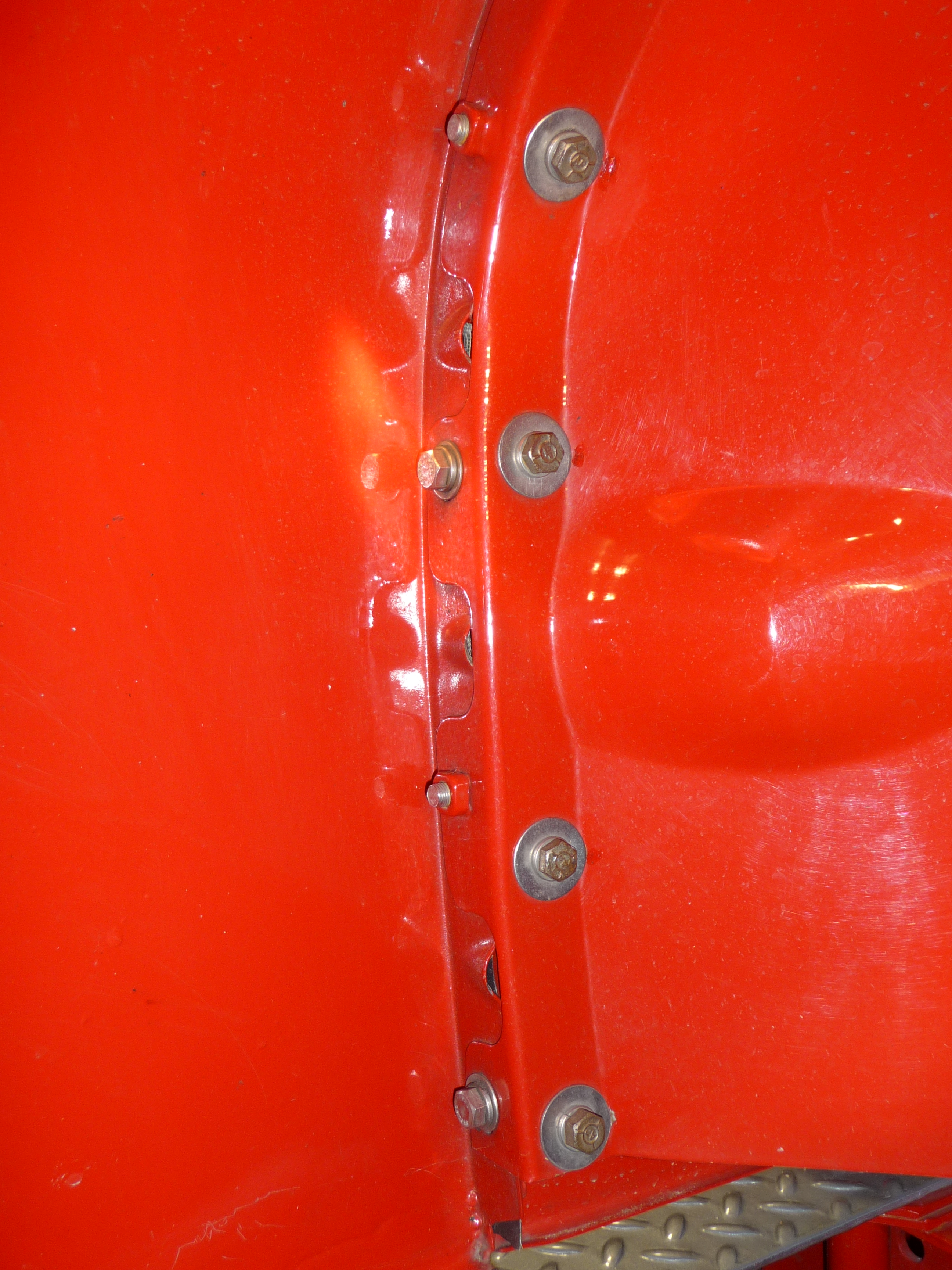

  18. David, You do not need to remove the fenders, just loosen the bolts where the fenders and headlight panels meet, the fenders actually have slots in them to allow them to slide out for the removal of the headlight panels and grill shell assembly at the same time. You will also need to remove the 4 machine screws on the top of the grill shell, 2 on the center hood hinge support and 2 near the back of the radiator where the grill support and fender meet, at that point you remove the entire assembly. On the attached picture the 4 bolts with large fender washers are slotted to slide and then will be removed as well as the 2 bolts (with regular washers)bolting the fender to the headlight panel. Good Luck, Firemack
