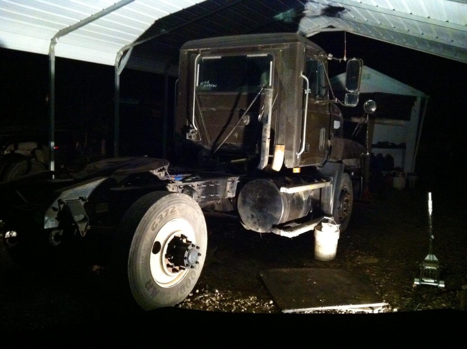

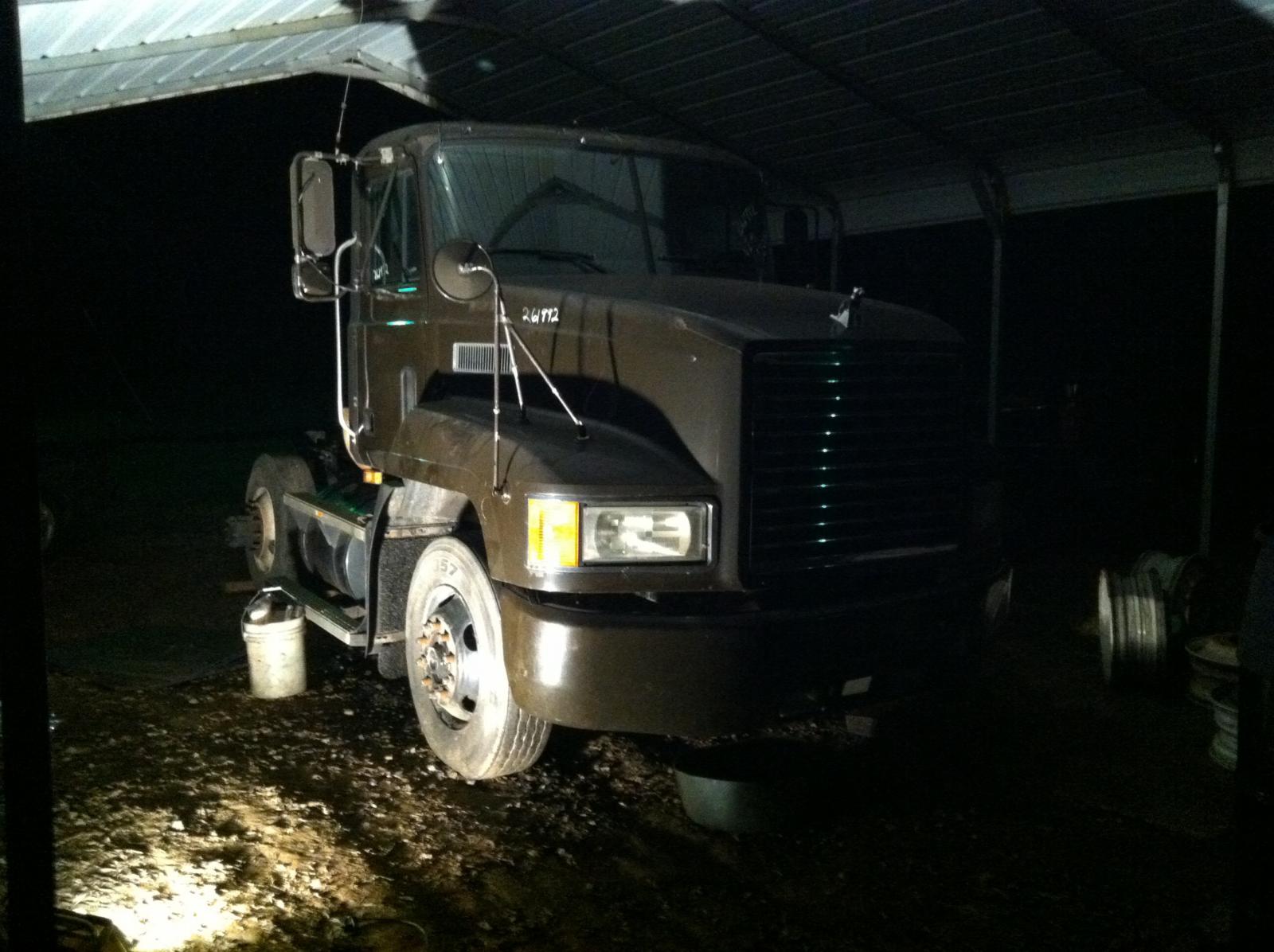

  16. Don't have any pics of it on the trailer , just the 2 R,s.
  17. Building for champ truck racing , this will be big trucks on race tracks road coarse racing . 100 mph cap on speed, single axle manual trans drum brake trucks. Roll cage is shedueled for install Jan 6 . Have a lot to do but making progress thanks to 84superdog.
