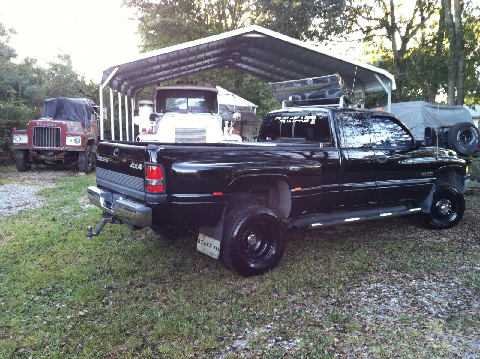

  2. I know it's not a tn mack but it was in Tn when I took the pic , I think it still counts.
