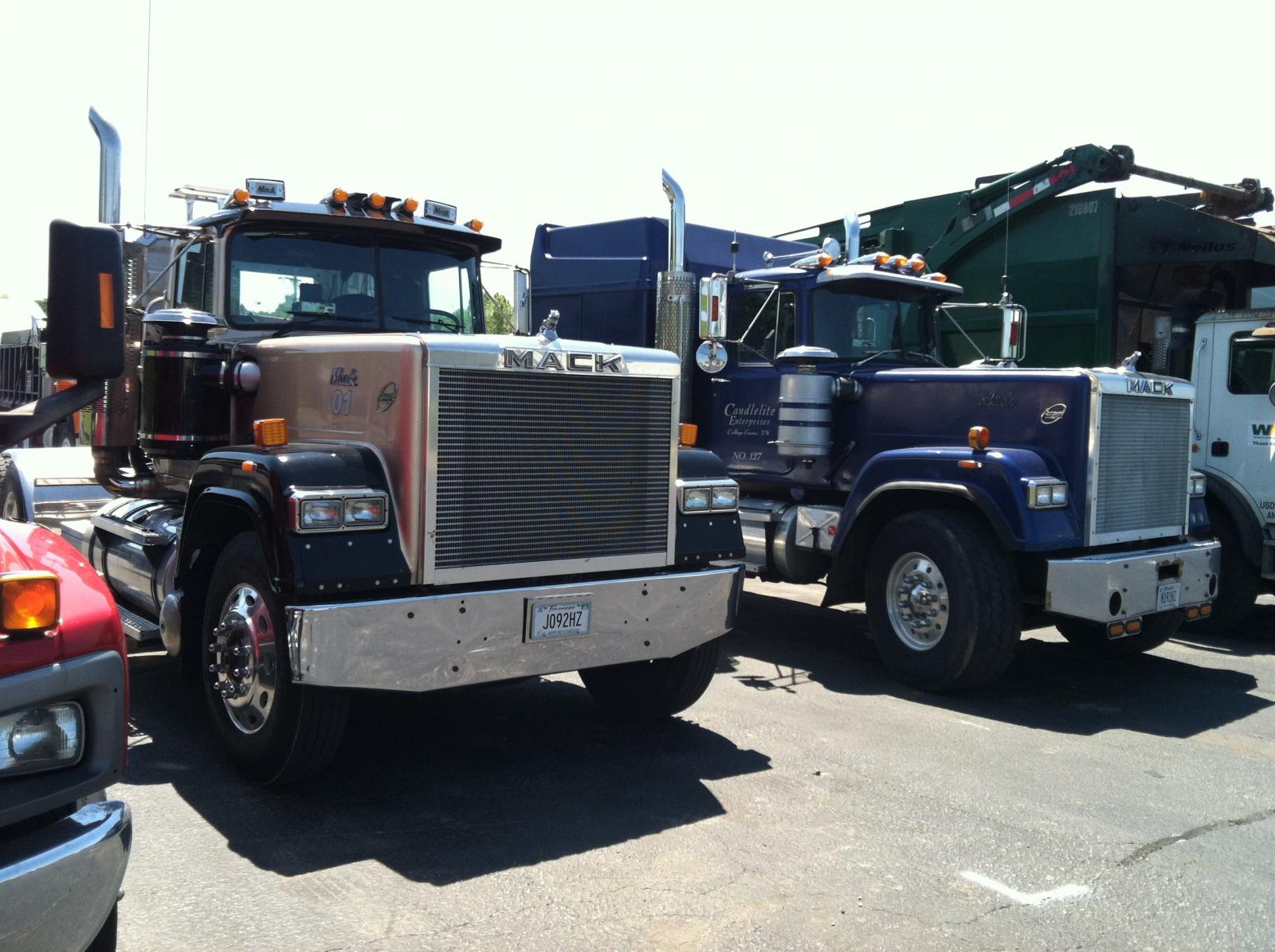

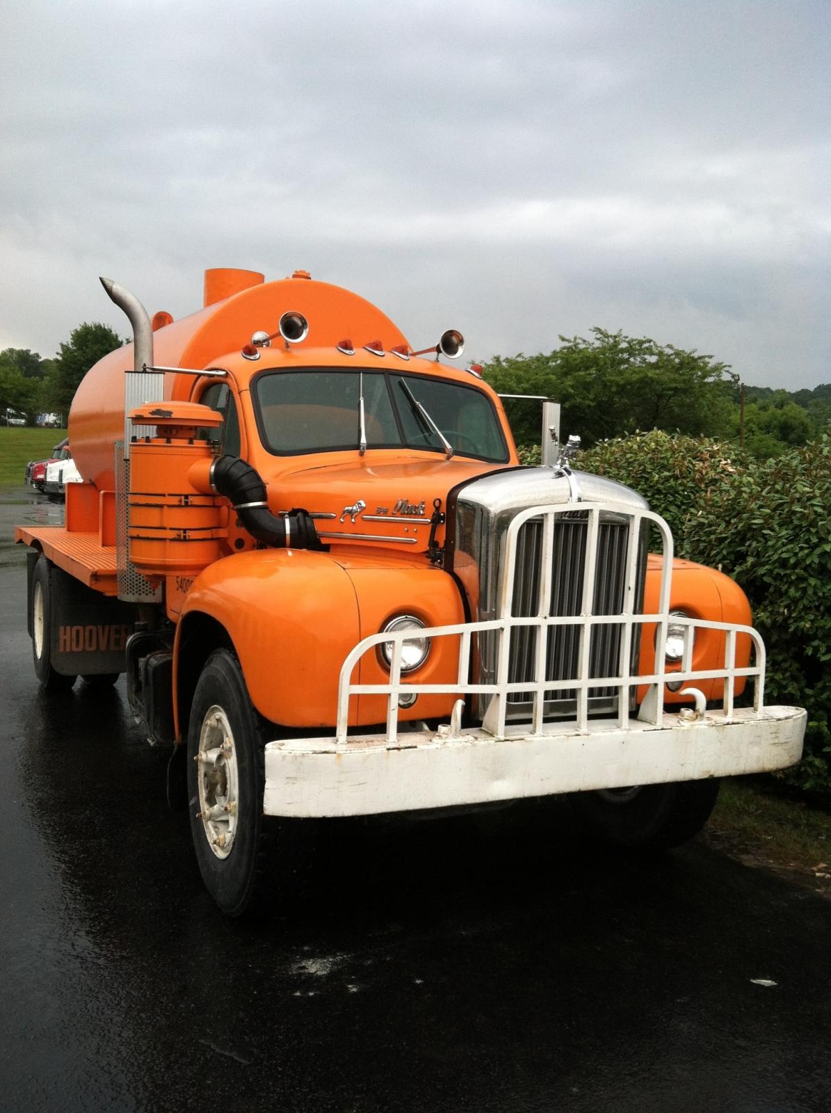

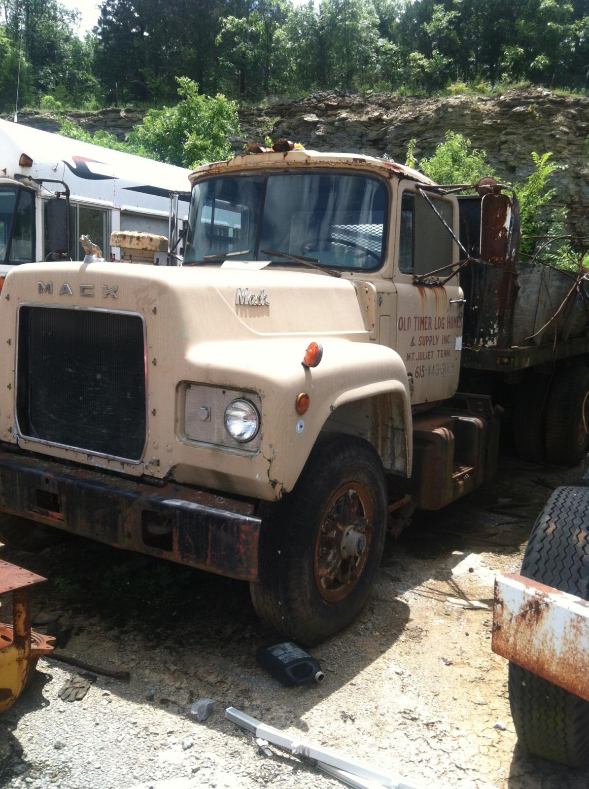

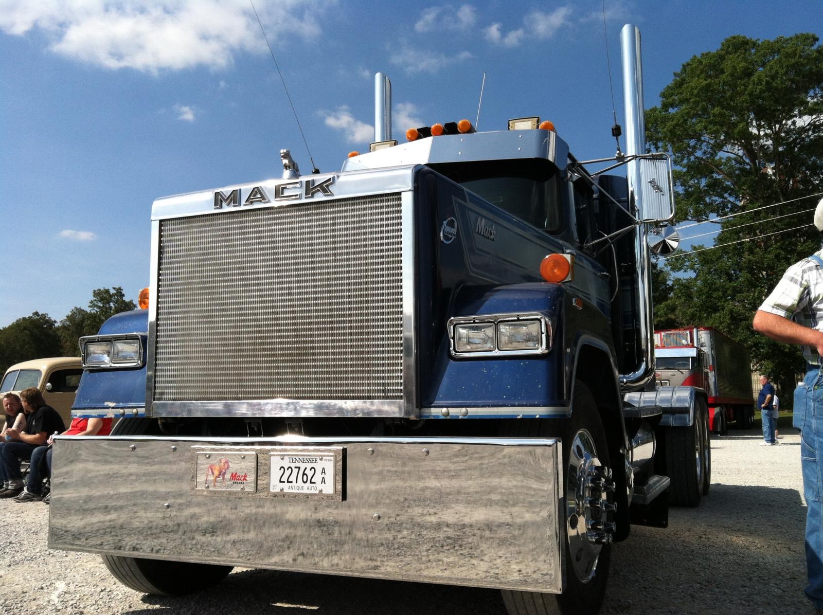

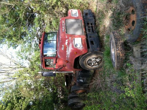

  8. Well heres a few to get Tn started.
