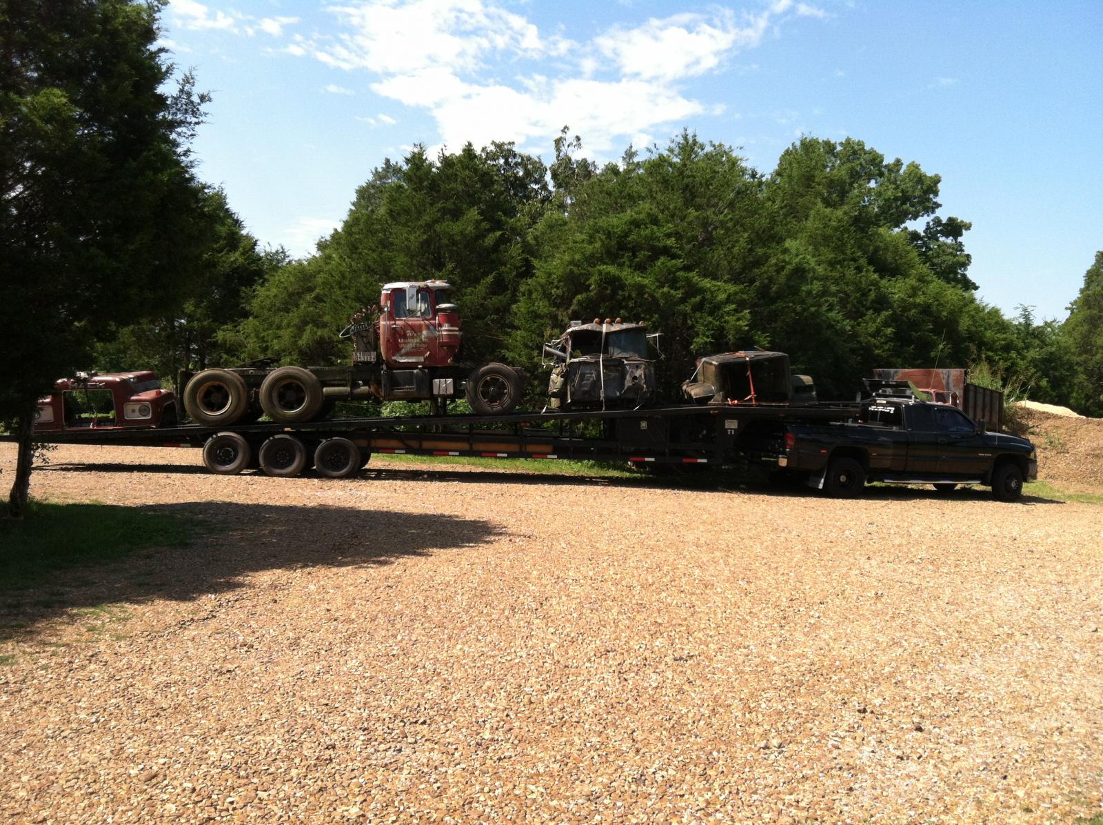

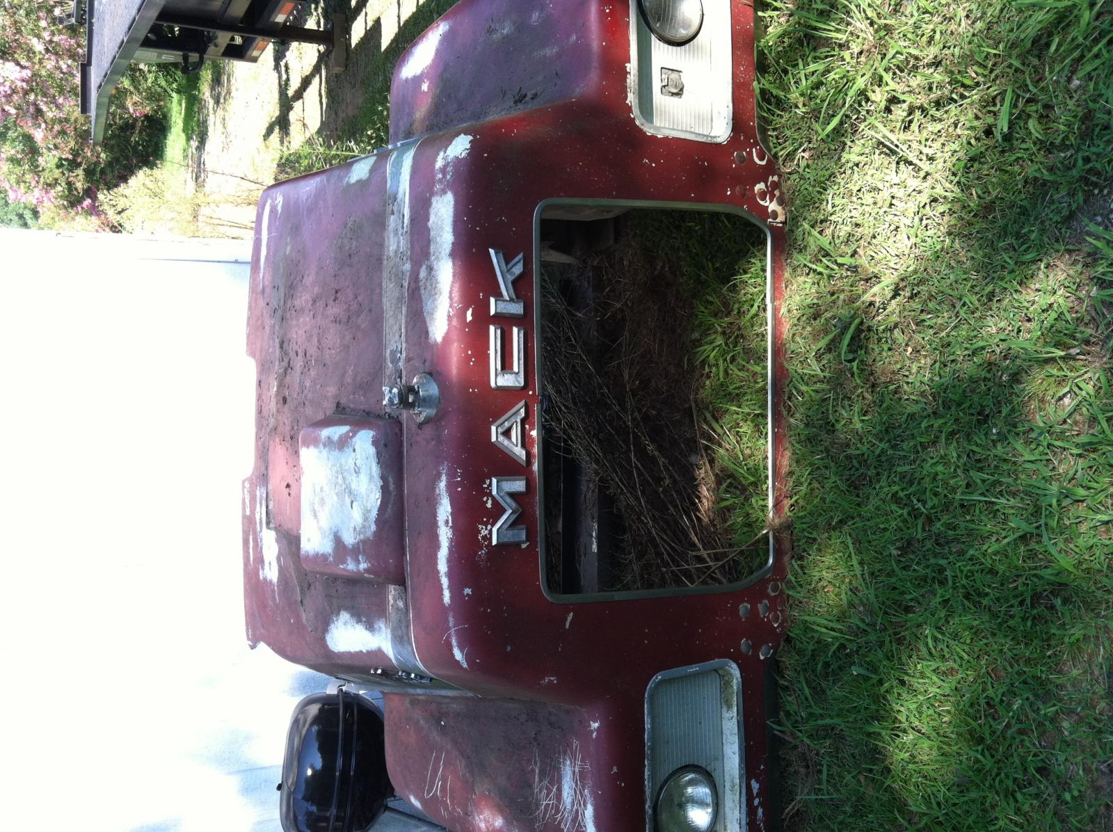

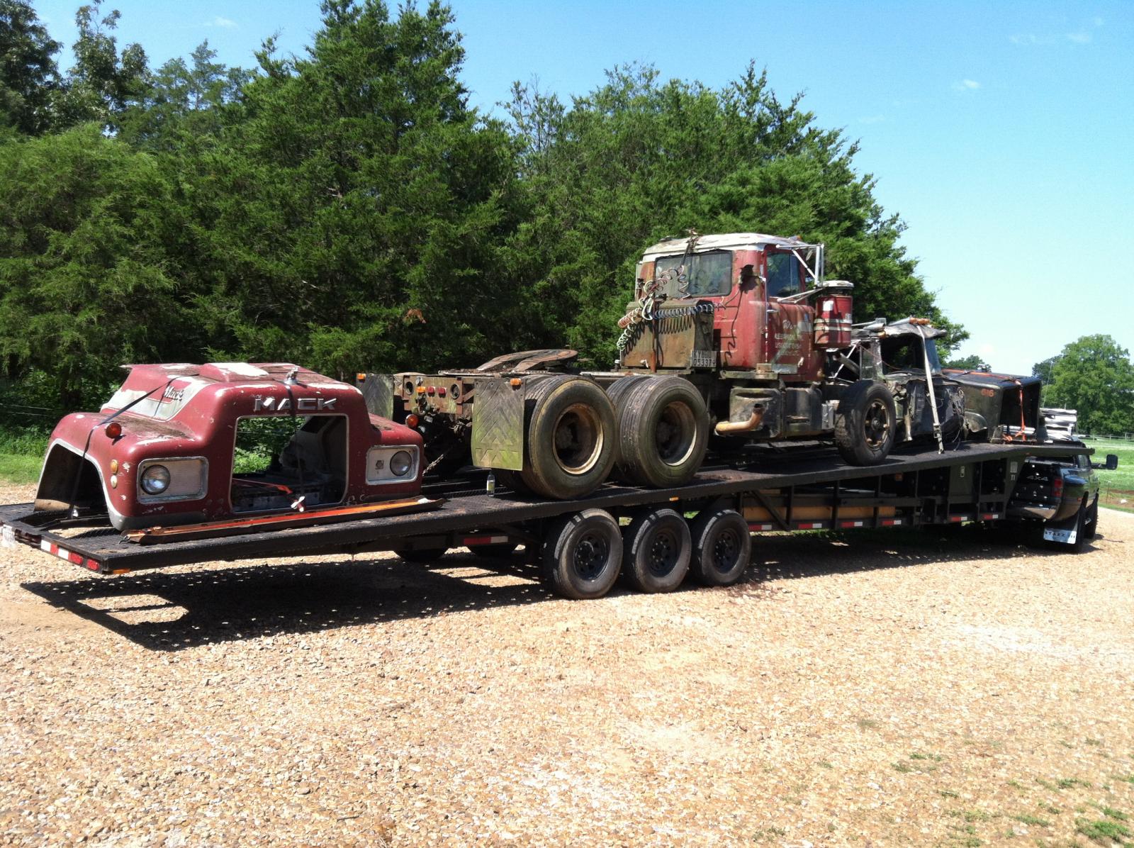

  25. Well I picked up My R and a superliner cab and hood .
