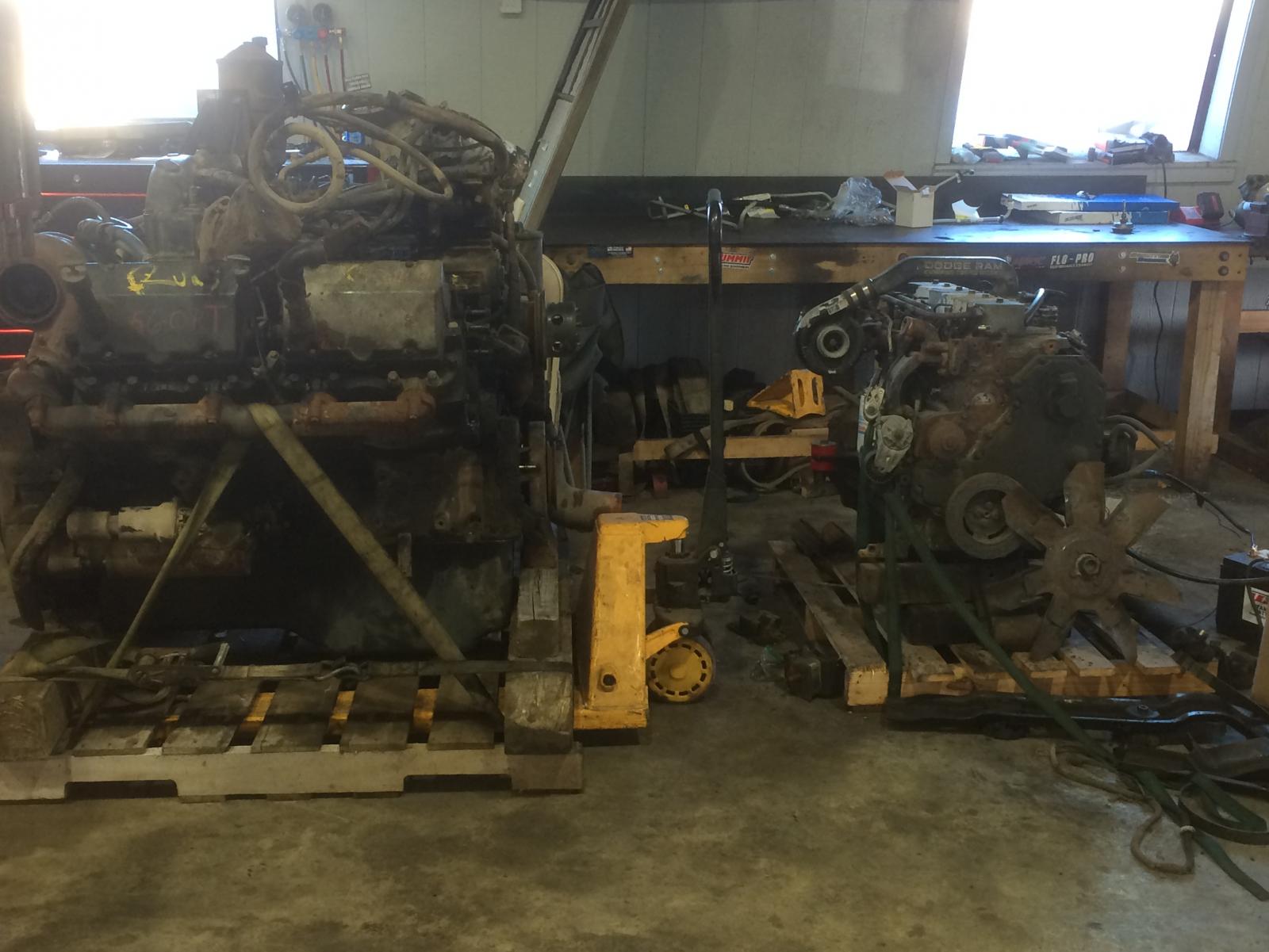

I had some time to pull the motor out of the new truck I purchased. I've pulled a lot of engines but this really shows you just how bulky an E9 is. A 3406 or ISX is a big motor on the ground. The Mack is just like a body builder with giant upper body muscles. Almost comical. The motor next to it is a 5.9 Cummins out of a Dodge pickup.

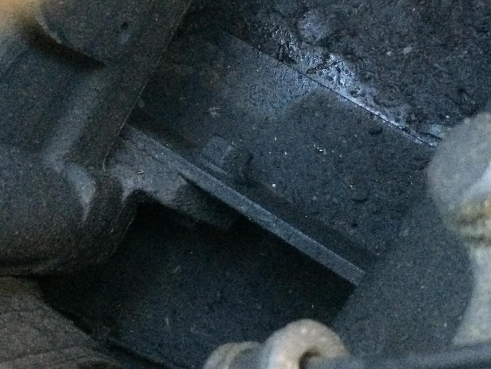

Here is a picture. Not the easiest spot to snap a good photo... Its a simple piece of angle across the valley with another piece of angle for the pump to sit on.
