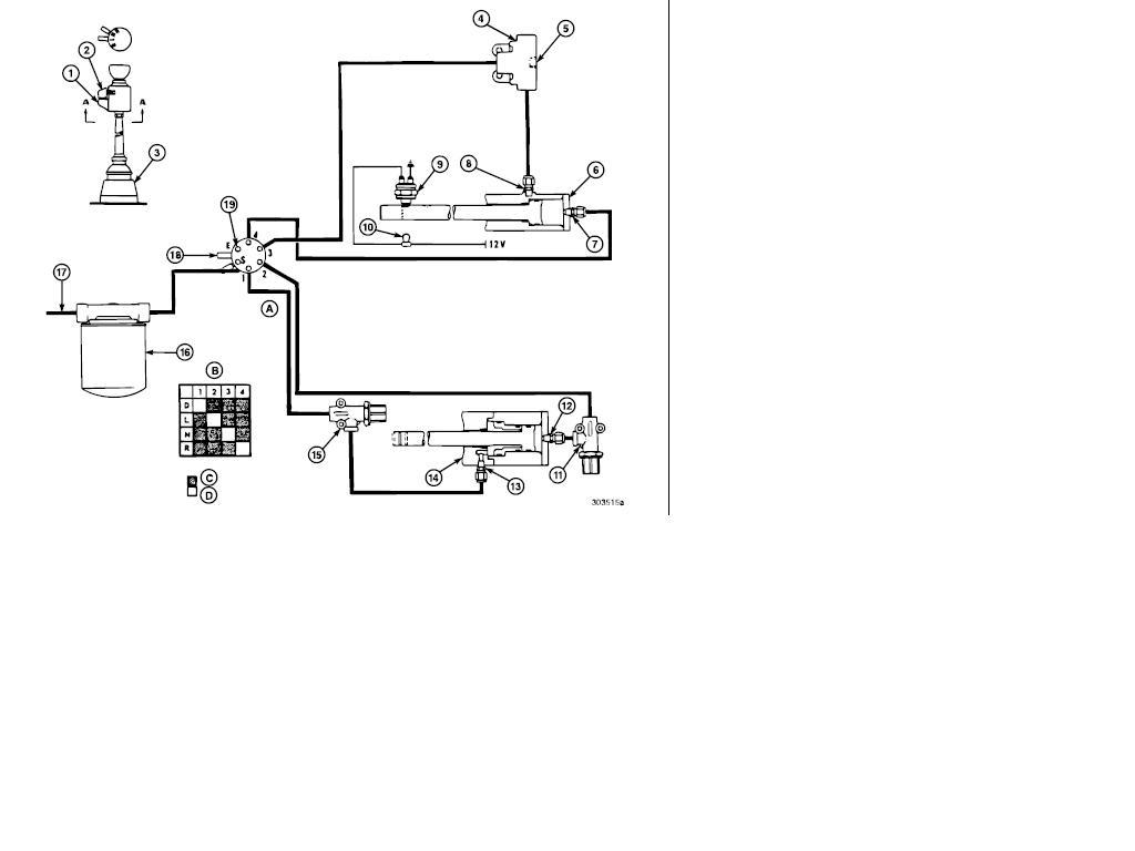

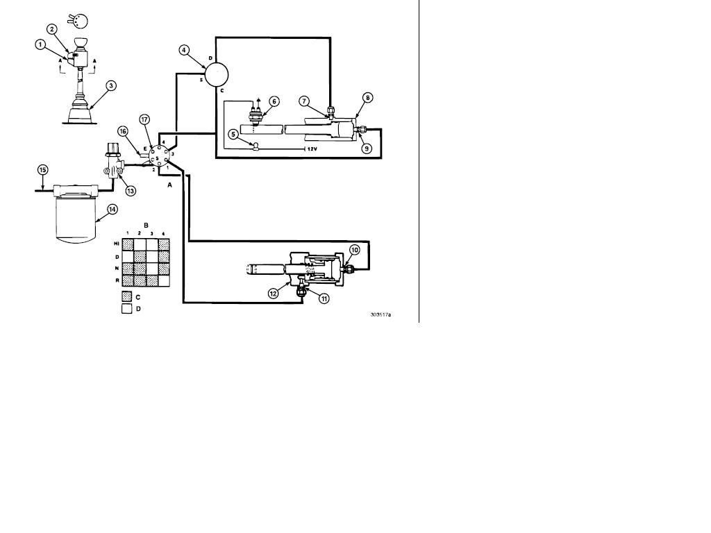

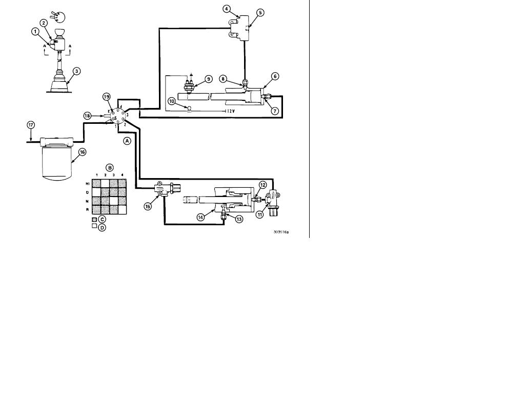

TRTXL107 Prior to Serial Number 9G9071 1. Air Control Reference Locator 2. Air Control Select Lever 3. Gear Select Lever 4. Quick Release Valve 5. Exhaust 6. Reverse Shift Cylinder 7. Port No. 4 8. Port No. 3 9. Back-Up Switch (normally open) 10. Amber Indicator Light (on in reverse) 11. Pressure Reducing Valve (60 psi delivery) 12. Port No. 2 TRTXL1070, Serial Number 8S6798 and later 12. Hi/Direct Shift Cylinder 13. Pressure Reducing Valve (70 psi delivery) 14. Air Filter 15. Air Supply 16. Selectair Valve 17. Exhaust A. Section A - A B. Piston Port C. Pressure D. Exhaust 11. Port No. 1 Hope this helps -
