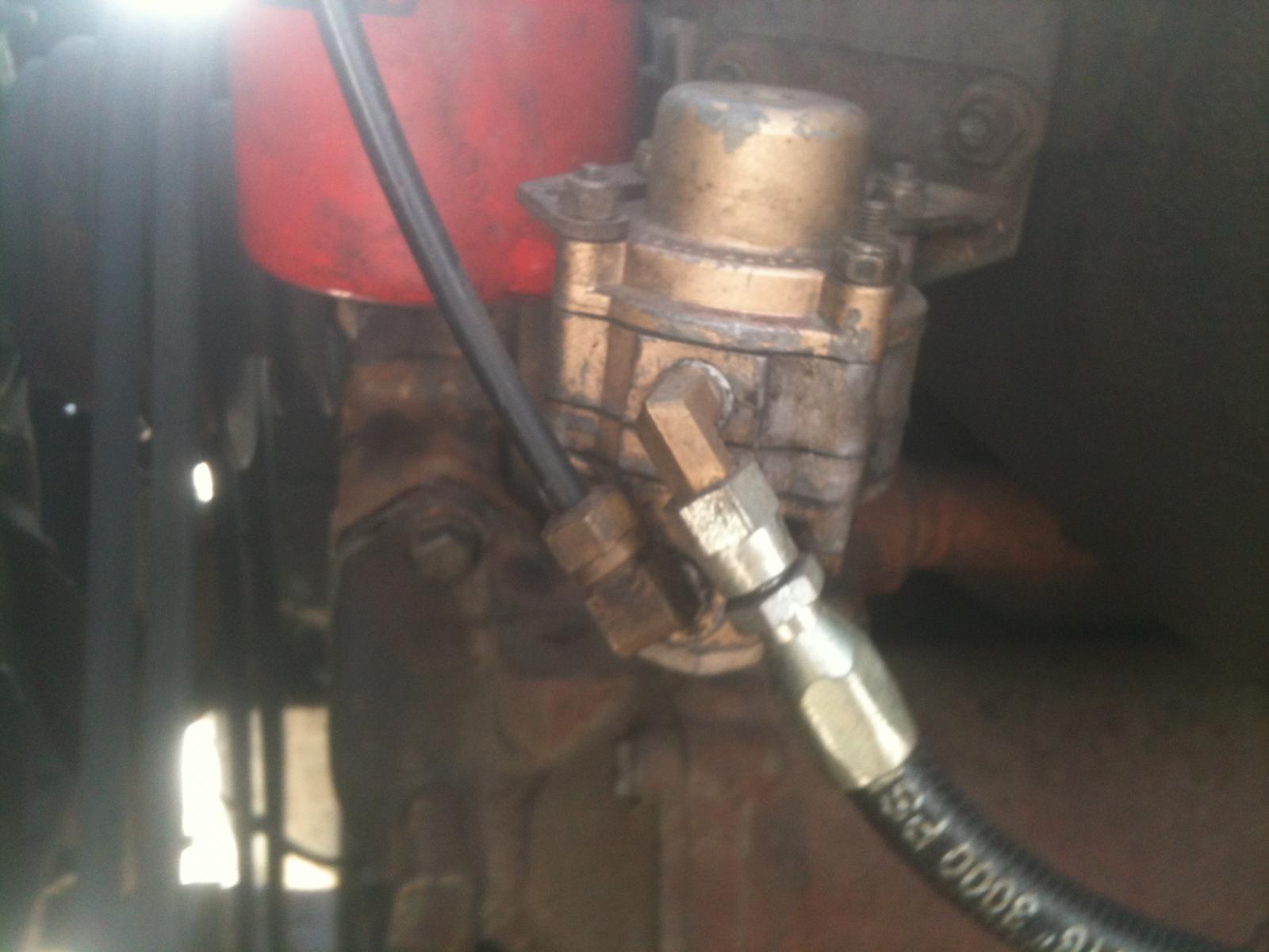

  9. wouldn't that be more effort than just removing it?I don't really understand how its hooked up i see the one line goes to the intake manifold??? i think?? and the other looks like its going in the cab. I ran out of daylight i will have a better understanding tomorrow. I have 3 toggle switches in my truck i haven't figured out what there for maybey ones for that i will check tomorrow. Thanks
  10. Could someone explain to me how do I bypass puff limiter? Mine is leaking a little and i think it is clogged . I would like to bypass it at least to see if this solves my problem. Do i just plug a line somewhere?
