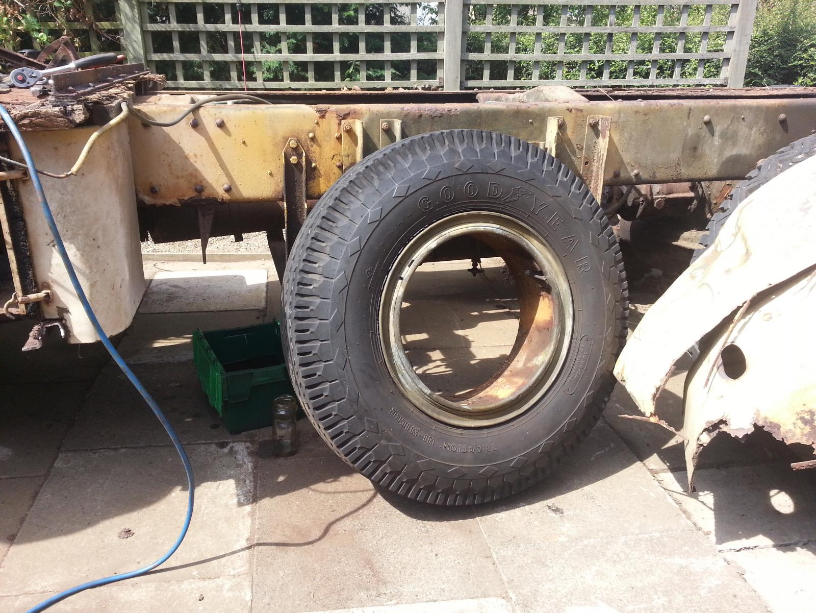

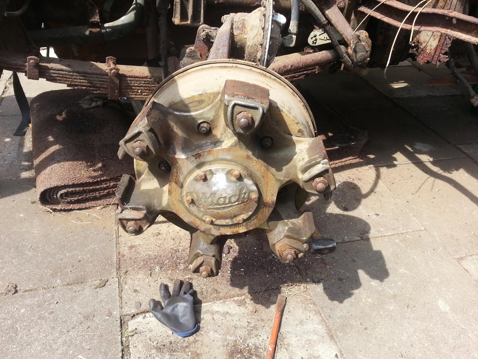

I am very glad I asked ! The truck has been lying since the early 80's and when I got to it you couldn't see the passengers side tires for mud. think I will go out and let them down before I go to work today. I will check round the local commercial tire places on Monday to see what they can do for me. I've heard of people being killed by exploding rims but I wasn't sure what type were the dangerous ones. Going to take my time removing the rears now. It's ok though as I'm not in any great rush for tires as you can see by my photos. I am glad I found you guys, would still be standing in the mud wondering how to get the truck rolling. Cheers.
Good evening my friends, I am hoping you will be able to help me. I am restoring a 1948 lfsw and I have just started stripping the wheels off. My question is this, what wheels do I need for the truck? Are there a common swap? Looking at the front rims they are held on with 6 nuts and lugs, they look like rims with a locking ring? Any and all information will be greatly appreciated.
