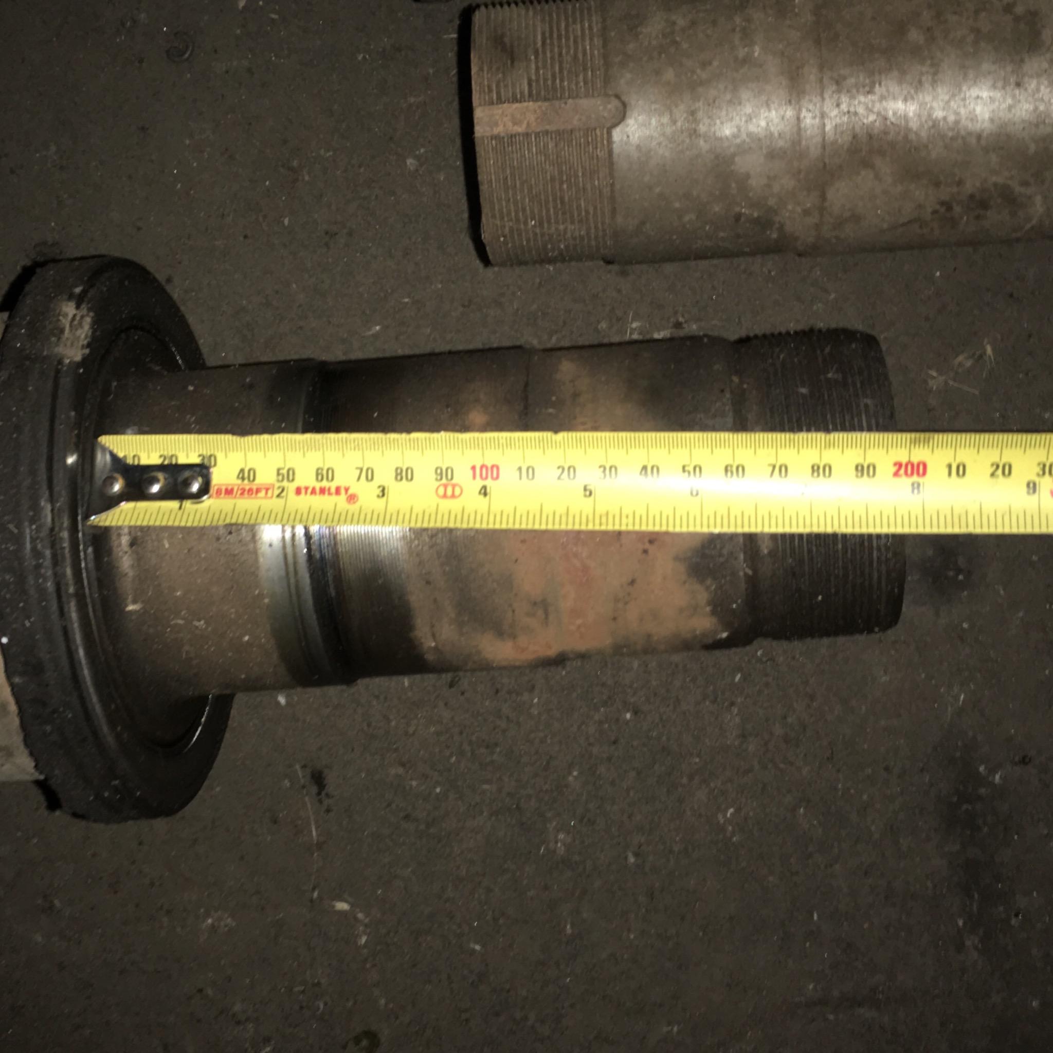

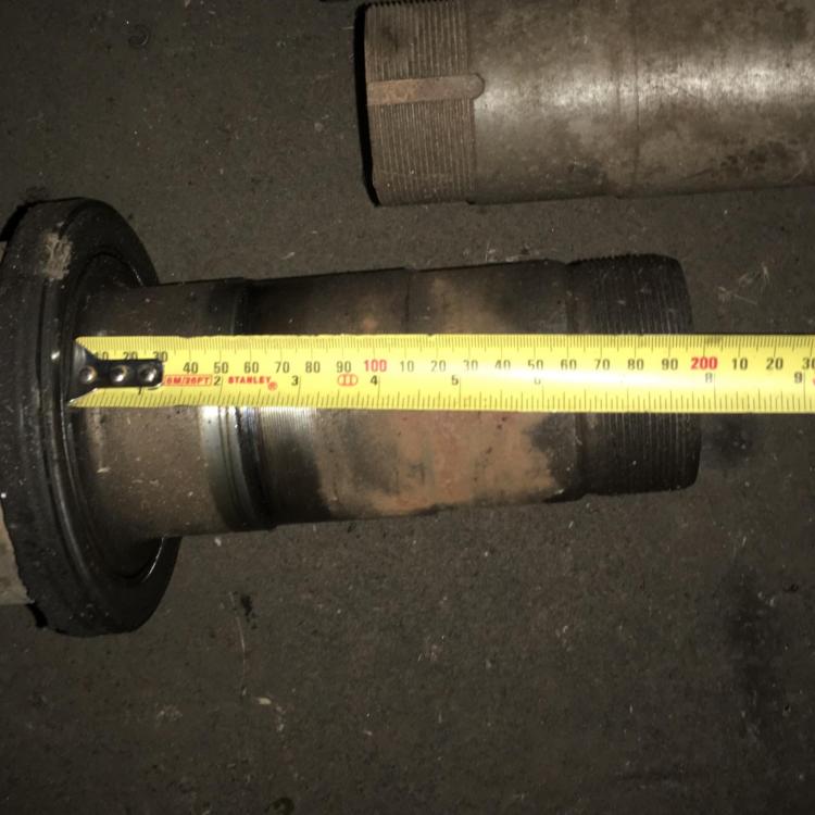

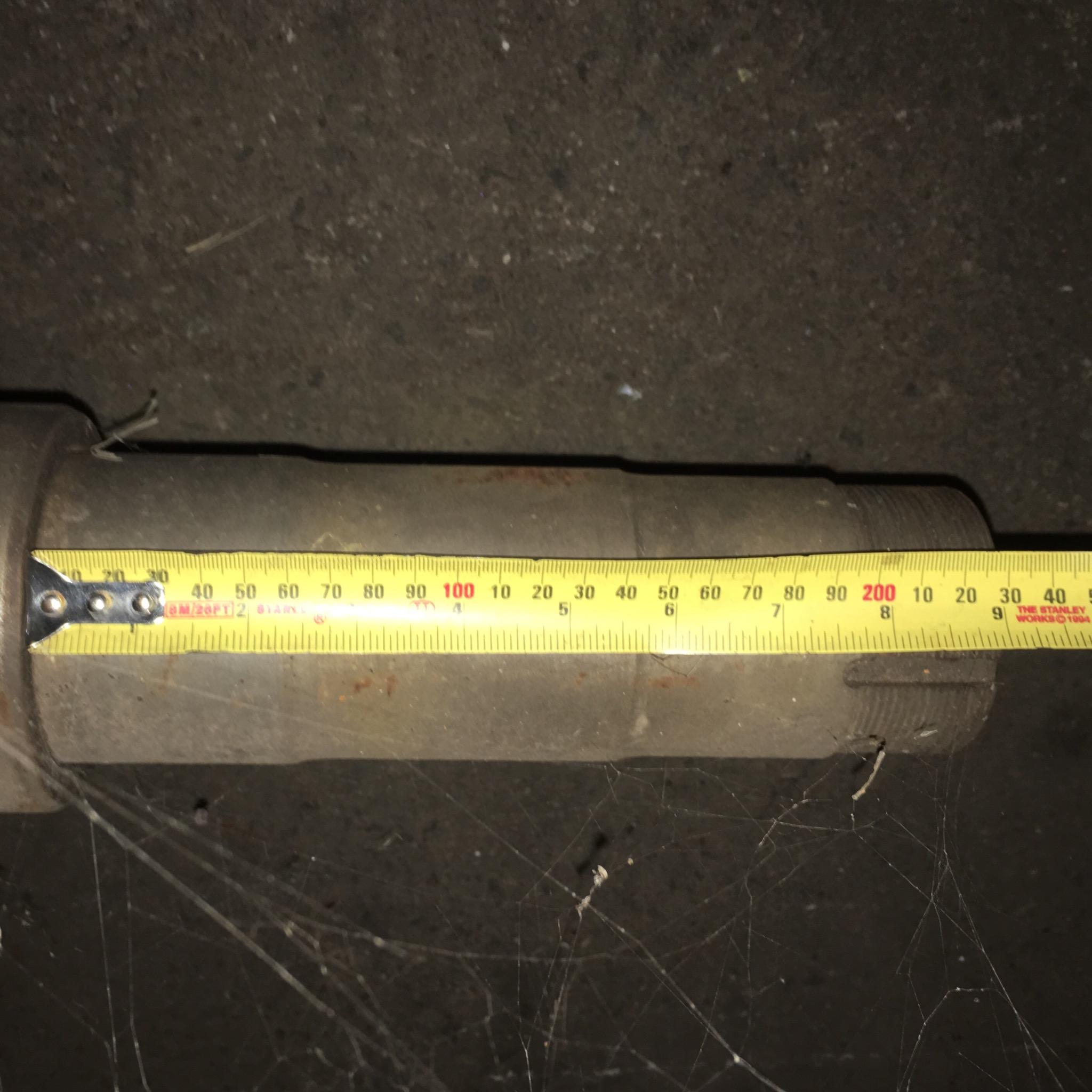

  6. Outer bearing on the 44 reads timken hm-617049. Outer on the 38 reads timken hm-617010. My truck started life with 34,000lb diffs, but when I bought it there was a 38 at the front and a 44 on the rear.
  7. Just checked my 38 diff for you any. And yep my inner bearing is a 598a. Also is a pic of the two different length spindles. 38,000lb 44,000lb So my 38 spindle is about 8 inches long, the 44 is 9.25 inches long in case my pics are hard to see. Hope that helps you.

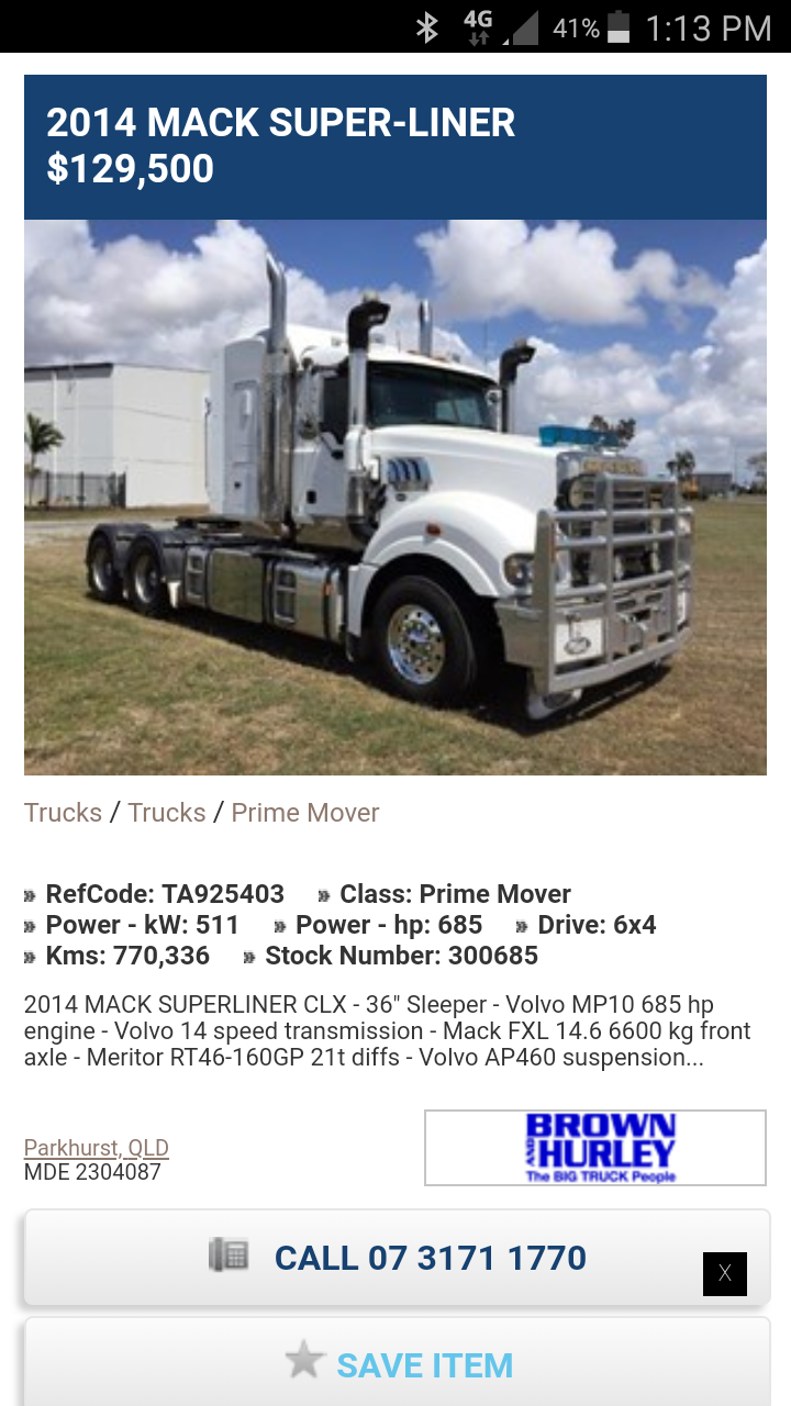

  10. Here is some for you Swishy! This is how a kenworth dealer sells a new Mack.

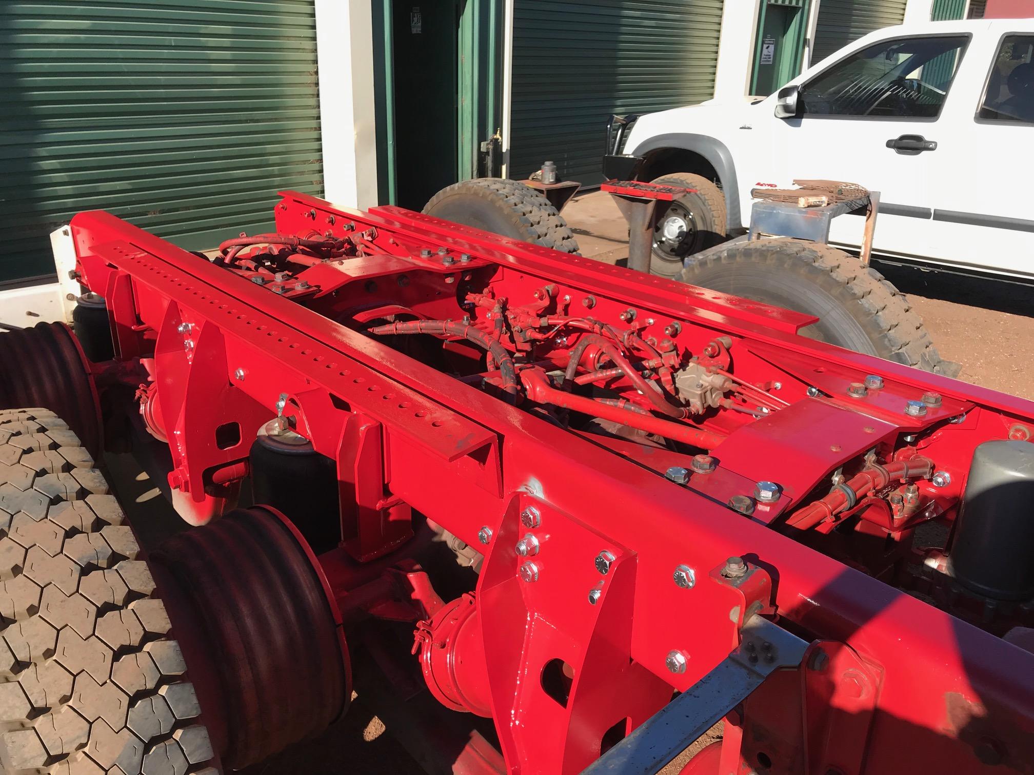

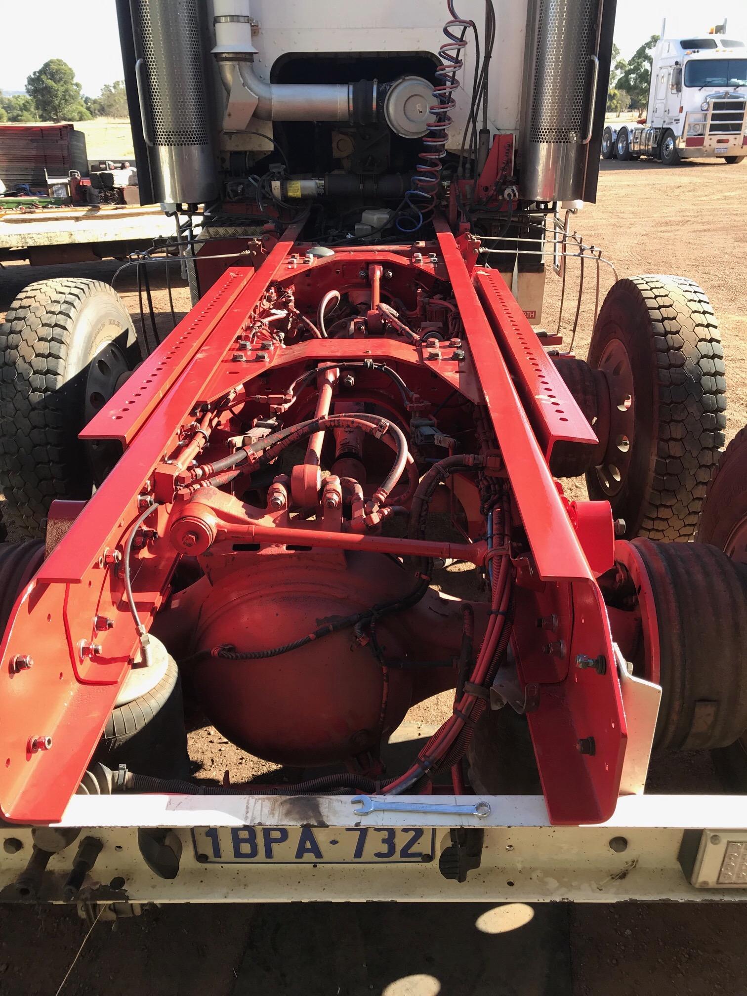

  19. Apparently hay can spontaneously combust if it was wet when bailed. Sure some guys in here can explain it better than me... but I have mate who cart hay some time and when I rains it delays them a fair bit.
