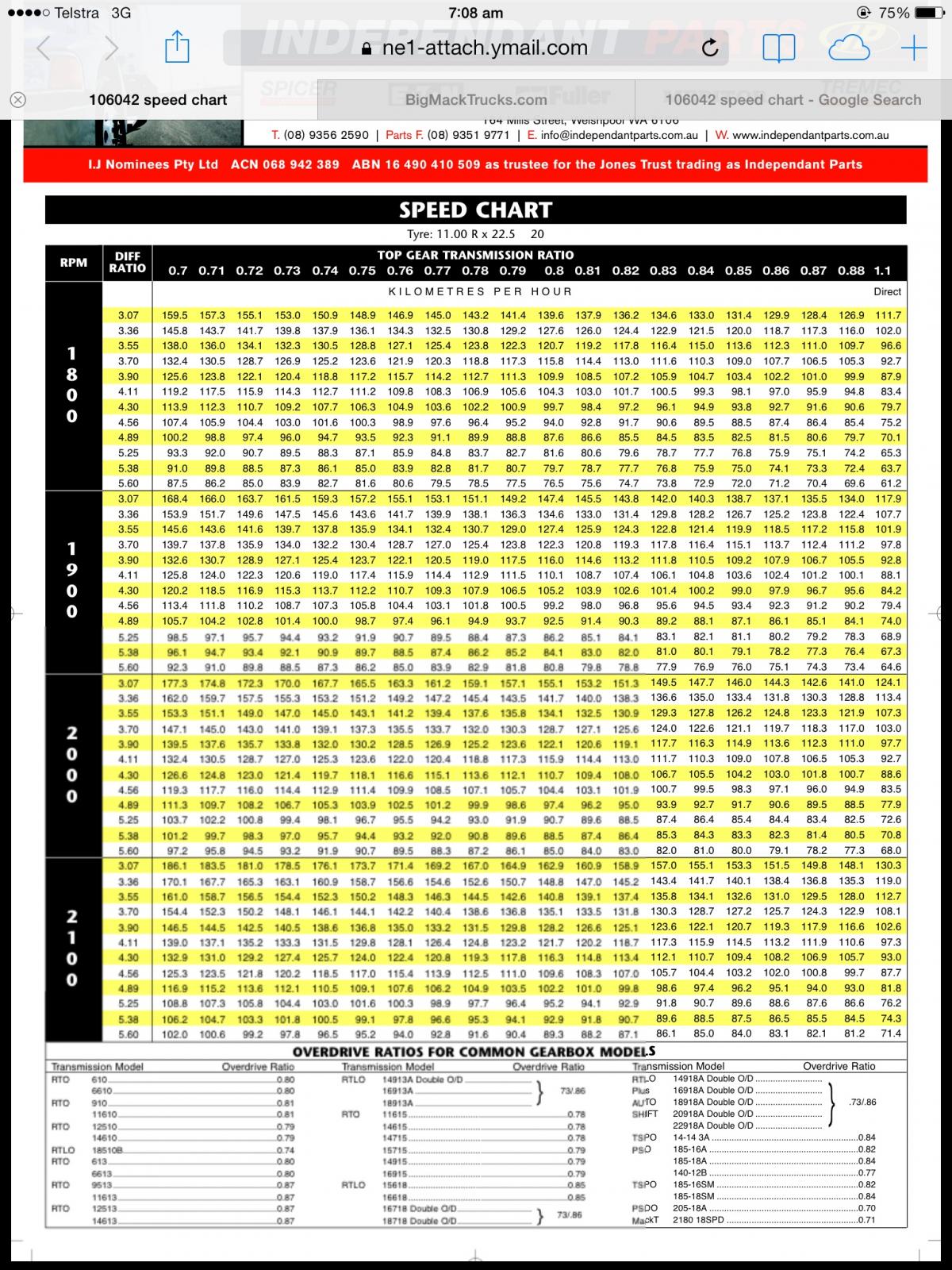

Sorry wrong link, try searching "106042 speed chart"
I'm pretty sure mack rears are different. I've got a chart that you can work out what ratio diffs will work with the ration of your overdrive. My mack 10 speed has an overdrive of .78 so using this chart I can safely assume what ratio I need. https://ne1-attach.ymail.com/au.f1251.mail.yahoo.com/ya/securedownload?fid=Inbox&mid=2_0_0_1_76745_APNoimIAABJjUj%2FehQAAAJSsIA8&pid=2&check_content_type=2&fullscan=1&YY=377702796&appid=YahooMailMobile&cred=9HhWTu6RV17.NmffrfoIlUGUgKU_iolKVY4pNVfFgE6f75s-&ts=1379917991&partner=ymail&sig=MgaDgnrz567b3sl8BEE33A-- Hope that helps mate!
What do you guys think the best cruising rpm is at 60mph? Both for fuel economy and pulling? I've got a 2v 300hp and I can get a cheap rto11613 13 sp single overdrive and 3.9 diffs. This combo should see me sitting at 1800rpm at 60mph (100kmh). What do the e6 engines like to run at?
