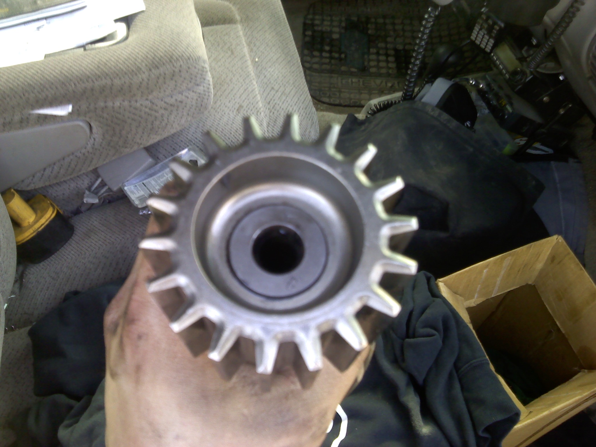

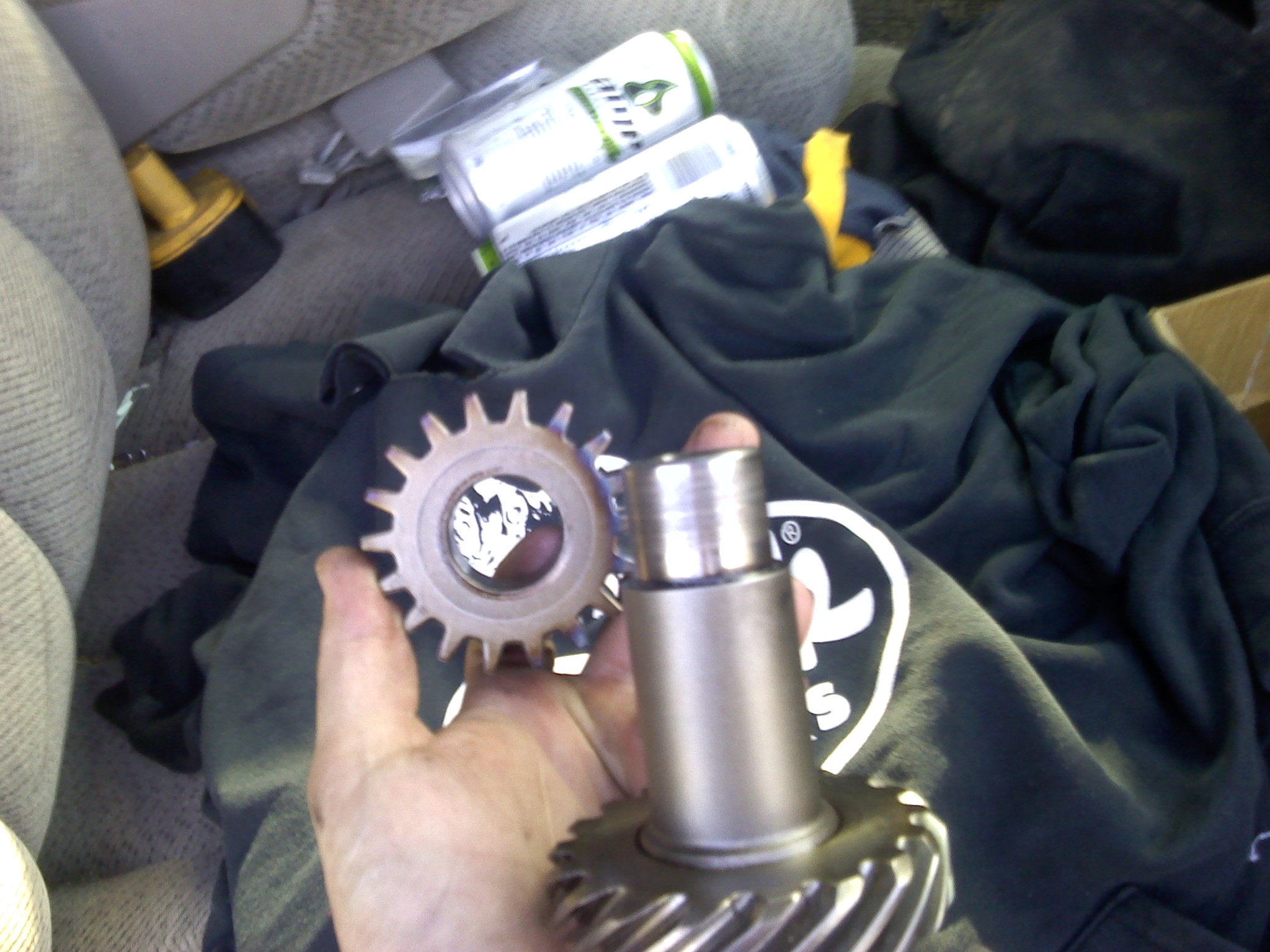

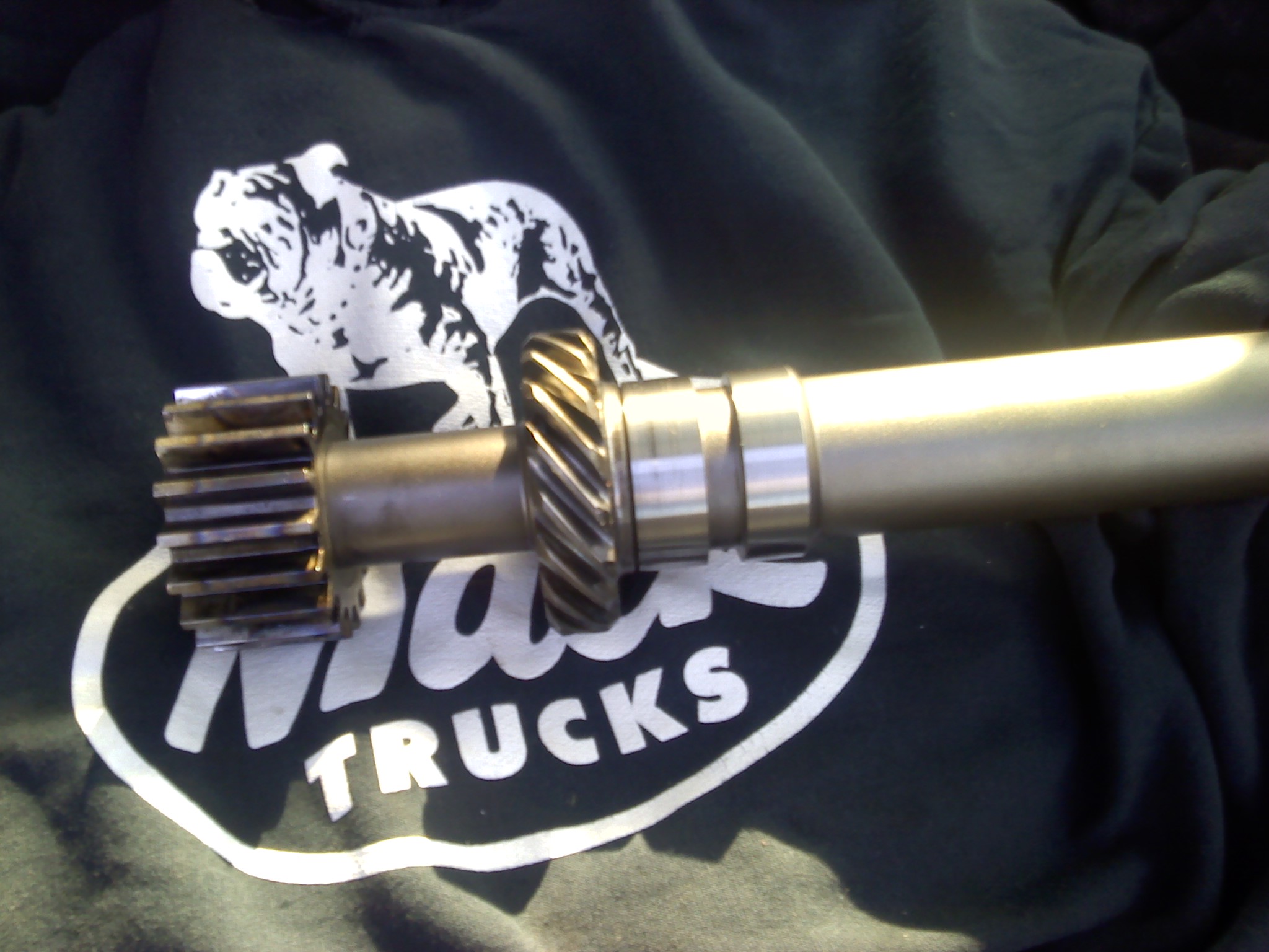

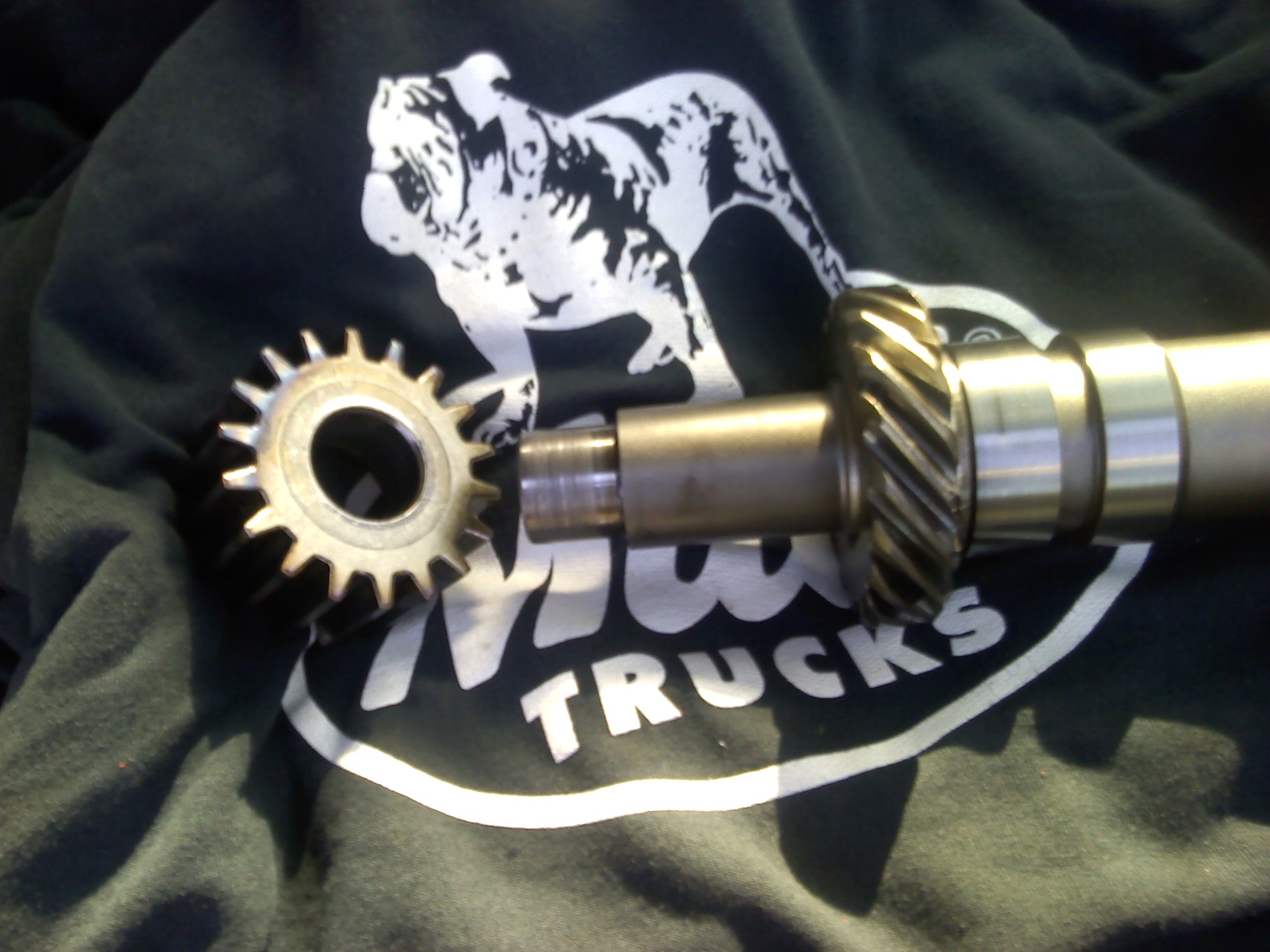

It appears a new oil pump would be needed with this shaft also, based on an issue that these shafts had with oil pump drive gear.. http://hr.mckenzietank.com/maint/Bulletins/45-sb219009.pdf I went ahead and had a keyway machined into it, and plan on using an extreem mating compound to mate the two parts together. There is still a very minor interference fit yet, so i belive this should hold. Im not a huge fan of welding a shaft that hard and tempered. One would think a keyway with a minor interferenc fit, plus the compound to keep the gear from walking off the shaft, and the air compressor coupler is right there, so it cant go anywhere..(i hope)
VIN 072852 - 97 CH613 I wont put a used shaft in for fear of this same scenario. Either way, if i cannot get a new one, i'm going to modify this, or another used one.
So, air compressor quits working the other night. Haul truck home, Did some reading her on BMT, tore into it today, and i have the same issue as gambi80 and others... Press fit shaft on the rear end of shaft has spun on the shaft. Here is the kicker, NO PARTS IN NORTH AMERICA OR WAIT TILL OCTOBER TO MFG MORE!!!! So i propose to you, what is the correct fix now; 1) Weld gear on the end of shaft 2) Half moon key shaft 3) Drill and tap a slot above key for set screw to prevent walking the gear off the end 3) Re-create tolerances like you would on a crankshaft(weld it up, grind it down) 4) Straight keyway 5) (place your idea here) Any combo of the above?
