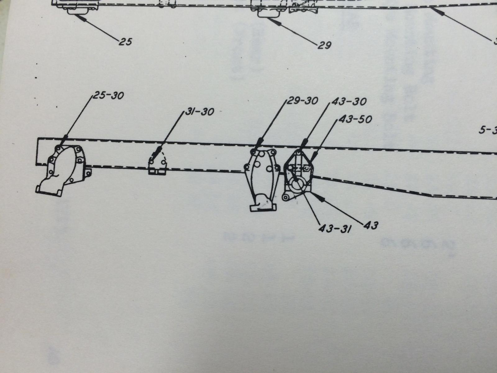

fifth wheel replied to 41chevy's topic in Antique and Classic Mack Trucks General Discussion

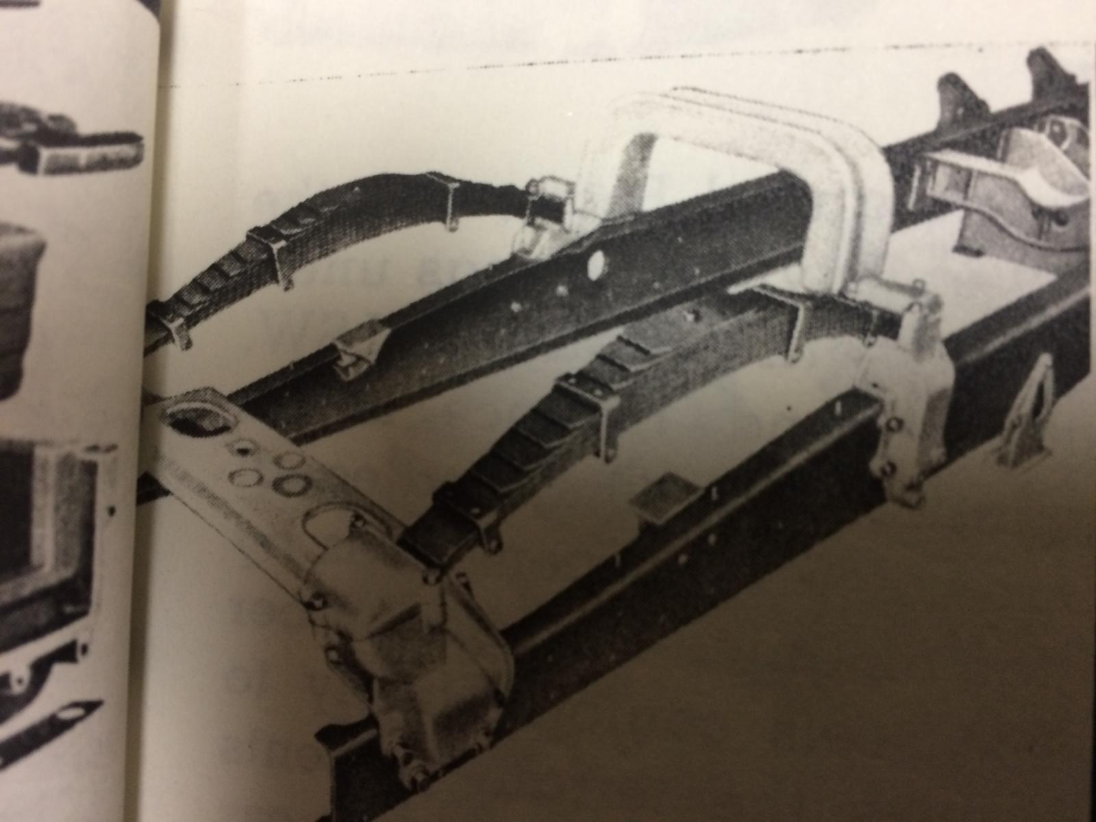

The early trucks, all 3 axle had a different frame design than the later trucks,(LTSW.LTLSW,LTLT,LTHSW, LTHT? don't think there was one. The difference is the web tapers up starting behind the front rear spring hangers and the later trucks the taper starts between the front hangers. The steering shaft passes below the flange, I have one and seen others with a factory inside channel from over the center of axle back to the about 3' past the rear hanger, and the rear hangers are unique to this design. From what I have seen and recorded at least 200 units were built this way ,assuming all LTSW's. The later design, taper over the axle, is on LTSW # 1482 has it , and all LTLSW's, and LTLT's. LTSW's had either 1/4" or 5/16" frames, I believe all LTH's had 5/16", and LTL's 1/4". All trucks have the same front spring hangers ( steel or aluminum depending on the model), the rear hangers on the early (steel), different from the later (steel, aluminum), and the LTH's have (steel) and I have seen some shorter in height. All trucks have the same length springs, different number of leaves 12/14 depending model and mfg of spring. I have been looking at and under every LT for the past 26 years gathering information etc., but still find something new and different. FW -

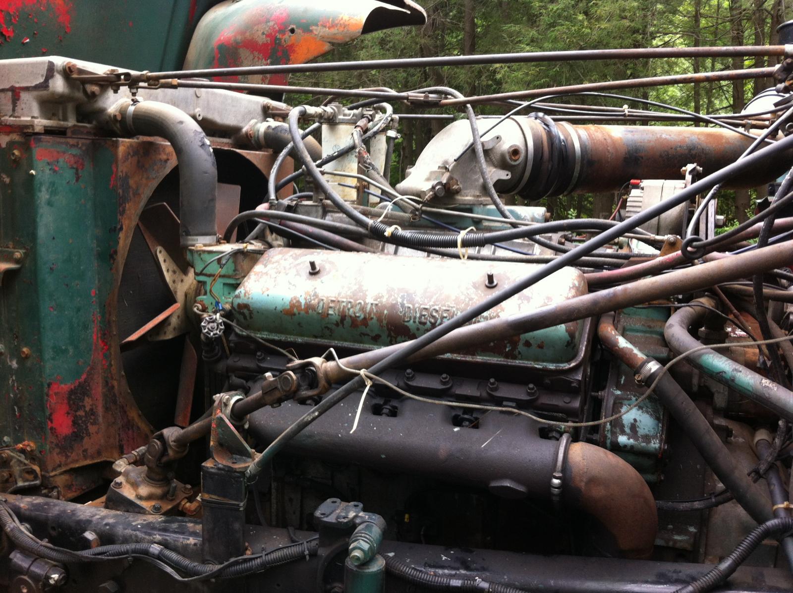

I can see Hall Scott and IH parts -

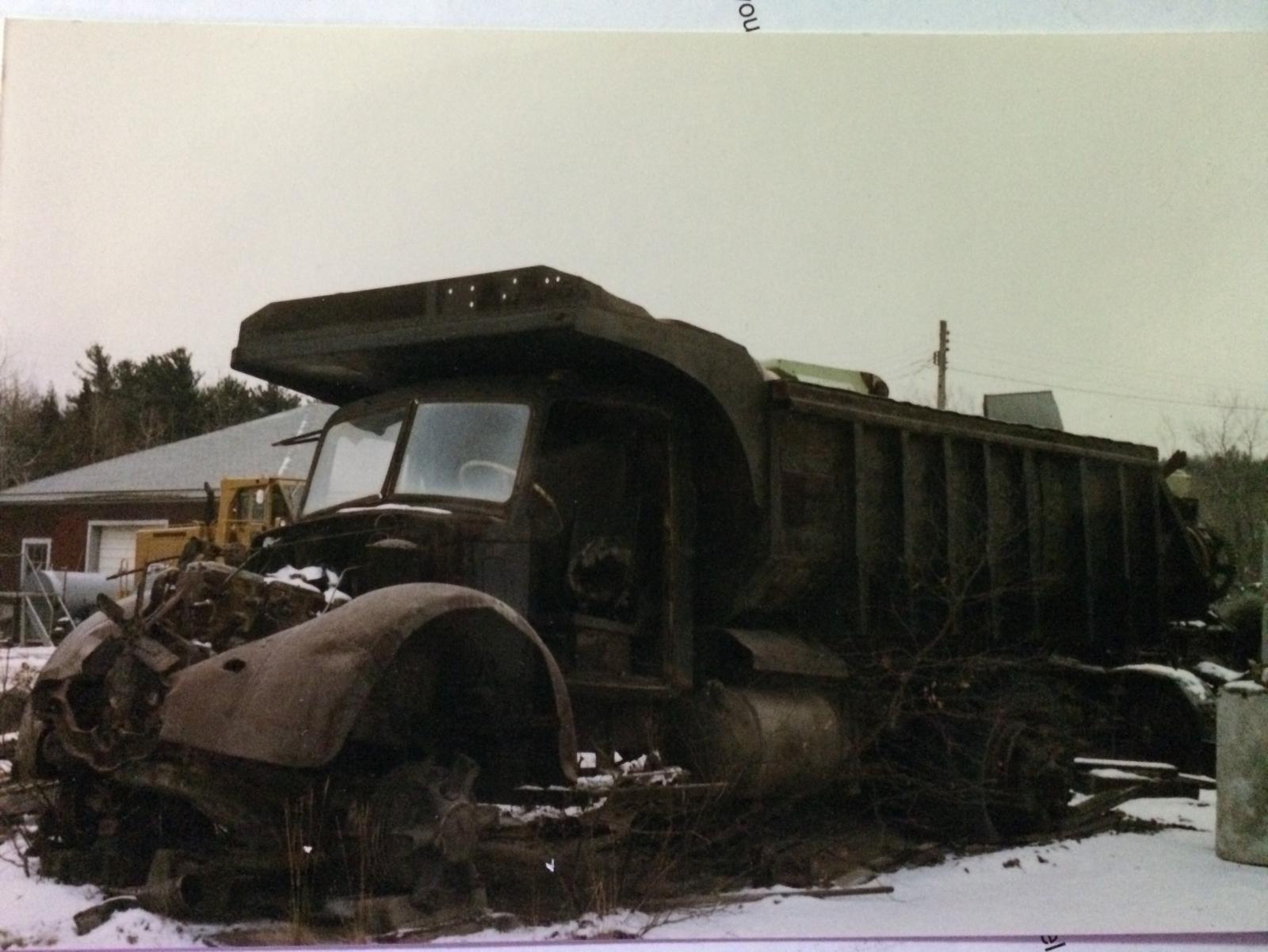

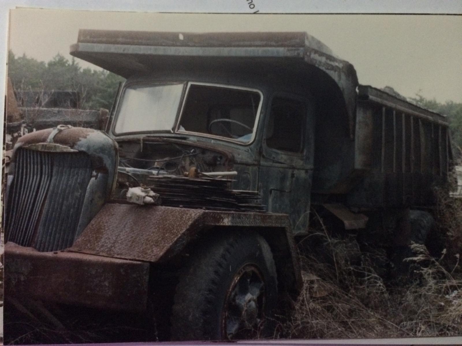

1949 Mack FT
fifth wheel replied to j hancock's topic in Antique and Classic Mack Trucks General Discussion
they are not "F"'s but L's with unusual specs, one of five built in 8/47, HB cummins power, factory reinforced frame, Mack shaft drive with 8 spoke hubs, 14x24 wheels/tires, 12x24 fronts, sheet metal radiator shell and LJ fenders. Garwood quarry body. The unit with the shop made fenders should be one of the five trucks as they at one time both belonged to a local quarry. I have one and the other was in Connecticut, at Yarworski's a few years ago. New in the Bronx, then Brooklyn NY, then Massachusetts. FW -

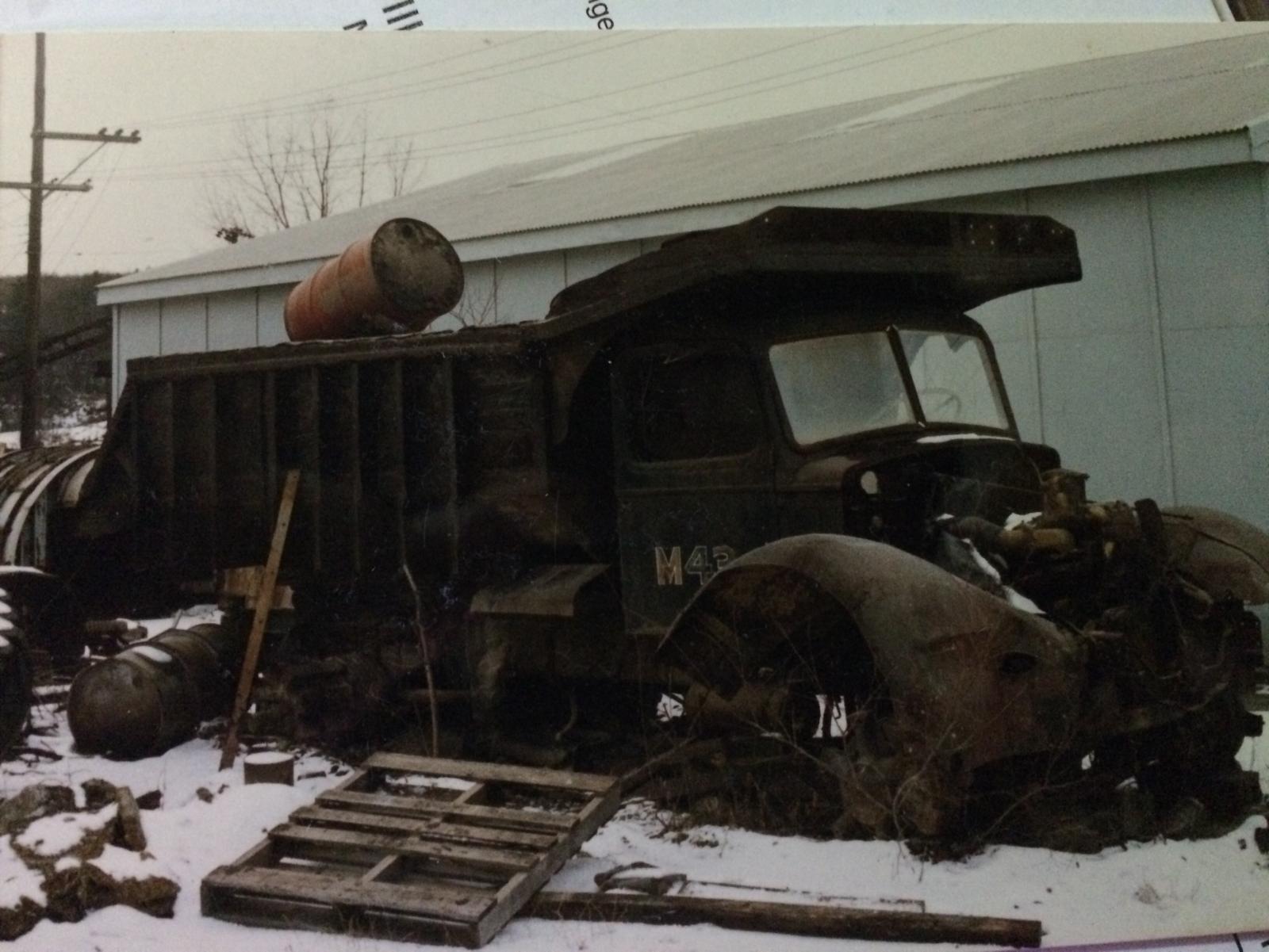

Here is a picture of the truck I took about 10 years ago, and drove it in the yard. When I was in Ogden UT in 1977 I have a picture of one of the trucks curbside, its on 35mm slide, will post but be awhile. FW

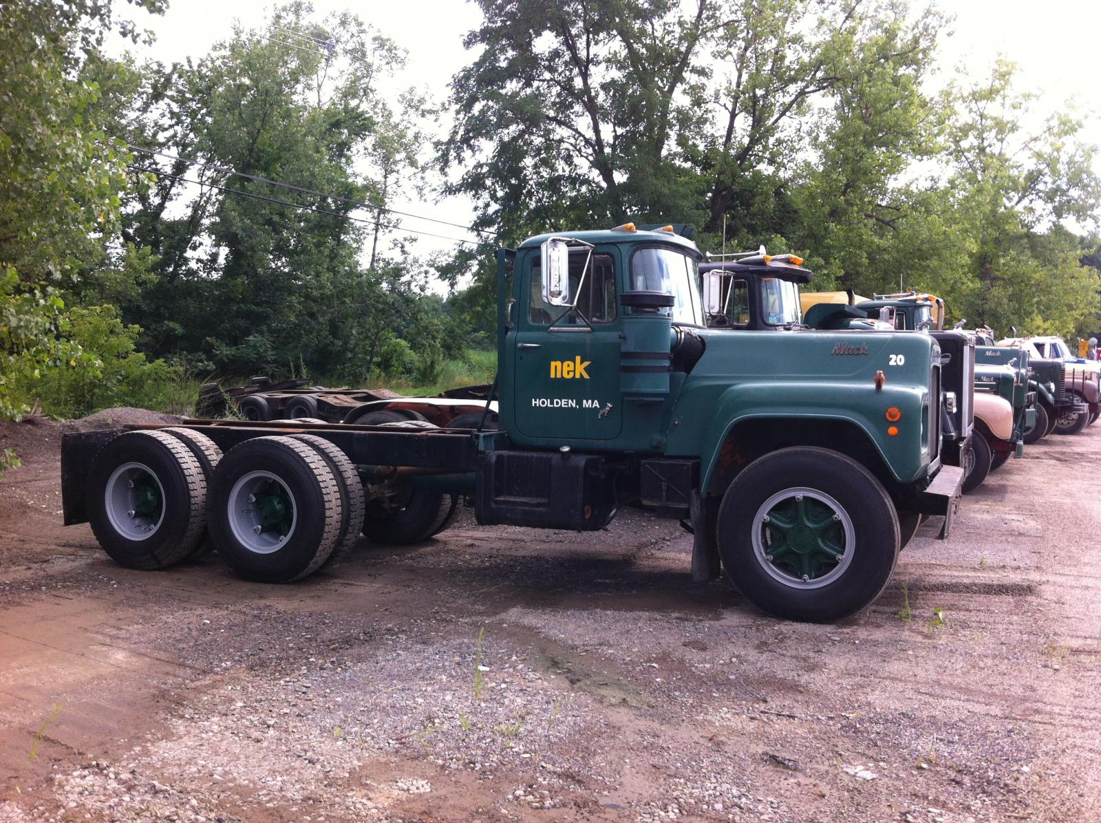

When at a trade show in Las Vegas I also toured the Bolder Dam, at that time you could tour the facility. The driver of these also was on the tour and probably en route from Hayward CA to points east. The paint schemes on the western trucks different from the plain colors on the eastern trucks. All bias tube type tires, January 1980 (nek photo). FW -
The western trucks have the straight frames of standard width (34"?) to accommodate vendor suspensions and axles, My RS has Mack engine, trans and rears on Hendrickson block and Rockwell front axle. FW
