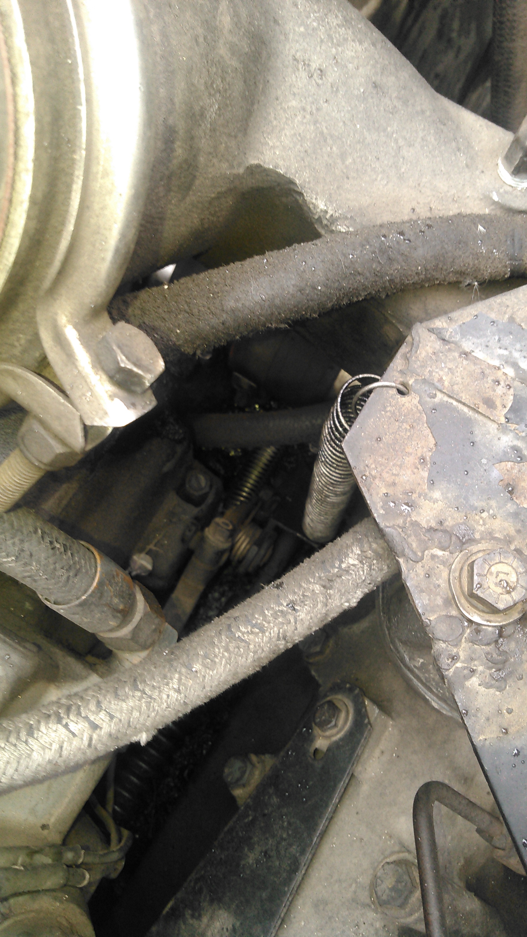

  18. Yes, the horizontal tab is on the valley pan, Your picture is the one for the vertical spring but I'm not sure which direction it should face since mine are broke off. But I can't see it being straight out since it won't have much strength. If you would want a stiffer pedal, you could move it up to the upper hole.
  19. The top tab broke off at one point as you can see only part of it remains, I just drilled a hole next to it and the other spring is below.
  20. Both of mine have two springs. One goes straight back to a tab next to the turbo and the other goes straight up to a tab welded onto the bracket that holds the power steering reservoir.
