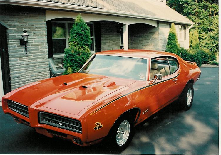

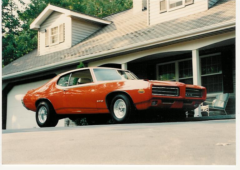

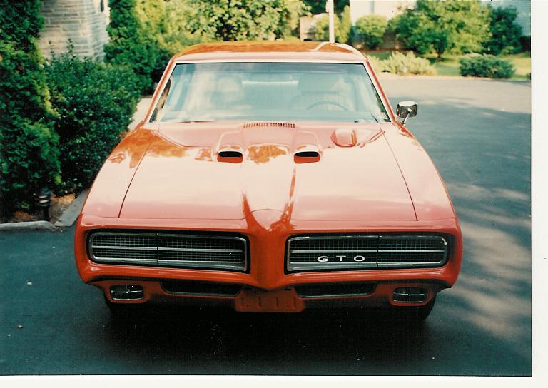

  7. This is my Judge that I bought in High school in 1979. Still have it today. 68,000 miles. Ram air III, 4 speed. I remember buying it and thought to myself, wow I'm buying an old car, it's 10 years old. Paid $200.00 for it, and had a hard time coming up with it. I guess that was a good investment!
