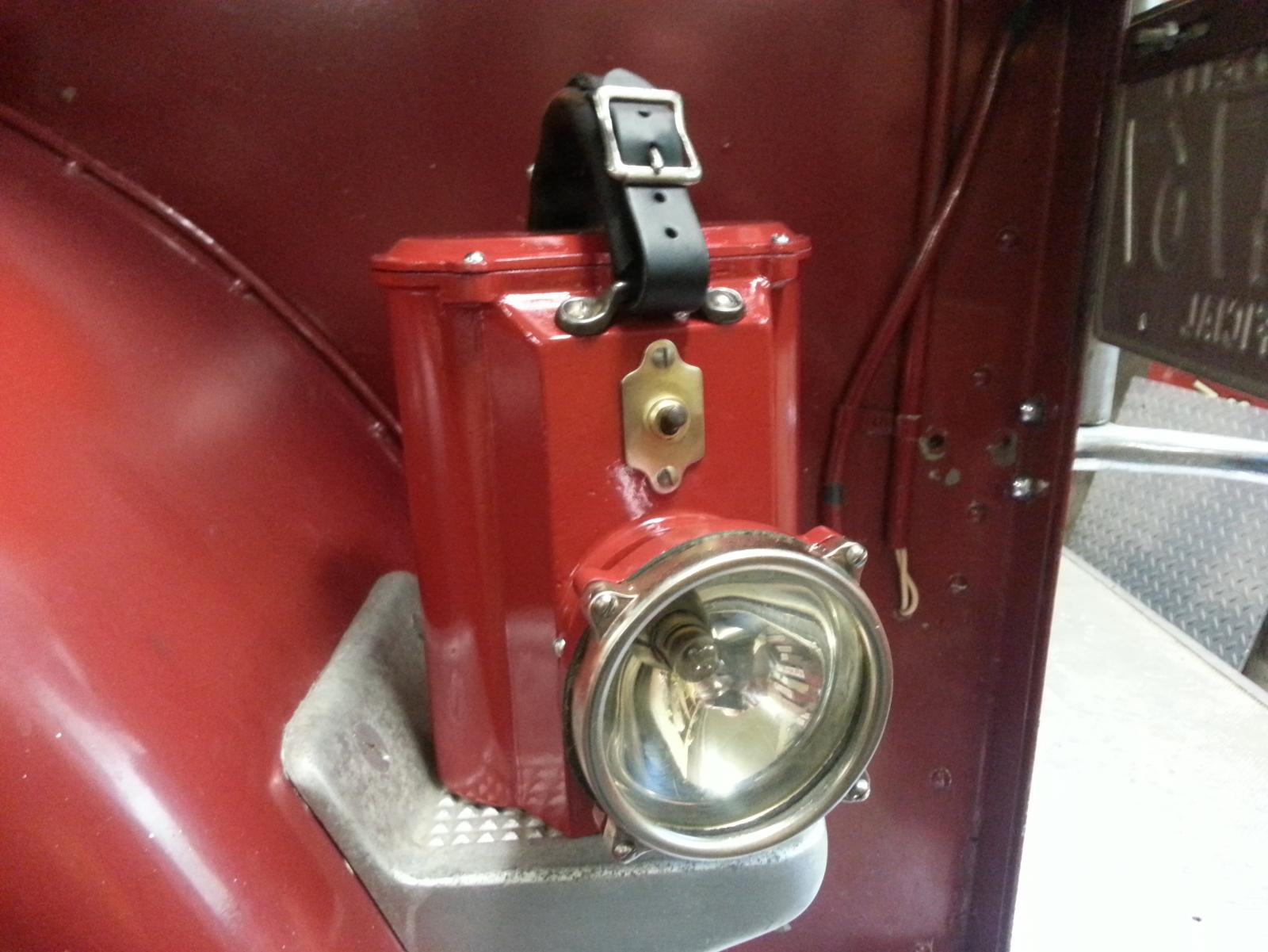

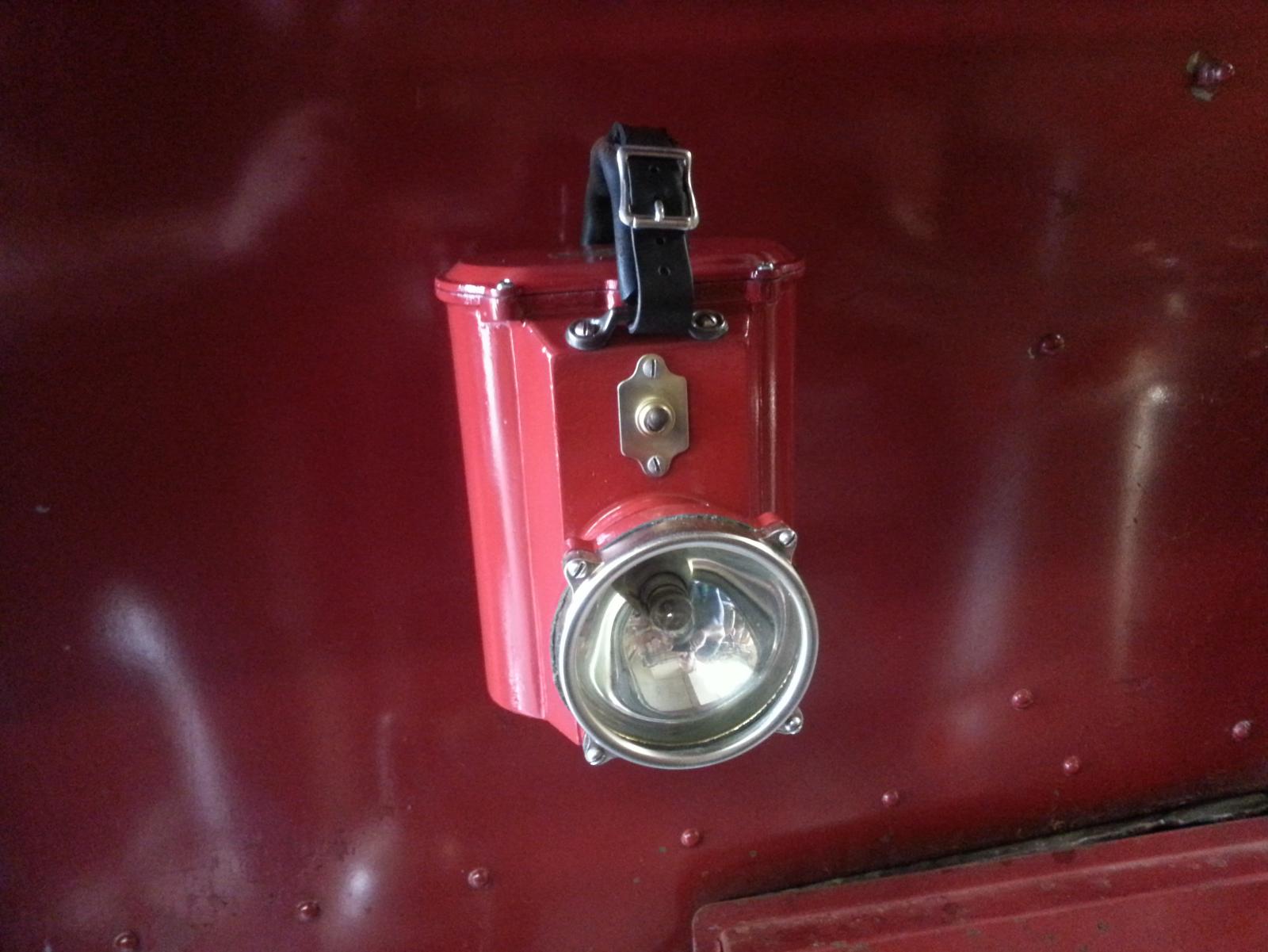

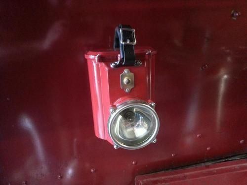

  11. I ended up buying one from ETSY. Generally Called a battle Lantern. Here is our refurbished version.

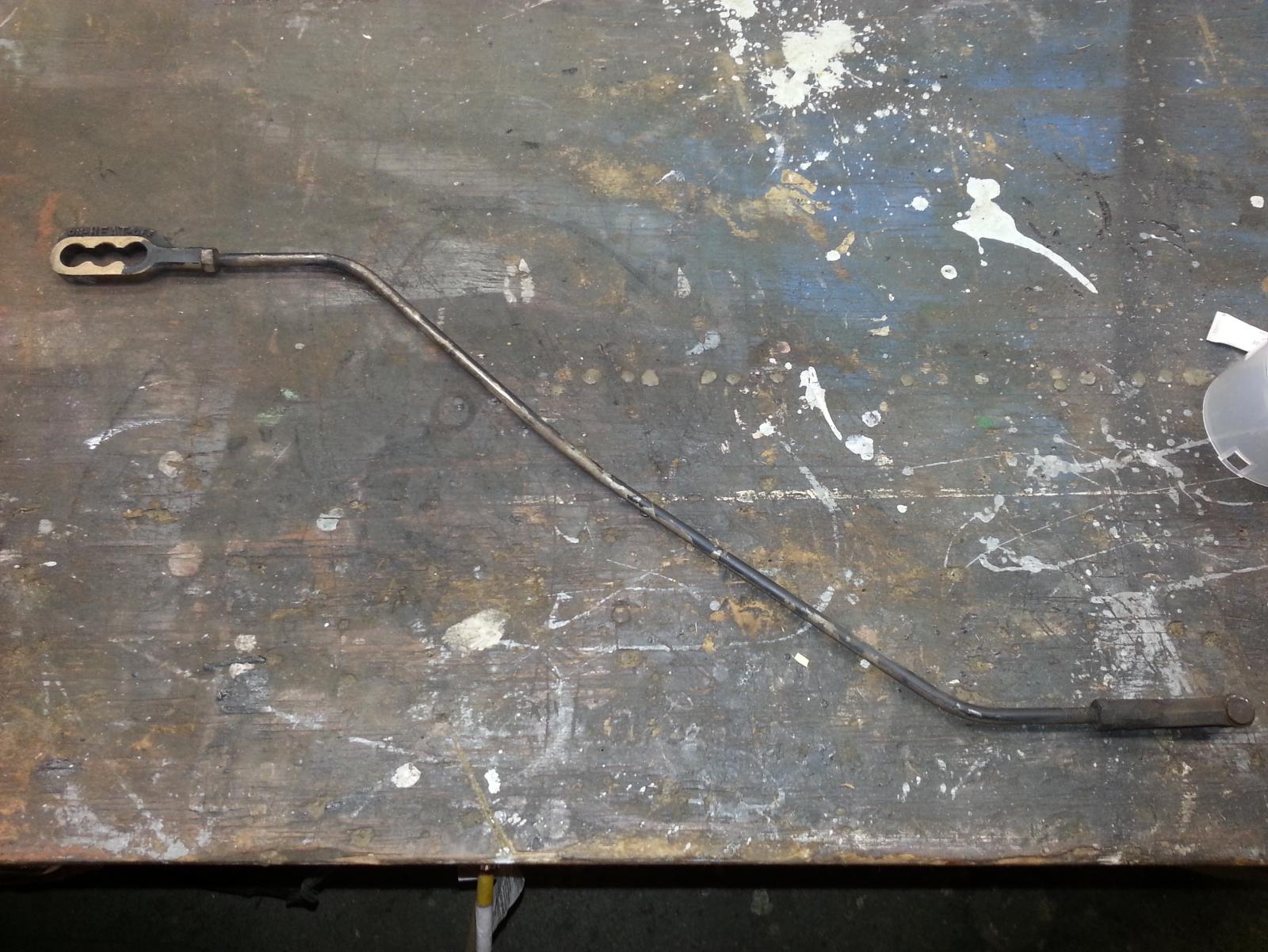

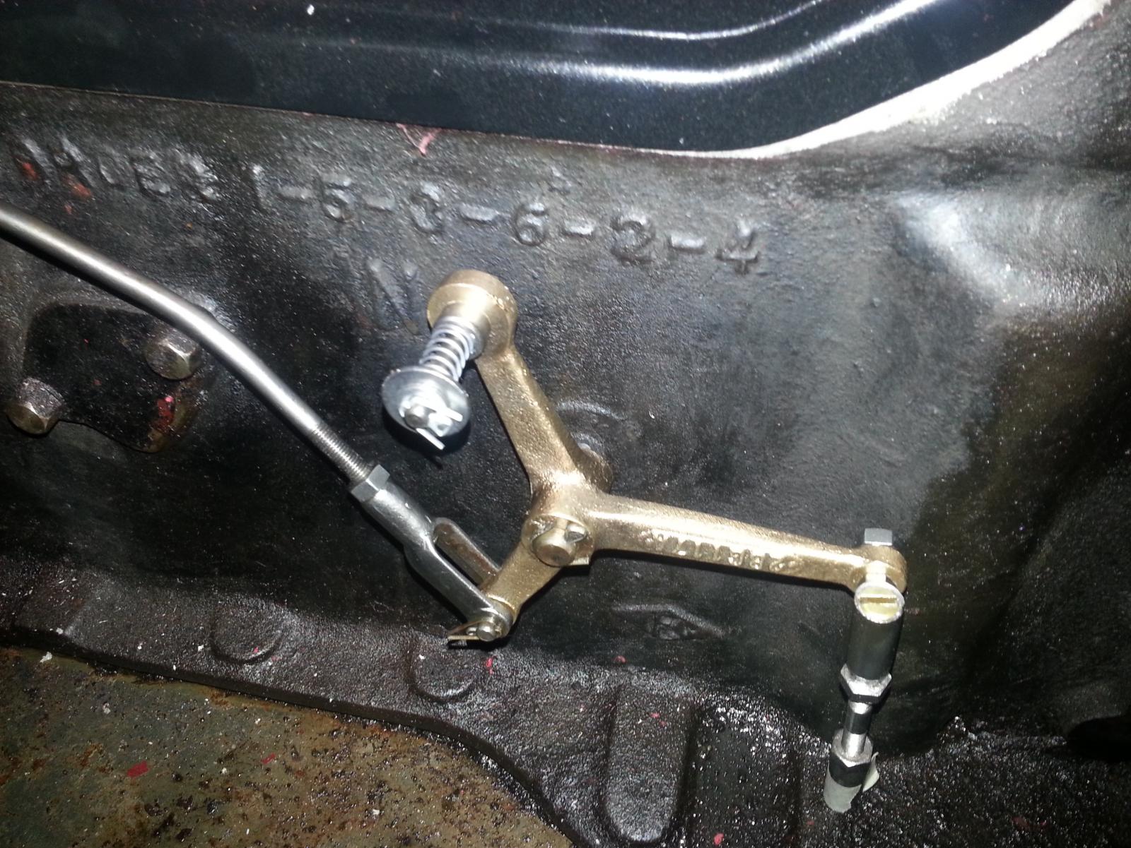

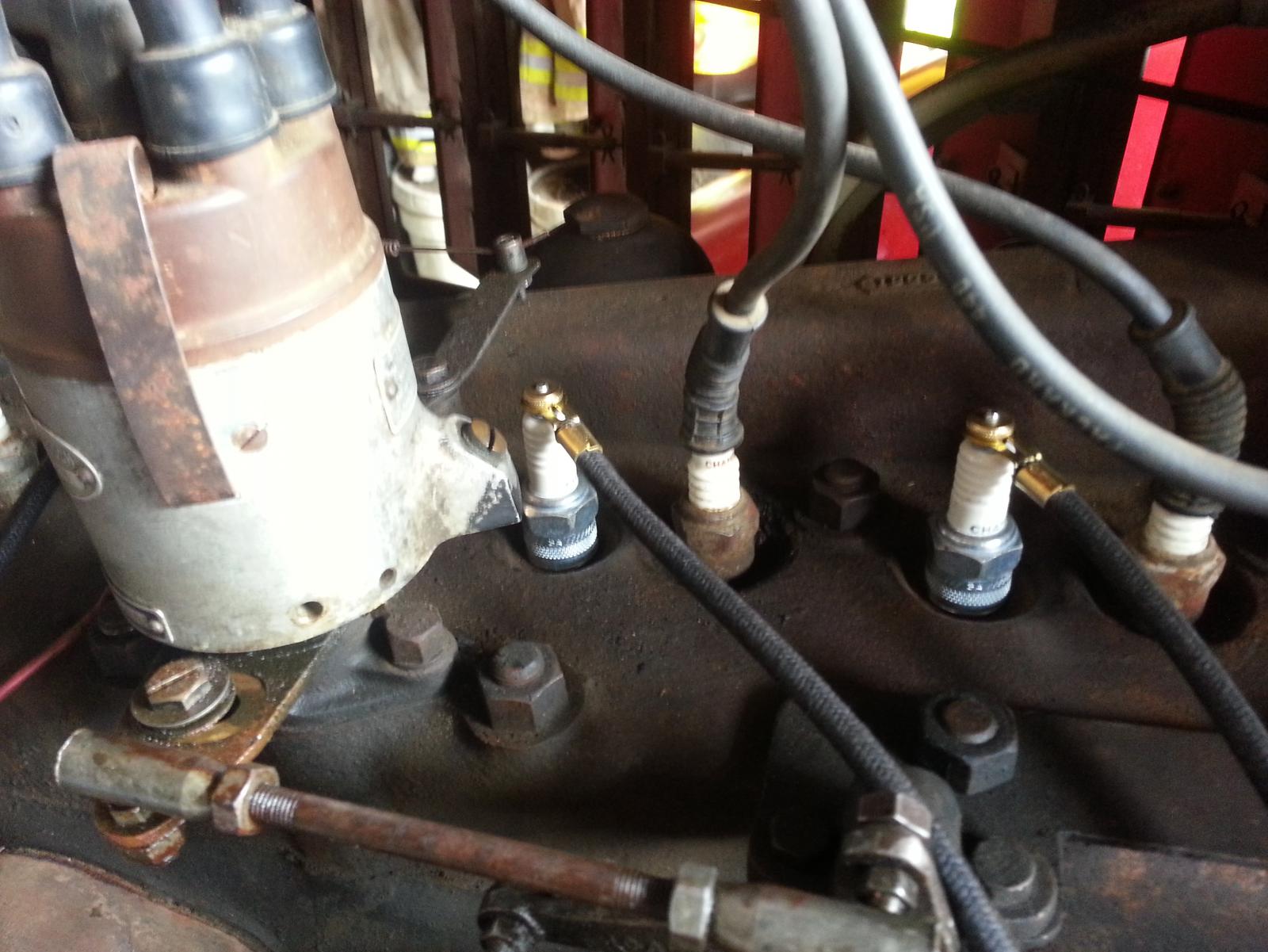

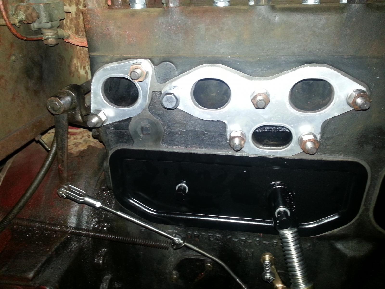

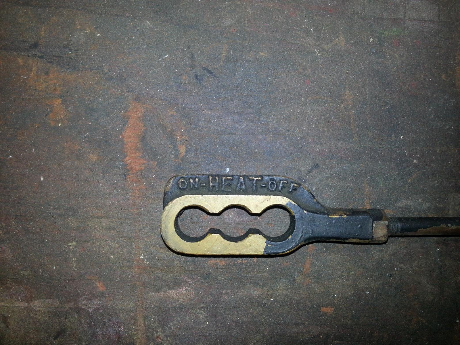

  12. I wrote this some time ago wih no response, but still hopeful someone might have an answer. This rod was connected to the exhaust manifold, which when moved would pre-heat the gas/air mix in the intake manifold. Does anyone know where the other end would have gone? The only place I can find that might work would be onto the throttle linkage, but that seems obsurd to me. If anyone has any knowledge of this system, please let me know. Thanks again for everyone intelligence and help getting the old girl up to snuff!
  13. Here is another question to all the Mack Folks, This is a rod that connects at one end to the exhaust manifold for the pre-heater baffle, redirecting exhust gases into the intake. The other end has been detached, and letting the rod flop around inside the engine compartment for as long as anyone can recall. Where does the other end attach to that indicates "On-Heat-Off"? The only place I can think of is on this brass piece of the accelerator linkage where this spring is. But really to the accelorator linkage?

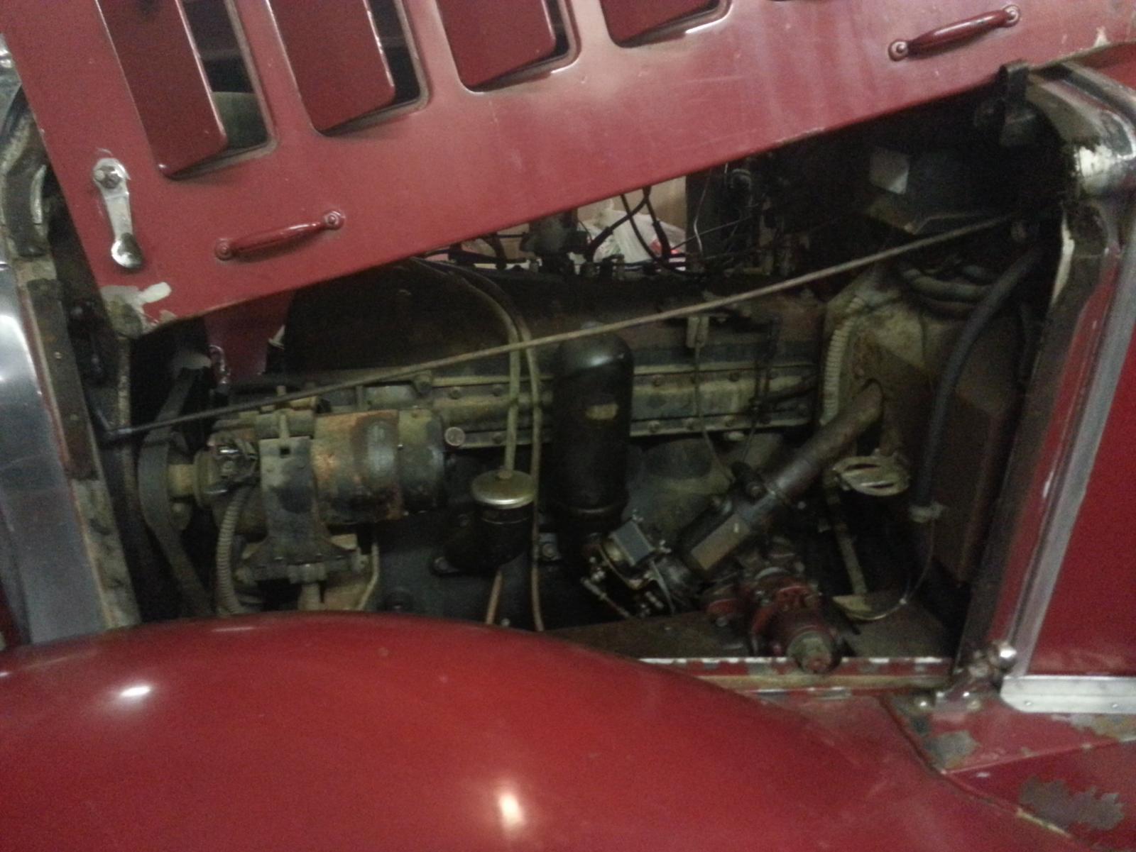

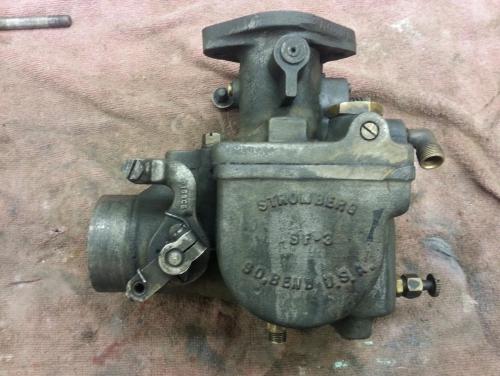

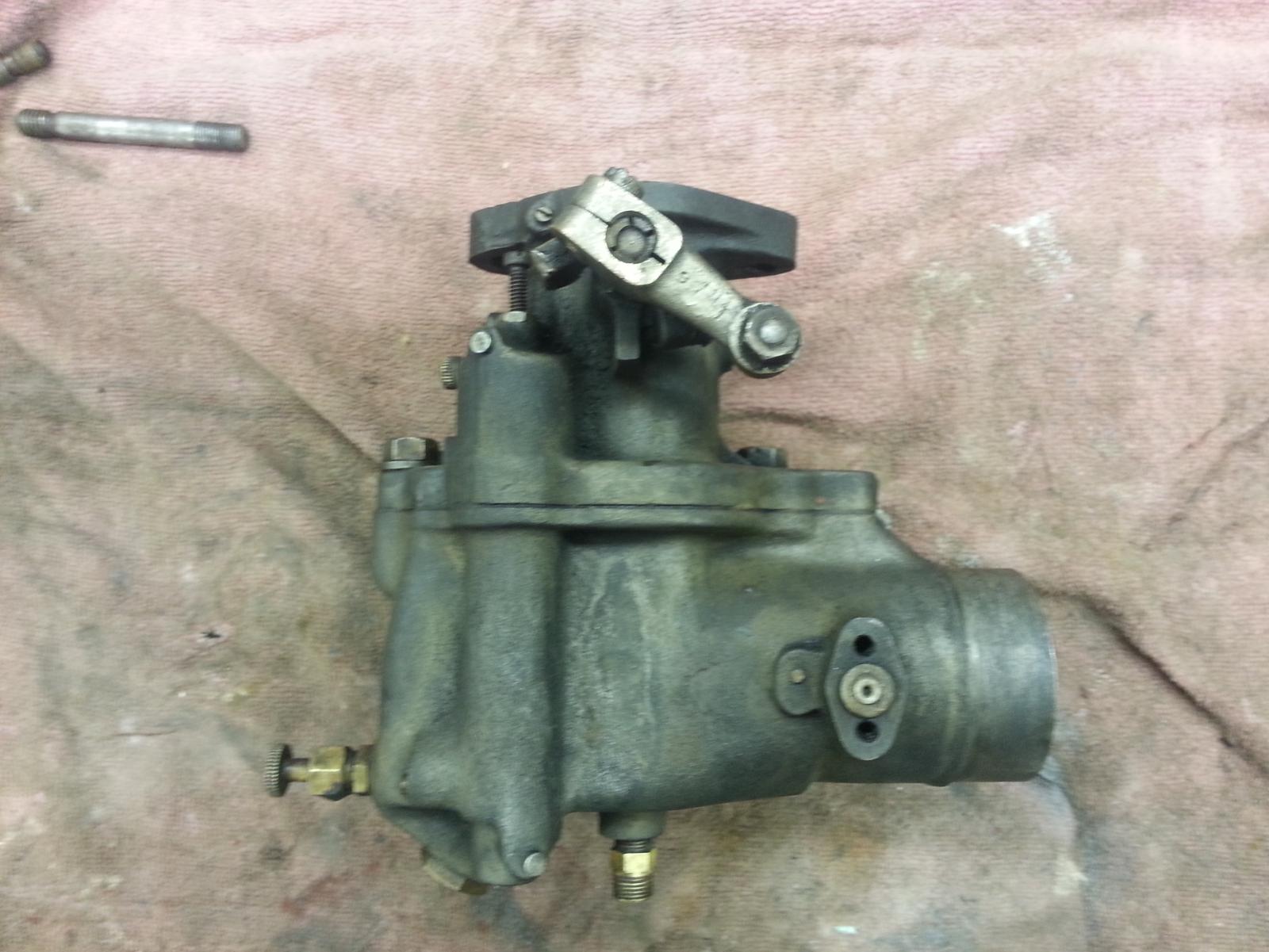

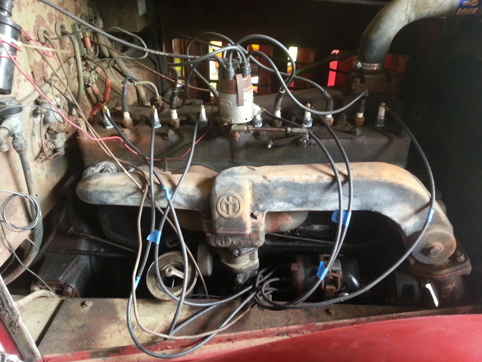

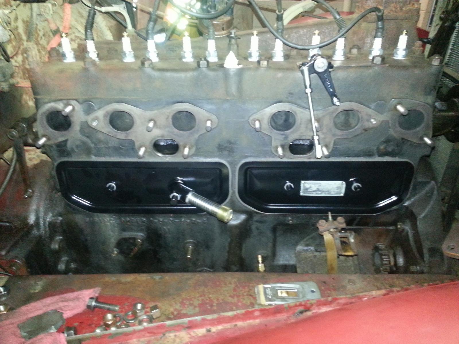

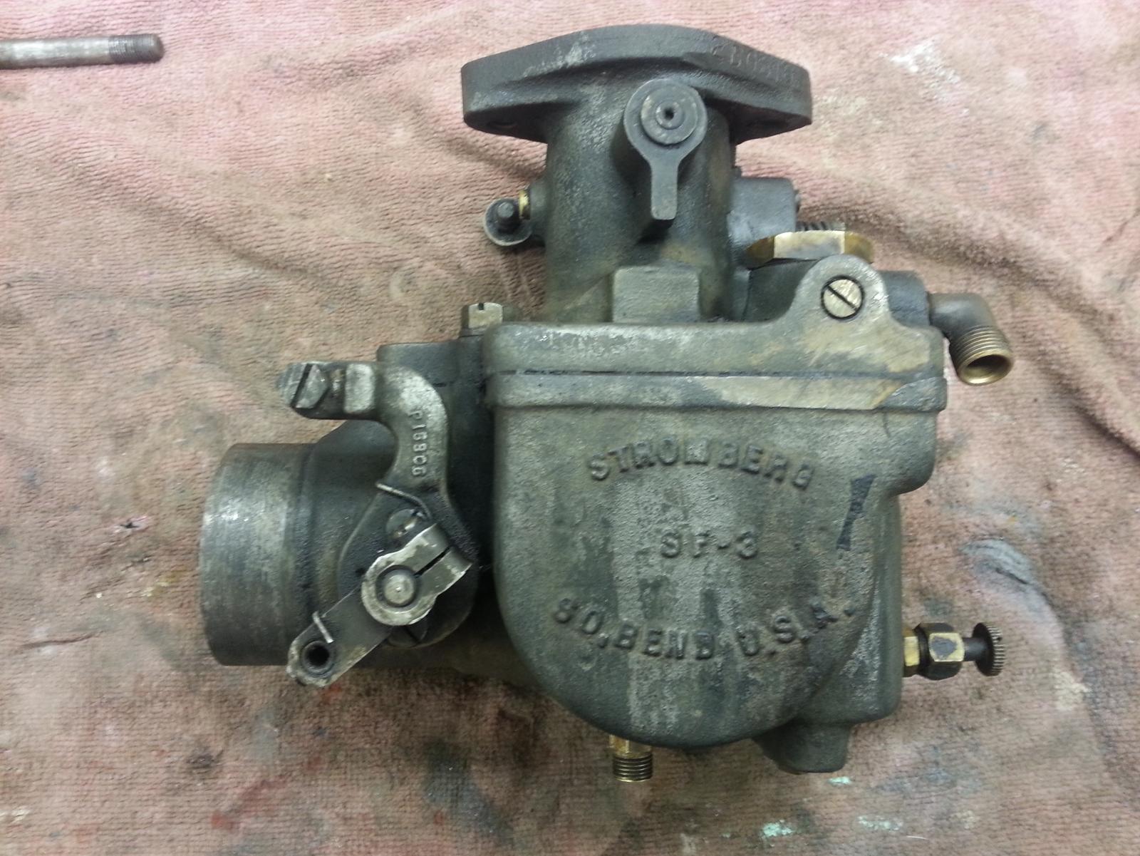

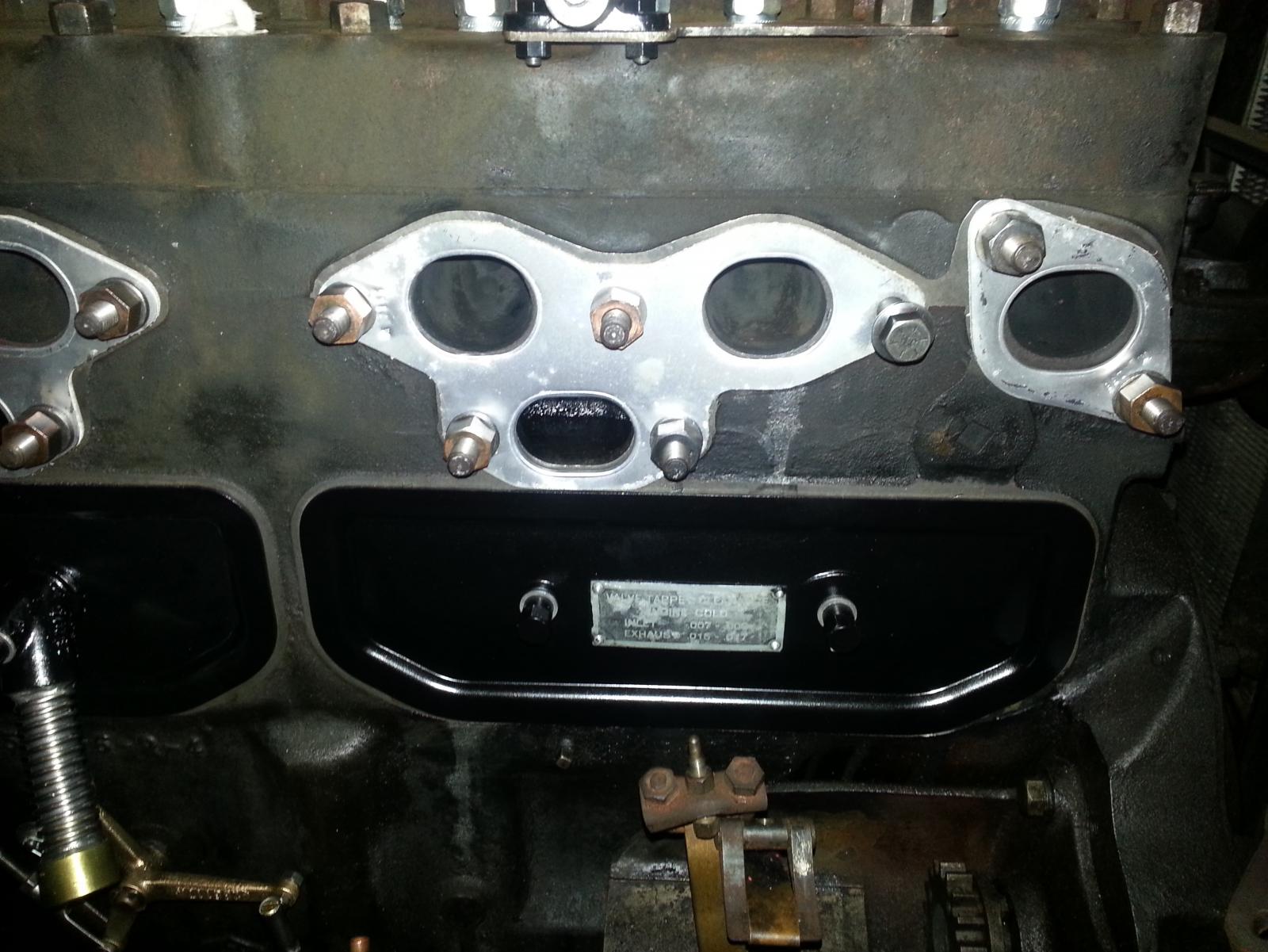

  15. Well I have not posted in a while and I thought I should provide an update. A few of us have taken off the exhaust and intake manifolds. They are currently at the welder being repaired for cracks and broken flanges. Attached are some pictures of the current state of the engine compartment. I am starting to put it back together with all parts cleaned and painted. The carburetor is all cleaned up nice inside and out. Thankfully we were able to save the old gasket, since trying to find rebuild kit for a Stromberg SF-3 does not exist. The gaskets from Olsen's came in and we ready for the manifolds! I will post some pictures of the completed carburator later. I figured I should put pictures up since not to often someone posts pictures of what is under the hood.

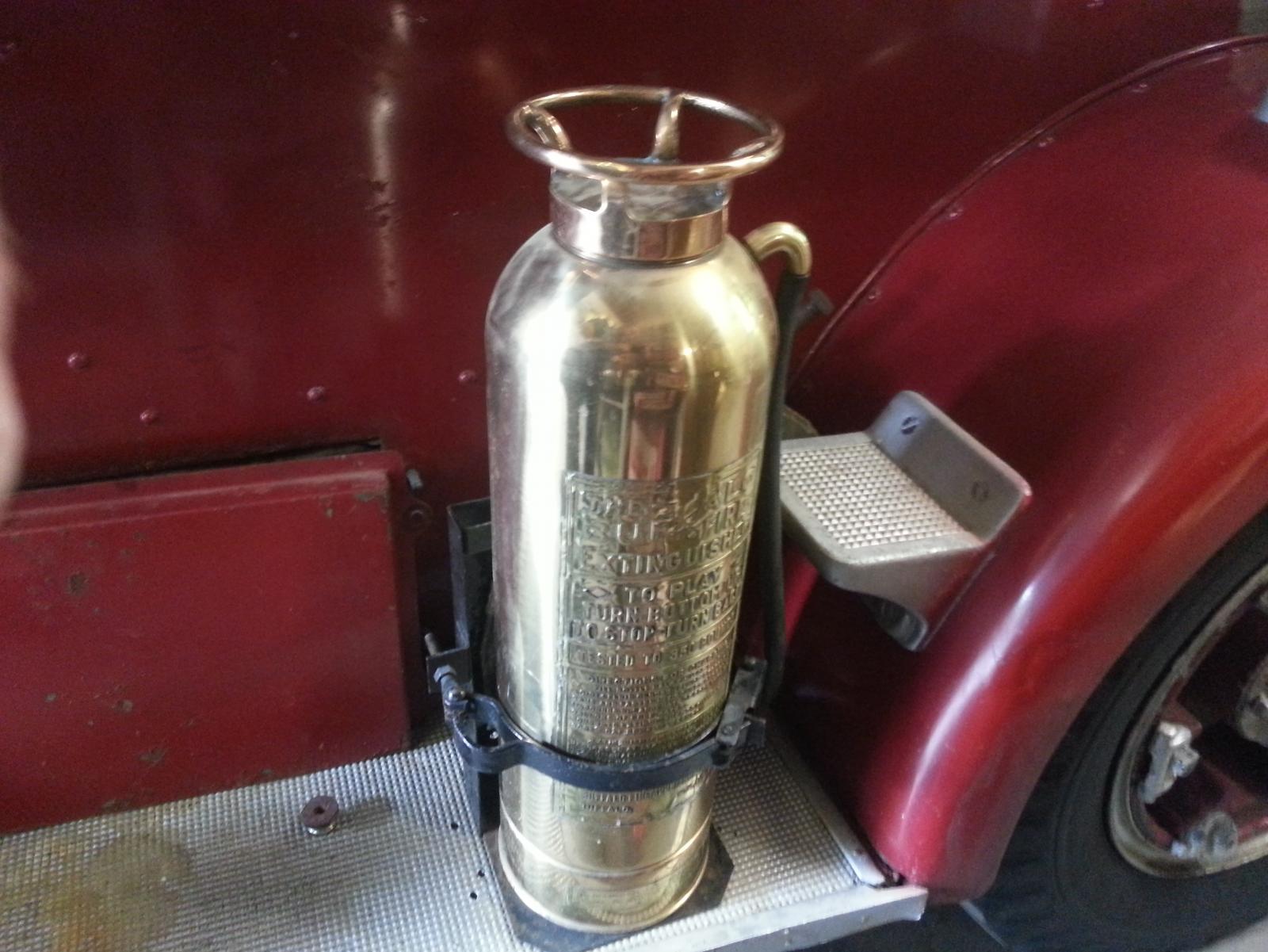

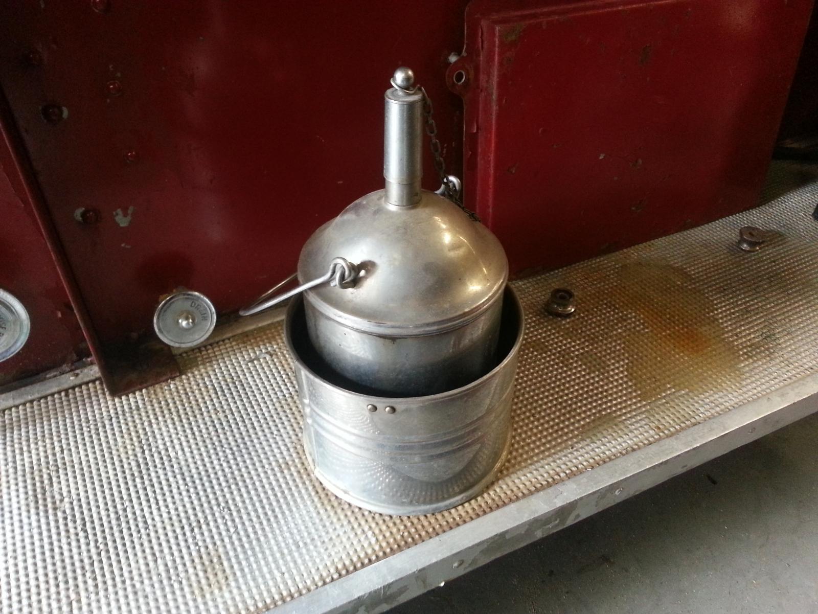

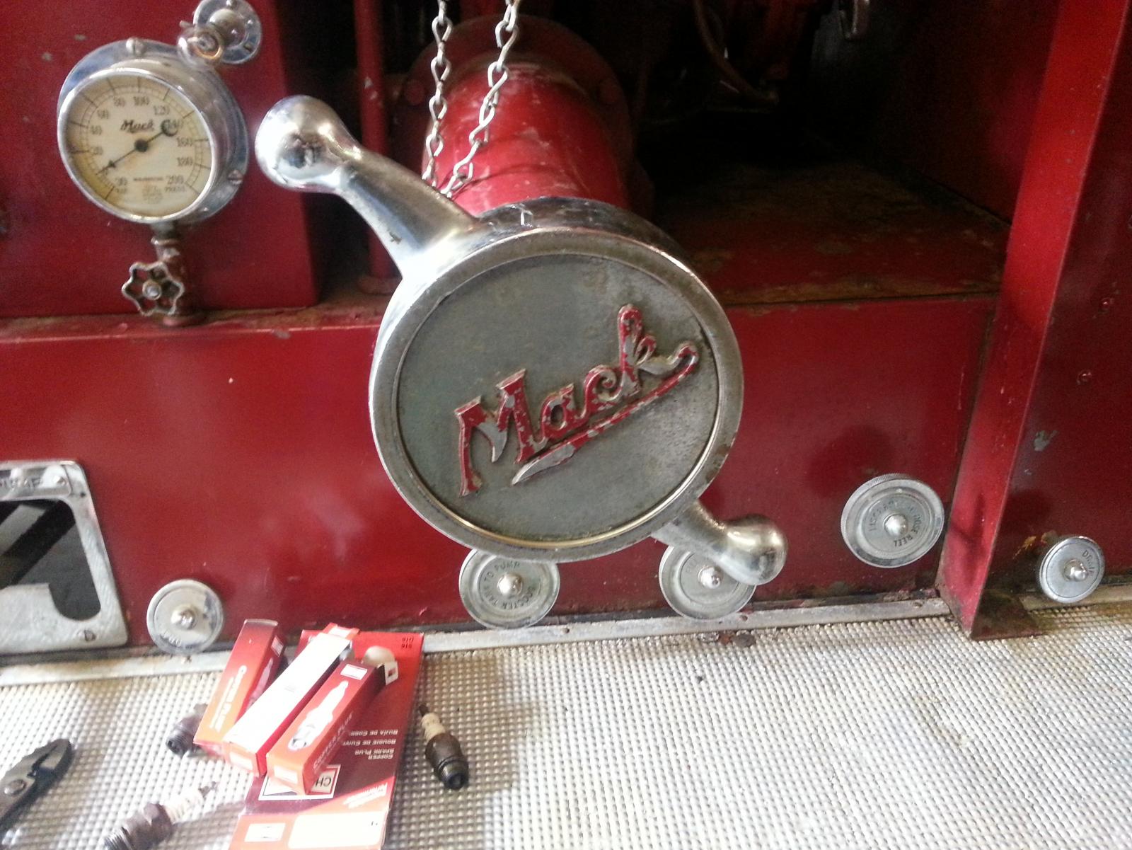

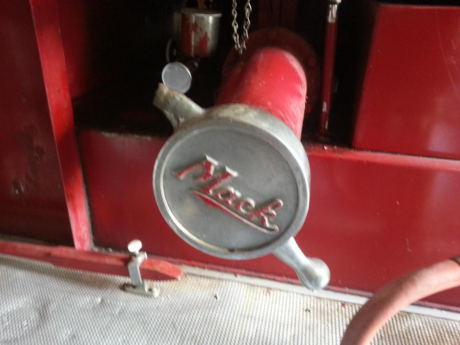

  17. As promised, here are more pictures of the Mack. We have installed the magneto and it runs good on that system alone. The electric lantern came in. I gave it a good cleaning and a new coat of paint. Tooled new leather straps for the leather handle since it was well beyond repair. Have two B7 type batteries coming form Interstate Battery next week. I have also included images of the pump suction caps. you can see that one of the handles is gone. The oil bucket is there and a extinguisher. Sadly not one of the originals.
