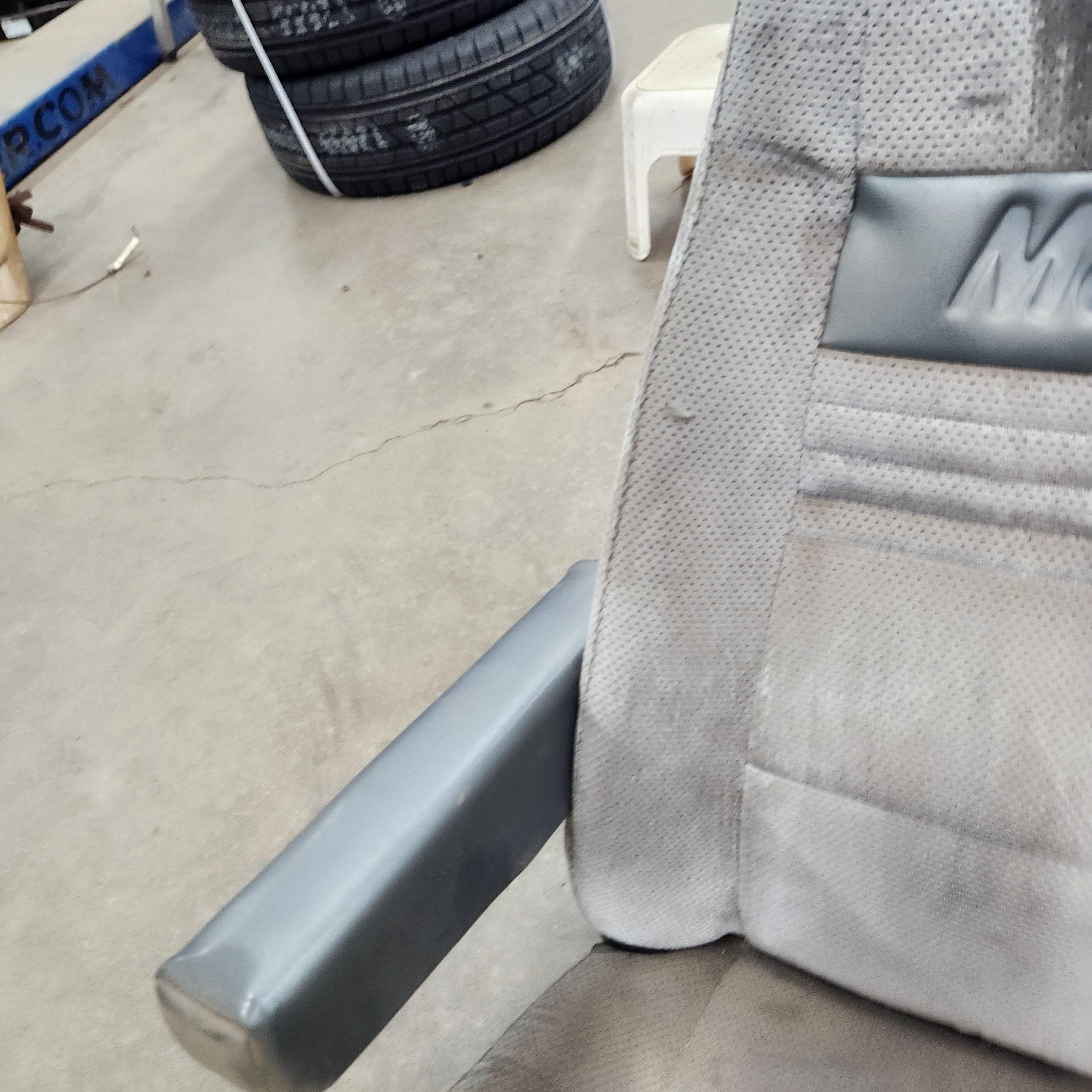

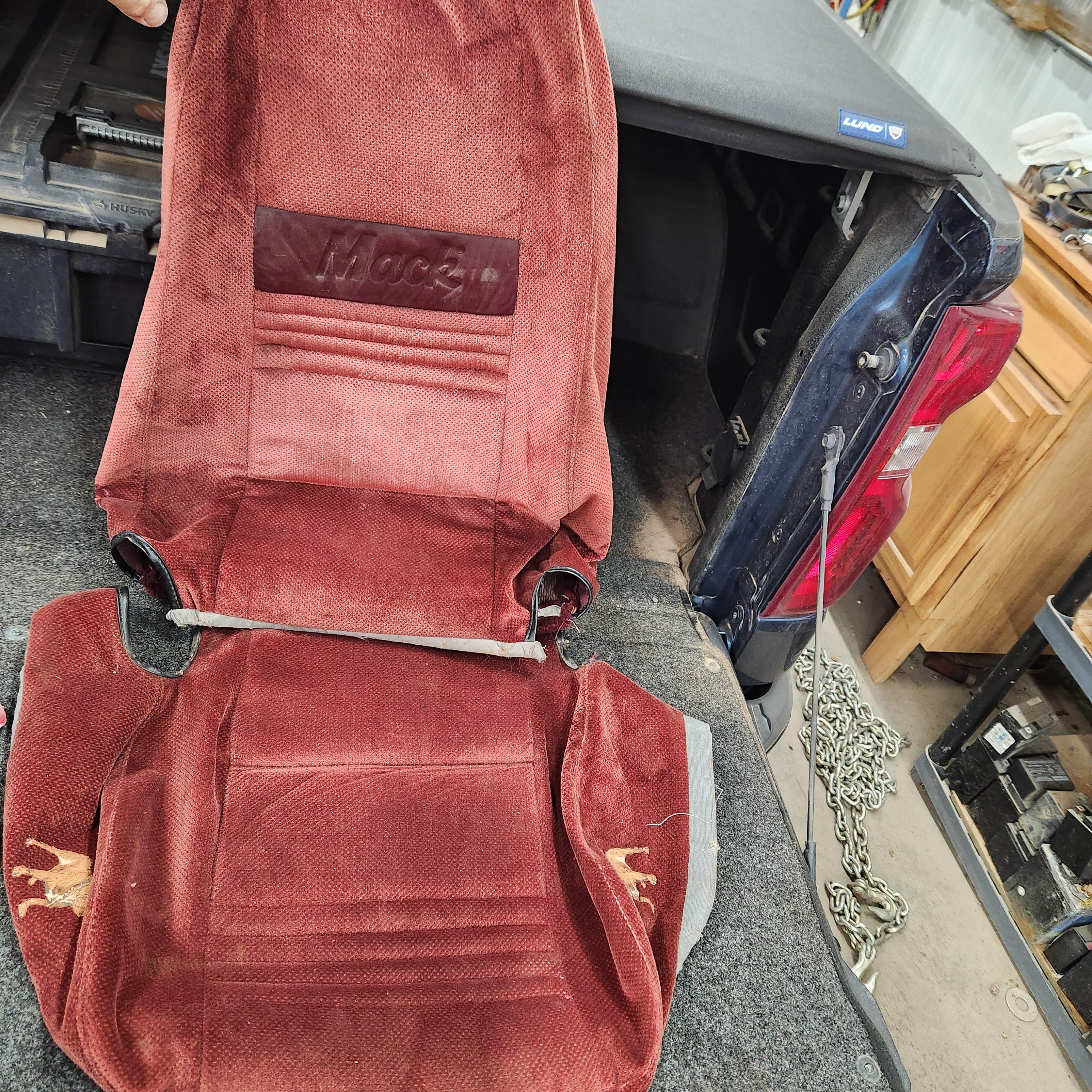

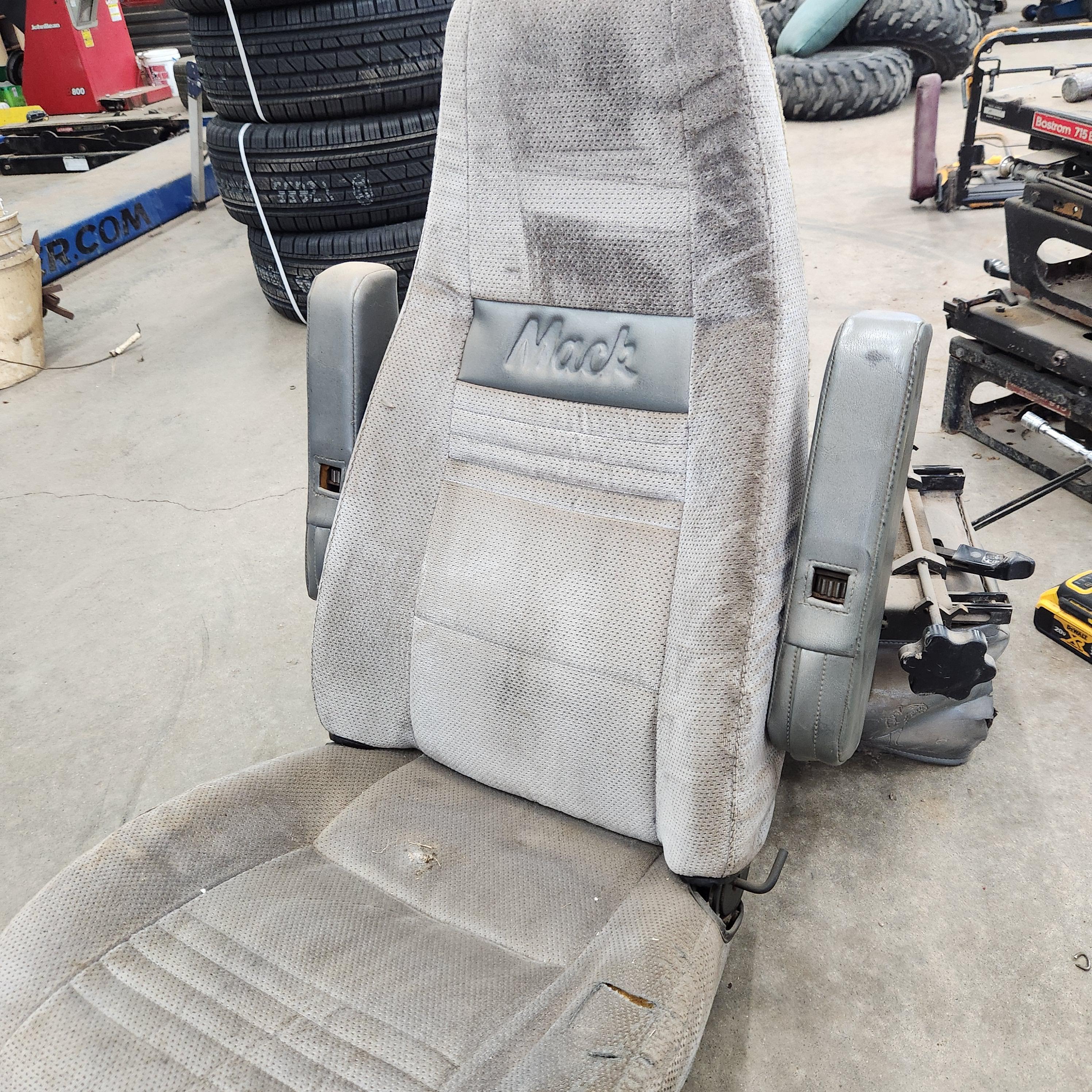

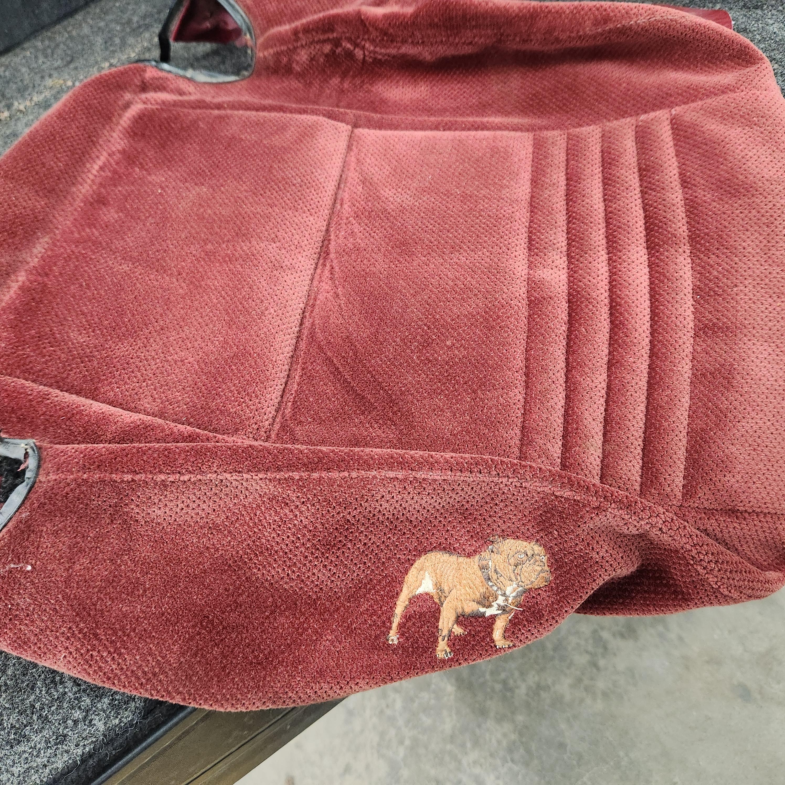

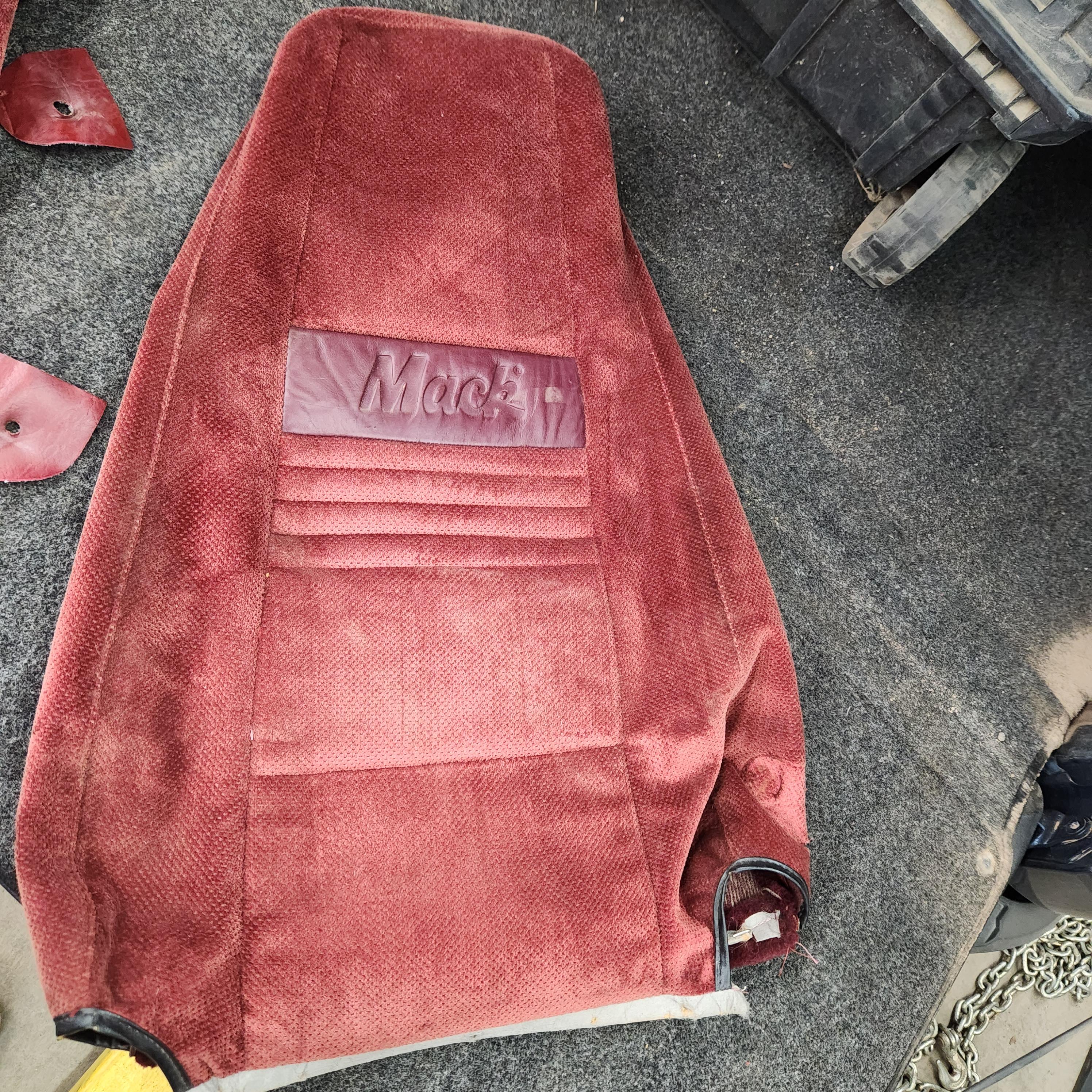

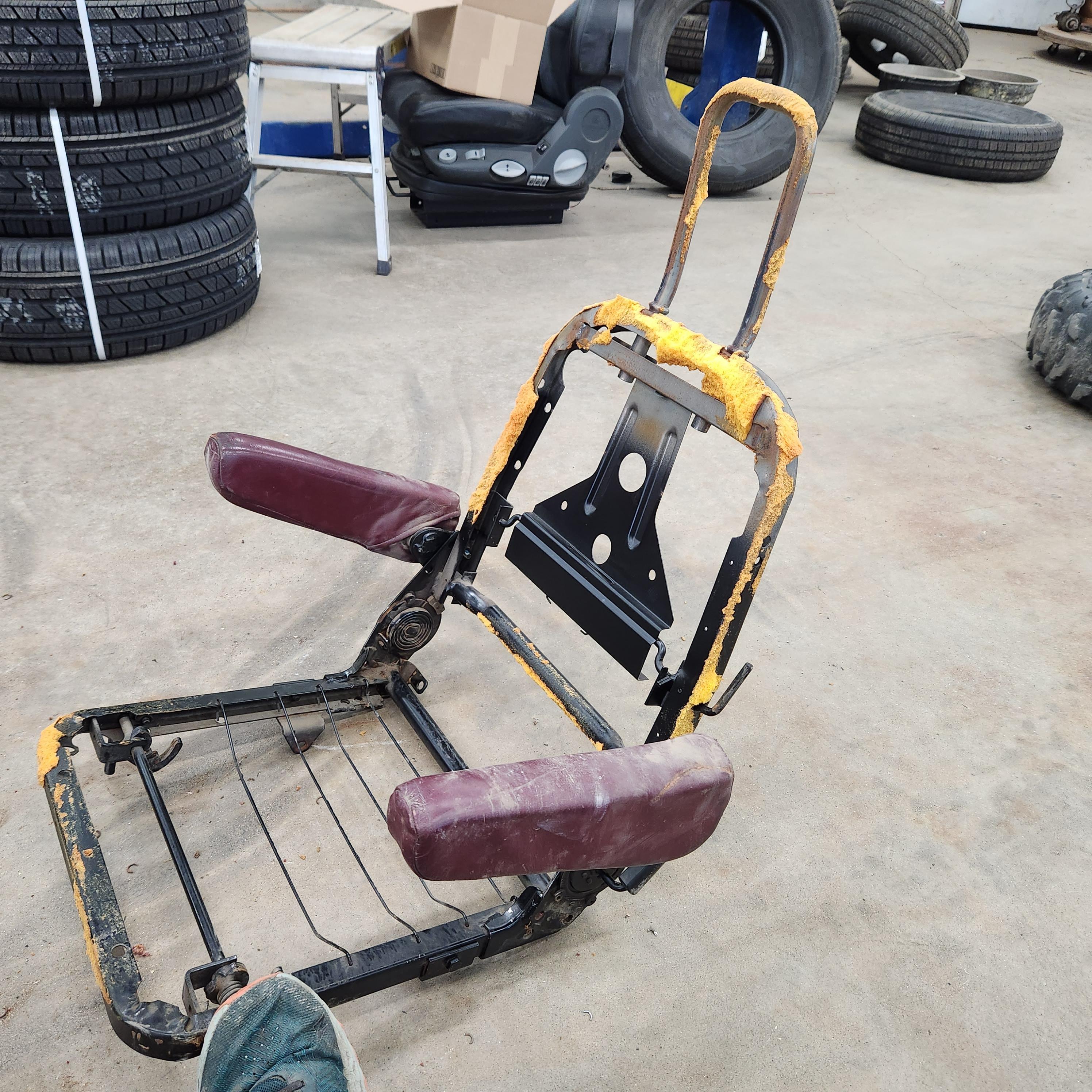

  5. Silver Mack Bostrom 915 came out of a 1996 CL Elite. Back cover good condition, cushion cover wore. Good armrests and good seat frame. Red, Bostrom 715E seat cover, came out of 1990 CH. Back and cushion cover excellent. Have rods and red vinyl filler pieces too. All excellent. Also 715e frame with armrests. Excellent shape. Also have RED armrests for Bostrom 915 seat. $250 for red 715 cover Silver- offer
