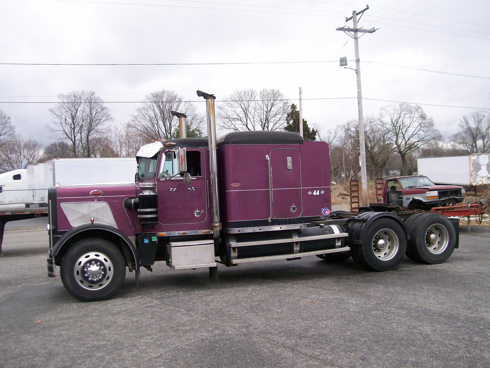

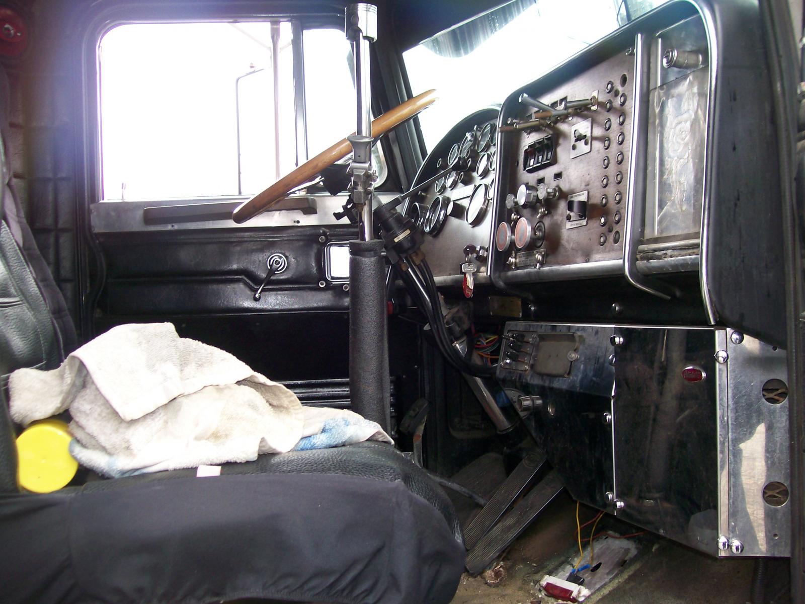

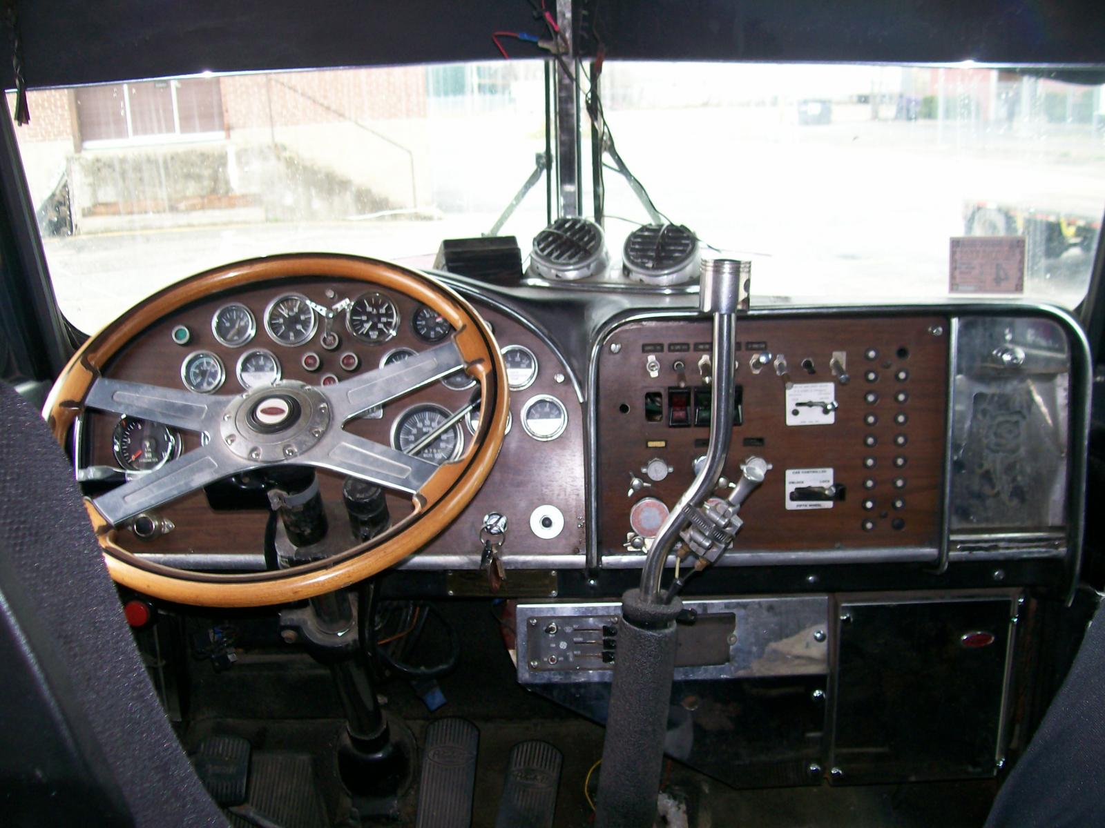

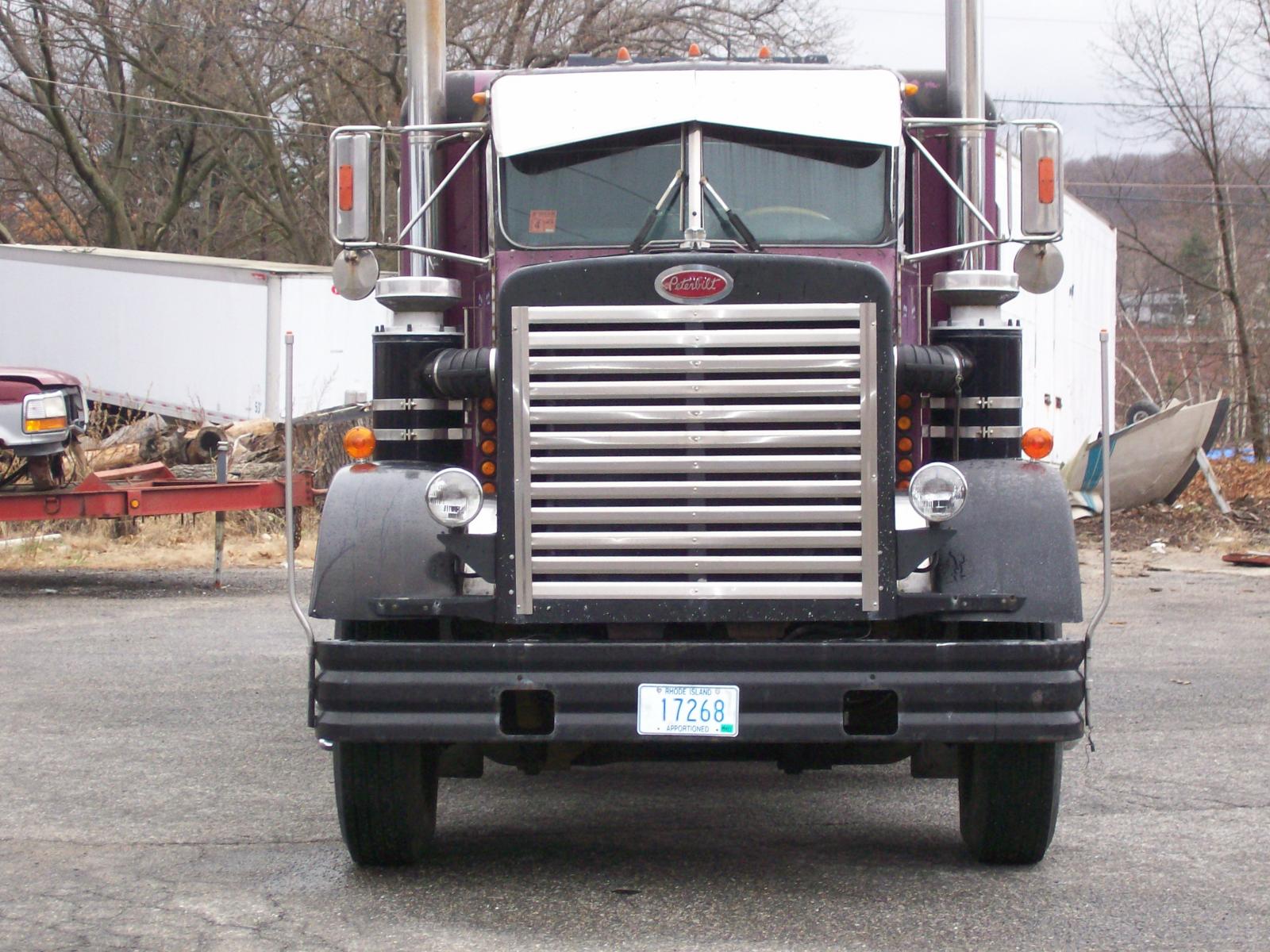

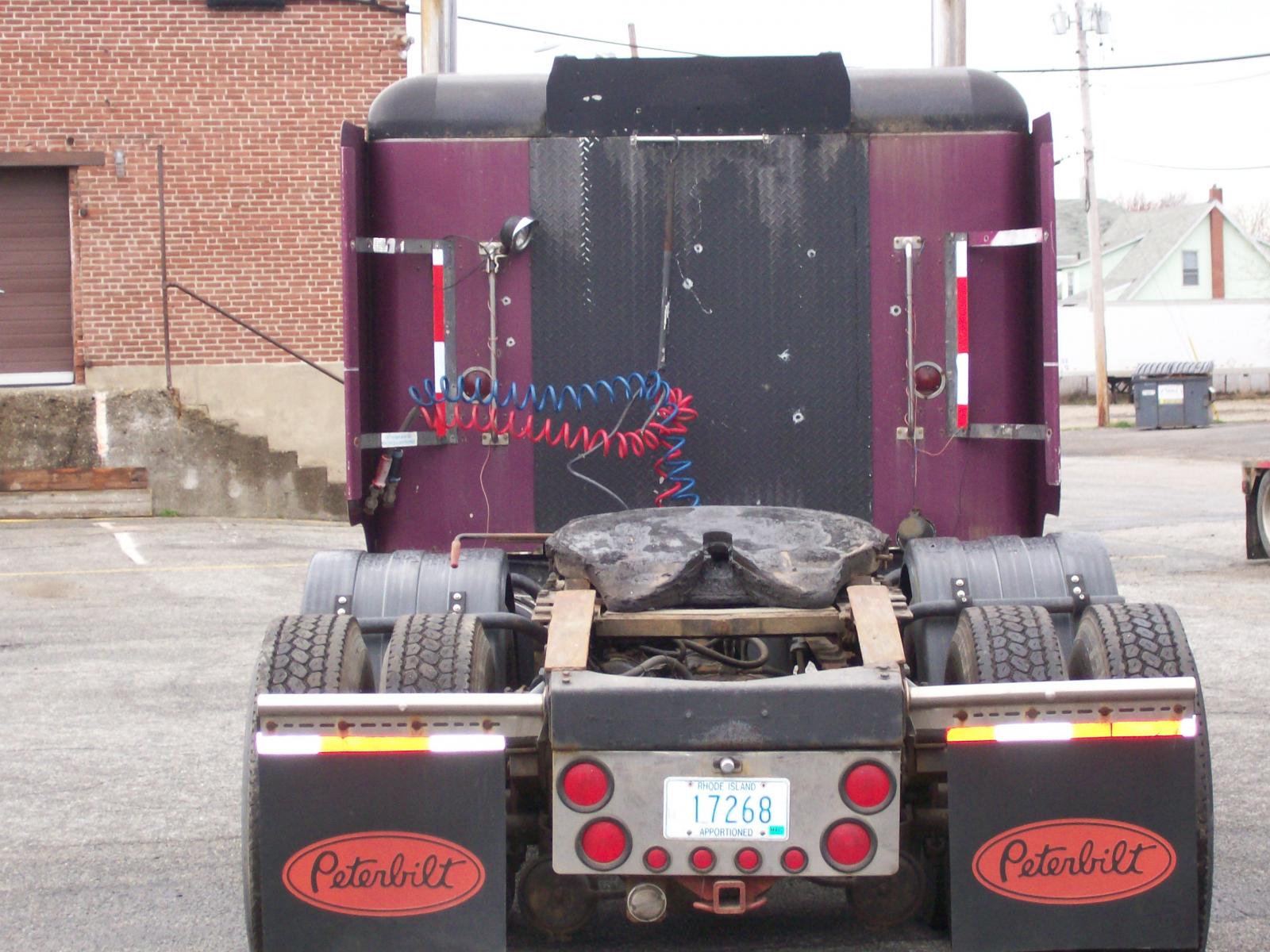

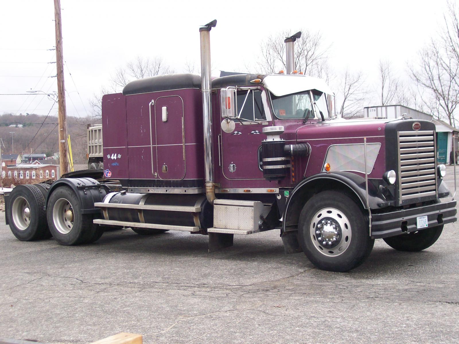

  1. CPL 675. Denotes that it is a NTC-350 Cummins, but prior owner claims it was turned into a 400 . 9 speed overdrive(want to turn it into a 13), Rockwell spring suspension, 3.73 rear gear, 40,000 rears, dual 150 gallon tanks from a Western Star, dual 6 inch stacks with rain caps, Jake (I NEED A CUMMINS PT FUEL PUMP SWITCH FOR THE JAKE)

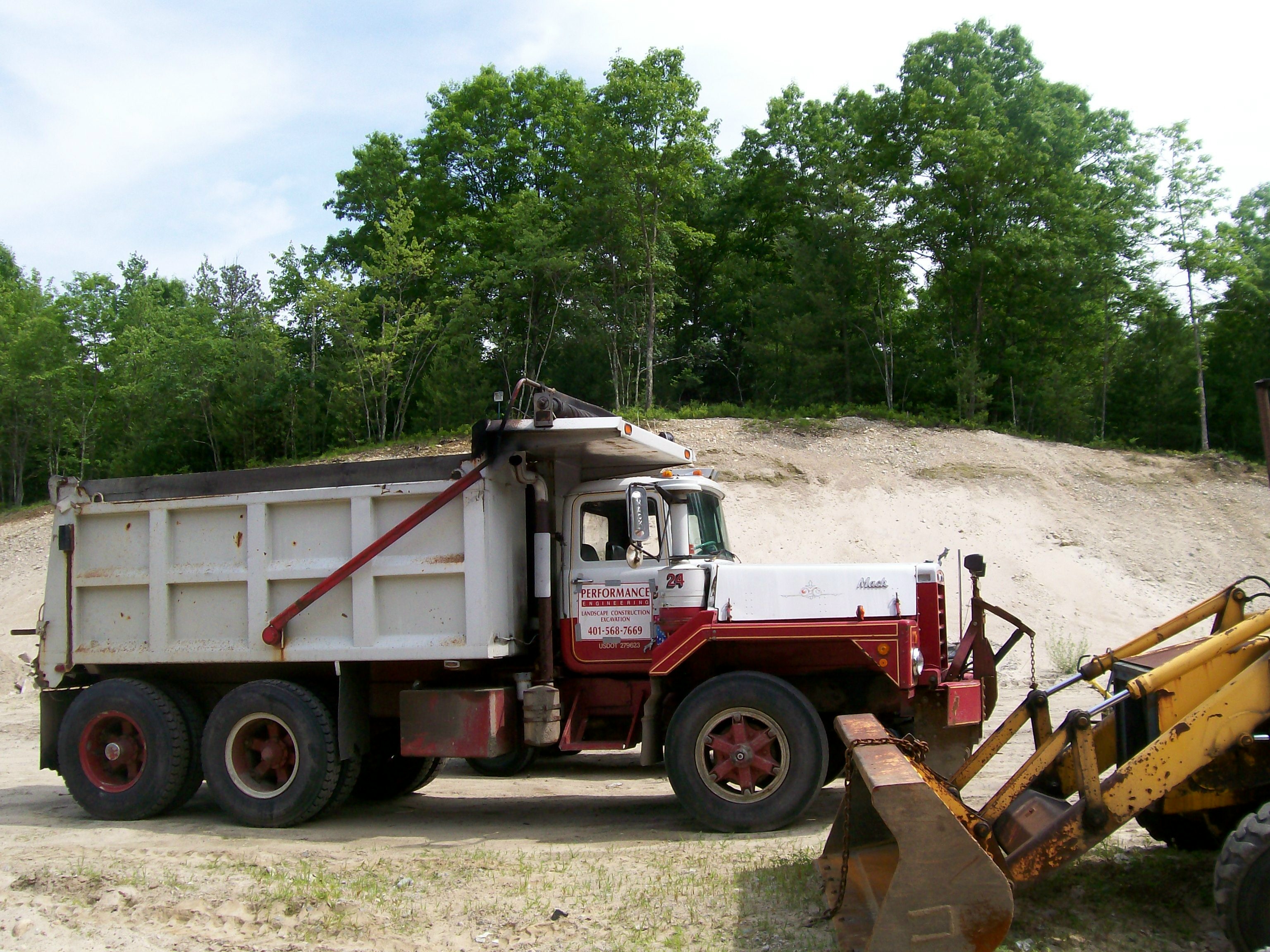

  2. Just another toy I bought awhile back.......I may work it eventually

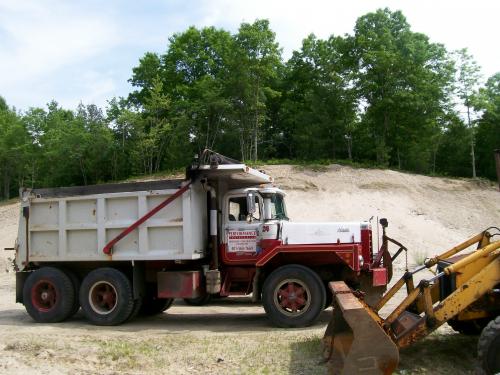

  3. Name: Mack DM-800 (1967) Date Added: 24 July 2008 - 11:30 PM Owner: ragman069 Short Description: Dumping 22 tons of gravel View Vehicle
