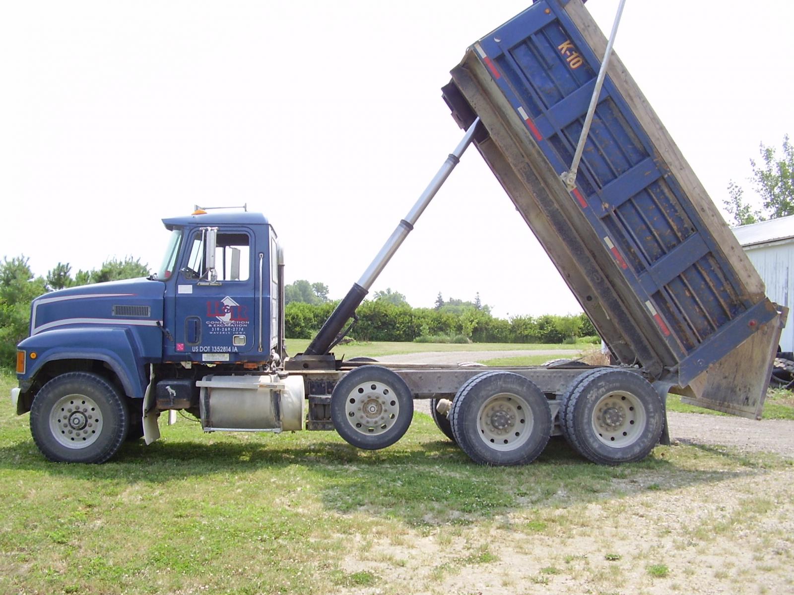

  19. This is the truck.
  20. I'm turning just over 1600 rpm's at 65 miles per hour. the truck is governed at 1725 rpm.
  21. How much power to the ground would be gained from switching to 11r22.5s from11r24.5s. I'm still trying to get my ch to maintain 65mph when loaded at 55000 to 60000lbs. Would like to turn up motor but nobody can tell me how to do that exacly. Motor is an em6275L with eaton 9 speed and mack 4.17 gears.
  22. Could you.just order the hood and taller cab mounts And install them on a ch forward axle? That might get the look you want for a lot less money.
  23. Heck with the flares! Where can I get that truck? That makes mine look like a pos.
