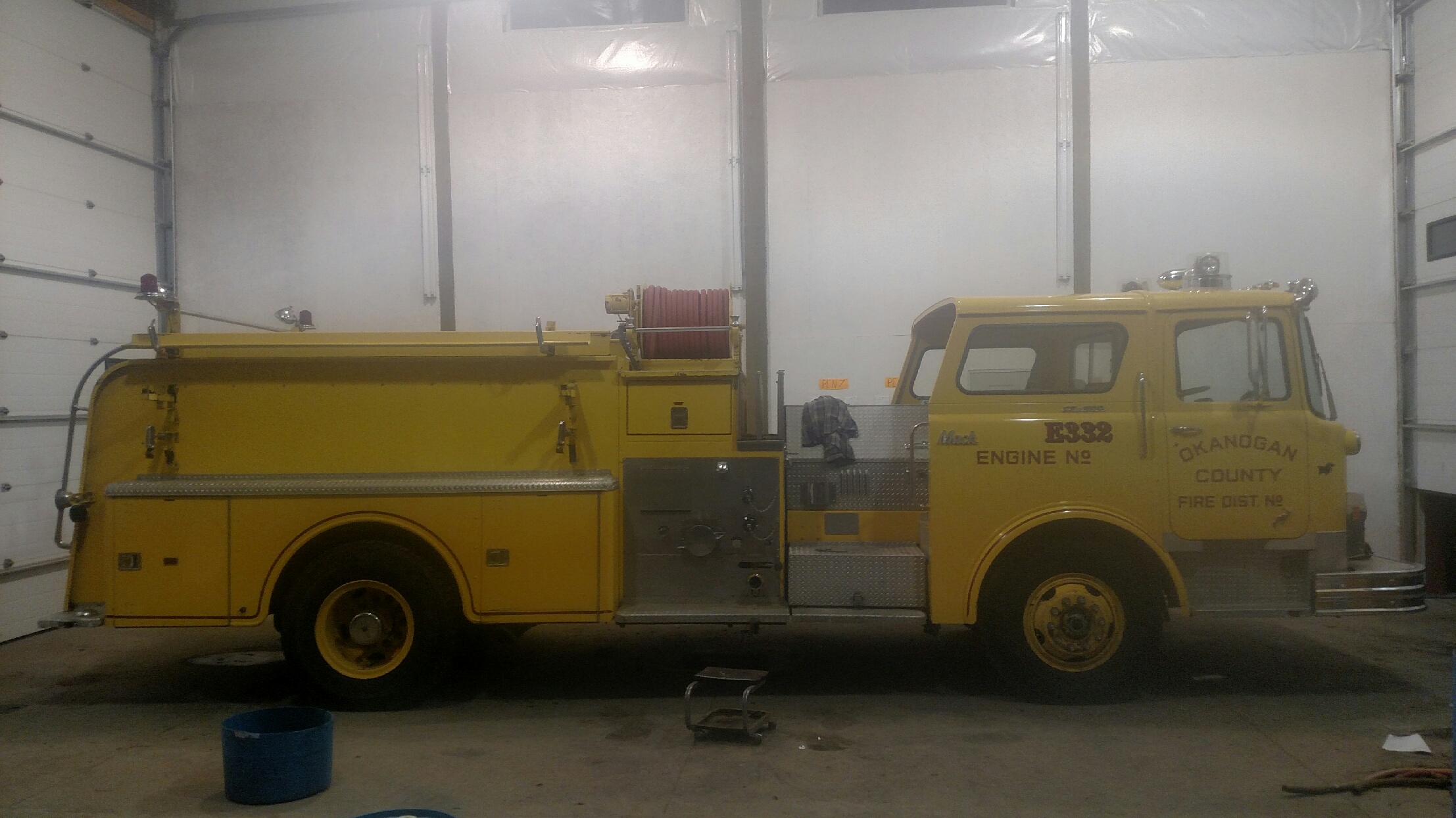

  2. yes! the truck was upgraded in the mid 90's the 500 gal steel tank was traded for a 700 gal. poly so no issues there! the rest of the truck is great, no rust only 19,000 miles and 850 hours on the eng. The investment has gone up more than I would have liked, after replacing the transfer valve, valve sleeve and bushing, rebuilding 6 apparatus valves and reconditioning 3 more the purchase price has been exceeded at least 5 times........good thing I got a deal on it!
  3. well the ole girl is getting closer to coming out of retirement and going back to work, just a few small details left like changing oil in the pump transfer case and rear axle and trans. still have to do a vac. test on the valves but I'm sure it will go well after rebuilding all the valves.
