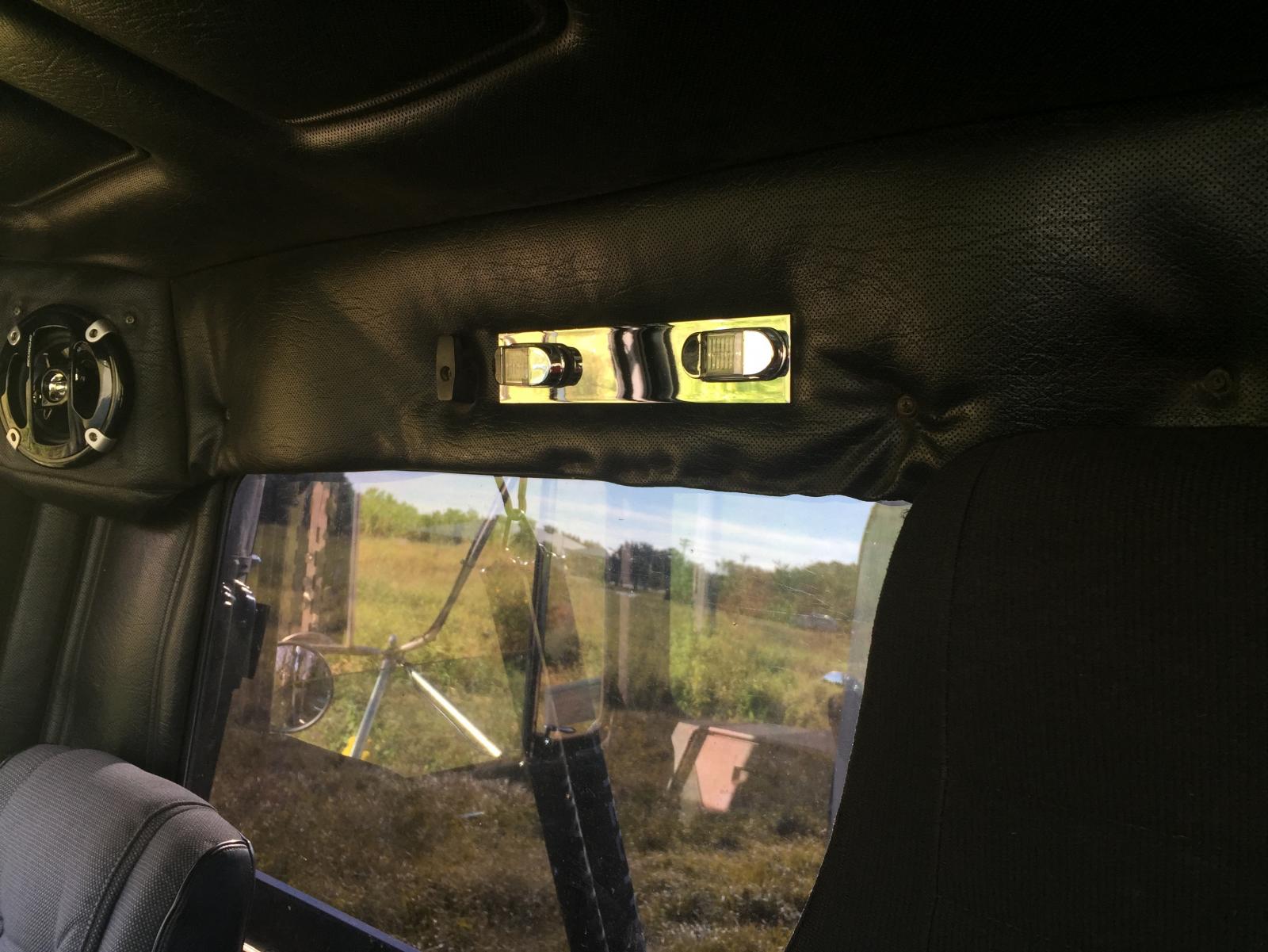

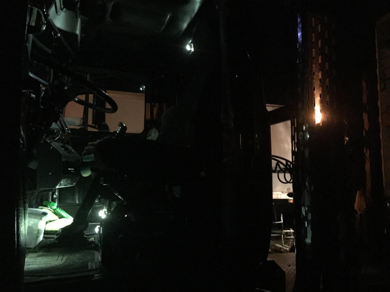

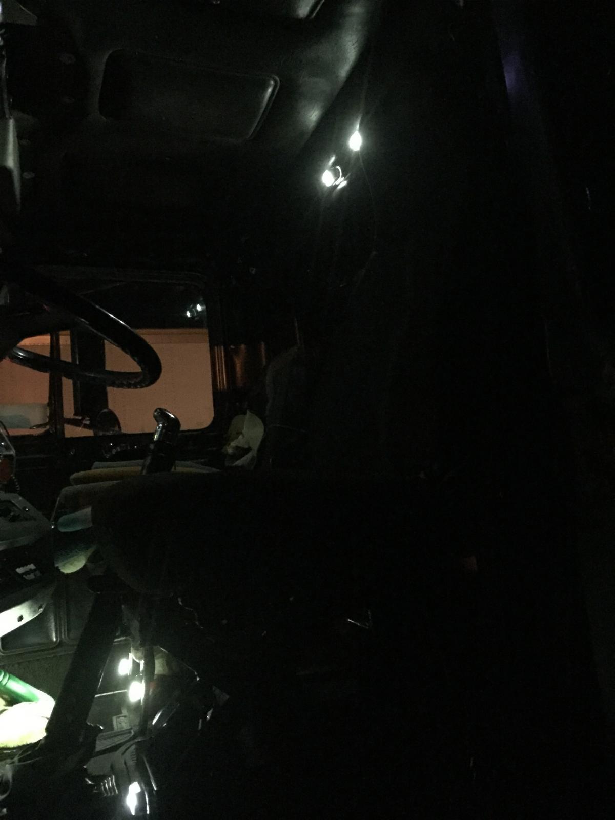

  4. They are 2 maxxim interoir led lights attached to a chrome piece.
  5. When I bought my superliner the lense cover for the doam lamp was missing so I just had a ugly bulb and toggle switch. So out with the old and in with the new. I love my old truck and the powertrain but some small things could use some upgrades. So here is the doam lamp assembly I made. What do ya think?
