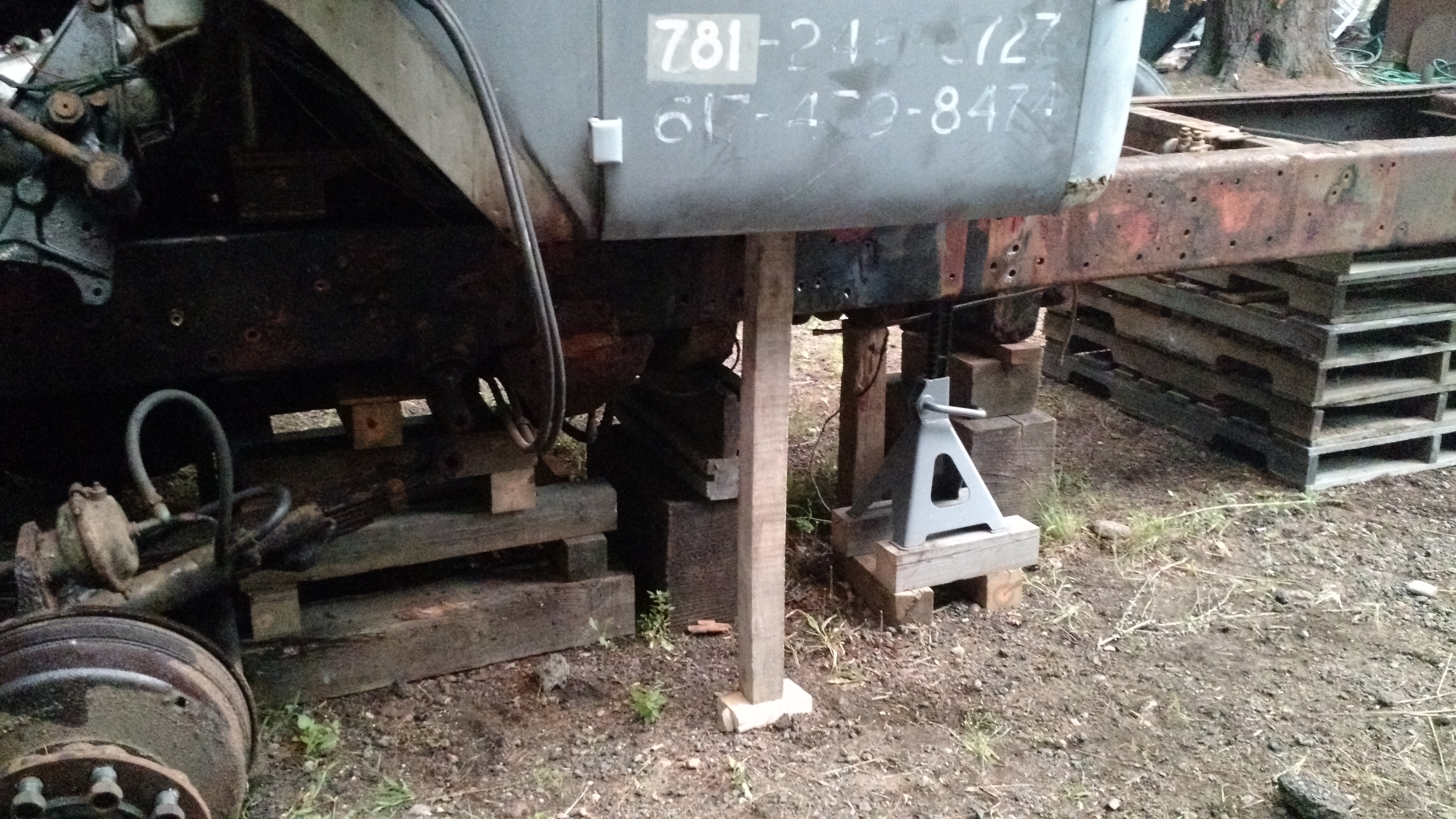

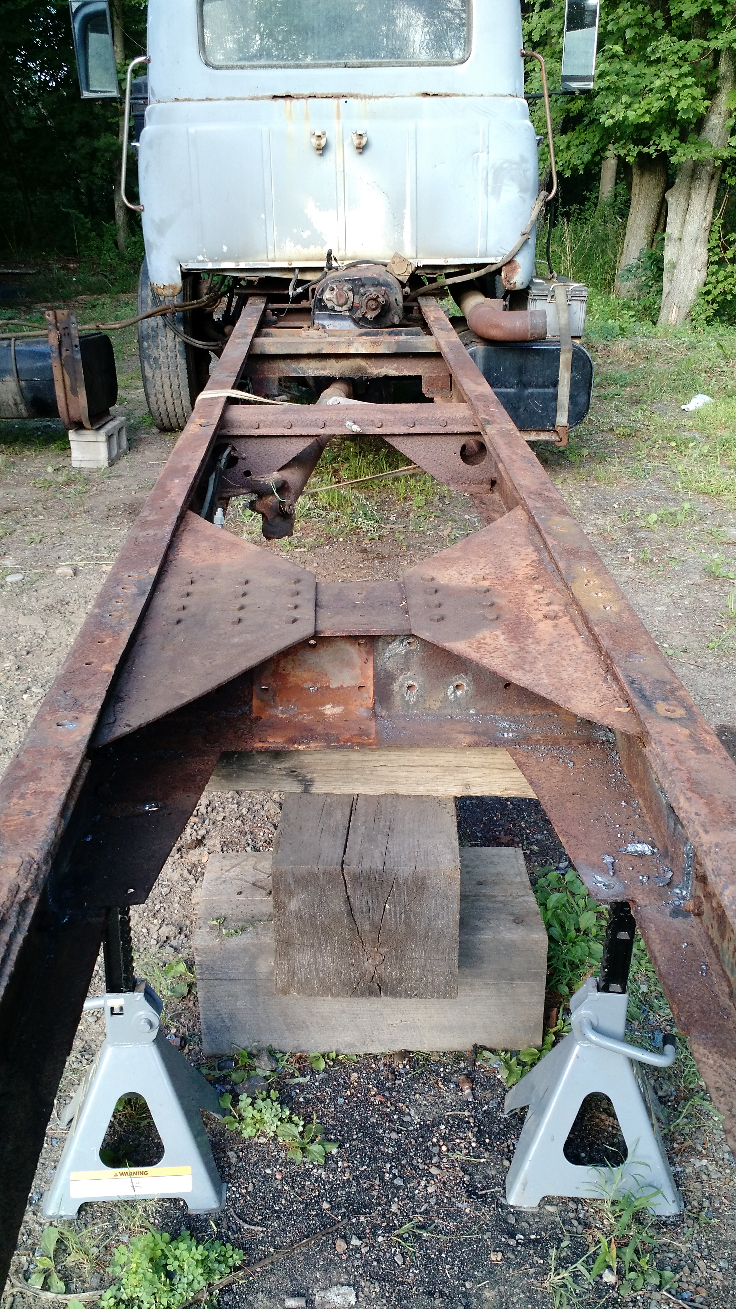

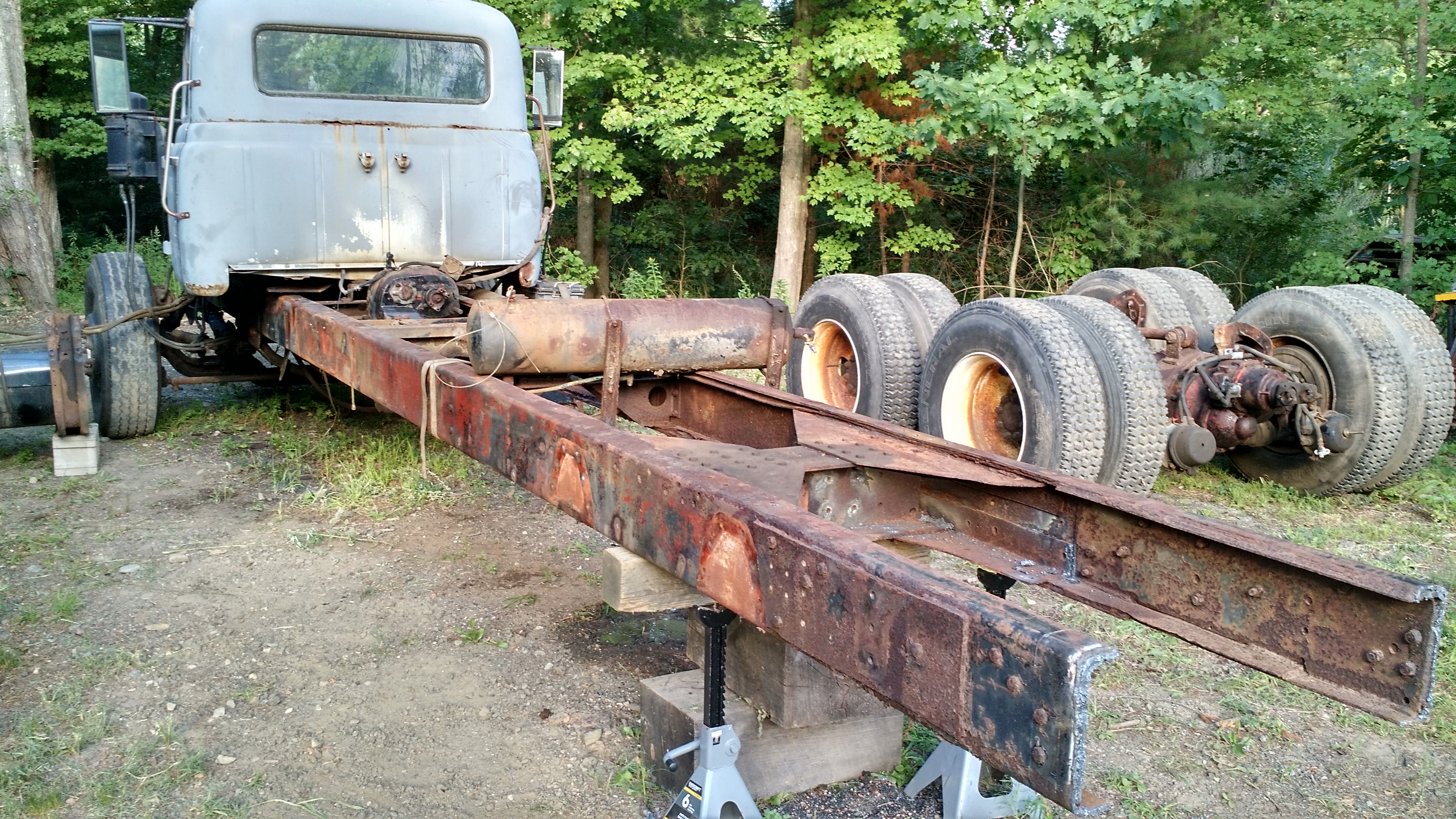

I know some of this doesn't look 100% safe, but it is more stable than you would think. I need to burn out 5 or 6 more bolts, get another 5 or 6 with impact gun and the rail should be out. I do wish it was going a little quicker, but things have been going pretty smooth so I shouldn't complain. Thanks, Andy

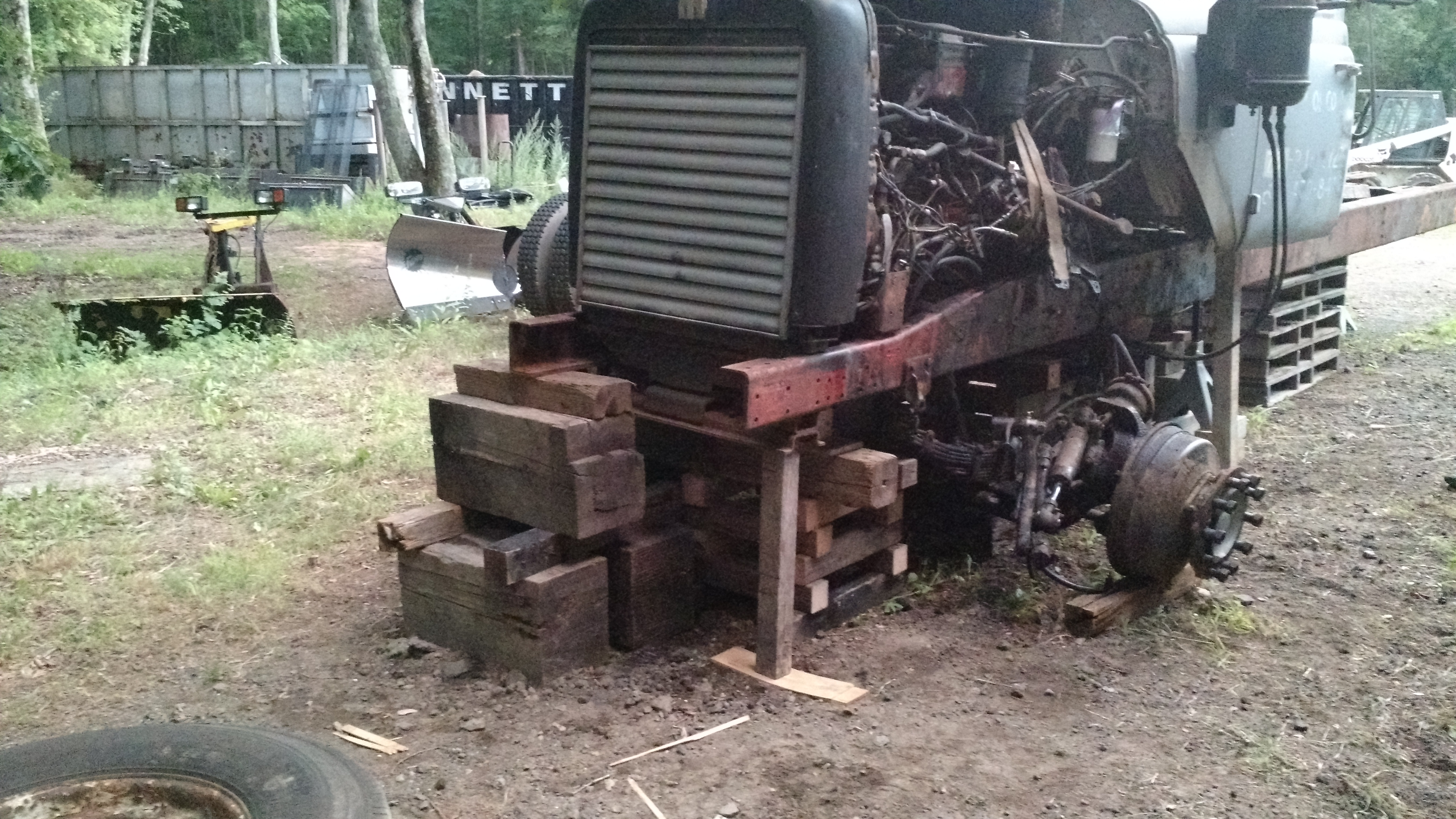

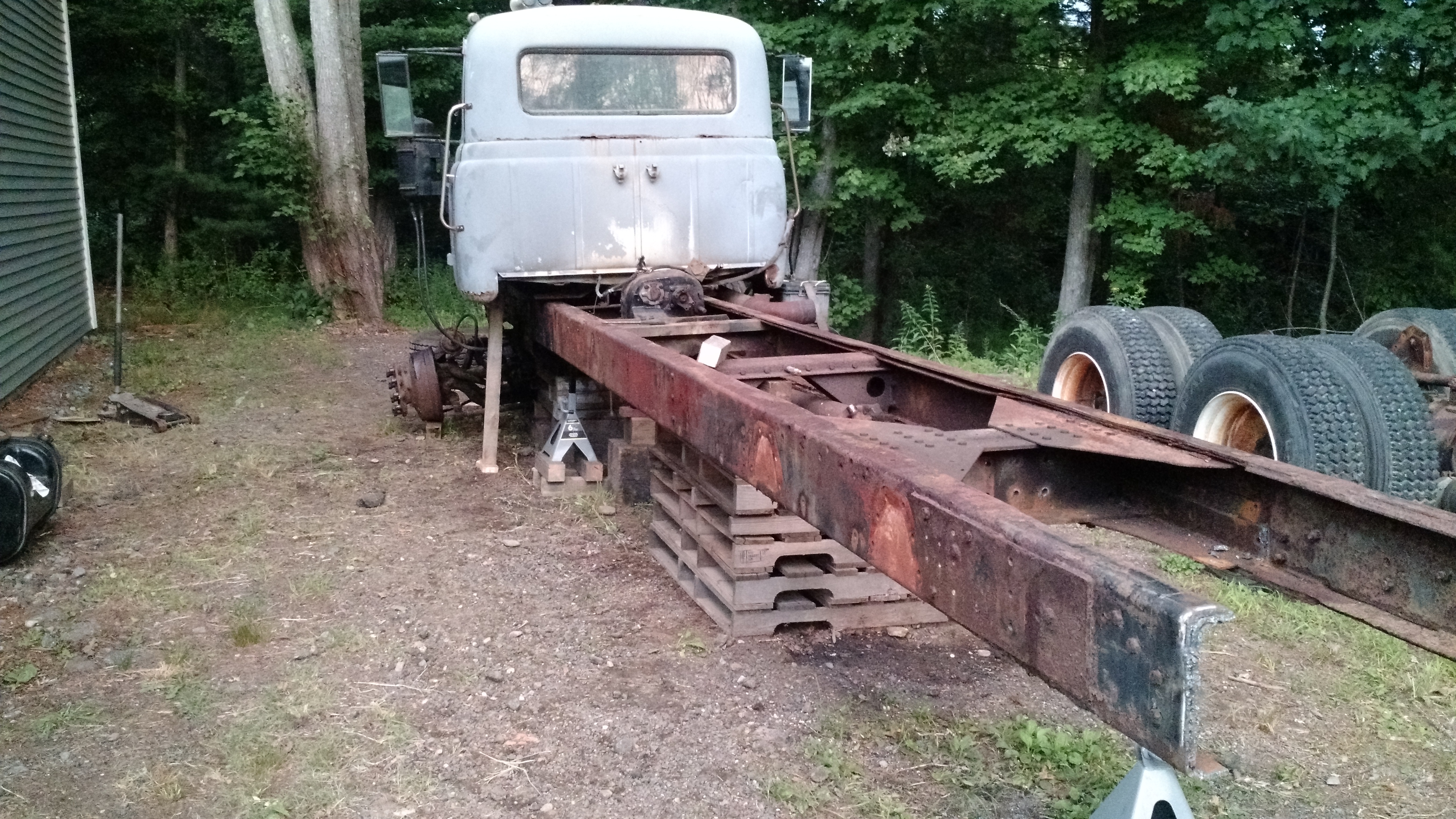

Didn't get nearly enough done today unfortunately, but some progress was made. I will let the pics do most of the talking, hopefully I can get the engine and transmissions cribbed up tomorrow. Gotta keep this project rolling. Thanks, Andy

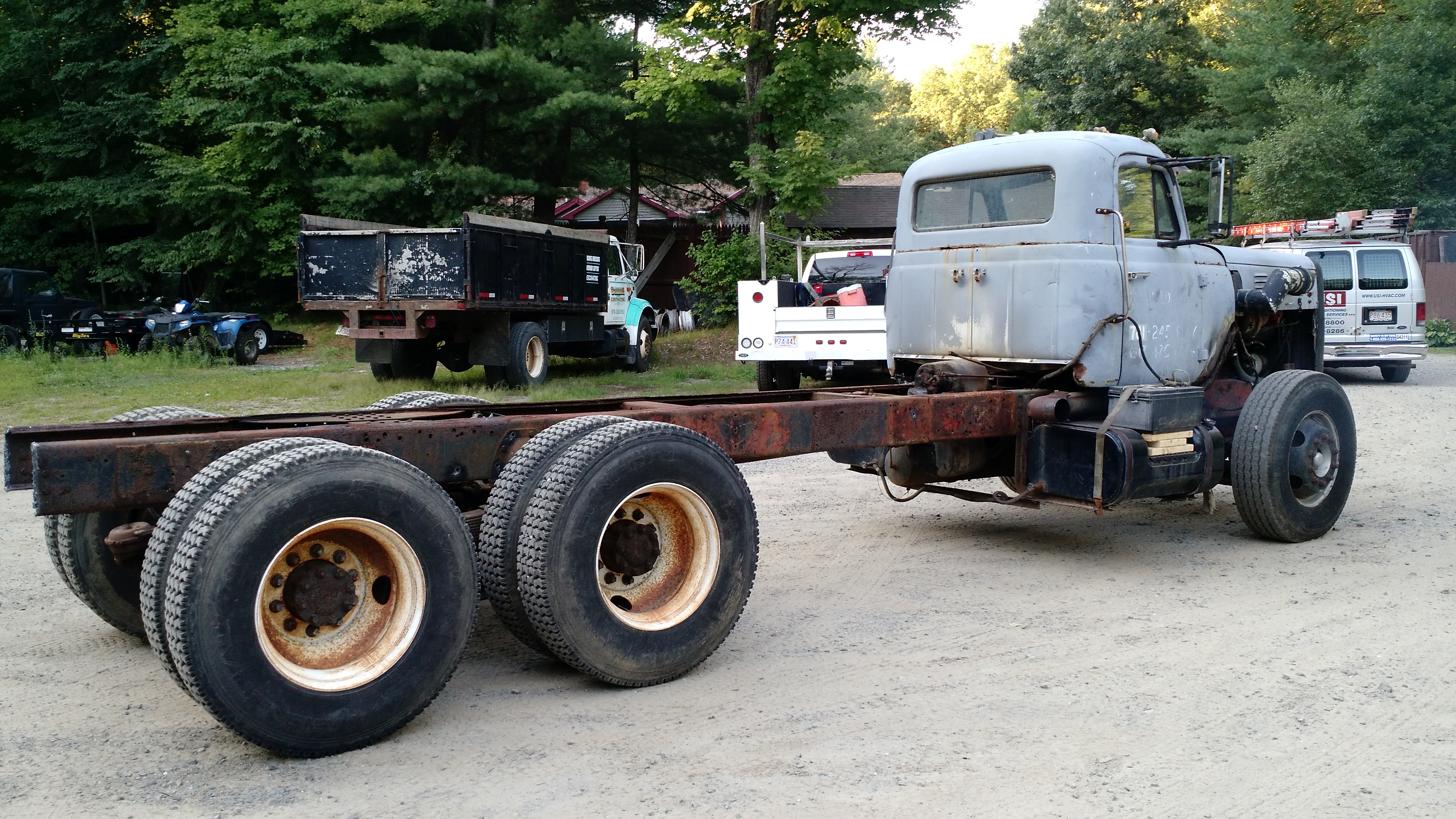

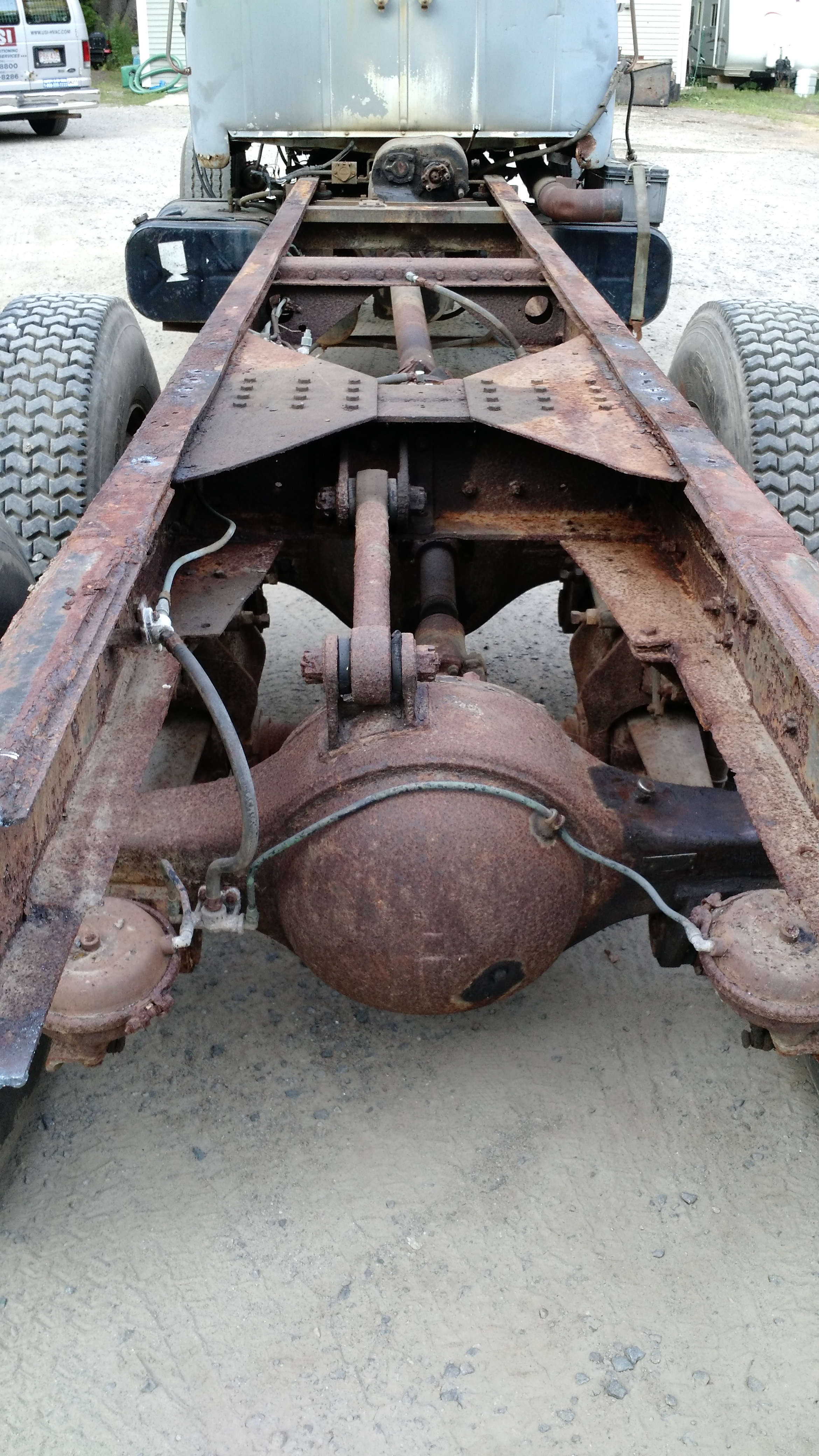

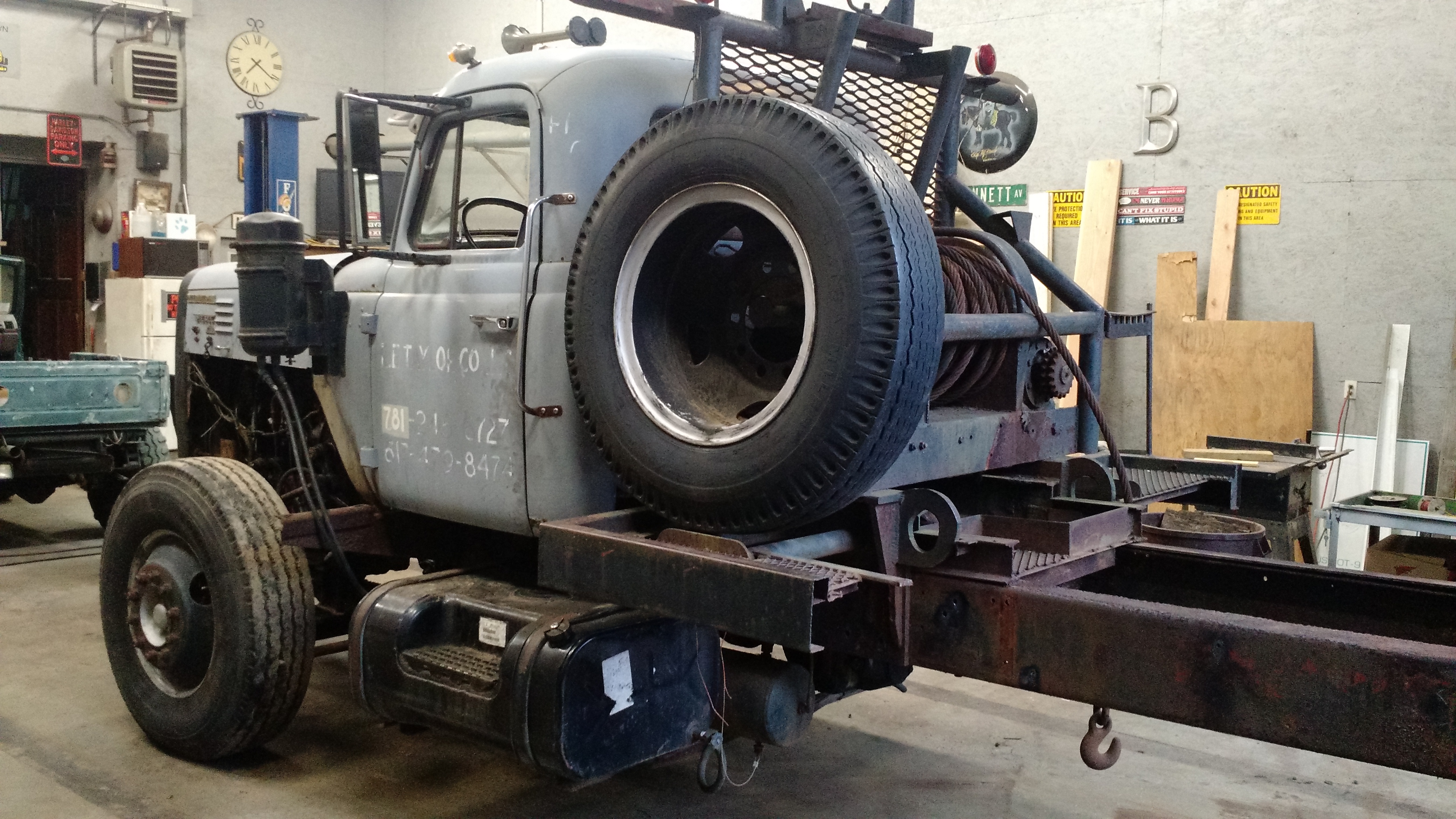

Well, I had to work a couple double shifts and Saturday morning, but I finally got the stubborn winch off. There were a couple bolts that did not want to come out, but with the fire wrench and an air hammer I got them. I cut off the back of the frame roughly where I think it previously had ended. I think that I want to put a pintle plate on it as well, and I would assume I need to add a crossmember at the very back of the frame. The plan is to go over everything with the pressure washer again tomorrow morning and set the truck up on some cribbing. Hopefully by days end the DS frame rail is out of truck, but that is probably wishful thinking. What do you guys think, should I leave the WB length as is, or shorten it? I'm definitely having the complete new frame rails fabricated and drilled by PG Adams and probably the crossmembers as well. Thanks, Andy

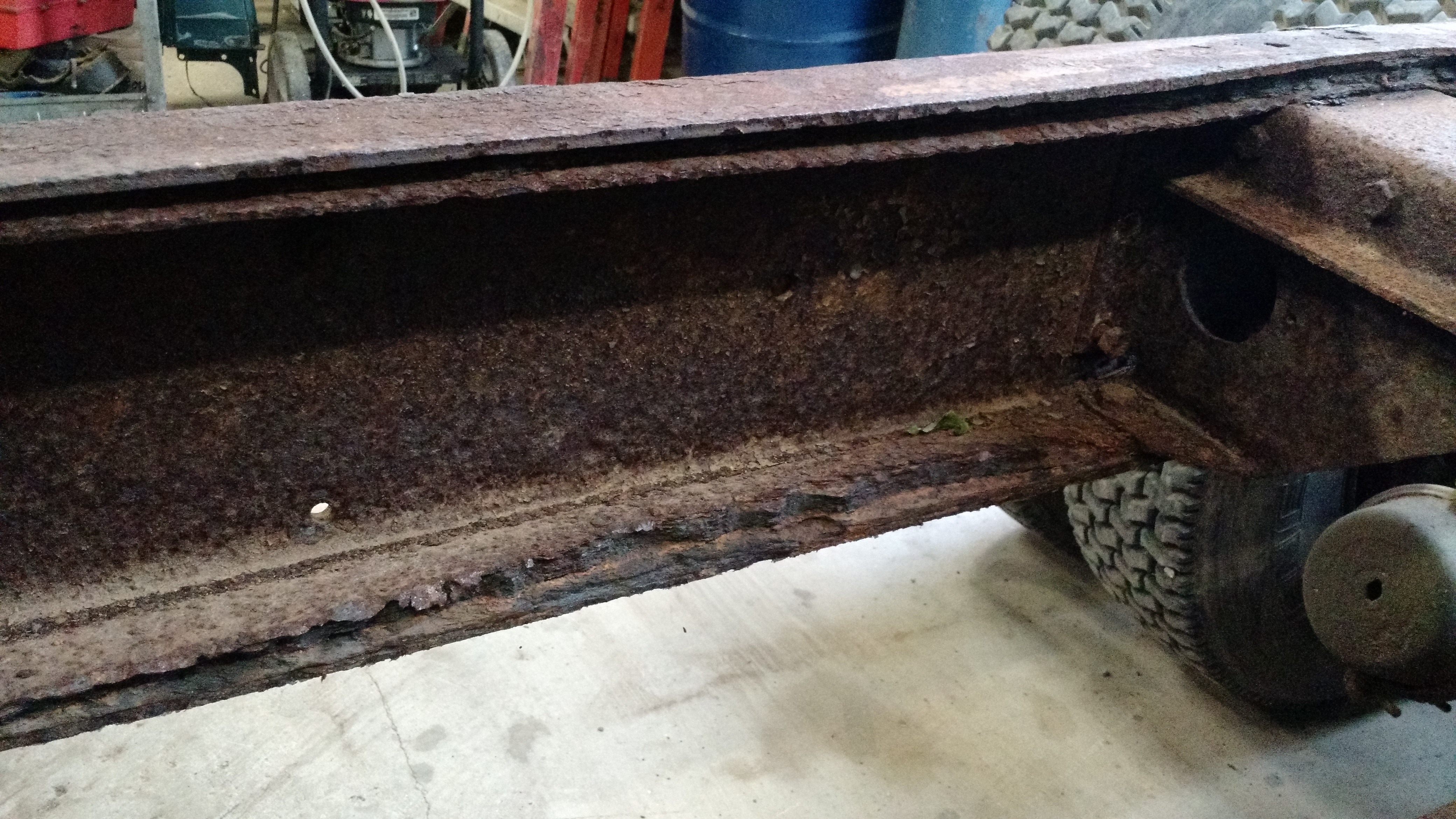

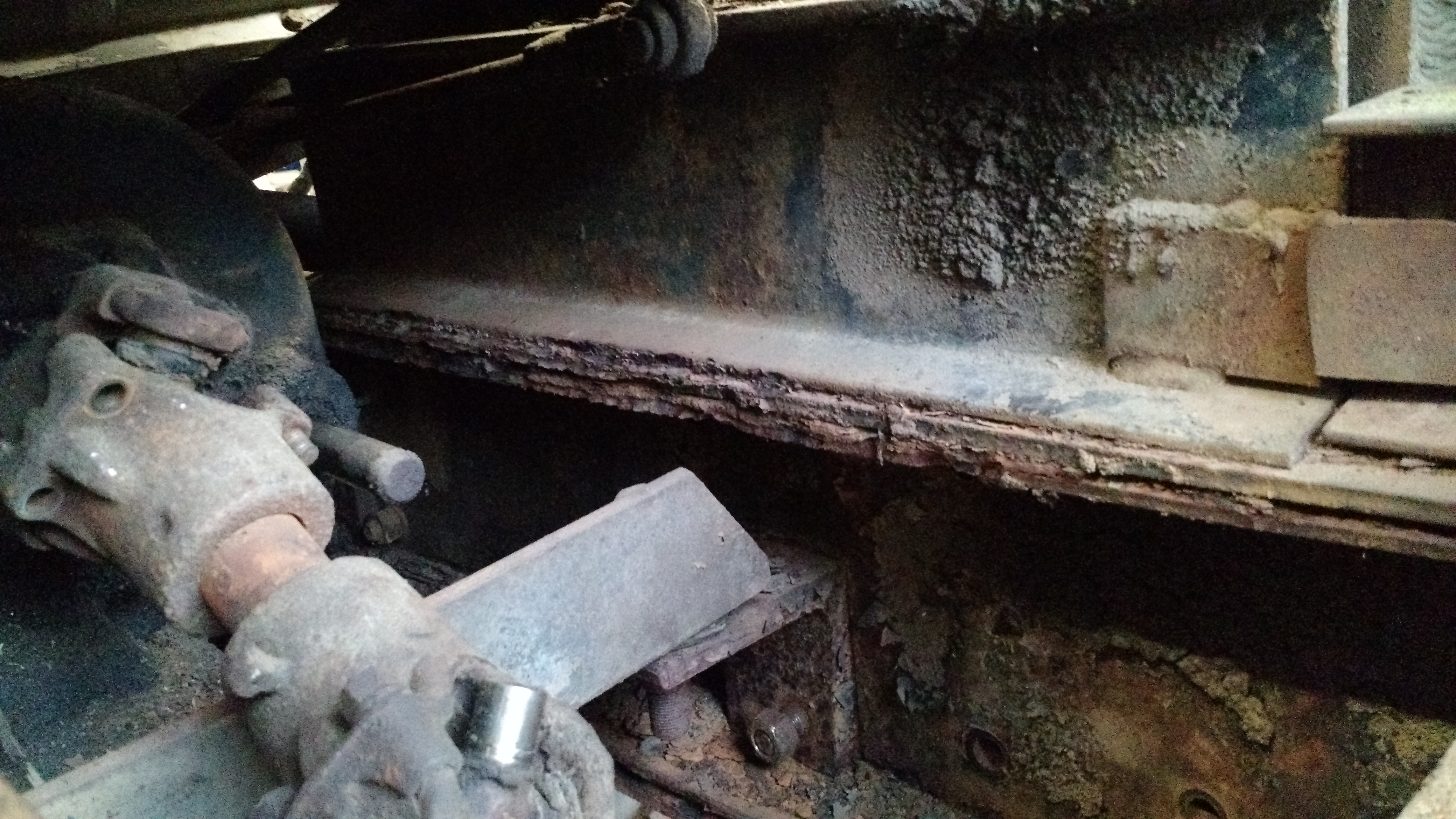

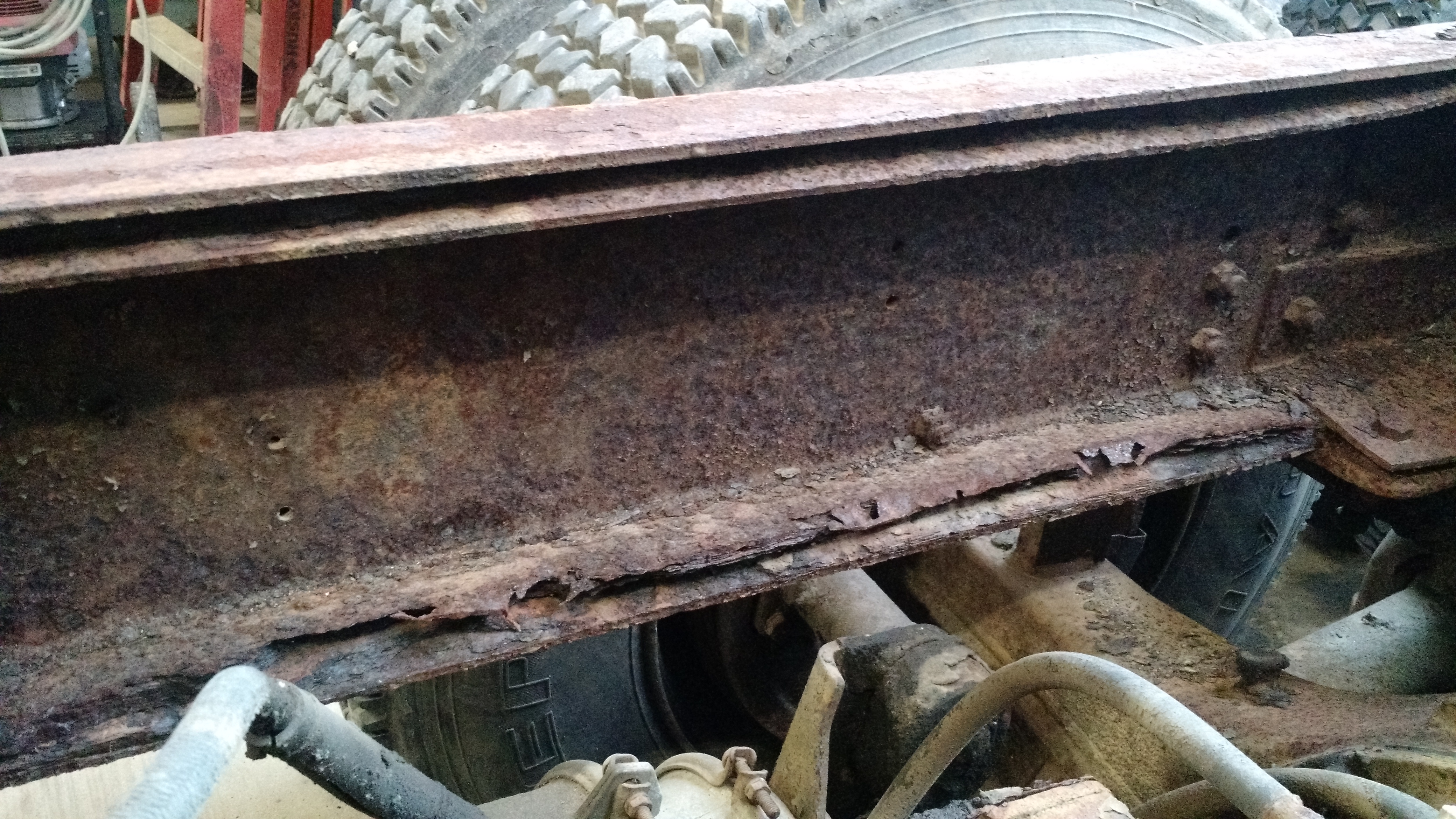

I have the same concerns, however I'm usually pretty driven when I decide to take on a project. It might take a while, but I usually power through it. We will see what happens, I hope to get alot done this weekend. Here are some more pics of the frame, it is pretty bad in spots. Andy
Got a little more done, I've worked on it a few hours every night this week. Need to get the torch bottles re-filled, there are still a few stubborn bolts in the winch, but it is almost ready to come off. I'm torn on weather or not to take the cab off for this or just leave it be. I really want to leave the cab, engines, and transmissions in place. Even though this is a major project I would like to do it in small portions and keep the truck as operational as possible. Any input/suggestions are appreciated, thanks. Andy

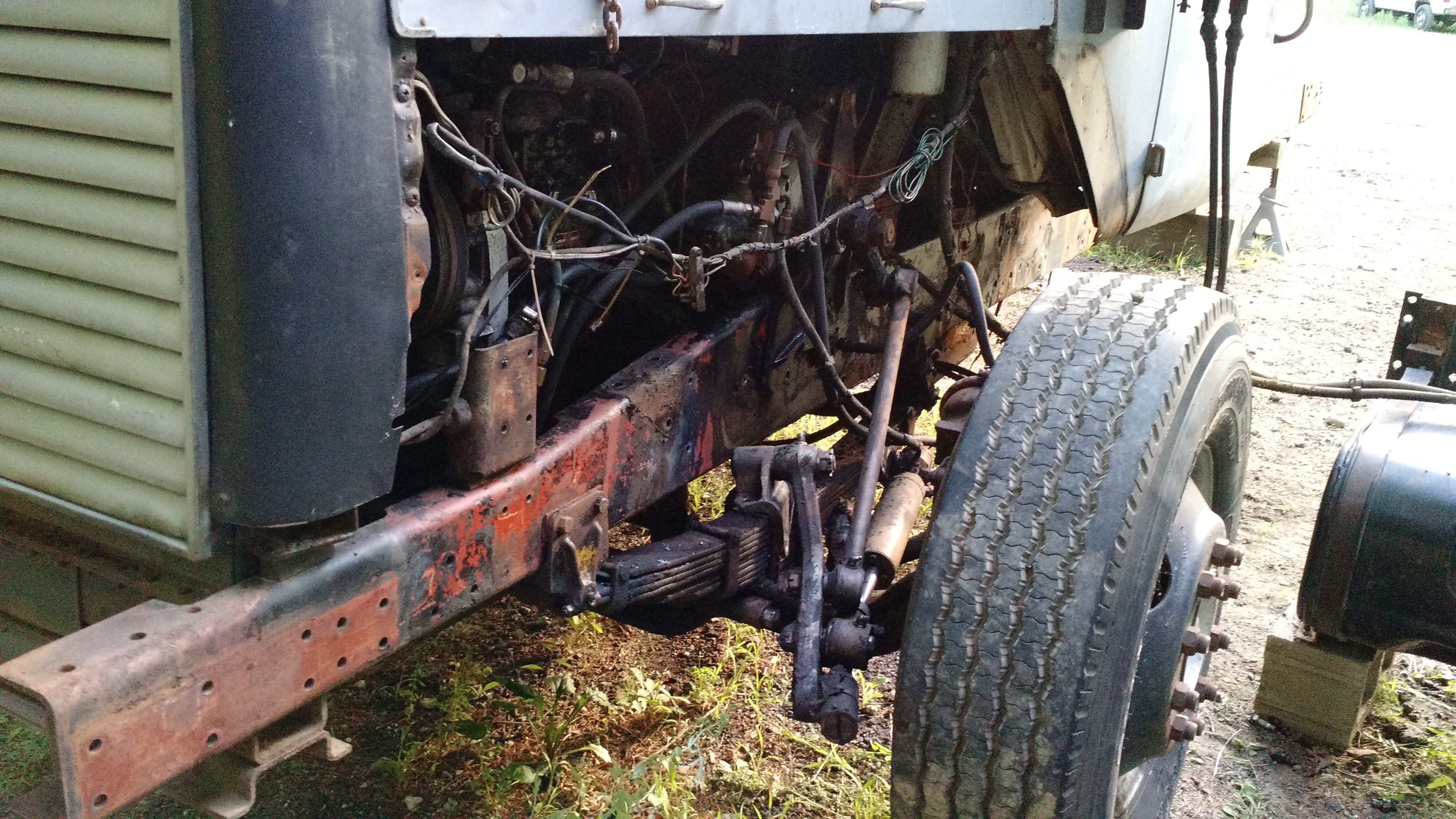

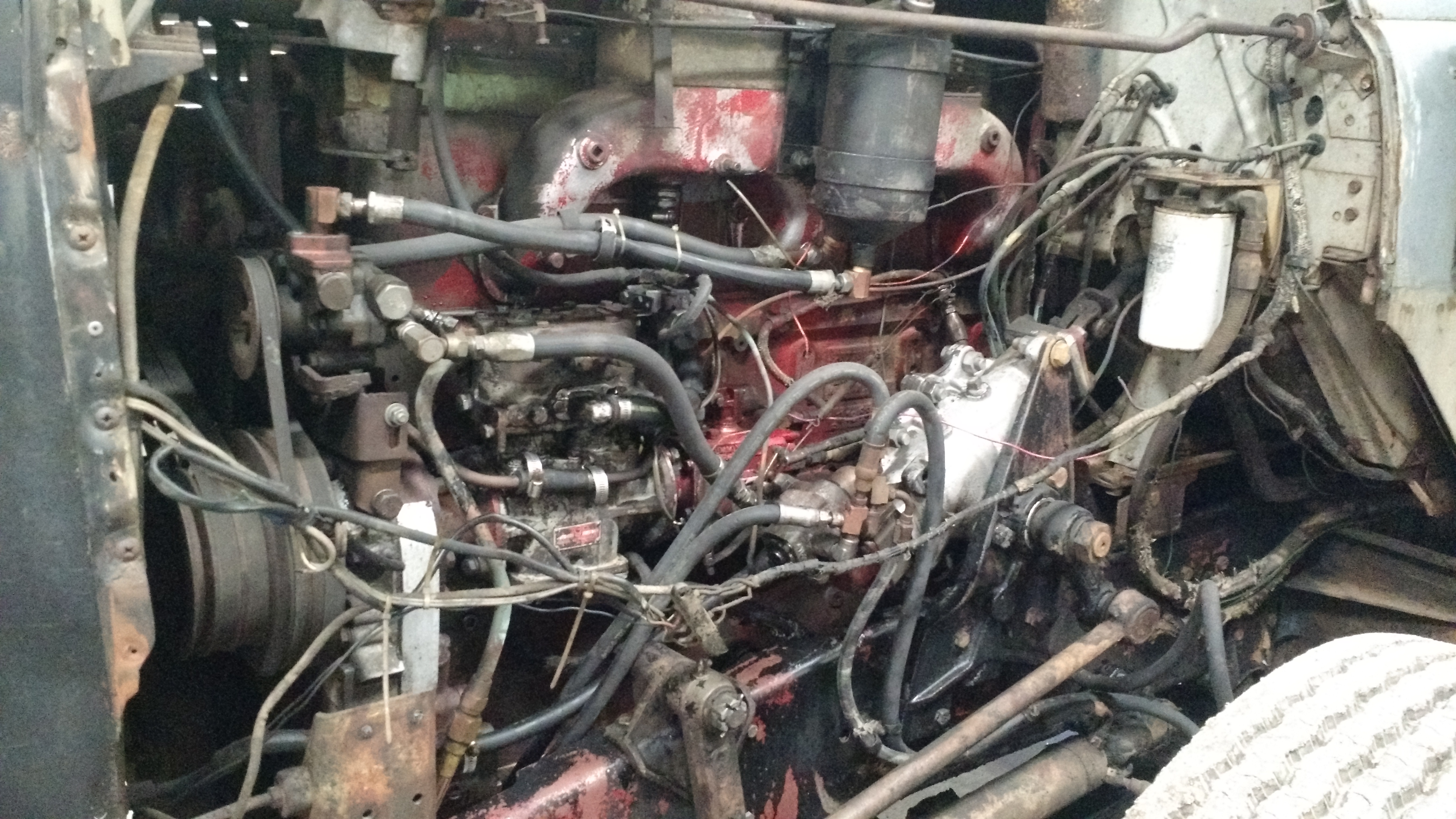

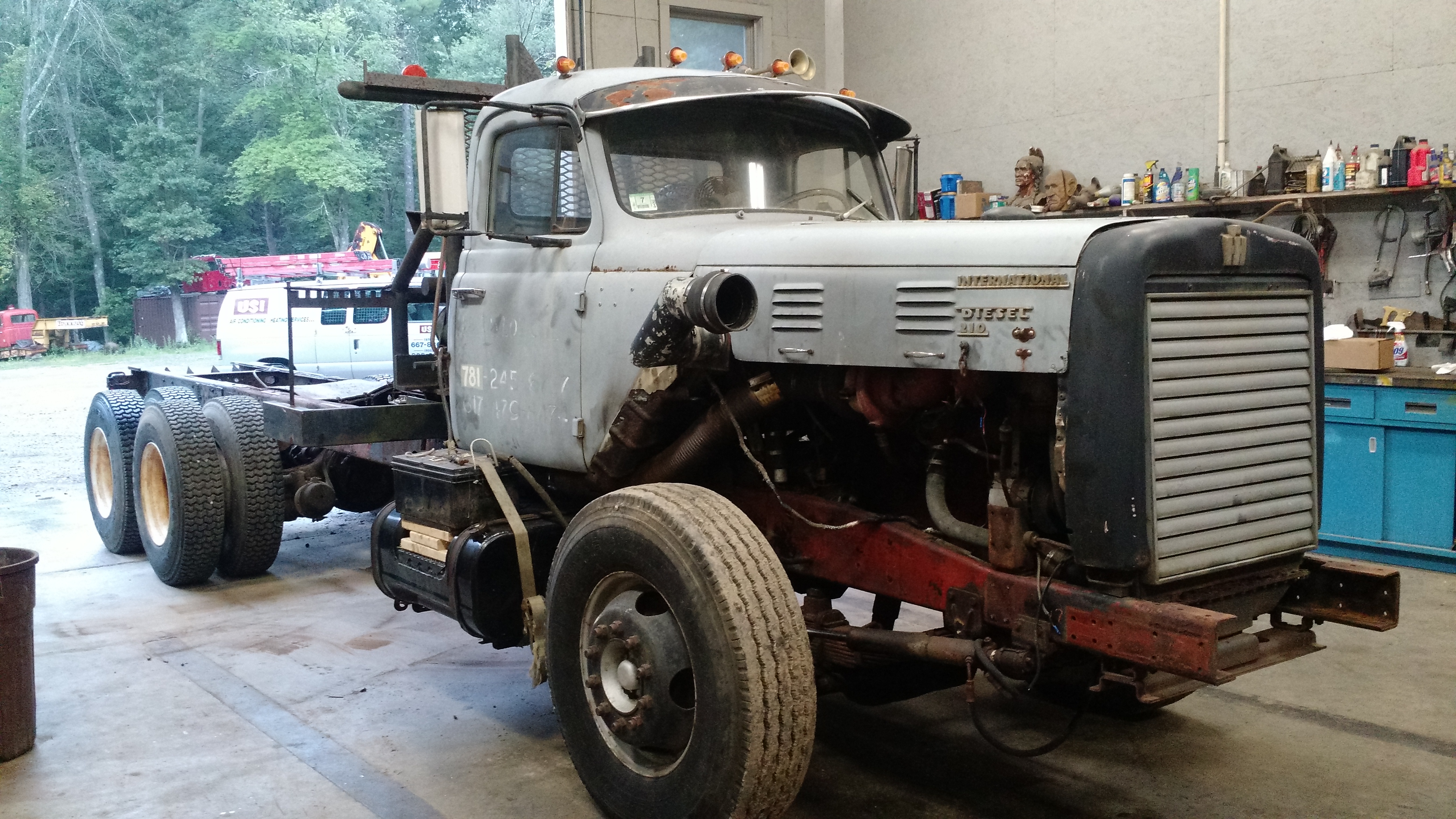

Got a little done, it was hot and mostly all torch work. I wanted to get the winch off, but being as busy as it is there wasn't a machine in the yard to pick it off. Instead, I focused on the front of the truck. I'm hoping to get the winch off during the week sometime, then maybe pull the DS rail on Sunday. There is a huge lifting eye on the engine, I'm hoping I can rig up a gantry of some sort to support the engine from there. Cribbing it likley won't be easy. I realized I made a mistake, the WB is 217" on the truck currently, and that is what the VIN data plate reflects. I think I'm gonna leave the WB it's current length. Another interesting thing is that it appears the frame was originally red and the cab and fenders were white. I think I want to leave it grey and black though. On another note, thanks guys. It's cool to be able to share this project with other like minded individuals. I'm pretty sure my buddy (who is currently letting me work out of his shop) thinks I'm bat-shit crazy, although he is being very helpful.

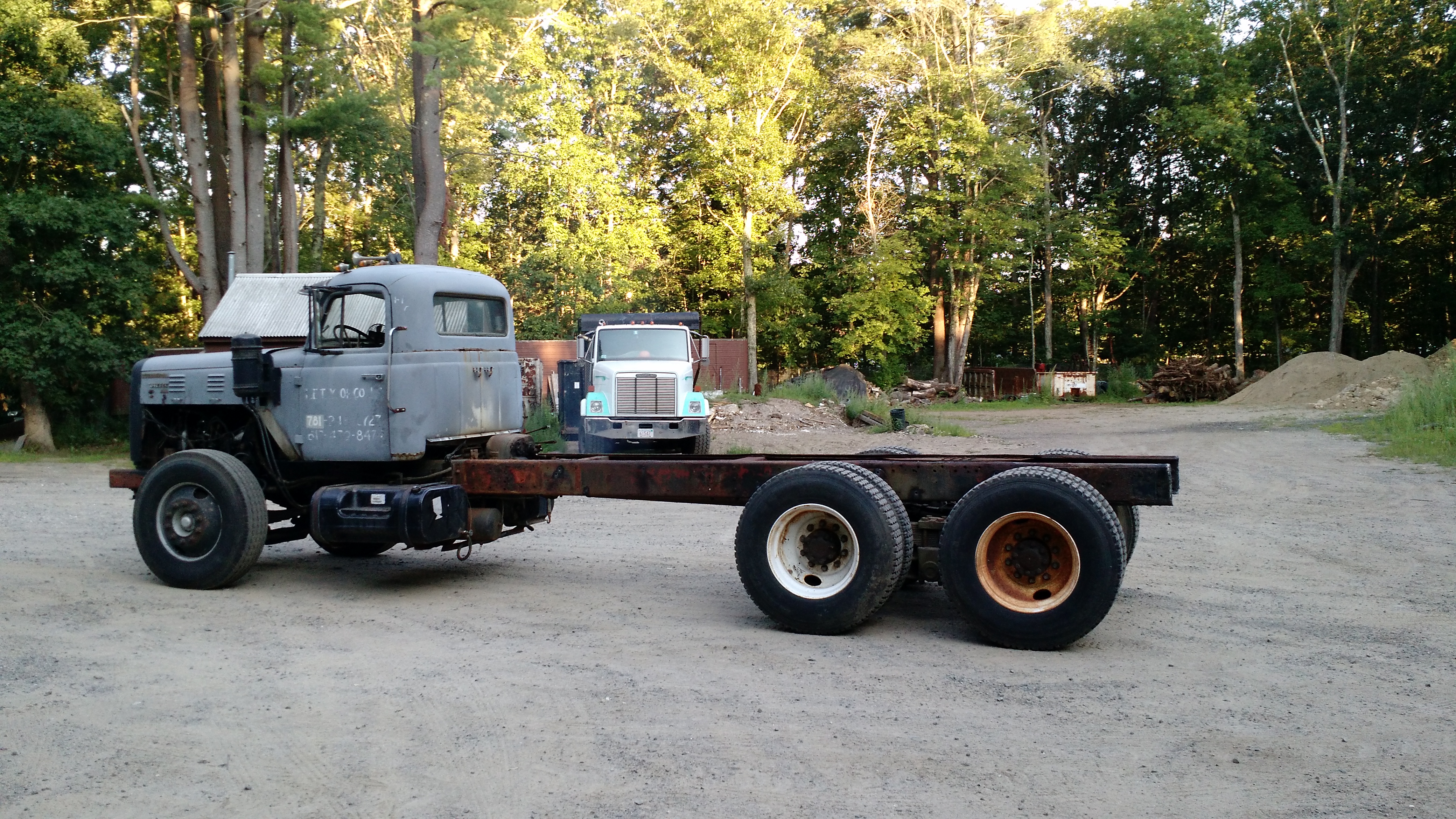

Thanks for the info, I was able to talk to Ron, and he is a very nice guy and gave me some good info and much needed encouragement. He has a guy that can repop the fenders, so that is a relief for me. He also said he had the same sort of frame issues with his truck. I would love to not have to fix the frame, but to me I need to fix it before doing anything to this truck. I looked it over again this weekend and after my researching frame repair I think I have the most economical solution in mind. My plan is to move the rear axles forward roughly 3 feet, splice in new inner rails in from about a foot under the cab and splice new outer rails in about 4 feet behind the inner splice. I sent some info to PG Adams, and waiting for a quote. I also have a line on a used mag drill for short money, I'm hoping to check that out tomorrow. As I was looking more closely at the truck I found that it was originally a tractor and the wheelbase was as you see it in the pictures. On the VIN tag it is listed as having a 270" WB, and it was most definitely a tractor. The frame was stretched, but the splice is right behind the rear axles. Andy
