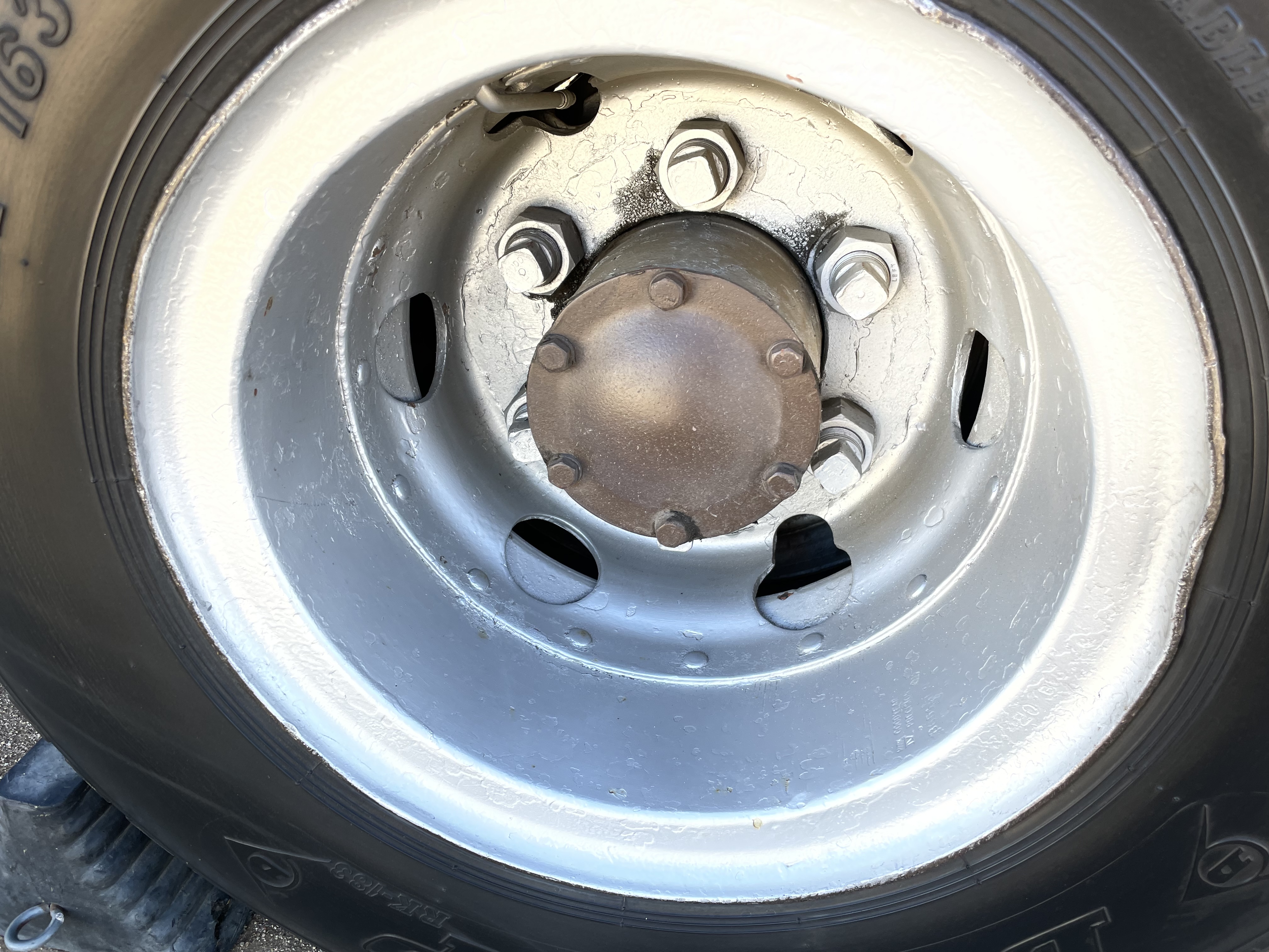

The 6 lug 15” trailer wheel
I need the drivers door about the rim can I have a friend that lives in Reno pick it up?
That would be great What does the wheel need to be fixed i am interested in the door did you ever find the instrument panel and visor?

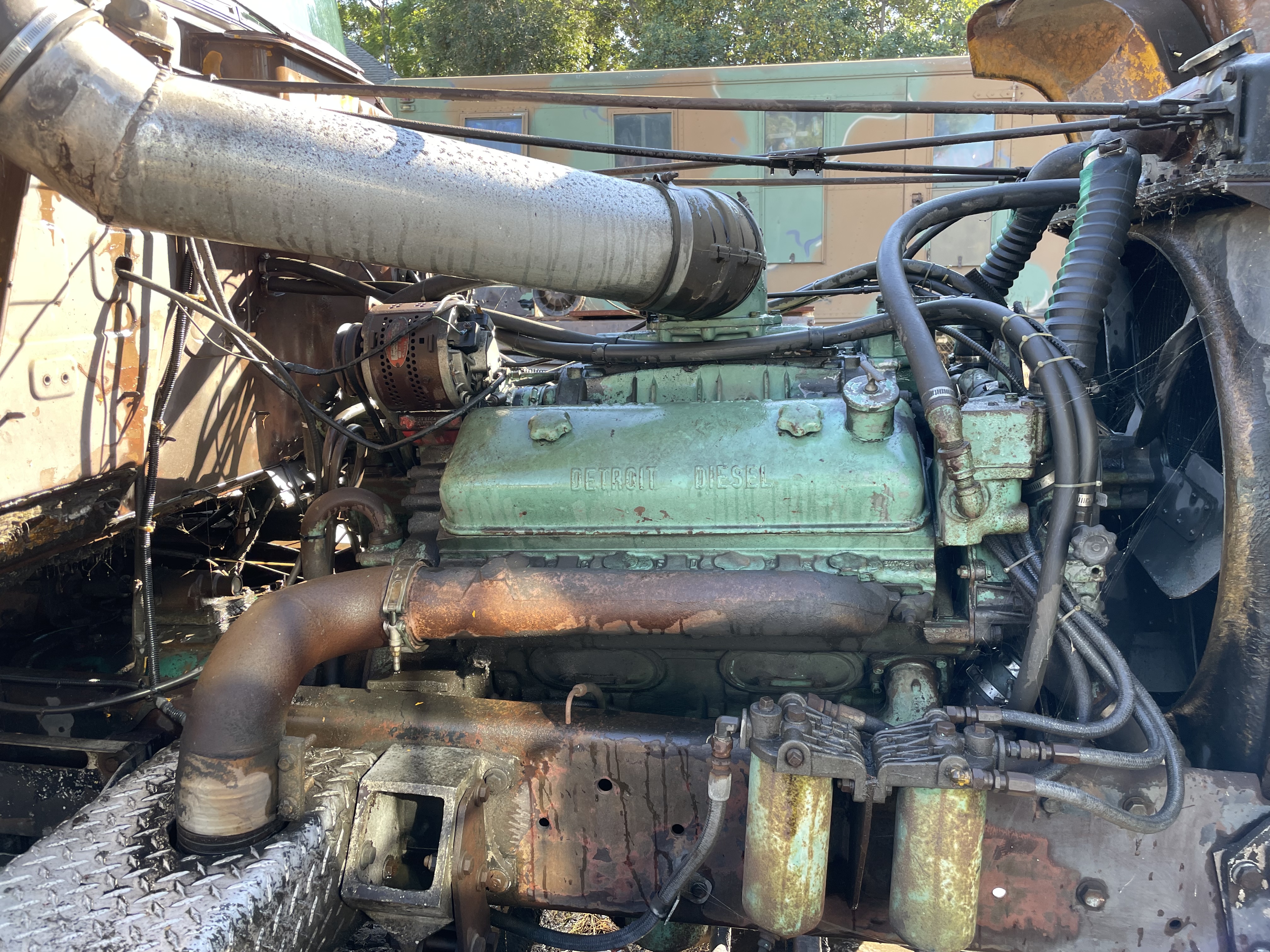

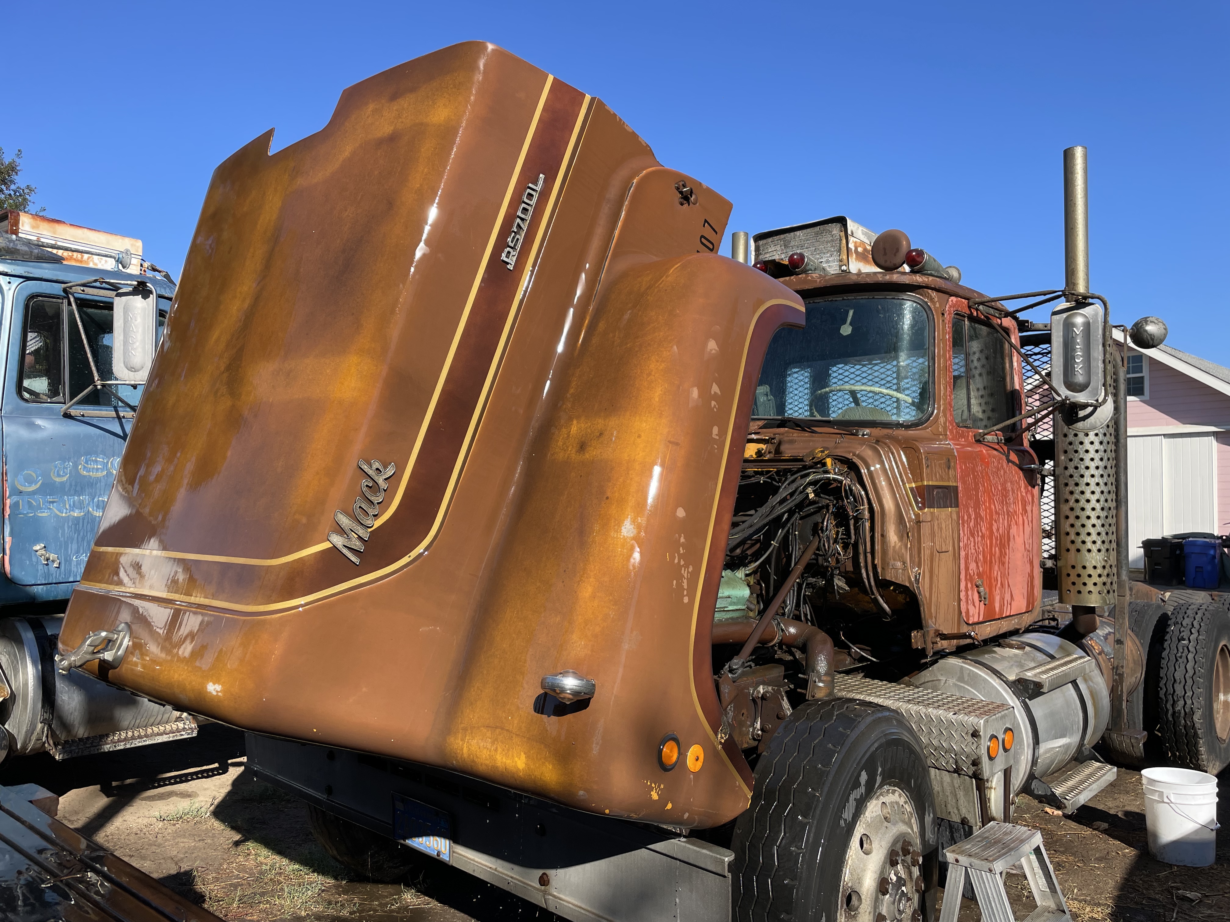

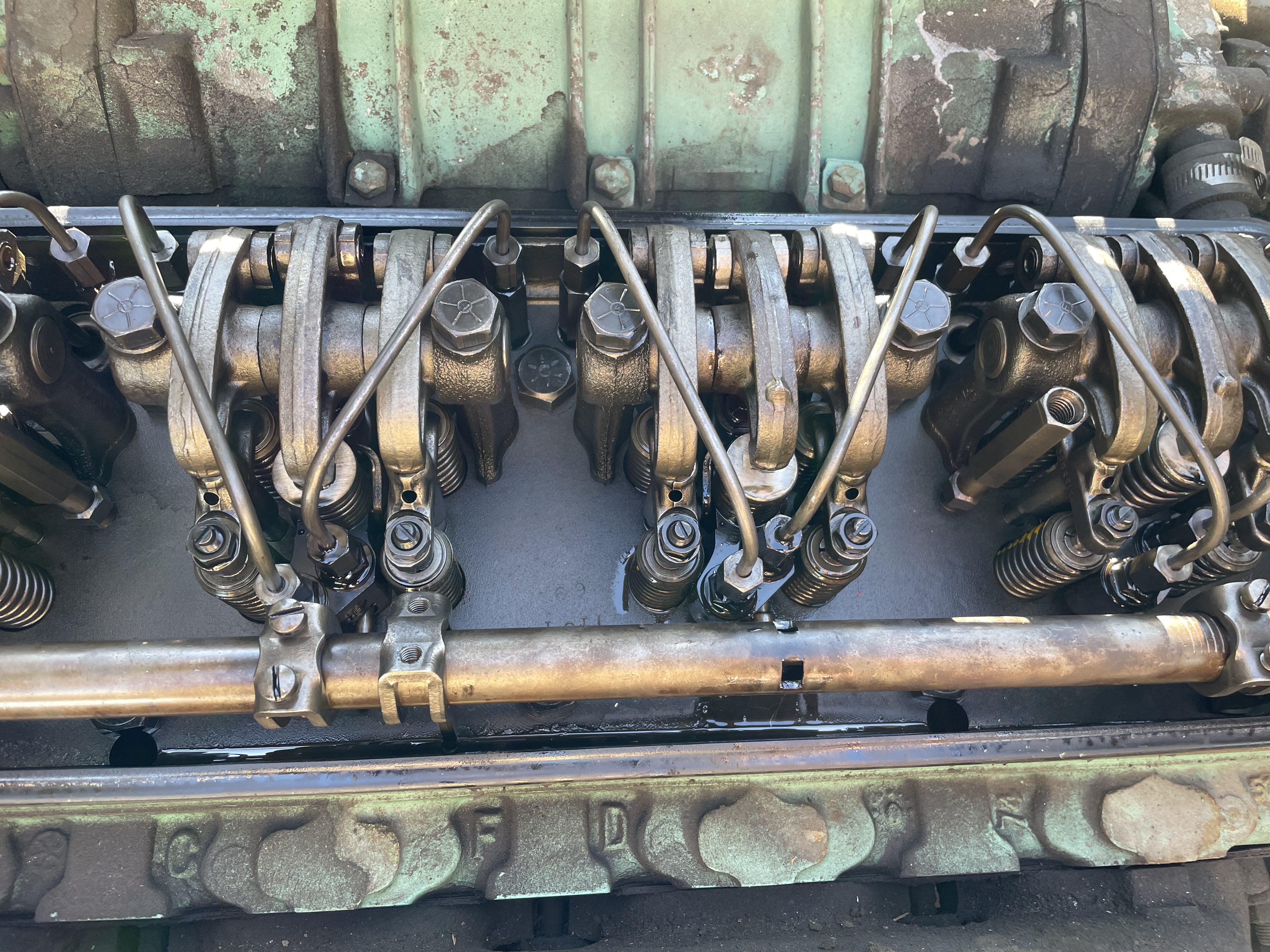

Today was fun we found the second injector on both sides were stuck. The drivers side one was easy to free up, the passenger side one required the removal of the rocker bolts to gain access. Then we discovered the truck was actually positive ground. then the starter solenoid was not behaving We did get the truck to run but there is no fuel coming back from the lift pump. now we need to change the filters and work on priming this thing

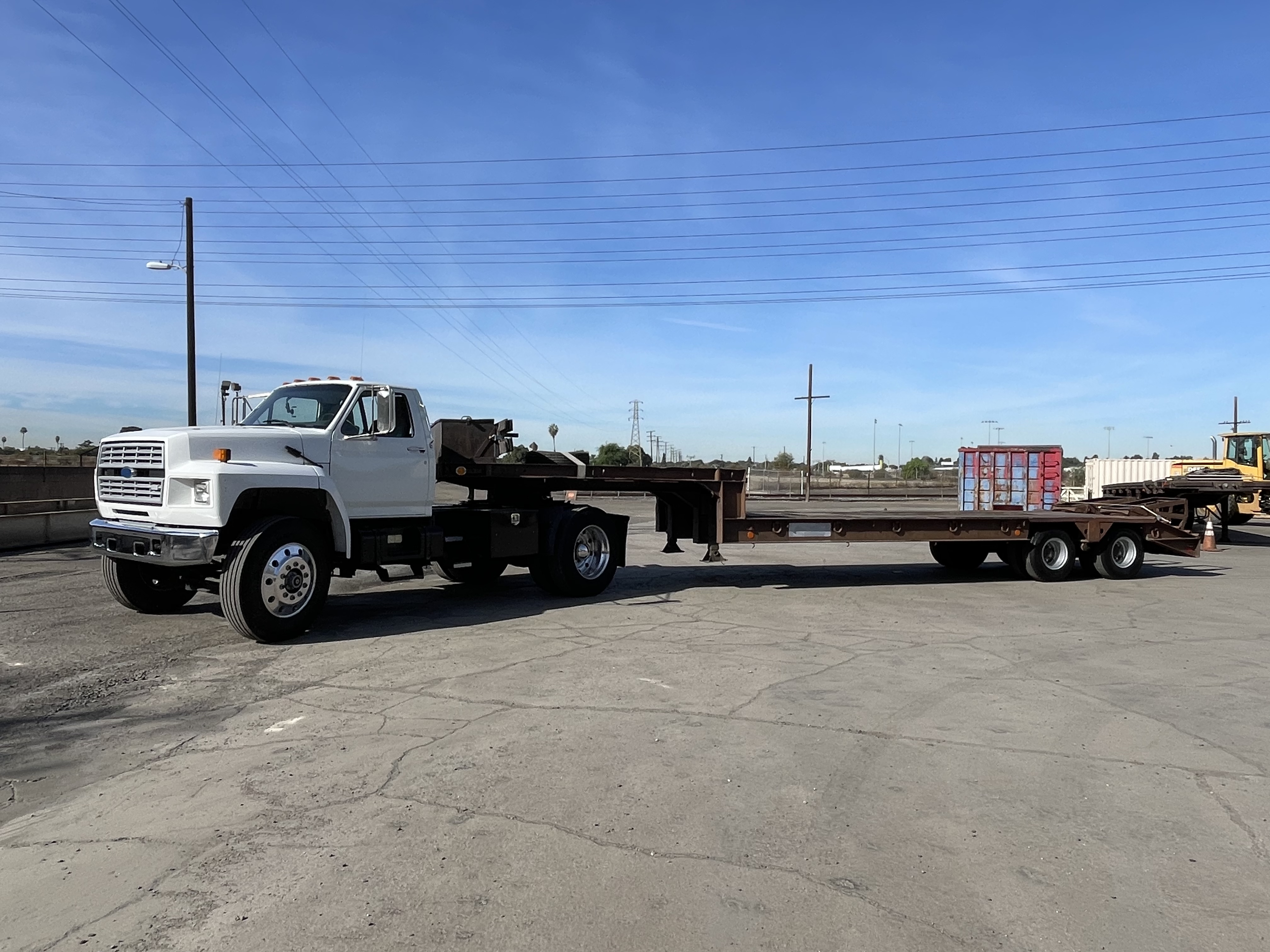

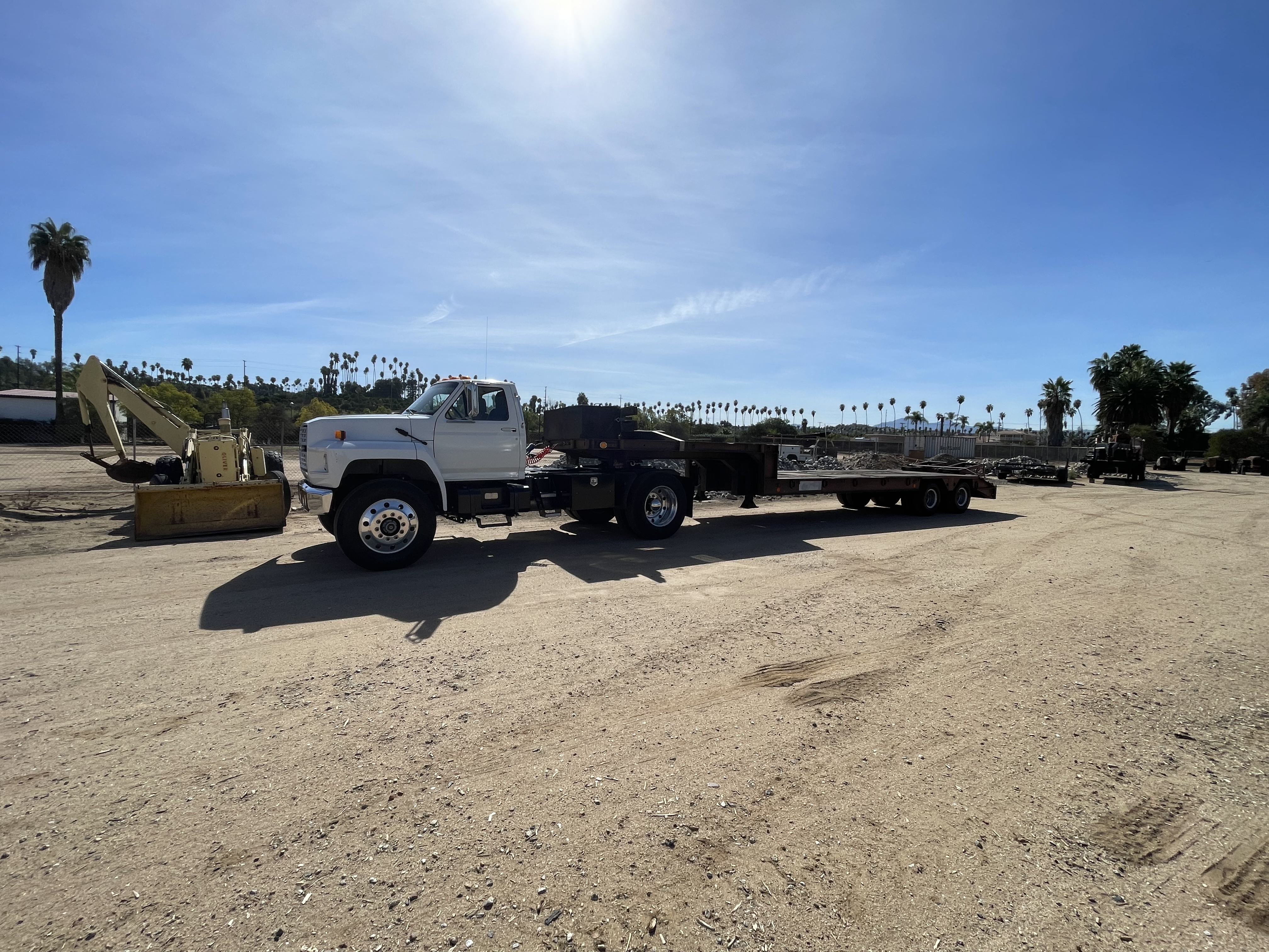

This is one the trailers the this Mack used to pull. It is now in storage at a friends house. This is also the first time the little ford has pulled a trailer since changing the rear from 4.88 to 3.90 and it did fine now I am looking for some 6 lug 15” wheels

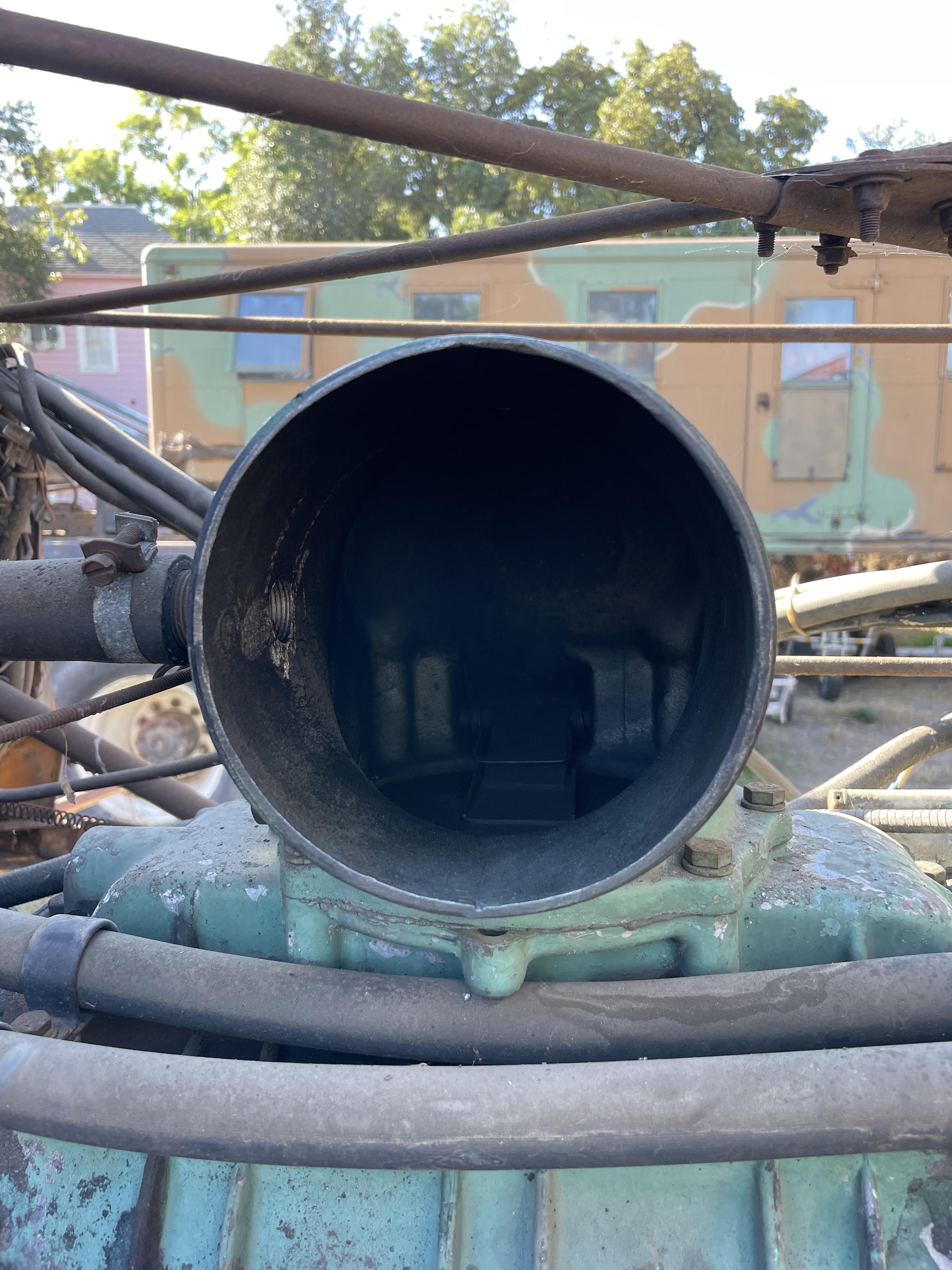

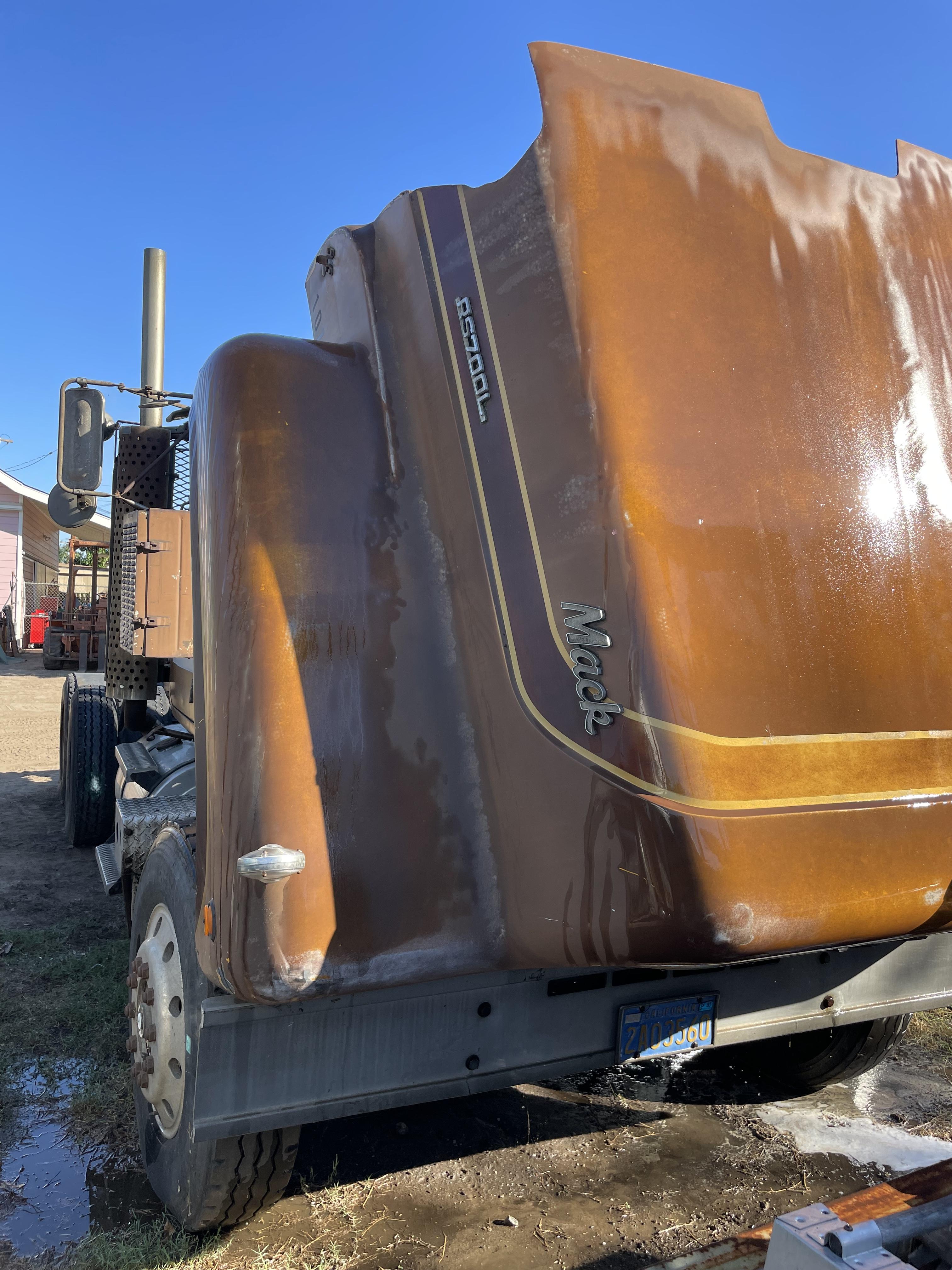

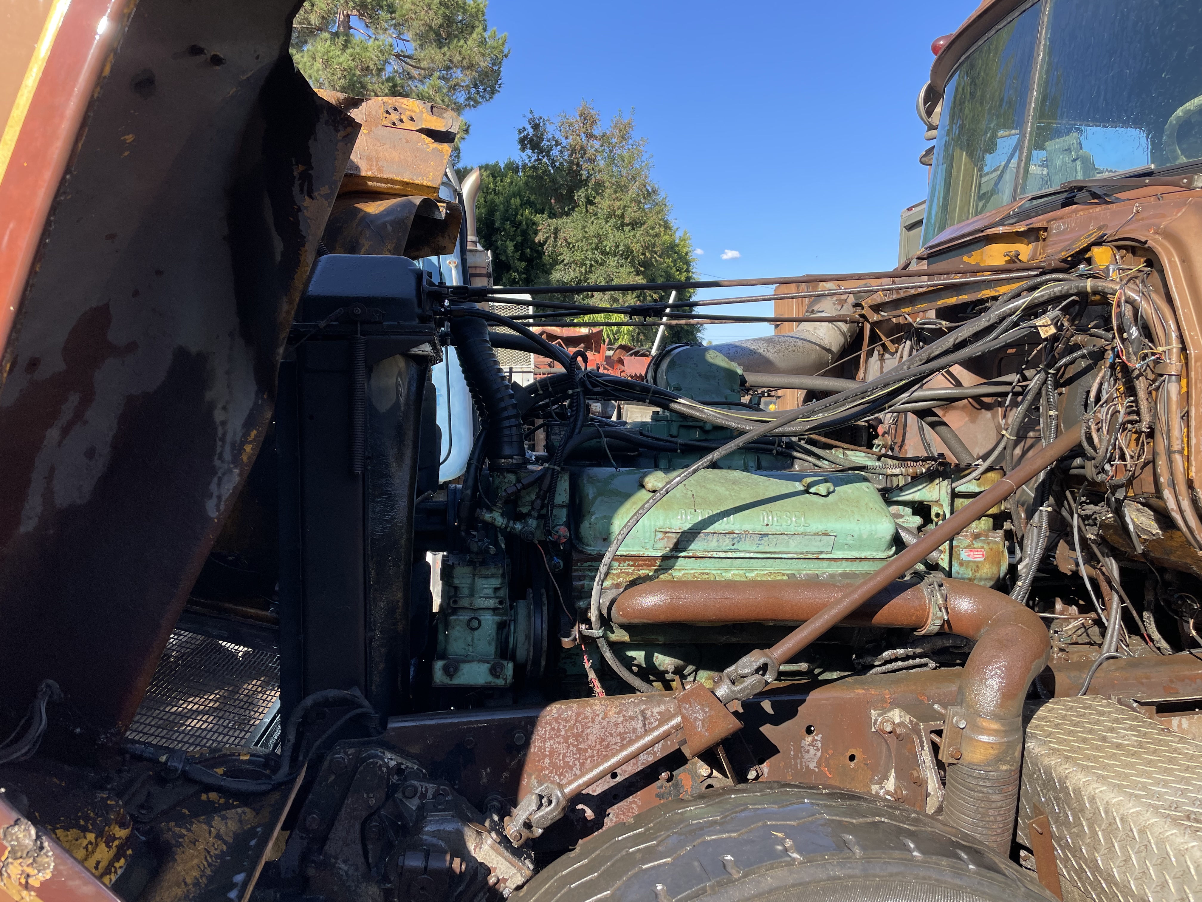

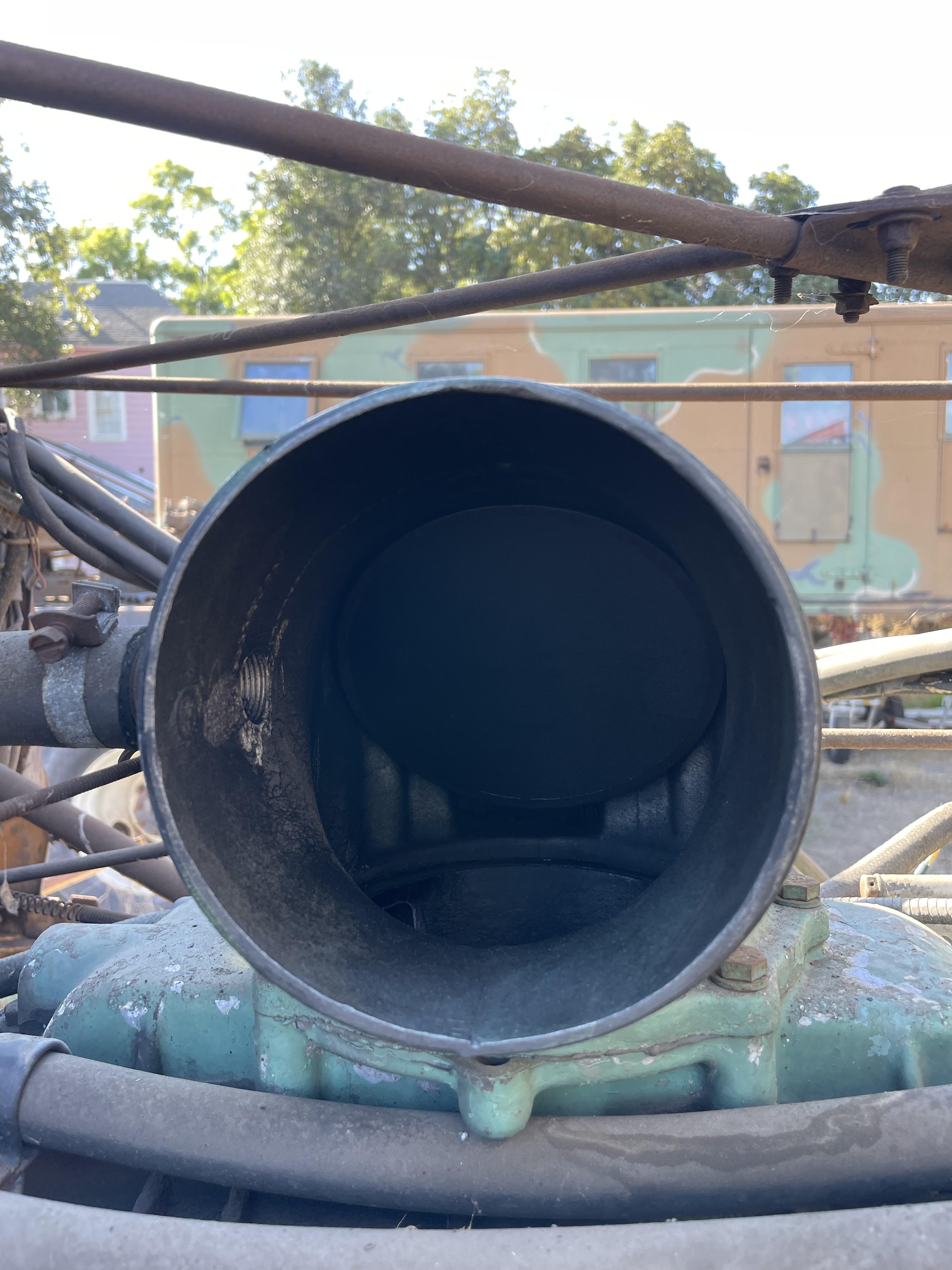

The black powder was on the dirty side of the air cleaner. The place that this truck came from supplied the foundary industry and that back dust is all over the site. the clean side of the air filter element looked new. The pipe was also clean inside
I have been working on this truck slowly due to other commitments. yesterday it got new batteries today I took apart the air filter and air intake and did not find any surprises. I dumped out lots of fine black powder from the air cleaner element which supports it being used in the yard since 1993. In the Farr air cleaner do you clean the outer screen? I also checked the emergency stop and it works fine and now I see how to reset it, pictures are a little dark but in one it is open and in the other it is closed I also got to use my long 1/2 inch snapon flex ratchet to bar the motor over two turns

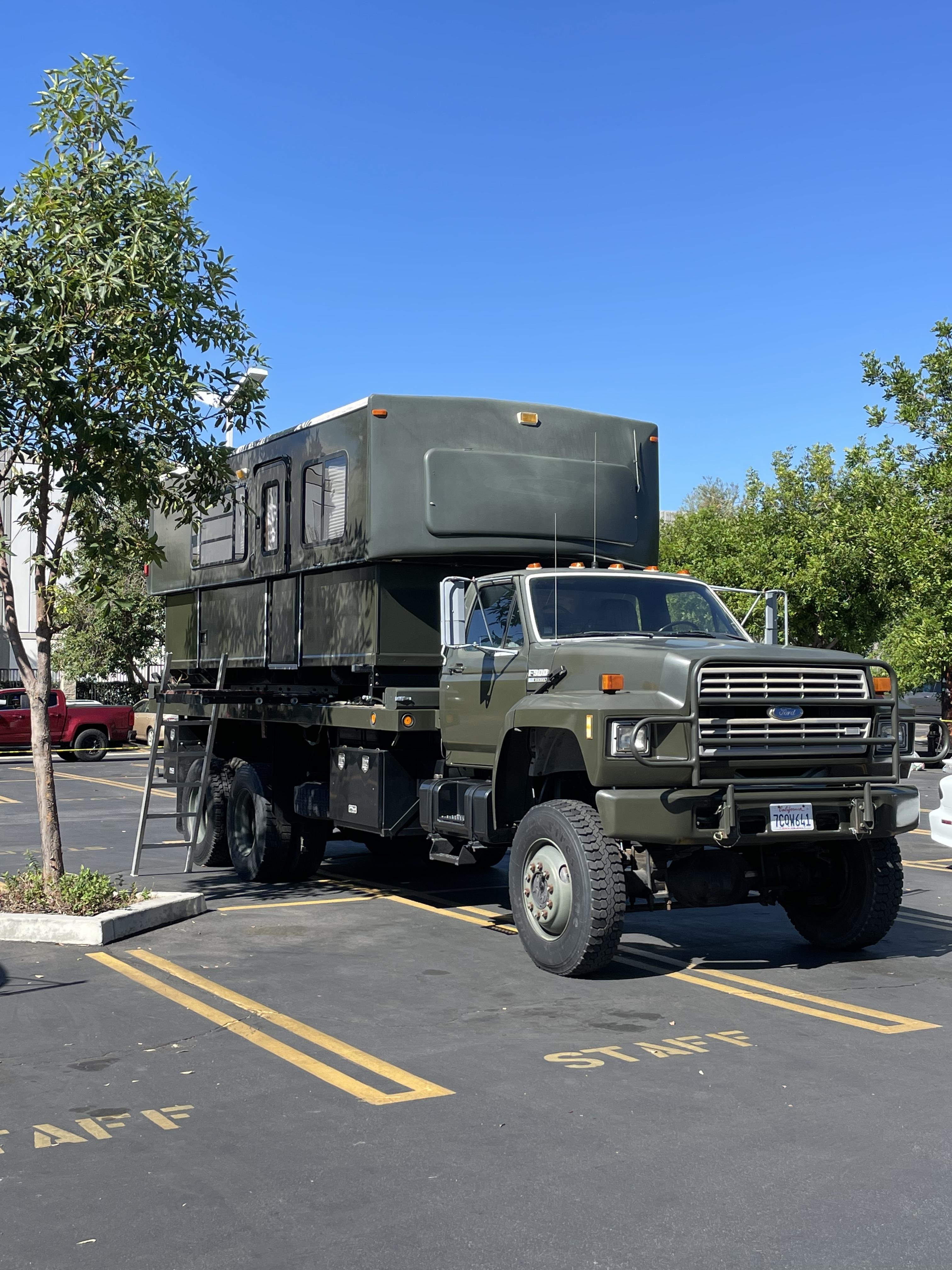

The issue with changing the gears is not the rear axles, it’s the front axle. In order to remove the differential you have to disassemble the entire axle and the current ratio is the fastest ratio that that carrier can use. So I would need a complete center assembly and I could only go from 4.92 to 4.25. if I really decide to do it the current best solution is to replace the Allison with a 13 speed

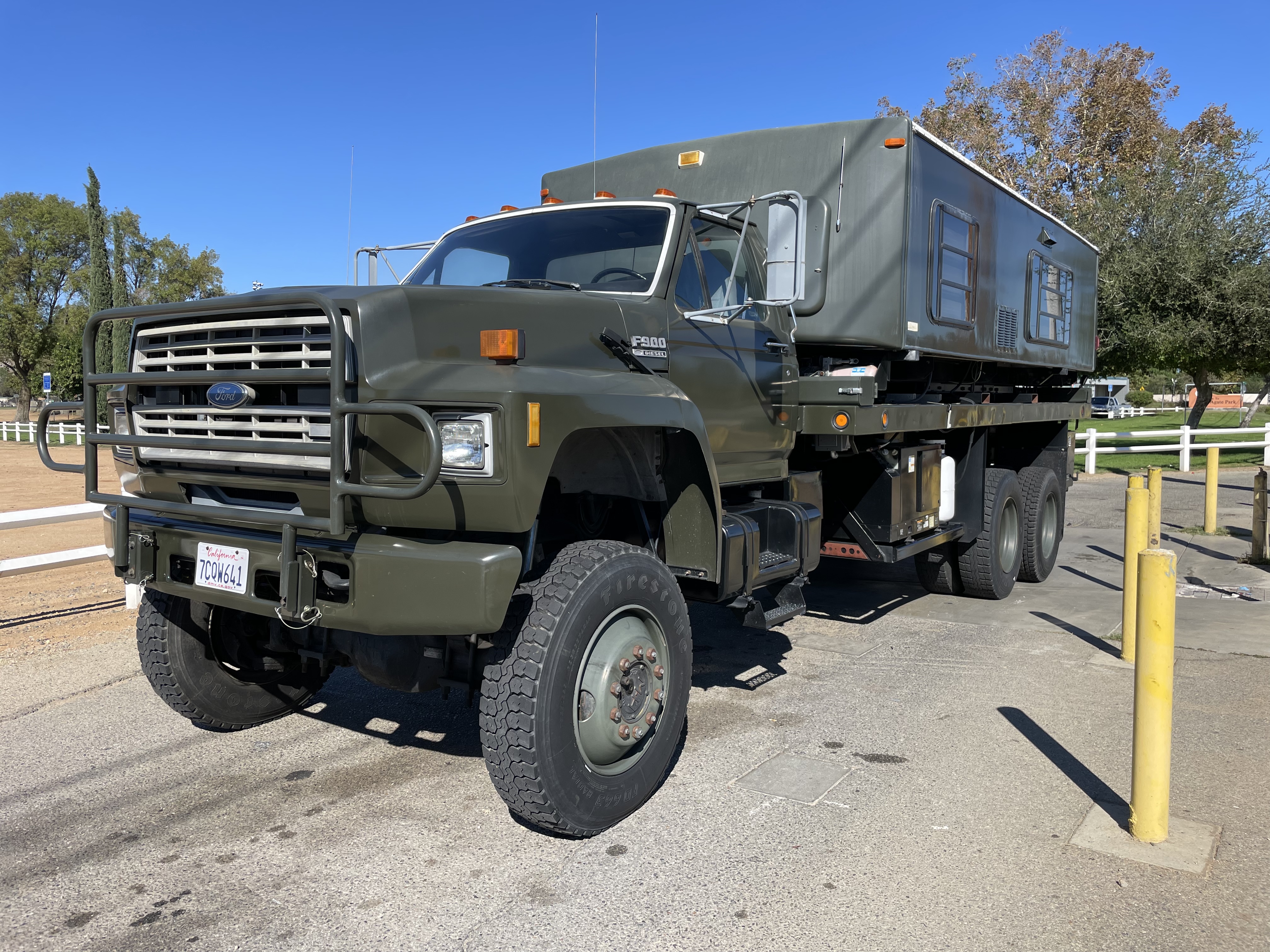

Thanks the green truck gets a lot of attention everyplace we go. At the UTI show the teachers were more interested than the students probably because they saw how much work went into getting the truck to this point and I still have a lot to do. right now the truck cruises at 58mph at 2500 rpm. I would like to drop the rpm and increase the cruise speed but with only 210 hp 7.8 ford I don’t have the power I want. Every option I have come up with costs a lot of money and quite frankly I get there, just slowly. So I may just insulate the cab better and turn up the fuel a little and call it good the wife wants stairs, more water capacity. I want to delete the spare tire, or modify the mount to carry a BBQ and close the gap between the bottom of the camper and the bed

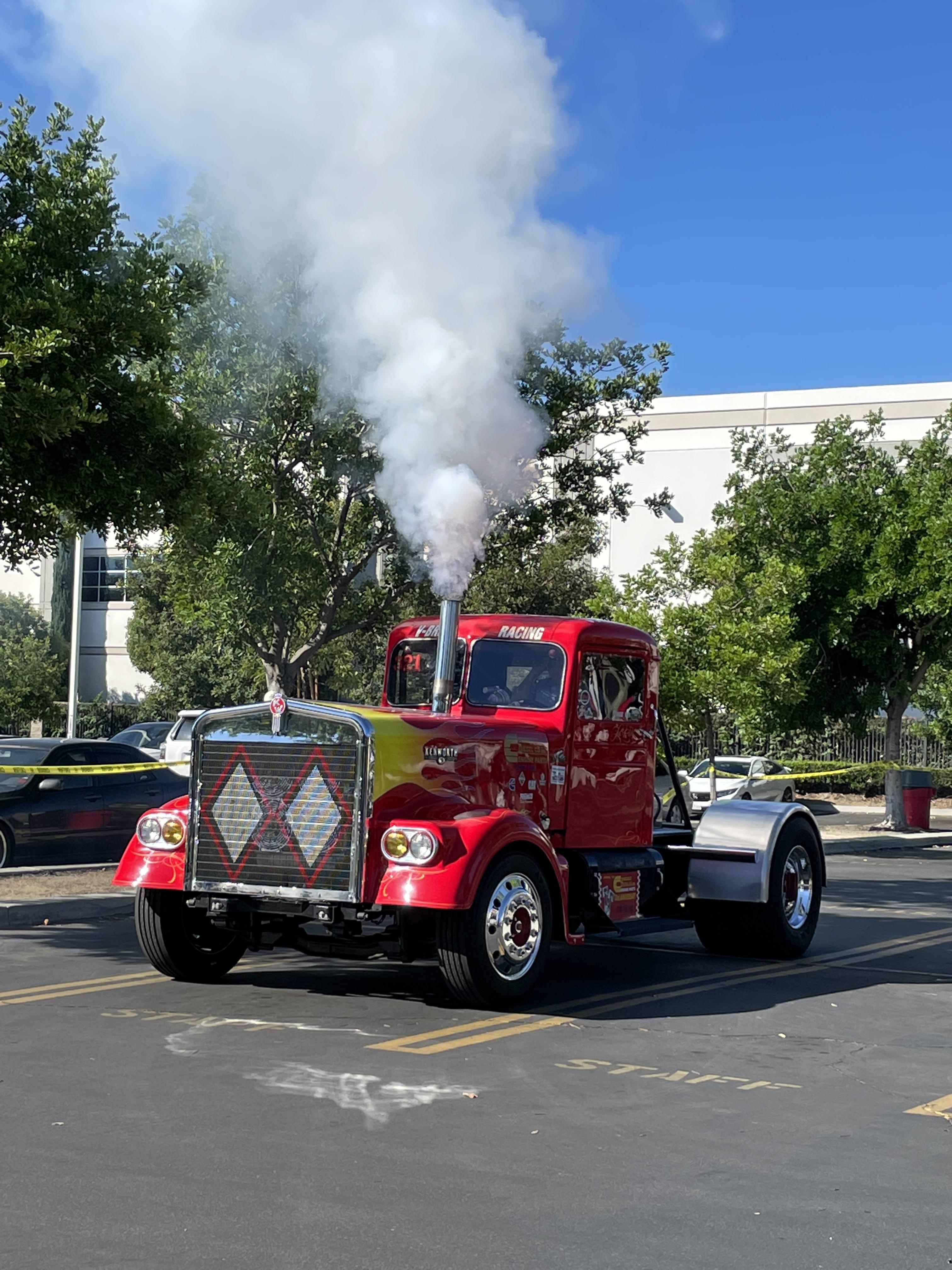

Not yet working on getting the parts to replace the passenger side glass i charged a spare set of batteries for it and will soon try to start it washed it on Tuesday, as well as two other trucks. I took the green truck to a car show at Universal Technical Institute today and this red truck showed up making lots of smoke here in Southern California 75 miles in LA traffic is so much fun but the green truck has an Allison so it was bearable
