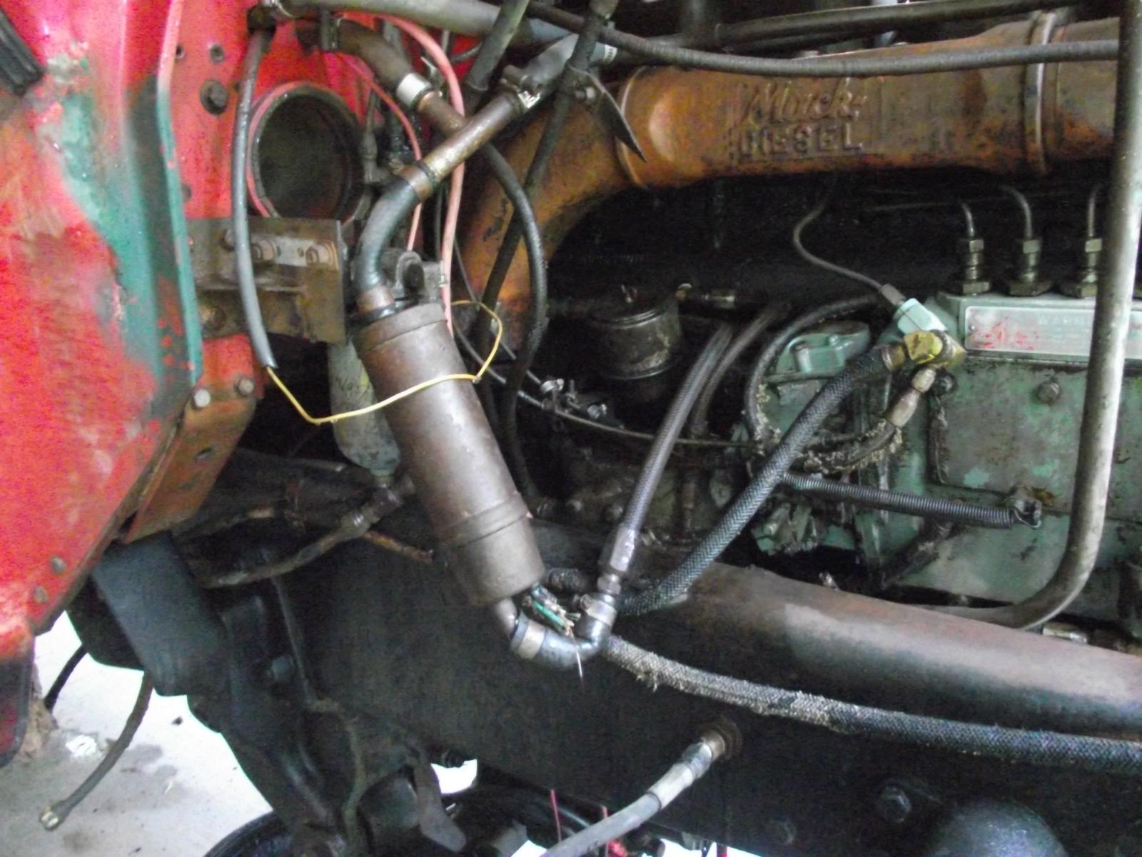

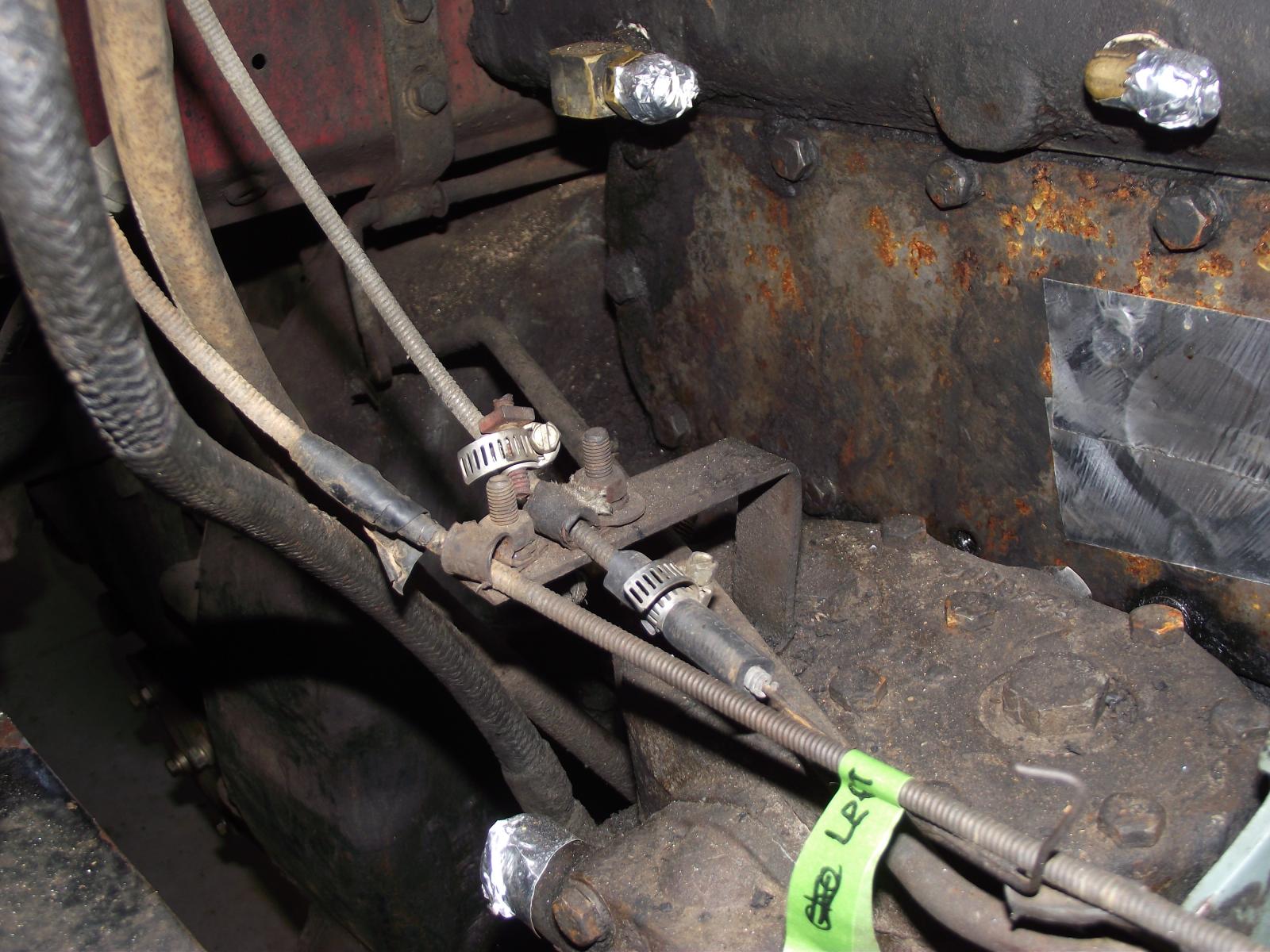

What are these two lines from the block?
razorback11 replied to razorback11's topic in Engine and Transmission
I believe you have all nailed it. The canister thing has wires running into to that have been cut so it was probably a block heater. So let me ask then, If I run a line from the forward fitting to the air compressor, and replace the rear fitting with a petcock/drain valve, does that sound like a way ahead? Bulldog, I see your first picture, the line coming off of what I would term the forward fitting, but I can't see where it leads to. Can you explain? Thanks all. -
