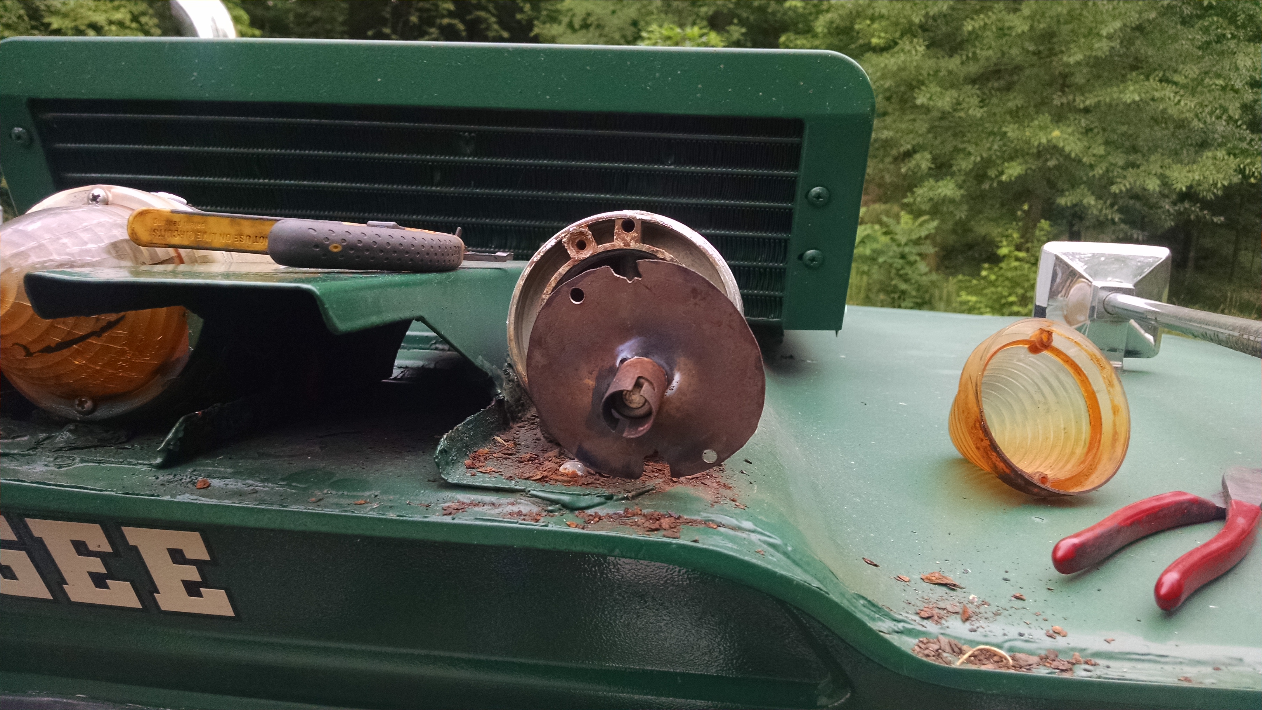

as of now,ive replaced the cab lock cylinders,replaced the small v shaped latch assist spring on bottom of right side latch with one sold at ace hardware,hydraulic hose going to right latch replaced,re position cab jack in bracket,swap tanks from right to left,positive grounded alternator rebuilt,replaced the primer pump on the injection pump,part# AMBAC INTERNATIONAL #MP 404760,fits the Robert Bosch/united technologies pumps, remade the metal pieces in the cab clearance light which was completely rusted away,ive also ran a new 6 wire cord from front to back to fix the tail,brake and turn signals,and have a few extra wires left to hook up a backup light,alarm,located a aluminum fab shop in the next town over that can cut the tank and install a wall,2 inch threaded bung and vent cap for me,ive also got pricing and availability on a PTO/ pump combination with special adapter that fits the maxitorque 10 transmission, tracked down the exhaust brake system [Blue ox] that im using on the motor,ive also replaced the threaded rod running through the right morror as it was found dangling by one end the other day,and today im installing the pins to hold the battery covers still,spring on air hoses/trailer pigtail,

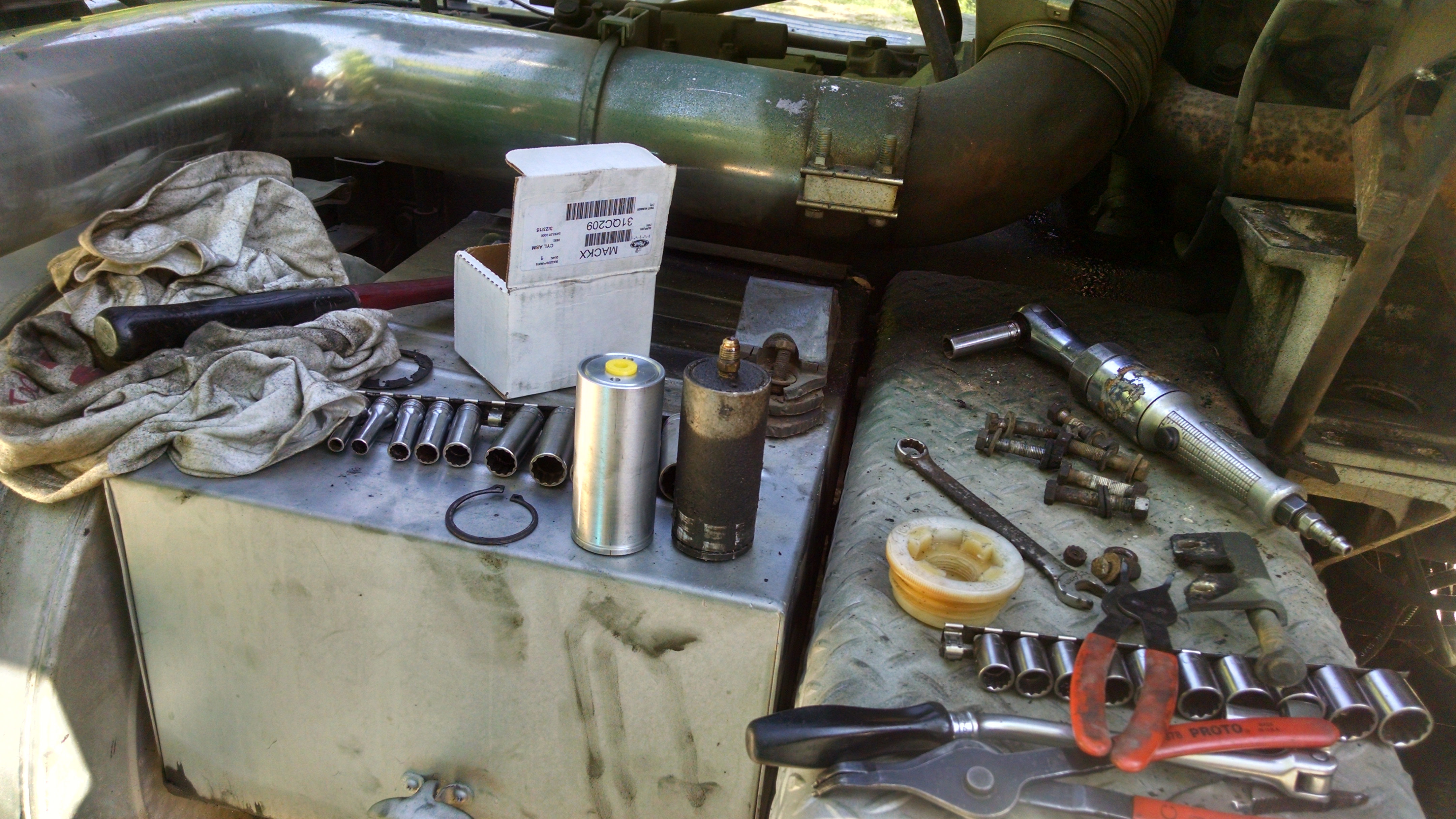

pulled the injector again today,took it to turbo diesel injection in Forest park,they had it ready for me by 130 this afternoon,said it was leaking at the split where it comes apart,,got home and popped it back in,i was giddy with excitment as i waited listening to it run,and no more leaks,now i can move forward to the next phase,,thanks AZB755V8 for the sound advice,
pulled the injector and iddnt see any seal in the bottom,replaced with seal but still leaks,may pull it again to get the injector checked,found a head online but dont know till i talk to them if its been checked for cracks,are they fairly easy to spot?
thanks for the good advice,i stopped in at the injection shop today and picked up a few copper sealing washers,the injector in question is the one behind the shifting box,im thinking i can reach everything and take it all loose and skinny the injector out,i planned on working the truck so im going to have to somehow get it right,its pulling a dump trailer,but a 24 ft one so it wont have more than 24 tons to drag off from a stop,
