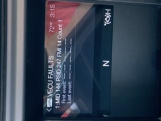

Not really,my dealer said not to worry about it that it was inactive and that all trucks will have random faults that don’t mean anything

Does anyone know what this fault is? MID 144 PSID 247 FMI 14 on 2020 Mack granite with MP8 engine, my engine brake doesn’t seem to be working like it should was wondering if this is associated with that fault. Thanks
