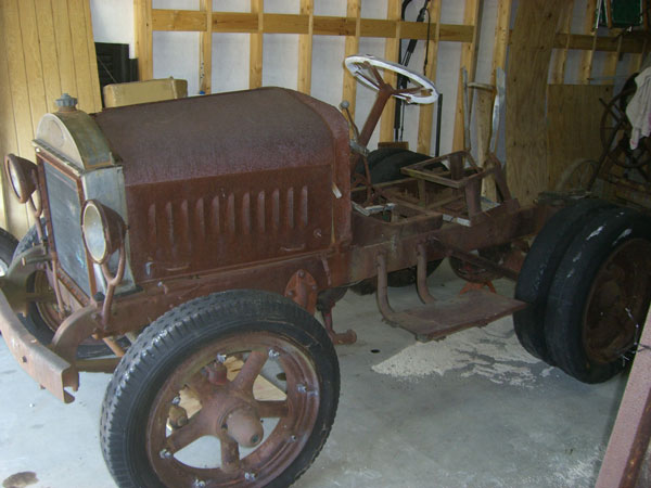

  9. Thanks Jim. I've contacted the Mack museum and they told me not to expect anything till after the New Year, due to a four week backlog,, guess the boys are busy. I've got a weeks work to make a proper place for parts and breakdown of the truck. Then I'll start parts hunting and a complete off frame rebuild.

  11. I just got this Truck a while ago and was told it was a 1924 AB. I'm checking out the serial number at the museum now. Hoping to bring her back to life soon.
