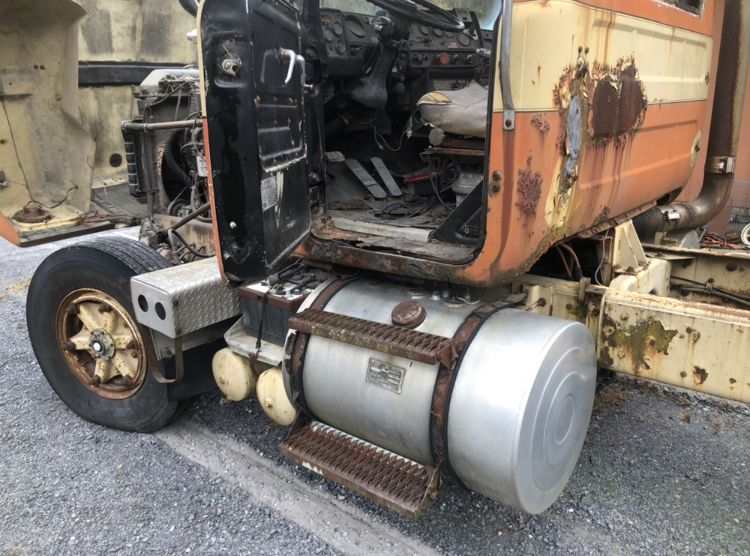

  11. Brought it home today. Has original sales receipt and build sheets with it. My question is. What other cabs interchange with a western r700? This cabs shot. But has almost perfect aluminum doors.
  12. I just got home today a RS753 it has the 1674 cat with a Eaton 13 speed
  13. If you don’t want 4wd I’d look into using a bread truck chassis
  14. It has a 1674 cat and looks like a 13 speed and 4 spring reyco. I think the L in the vin means light weight? Looks to have a bunch of aluminum brackets. Cab looks to be about beyond repair and hood is broke several place too. I’ll keep ya’s posted.

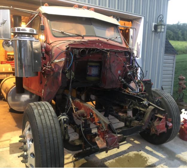

  15. Finally got the engine out today. Made plates that bolted on the intake rear head and the exhaust front. Came out nice. But now I have a question. My engine is sitting level on blocks on the shop floor and the bell housing has a bolt directly at 12 o’clocK. The Tranny is also sitting on the floor level and has bolts at 11 & 1. How is the bolt spacing on a standard B? I know my pattern is to create the 18 degree tilt of of the engine and keep the tranny level. Just wondering wich is different for the b67.
  16. I’m really thinking of cutting my sheet metal and converting it into a tilt front. Just got the engine out and once I get the new steering box squared away that will be next. I spoke with Kevin All he is in the process of building and going to sell original looking fiberglass tilt fronts for the B.
