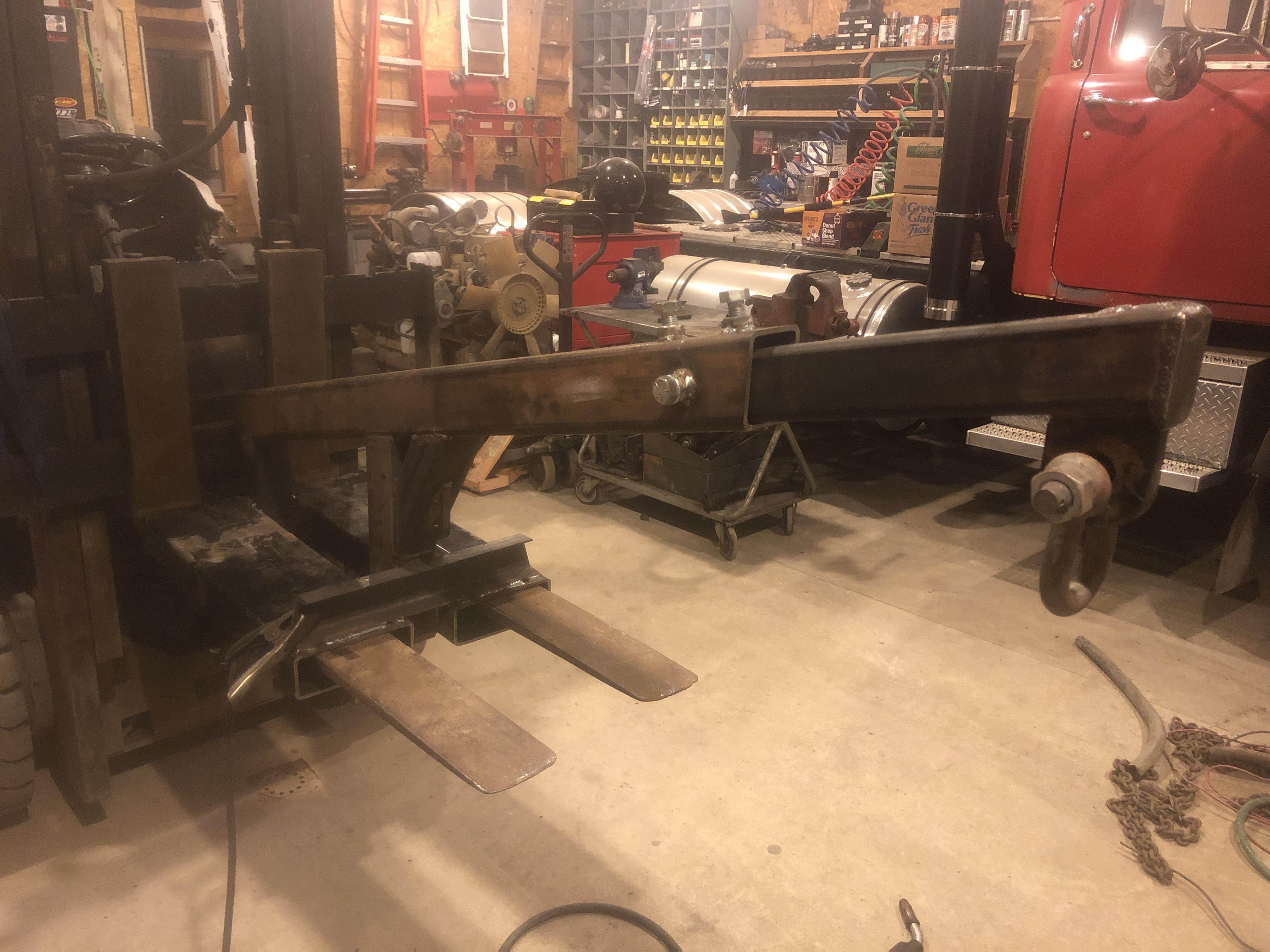

  8. Just like the title says. The purists out there will prob be upset and the Mack gods unhappy. This is the beginning of my Cummins swap. I got my crane made up for the forklift so it’s soon time to try it out.

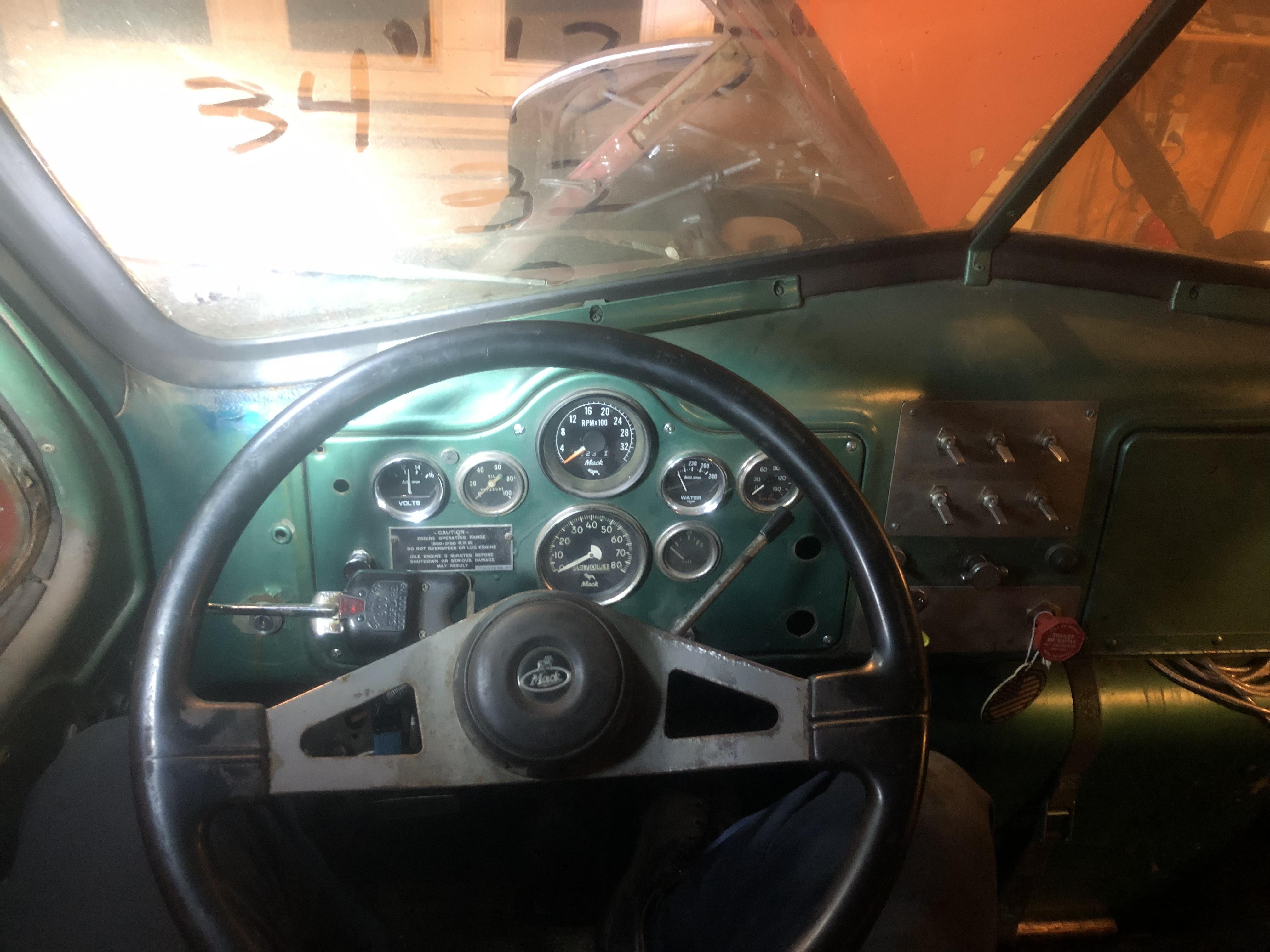

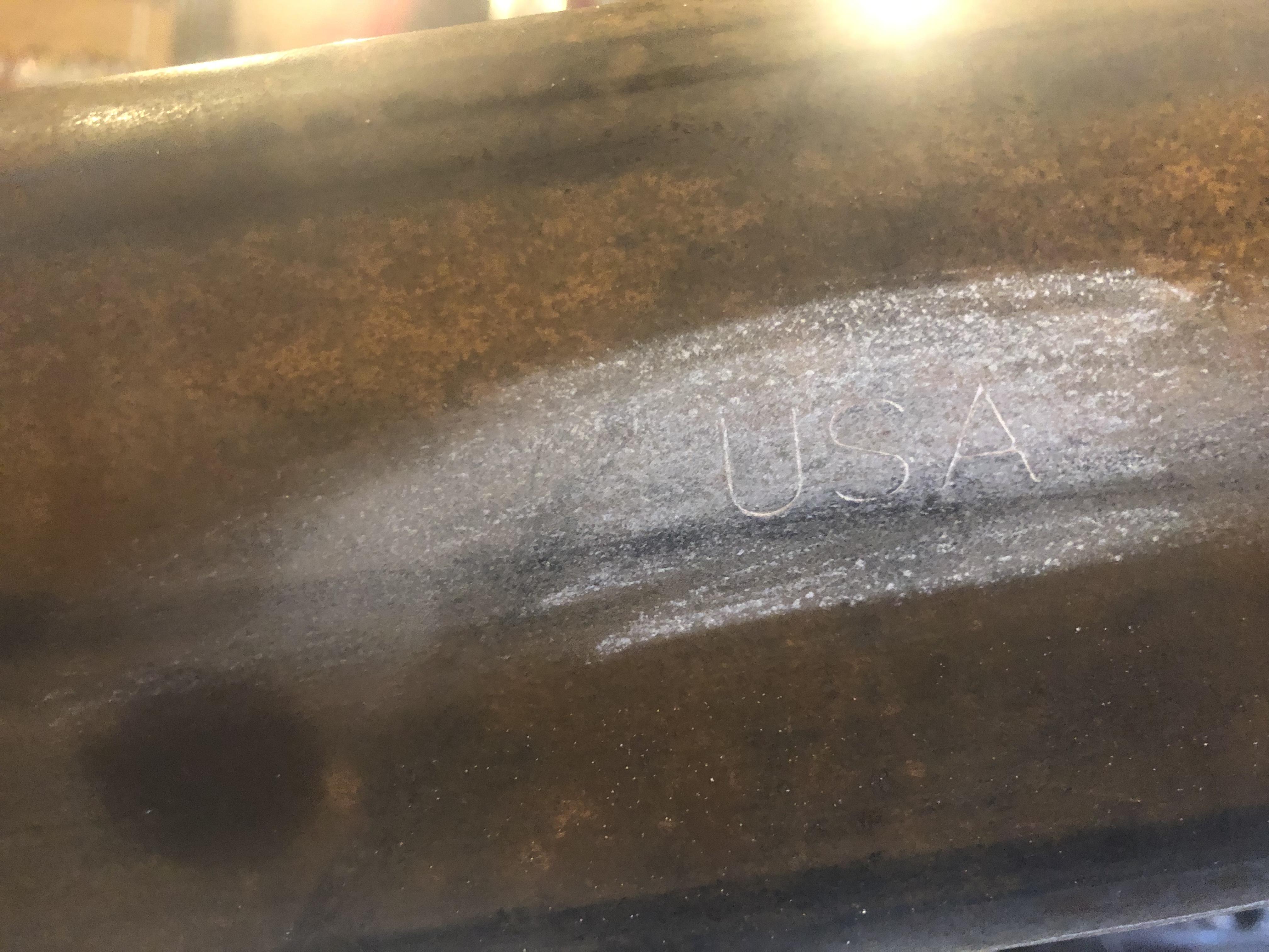

  12. Here’s what I came up with. Look what I noticed on the steel I’m using. The new stuff I bought is USA 🇺🇸. The older stuff I’m repurposing is Canada 🇨🇦

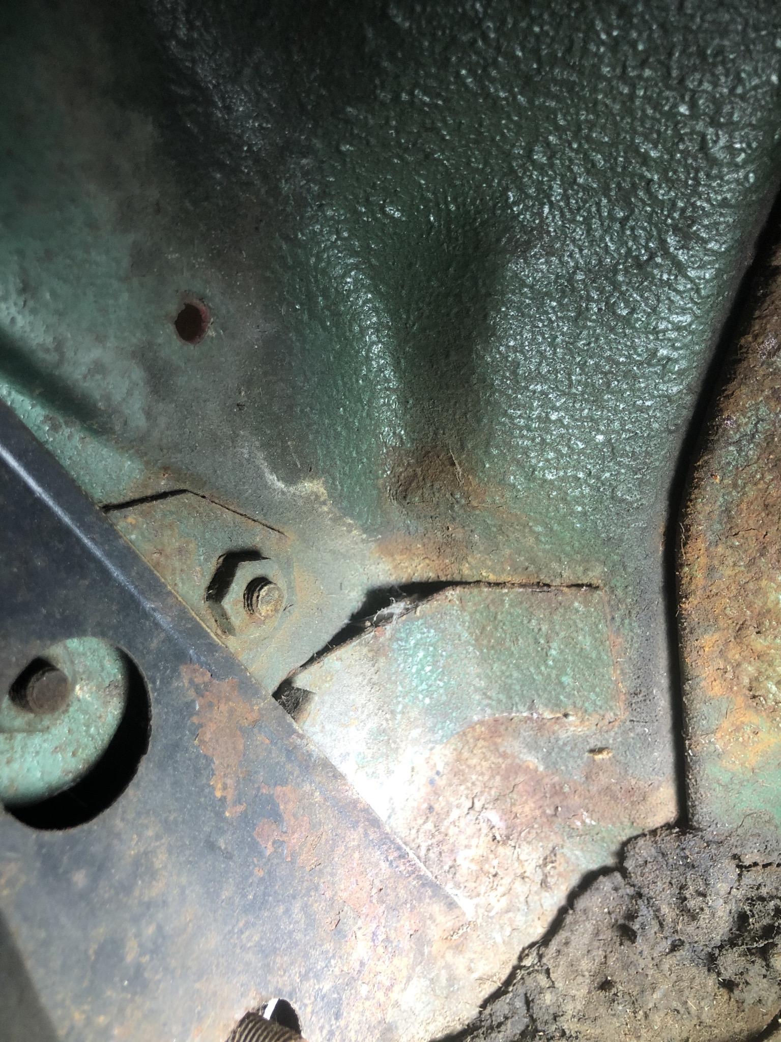

  16. Idk what that is. It’s just a small piece welded in from factory by the looks of it. Kinda like an extra brace? I’ve seen sever of them throughout the cab

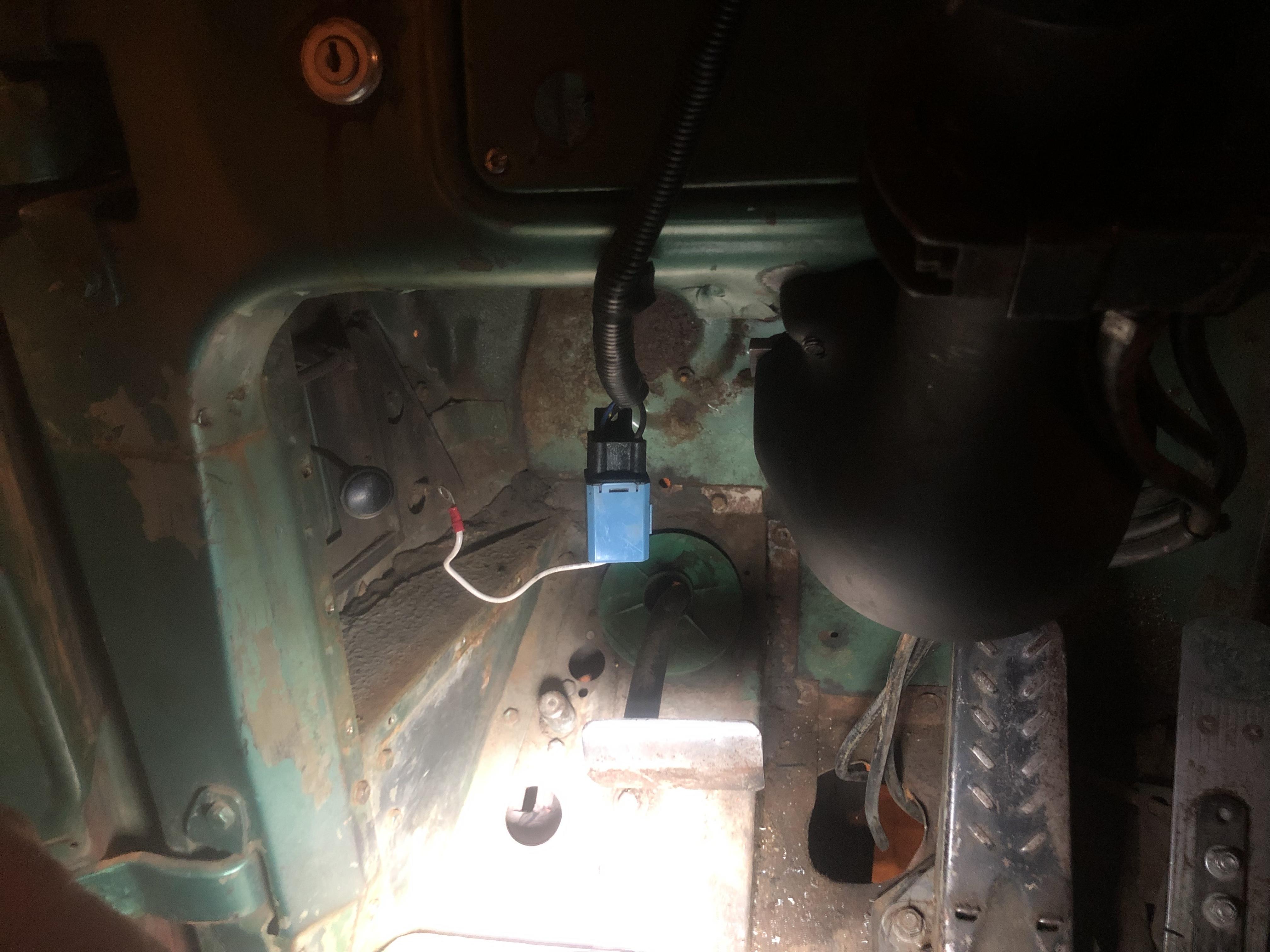

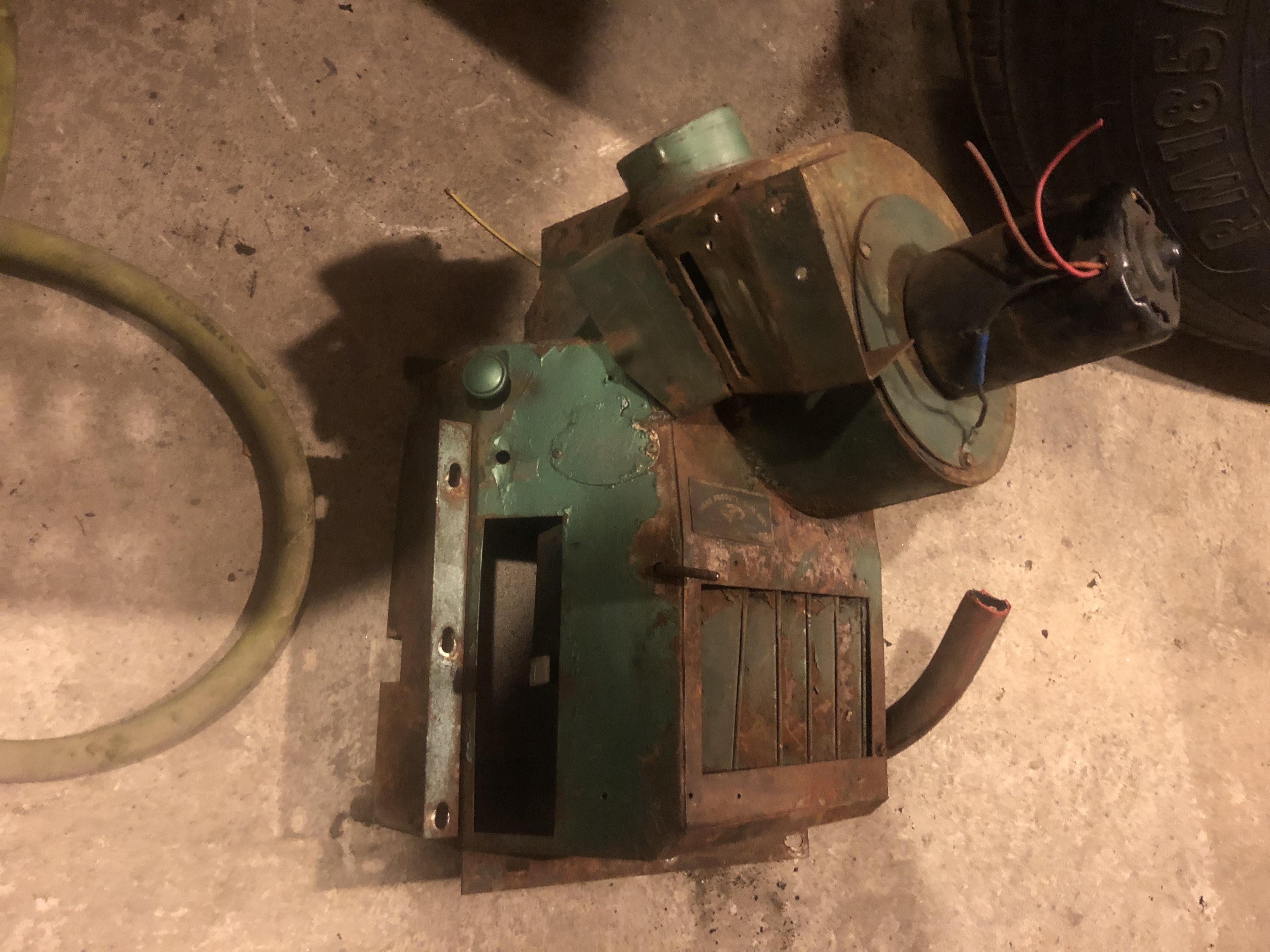

  17. I removed my heater assembly which cleared out some space so the floor dimmer is fine with me. I will save these other switches for probably forever though. Now I just have to do some figuring where to cut the hole in the firewall and what boot I’m gonna use.

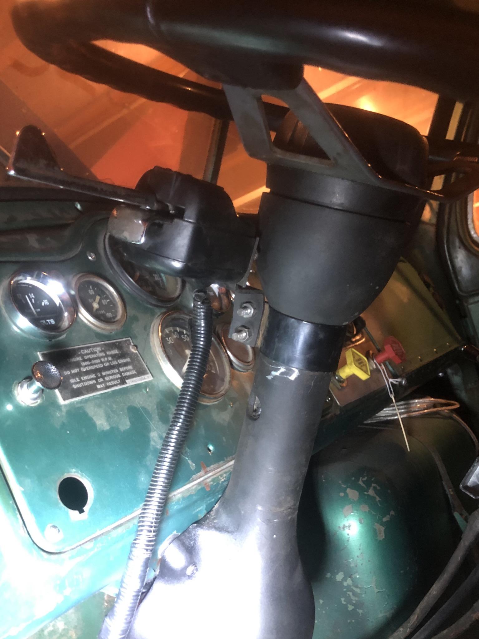

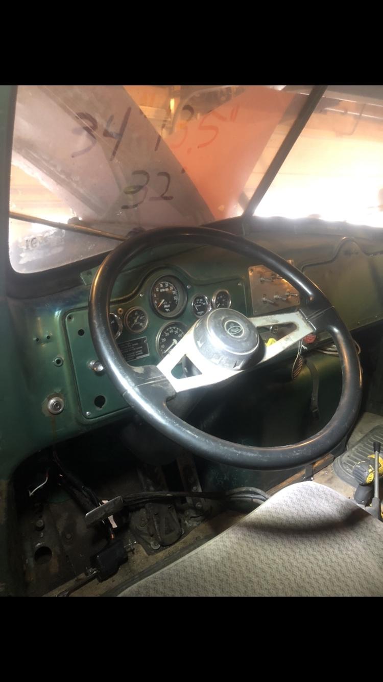

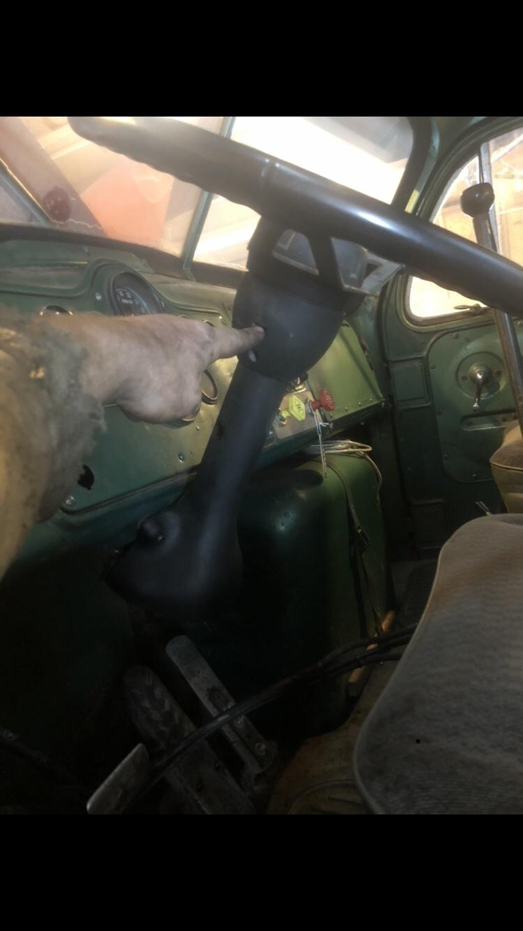

  18. I got 2 columns when I got. I decided to use this one due to the 18” wheel, other has a 20”. They where both from mr garbage trucks. I took the extra apart and Larry was right. Very ugly exposed shaft and spacers. After further sitting on my garage chair I realized they also had 900 series (non canceling) turn signal switches. Same as my B but they have dimmer switch. I was able to switch the clamp and bracket to my already wired switch. It raised the switch and moved it forward.
  19. I really don’t know what it is. I’m guessing just decoration. It it be nice to move the blinker that much further up though
