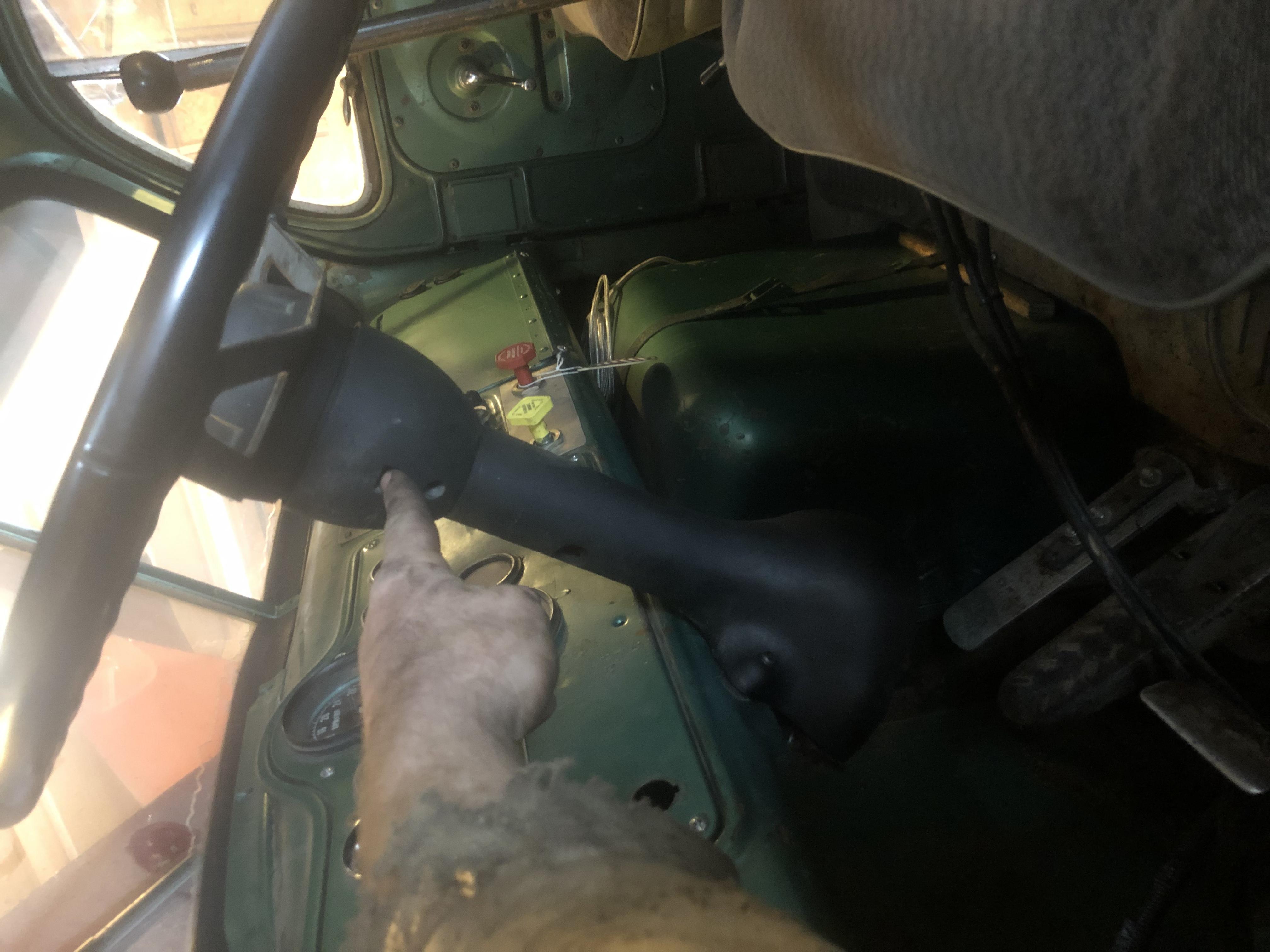

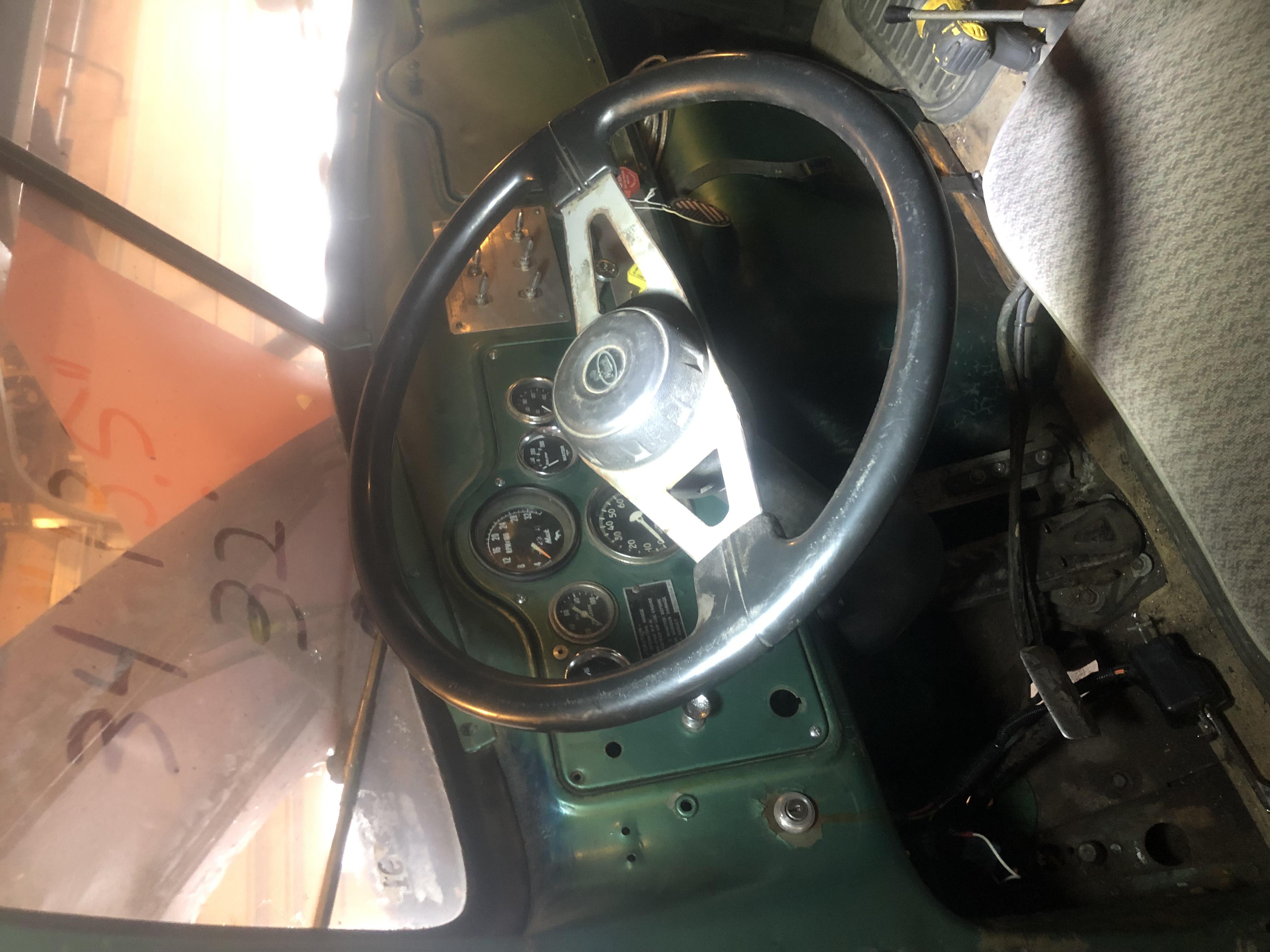

  1. I got my column all mounted and I’m happy with the wheel placement. It’s very comfortable from driver seat. Now my question is. What is this bell shaped piece on top of the column? Can it be removed and if so how? If I can remove it I will be able to mount my turn signal switch and trolly valve higher up.

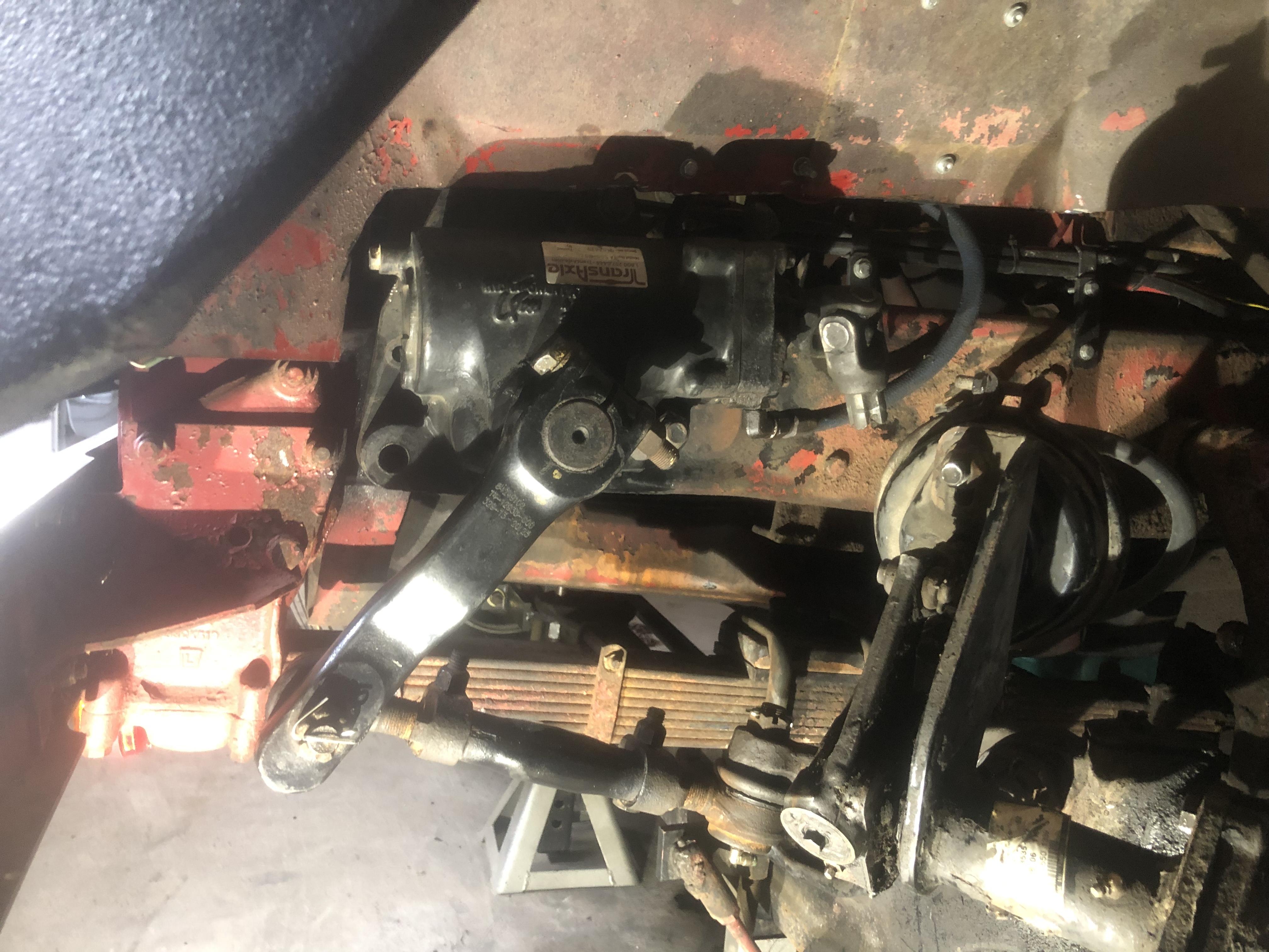

  7. After a few hours I got it out. But not after using sawzall on shaft above box. Floor layout gave me issues and also tilt of engine kicked oil pan flange and sump. Once I got the sector shaft below the bottom flange of the frame I couldn’t get the box below the flange on the block the oil pan bolts to. Then after cutting column off about 3” above box I got it wedged between spring and sump. I don’t really remember what I did then but eventually it came out. After several hours I was running out of blood and patience. It may come out all together but it didn’t for me.

  10. B67 steering box. Will it come out of the truck with the engine in and cab on? I’m not sure but I think this is a specific question for a b67. I think the 61’s are mounted a little back further. I’m not sure. I don’t want to get it stuck part way then have it in the way to pull the engine, and I’m not ready to pull the engine at this time.
  11. I agree vlad. When it comes to mixing parts one must be careful. My front axle is modern freightliner, my pump and steering box came off the same truck also modern freightliner which had the same 8.3 c series Cummins in that I’m also switching to this winter. So I’m theory my steering should feel just like driving a mid 2000 freightliner fl70 or fl80 down the road.
  12. I’ve been messaging with davehummel on this topic because he has done a similar conversion to his, but Here is a pic of my current progress. I don’t think This steering box would work on a truck with an original axle. There wouldn’t be enough room to turn to the right very far.

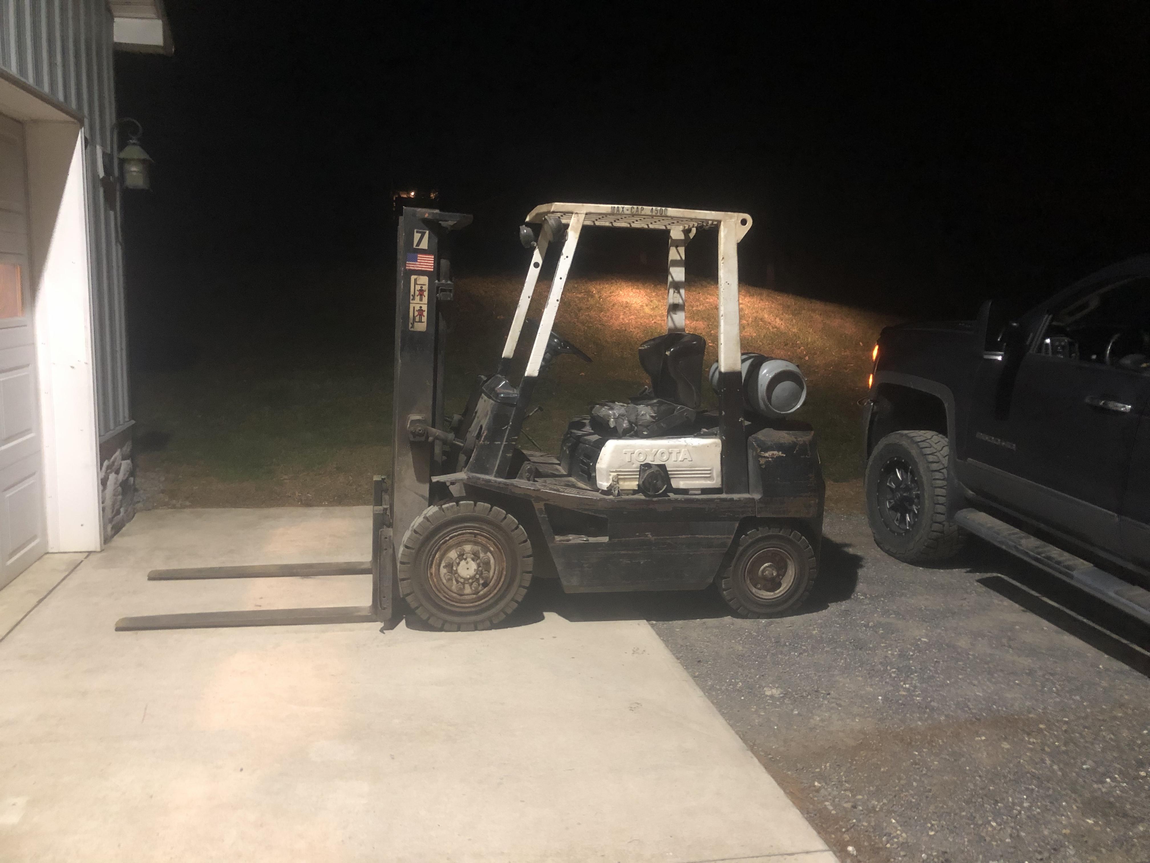

  16. It’s a 5000 pound lift and I have a few thousand pounds of suitcase weights to hang on the back if I need too. I don’t really know what the 673 weighs but my cherry picker is only rated for 1 ton handled the 8.3 ok.
  17. Forks are 46”. Off the top of my head it’s a 42-3fg25. Gonna make the boom about 6’ long I have two pieces of 3”x8” box about 28” long I’m going to use for the forks to go through and build off of them. Something like this but I’m going to make the boom raise up at a little angle. My garage is a little small and I have to work through the door opening. This will give me a little more clearance

  19. What you guys have? Things you Like or wish things where different? Bought a forklift for my winter engine swap project now looking into building or getting one. I’m looking for simple and fixed. I don’t think I want to mess with telescoping. Any ideas or measurements would be helpful.
