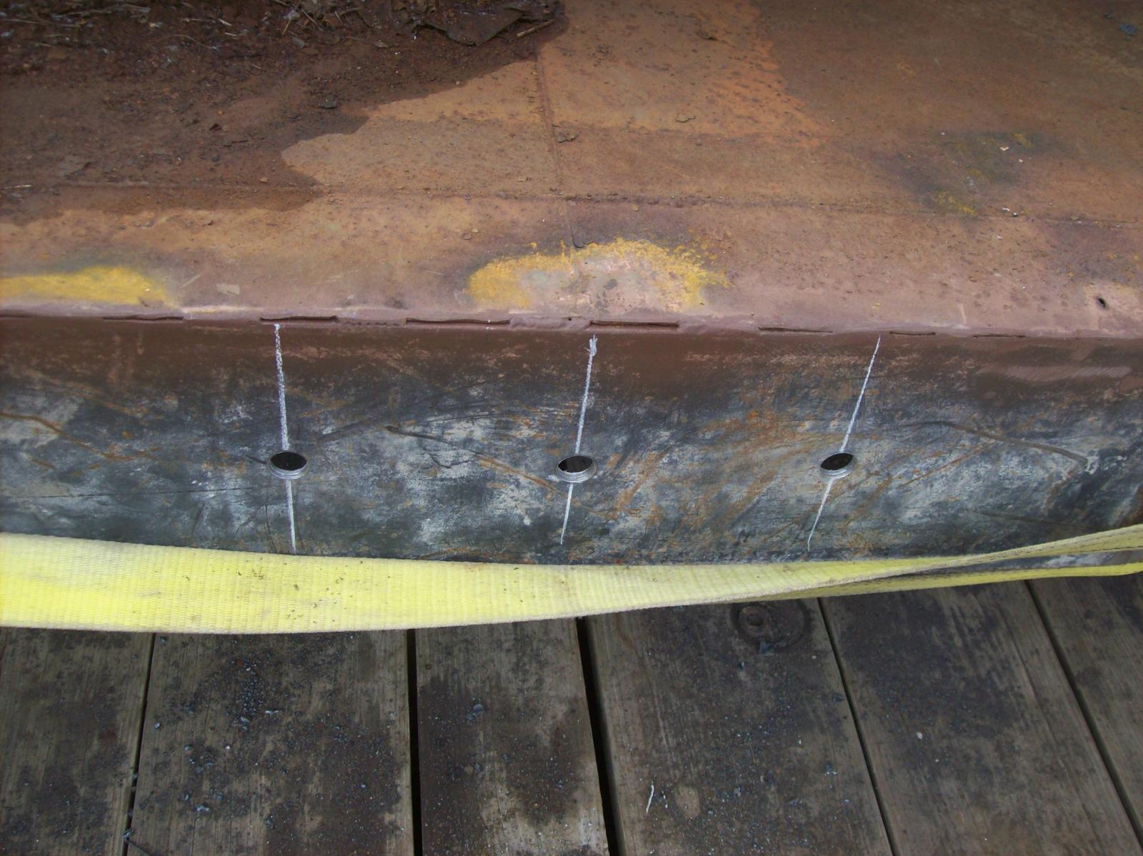

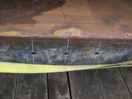

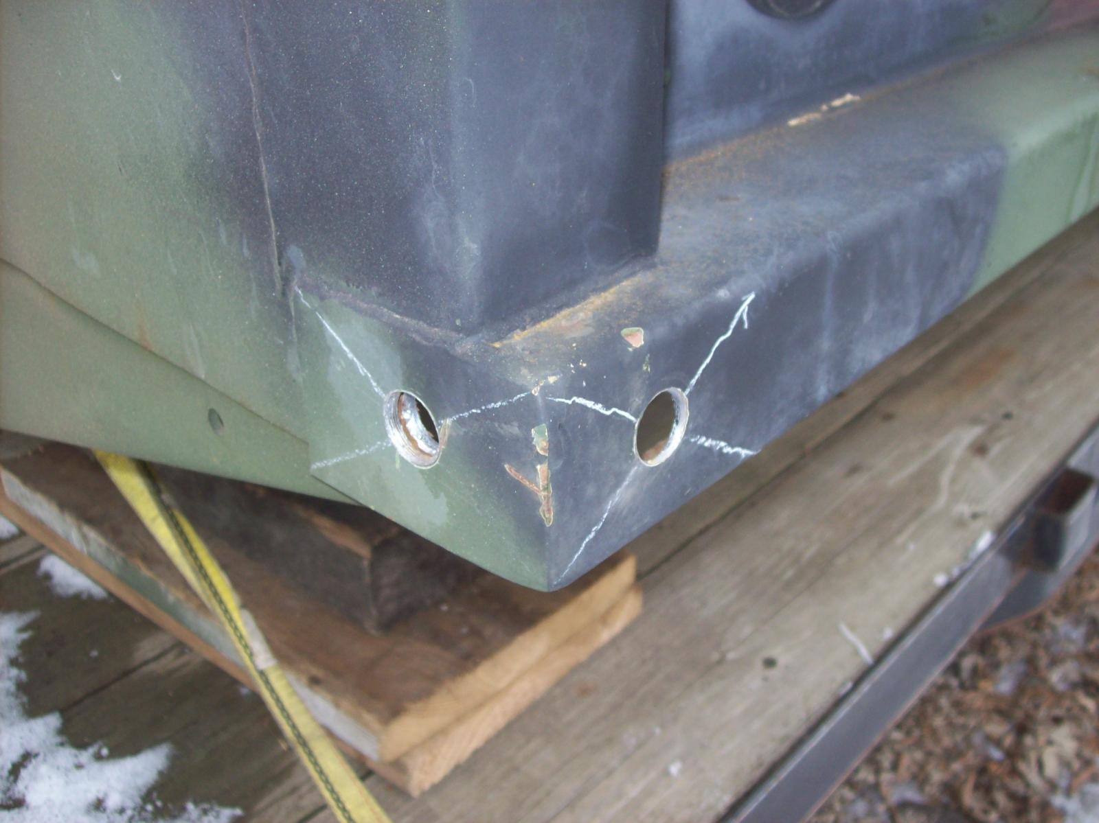

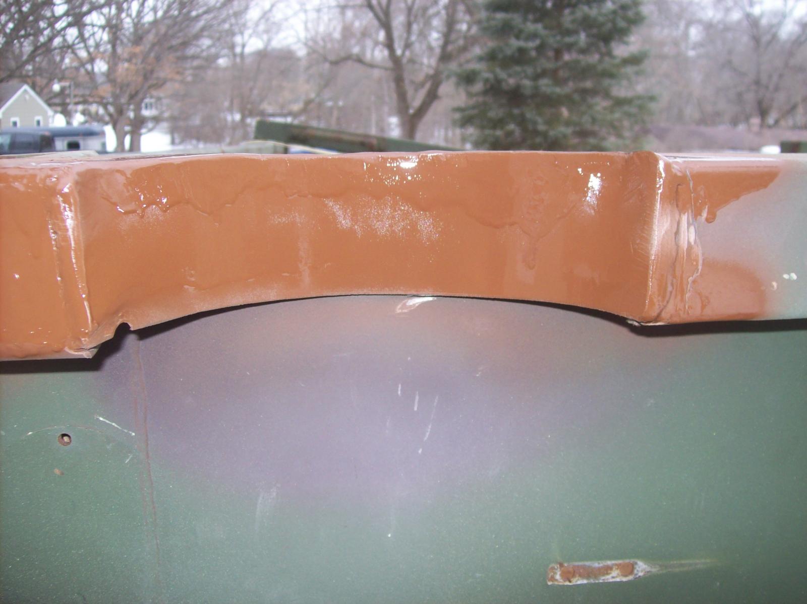

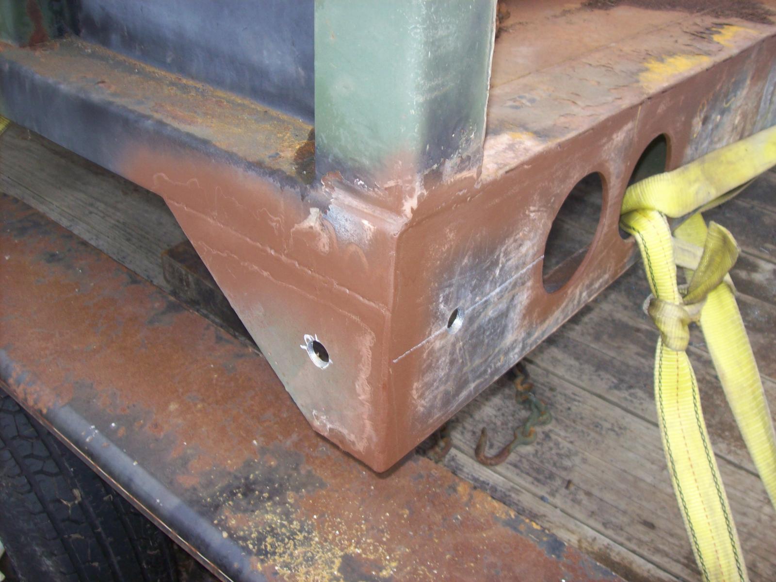

  7. Got more done today Im going with 3/4 inch LED clearance lights so I used a hole saw and got those all taken care of and where the I cut insets into the front panel where it gets close to the stacks and welded some sheet metal in to give the rolled edge some support I slobbered a bit of brown paint on the raw metal to keep the rust from forming.

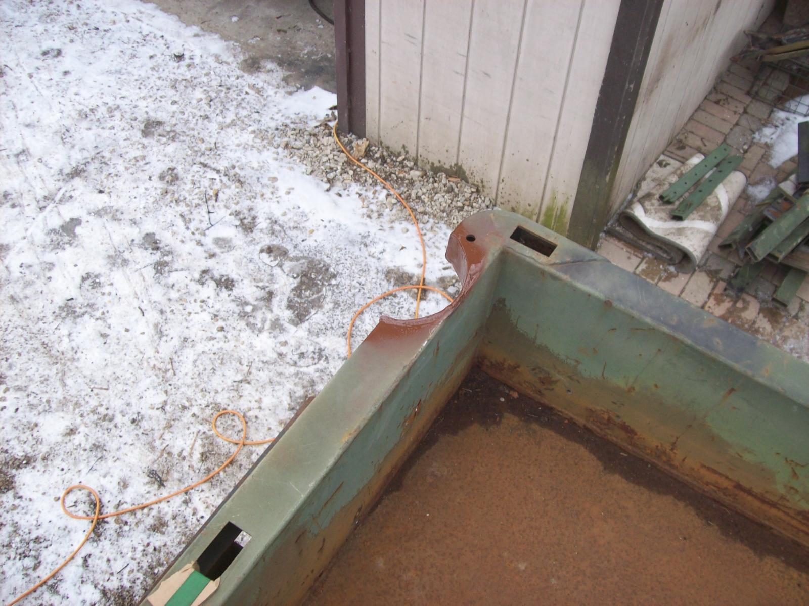

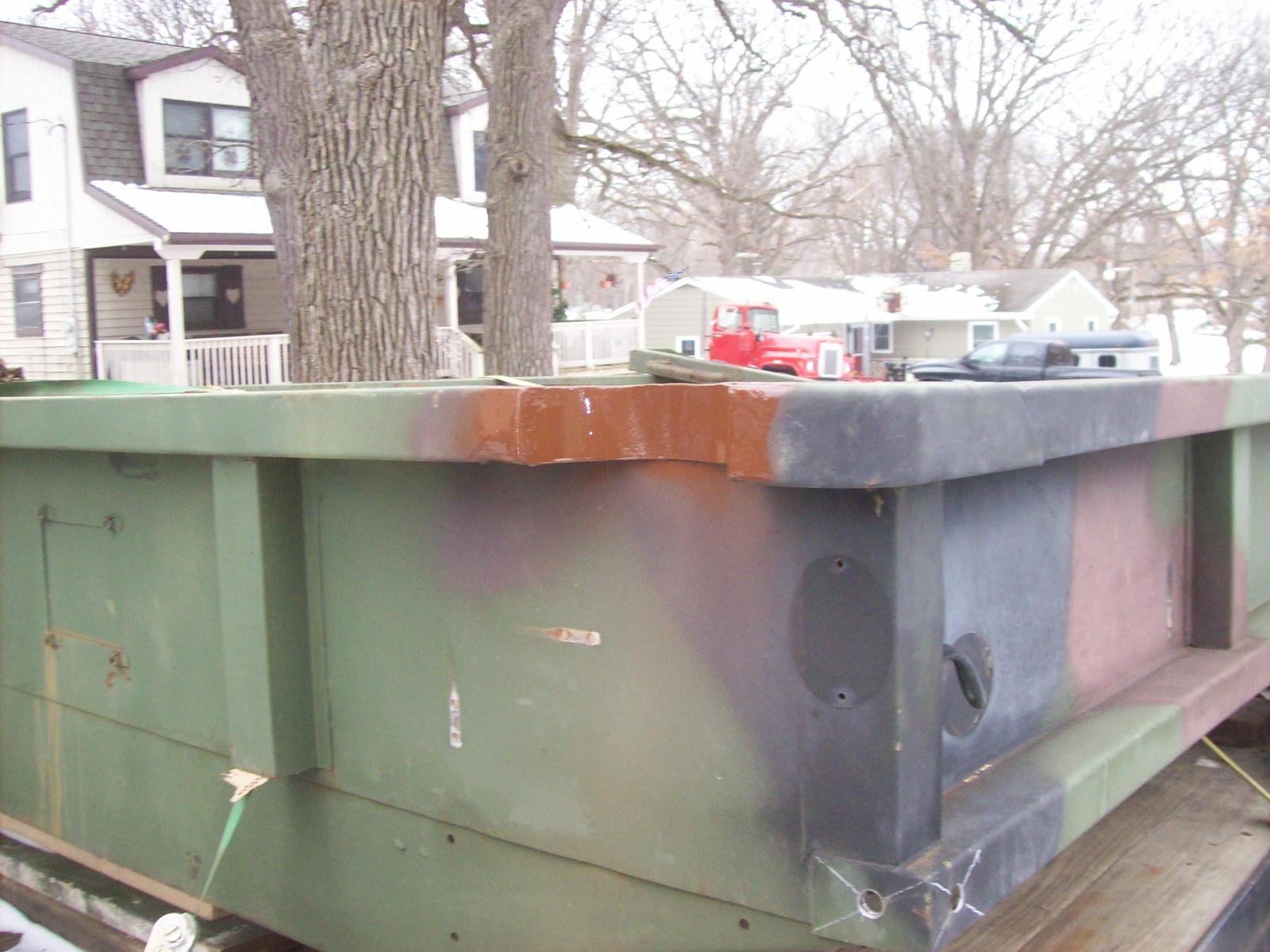

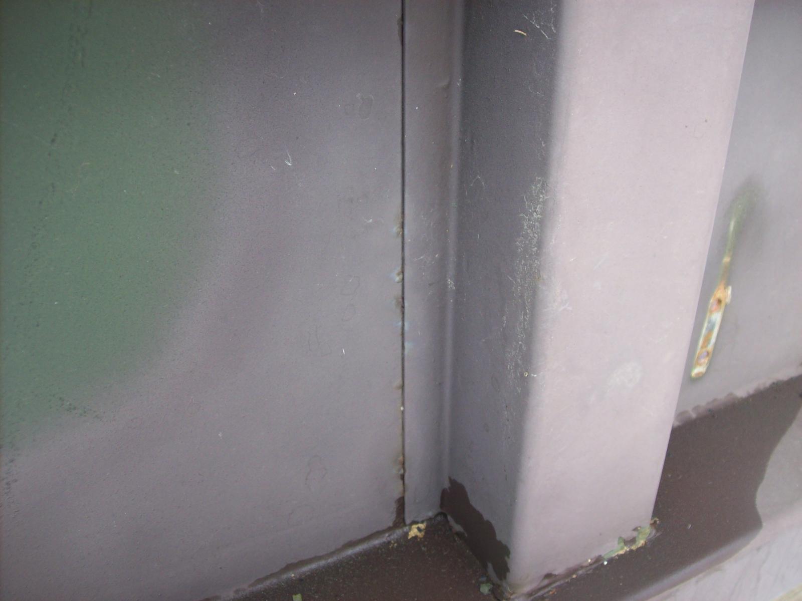

  18. As seen in the picture the uprights are flanged where they meet the flat side of the bed the inserts will be fitted to sit on these flanges and will be held in with stainless steel rivets or nuts and bolts I have not decided which I will use yet.

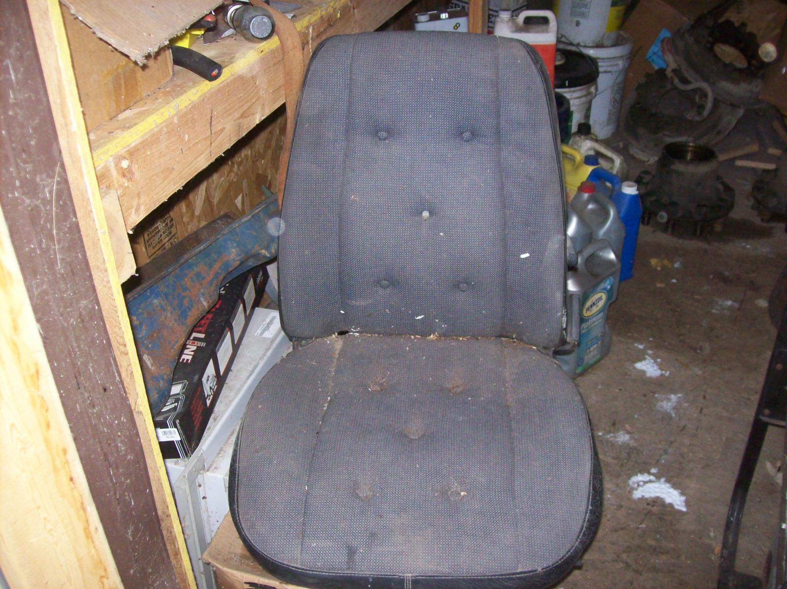

  23. I have a seat removed from a R model its been sitting in my shed for probably 10 years I would use some upholstery cleaner on it looks pretty dirty its like new had a few mouse turds on it didn't smell of mouse pee though make me an offer if you need it.
  24. The bed goes to the sand blasters next week I decided to split the tailgate down the center and make it fold out like doors on a dry van. I will weld hinges to the rear uprights and go from there I will use cane bolts to lock each side individually and I will weld a piece of flat stock on one door to overlap the other like a dry van. Went down to the recyclers Saturday and bought some new road signs that were sitting there the backs will polish up like a mirror for the inserts between the ribs on the sides.
