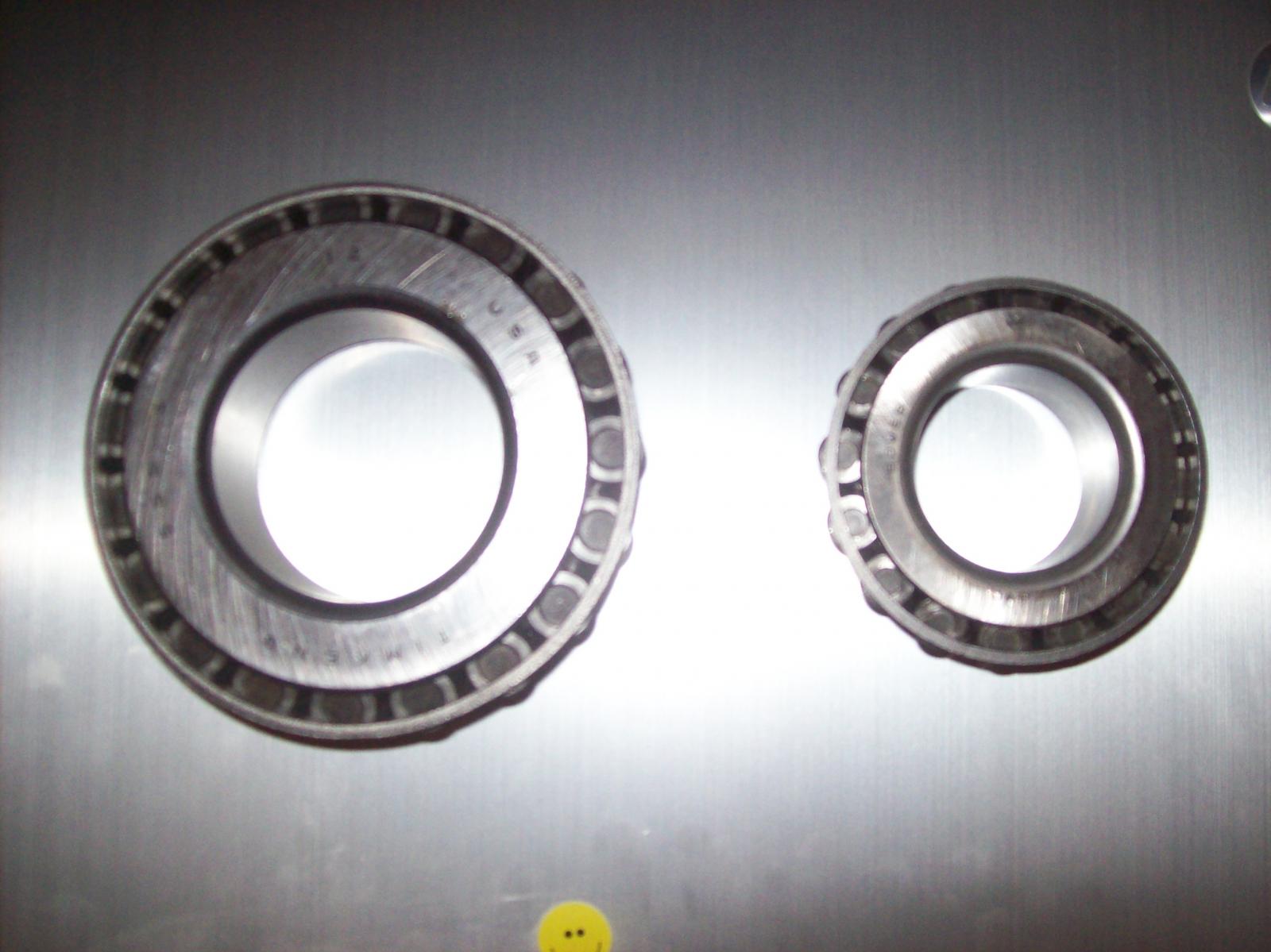

  12. There was a couple of them at the auction I bought my mack from they bought all the other trucks that were there as long as they didn't go over their 4500-5000 dollar limit they got a beat up CH and some beat up petes and fords.
  13. There is a real nice black dash for sale on ebay right now.
  14. Dodge still makes some real short wheel base trucks used as airforce tugs most have low miles and a 6BT cummins.

  16. Went to Woodstock today with our head mechanic and another driver and drove one of the two CH trucks welch bros bought at an auction up there not bad trucks one with a 427 the other with a 350 neither had over 325,000 on the odometer. Not a fan of CH trucks but rode nice with full air ride aluminum wheels all the way around nice clean interiors the one I drove back was all set up to pull a powder wagon.
