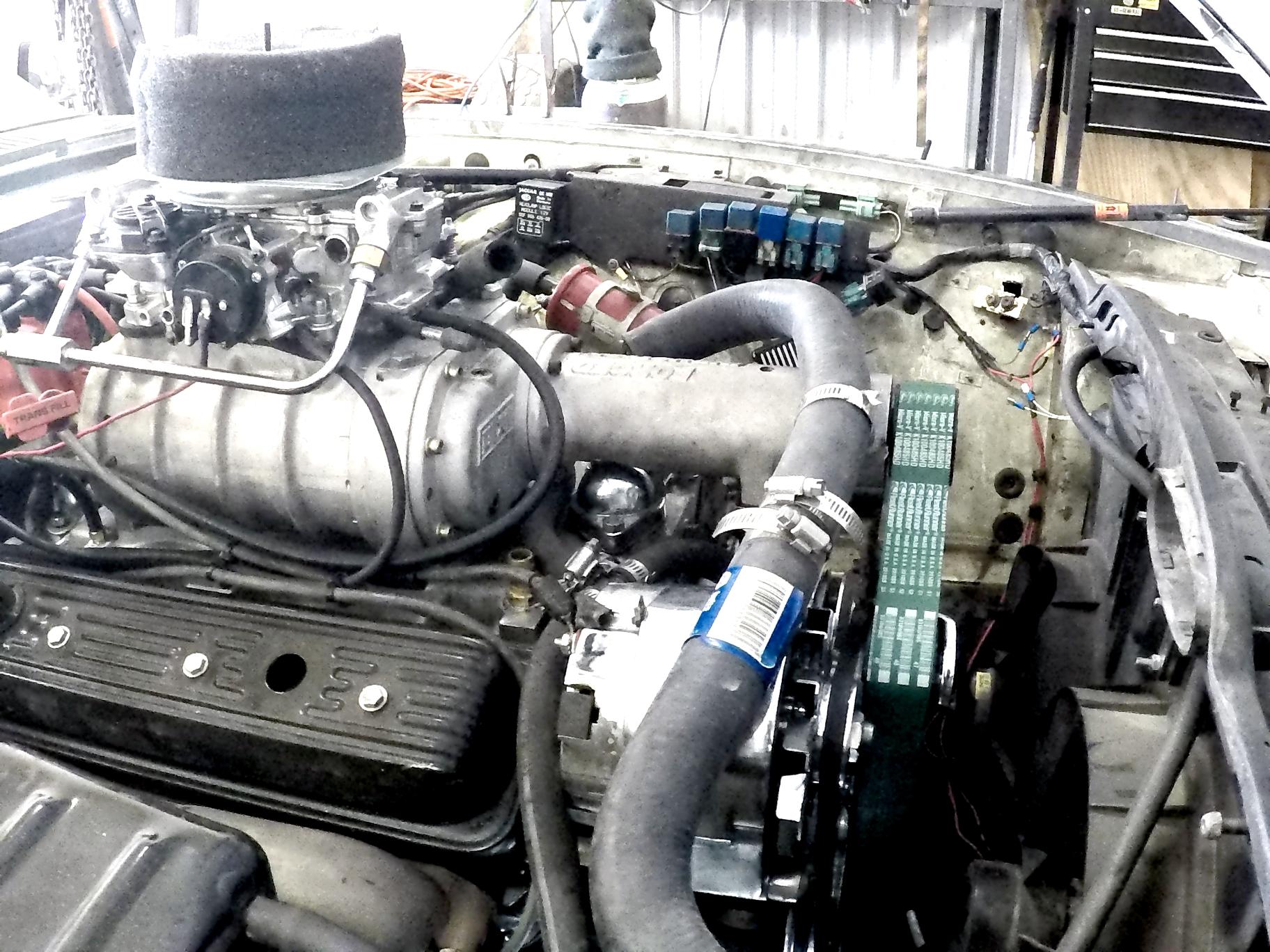

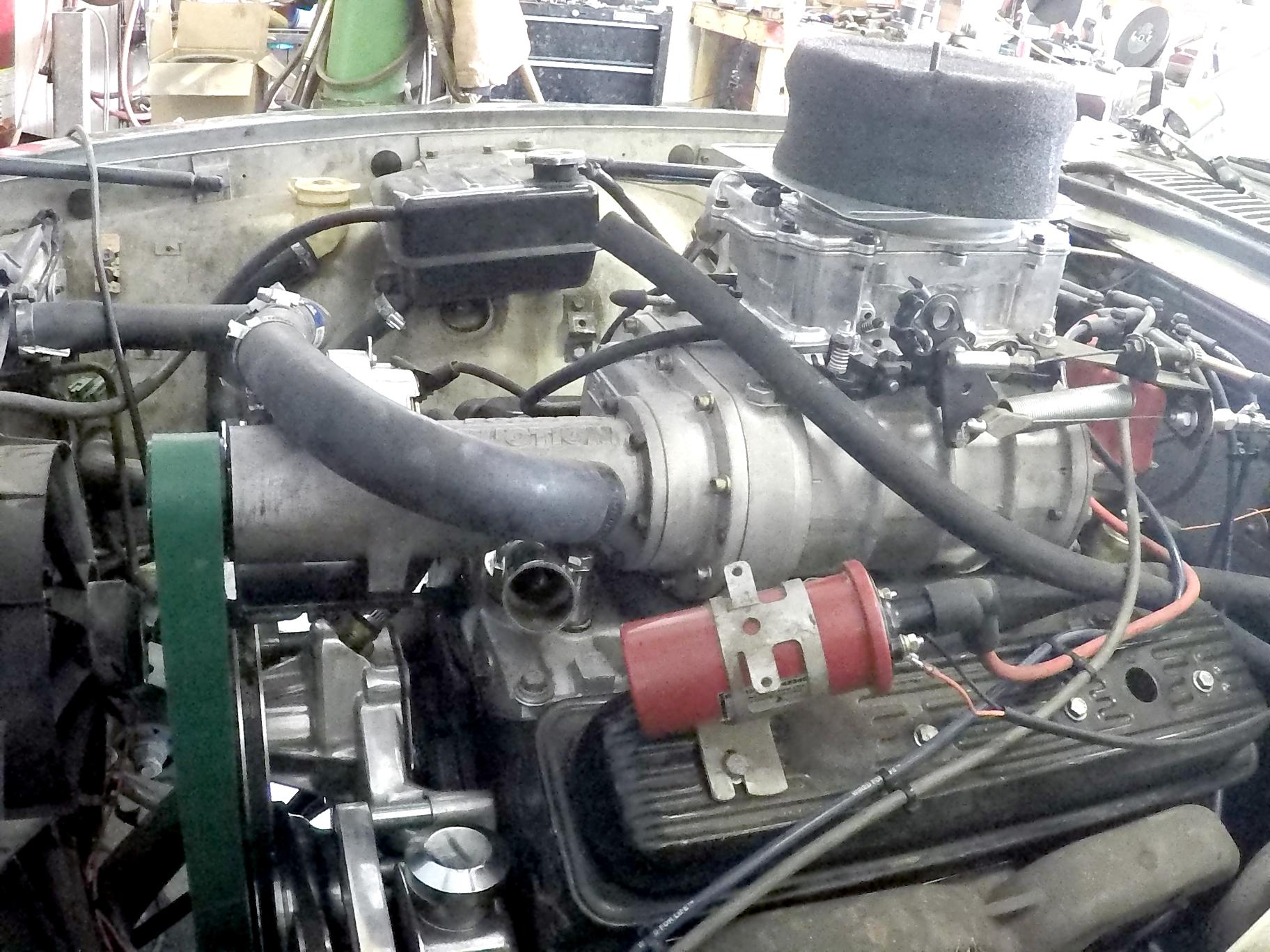

  2. its 1 1/2 in exaust tubing thats miter cut and welded back together. of course i could only find 1 1/2 inch in exaust tubing in short legths so there is 3 peices to make the upper hose. i could have made it a little prettier by using a few more pie cuts to create more of a radius in the bends, but i still haven't picked up more welding gas yet and tight seal welding thin material with flux core wire is kinda a bitch...lol. im not too worried about my outlets being on opposite sides. at some point ill get a custom or universal radiator to put in it that will solve that problem. i ordered 2 different top puleys (150 bucks a peice ouch) doing a few calculations and reading some literature on the blower. the blower has a maximum recommended rpm limit of 14k rpm at the blower the pully ratio's i have on it right now would spin it at 16+ at 6k rpm (6k rpm camshaft in the engine) so one blower pulley i ordered should put me at 14k blower rpm at 6k engine rpm with the 7 inch crank pulley. the other one i ordered will be just slightly over driven from the ratio the blower would have originally come with. hitting 10 psi at less than half throttle at low rpms with 9.4:1 compression on pump gas with cast pistons makes me a little nervous...lol if i can get it to run 6-7 at wot threw the top end i would be a bit more comfortable. you got to get some video to post of your Gasser one of these days i gotta see it, sounds like a blast.

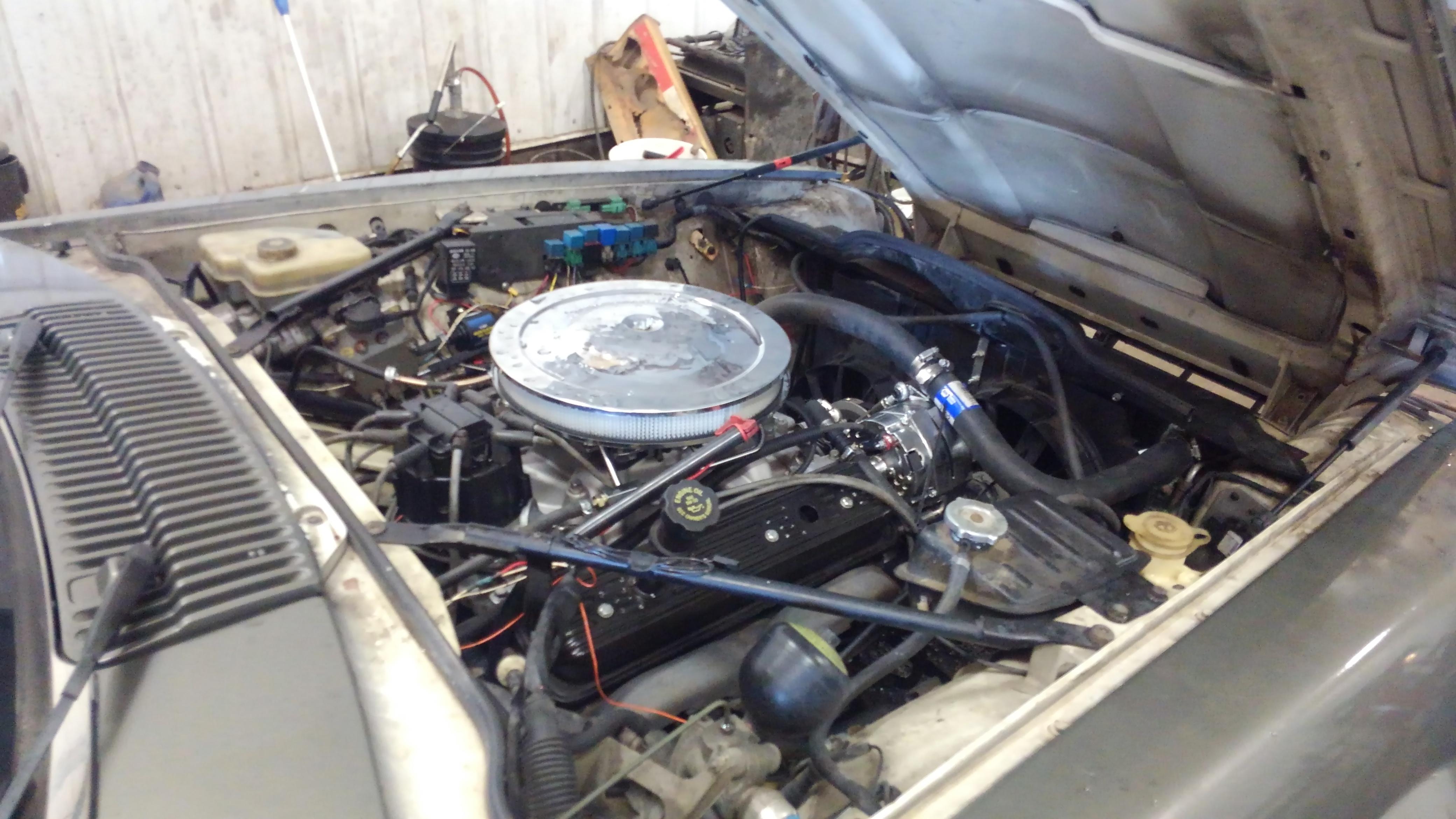

  3. got things buttoned up today fluids full ect, unfortunately all i could do is putt it around. would make 5lbs of boost at around 30% throttle. goose it and it will hit 10psi in the blink of a eye with the over drive pullys on it. i am going to have to order a larger blower pully before i can run it threw its paces. i had boost in mind when i put this engine together but not 10lbs at half throttle...lol iv got the timing set WAY conservative. at about 25 degrees total timing a good dose of octane booster in the tank. even at 25* total timing the throttle response is amazing. if you goose it 1/4 throttle off the line it will spin the tires. even spun them a little rolling in 2nd one time goosing it. cant wait to get the pulley drive ratio down so i can actually give it some throttle and rpm without the boost going higher than i feel comfortable with.
  4. or if my radiator inlet was on the other side...lol if you flip the thermostat housing around it ends up pointing towards the rear of the engine. i think i might have a clock-able housing in my parts bin somewhere but i don't think it will work with the blower snout. i might have a look tomorrow before i start on the hoses and see. still using the jaguar radiator. i planned on upgrading the radiator when i did the engine swap but hooked it up intending just to use it for a few test drives but 2 years later its never got even anywhere even close to running hot so iv never upgraded it. when i eventually get around to doing that my inlets and outlets will be flip flopped put the top inlet on the drivers side and the outlet on the passenger side. because right now both my hoses go to the opposite sides lower hose i think will be simple i think if i just add 6 inches or so to the center it will push the bend in the bottom of the hose out away from the crank pulley. top hose will need to make one bend right out from the thermostat to point it towards the core support. then go to the core support make a 90 then another 90 into the radiator. i grabbed some small exhaust tubing the same size i need for my radiator hoses today. i think im just gong to chop that up and make a metal hose like you would have on the big truck. it will probably take less time than staring at the wall of hoses at napa trying to pick out things you think might work and then the 10 trips back and forth that follows....lol
  5. got the belt alignment ironed out and then re installed everything, and it had its first test start today. only ran it for a few seconds though as i need to re route my coolant hoses so the radiator wasn't hooked up. lower radiator hose hits the blower pulley, and top hose well would work if the outlet on the thermostat housing was the same size as the old one but the routing wouldn't be very ideal anyway. i think im going to make up some metal radiator hoses tomorrow and then just use a a bit of rubber hose on the ends to make the connections.

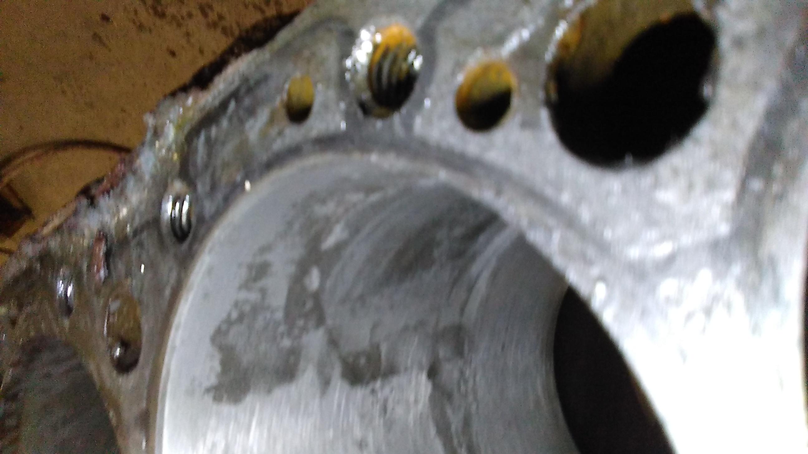

  8. id love to see some pictures of your dads xke if you find some. i got my other core 350 torn down today. i was told by the guy that gave me that engine core that it had a bad cyl head, its been sitting around the shop several years now, a bit of bad news is although everything in the bottom end looked great other than 1 cyl that has had water sitting in it this entire time the engine had rusted up enough on that one cyl it wouldn't even spin over all the way till i cleaned it up a bit. as you typically find in the late vortec blocks all the other cyl's looked great could have easily gotten by with a hone re-ring and bearing job. ran a hone threw the cyl that had water in it and its defiantly going to need to be bored oversize to clean up. its also a 2 bolt main block rather than a 4 bolt like i have in the jag. so now knowing that its defiantly got to go to the machine shop to be bored complicates how i might want to biuld the engine. i was planning on just re-ring hone thow a set of flat top pistons in it and new bearings then call it a day. the project i plan on putting that engine in is a 2wd 89 toyota pickup, weighs quite a bit less than the jag and will likely never get traction so wasn't really planning on a high horsepower build. figured id run vortec heads on it and thow the lt4 hot cam in it when i upgrade to a blower specific cam on the jaguar would make way more power than you could really use in a 2800lb rear wheel drive mini truck. now at the point that it needs to be bored its really not much more to just go ahead and biuld a 383 thinking maybe i should biuld a forged 9.x:1 383 out of it then when i get ready to put the other project together pull the engine on the jag put the new short block in there and re use the jag short block in the toyota project. but id be giving up a 4 bolt main for a 2 bolt main in the one i want to make more horsepower with if i did that. the other option is to just biuld a basic 383-355 out of the 2 bolt main block and when and if the jaguar short block says its had enough re biuld it as a forged 383 and keep the 4 bolt main block with that car. ether way the blower setup will get put on the jaguar engine as is for now because the machine shop i normally use tends to be really slow so after i decide how i want to build it and drop the block off it will probably be a couple months after that before i see it again. i did video record the engine tear down on the other block hopefully ill get it edited over the next few days here and upload it.

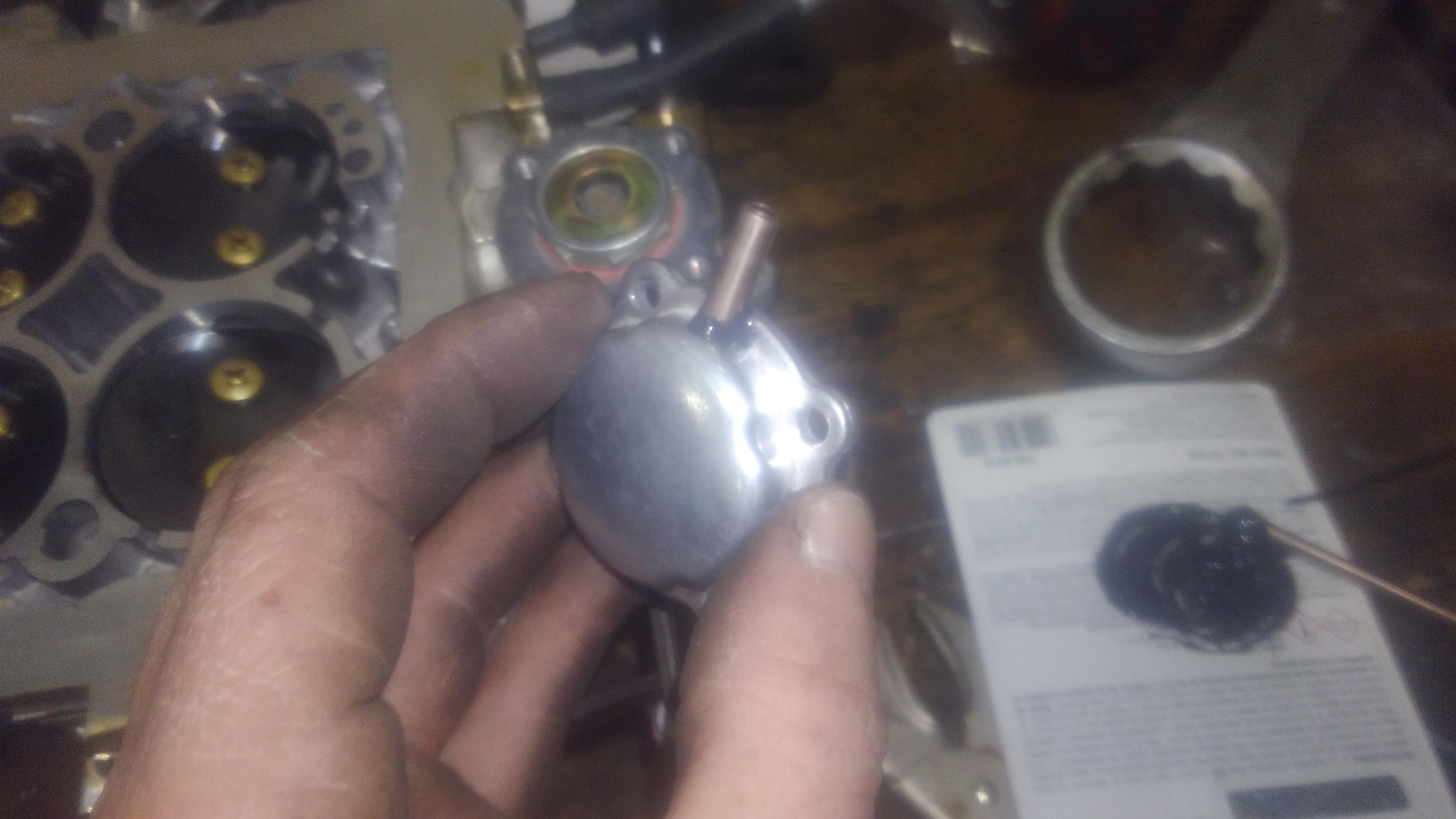

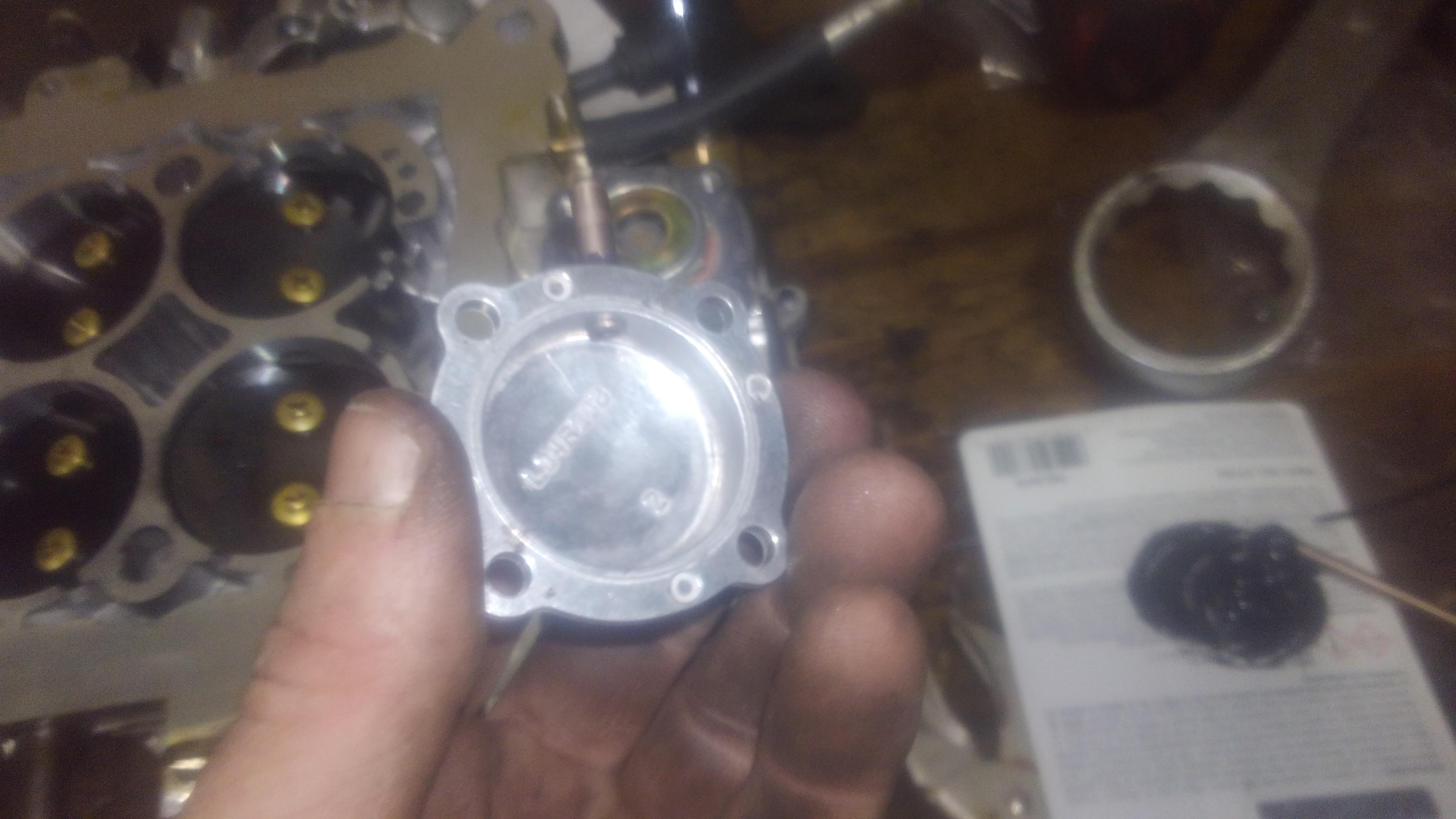

  12. did i couple quick modifications on the carb in preparation for the rest of the parts to come in. with the supercharger you want to be able to reference your powervalve to the intake manifold below the supercharger so you need a external port to hook a vacuum line to as vacuum under the carb is no longer directly tied to engine load. on the summit racing carb there was power valves on both the primary's and secondary's. and the power valves are located under a small cover under each float bowl. i put a block off in the secondary's and bumped up the secondary jets 7 sizes . drilled a hole slightly smaller than 3/16's and covered a short piece of 3/16th break line in some 2 part epoxy and pressed it into the hole giving me a nipple i can externally hook a vacuum line to. i then found a drill bit just slightly larger than the port that used to feed the power valve from under the throttle body's cut about 1/4 inch of the shank off of it covered it in 2 part epoxy and drove it in the port with a punch to block off the passage. then put it all back together hooked a hand vacuum pump to the nipple applied a vacuum then worked on a few other things for an hour came back and the needed had not moved. so i re installed the carb. i will route the new power valve port back to a manifold vacuum port on the carb till i get the blower put on. new fuel pump came in at the house today while i was out at the shop so hopefully. ill get that installed in the morning tomorrow and if the weather will cooperate a quick run around the block to make sure everything is functioning properly and that my secondary jetting is not off in left feild although i fully expect to have to re jet both anyway i don't want to start off a mile out if i can help it.

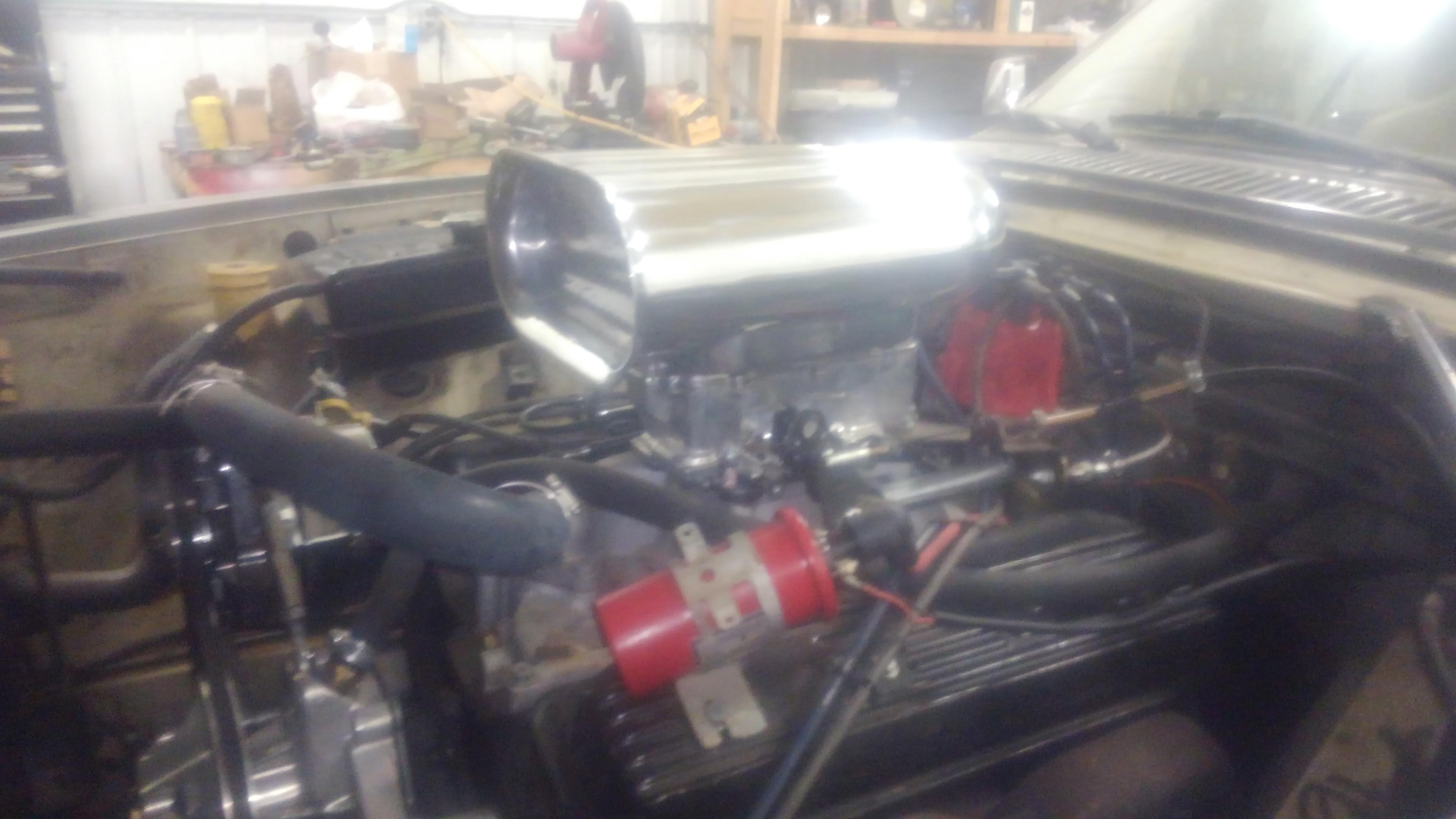

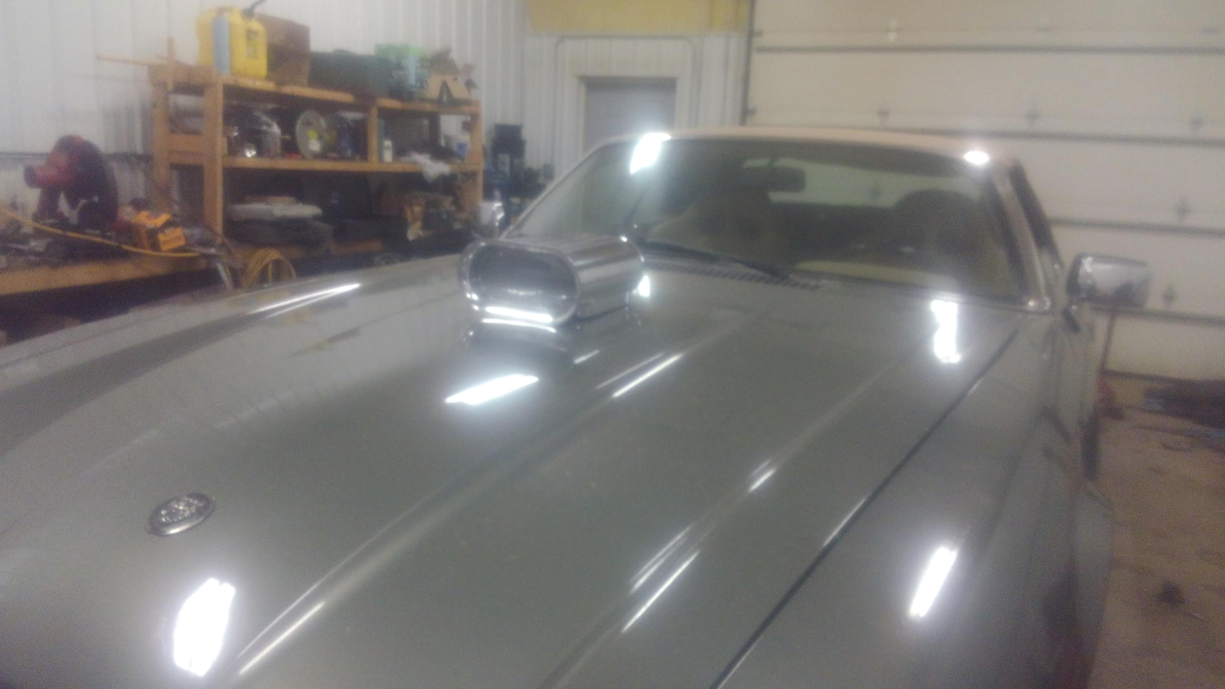

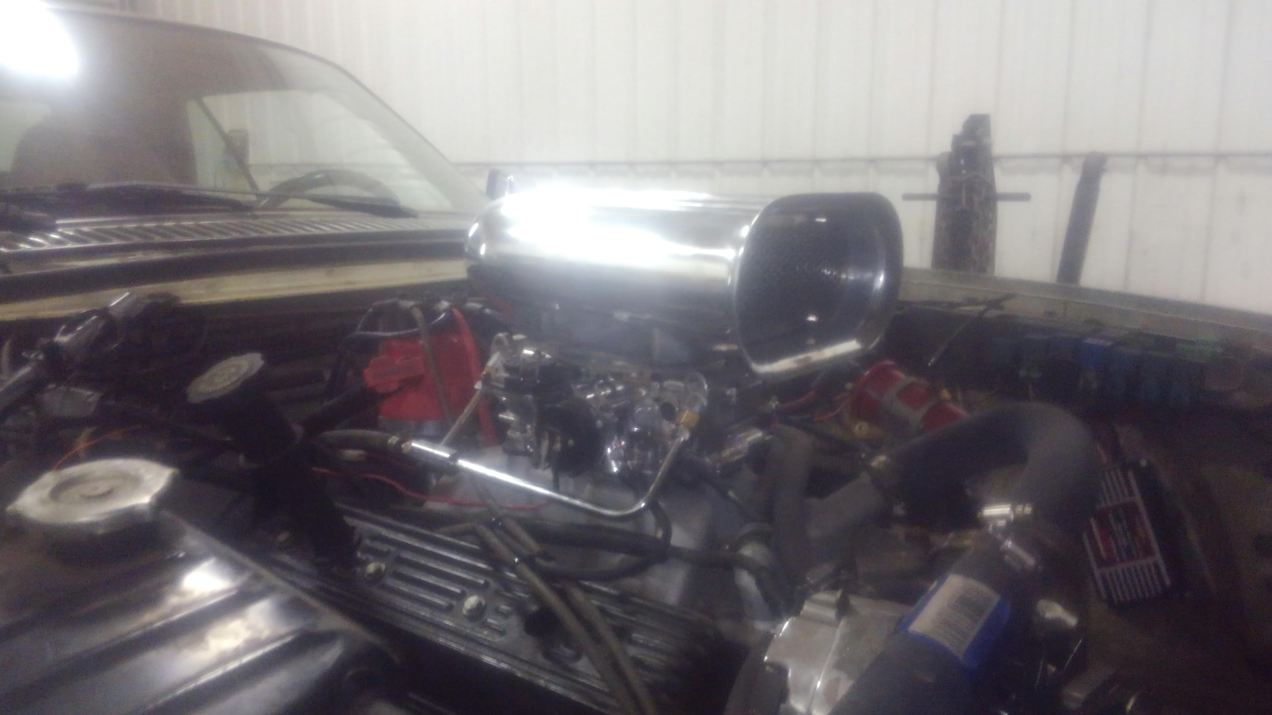

  14. got any pictures of the whole car? it is super fun to watch the gassers race, wheels up and sideways off the line...lol how does that e-85 work out in a play toy. i have never really considered running e85 mostly cause iv seen what 10% ethanol will do to carbs if they sit around a while. i could only imagine e85 i got home today and one piece of the puzzle has arrived. i couldn't help myself i had to set it on the engine and on the car to see what it was going to look like. looks a little goofy sitting ontop of the hood hopefully it will look a little better when there is a bit of engine sticking out with it. looks great on the engine though.

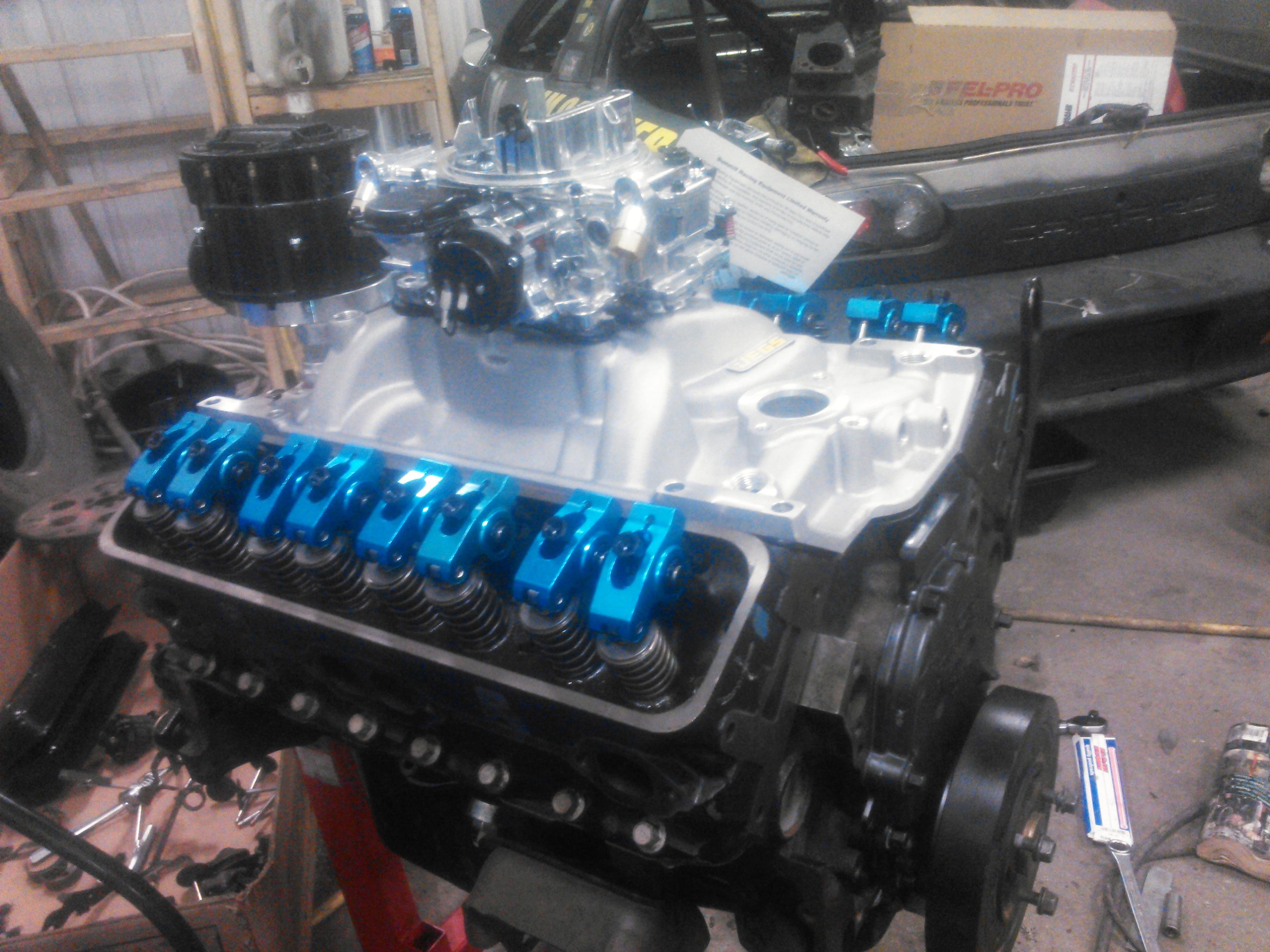

  19. engine is a 4 bolt main 97 vortec 350 that i rebiult running modified vortec heads and a lt4 hot cam. ((intake/exhaust) is 218/228; and maximum lift with 1.6 rocker ratio (intake/exhaust) is 525/525.) 9.4:1 CR

  22. fixing the fuel system. iv got the fuel system re-plumed to put the fuel pump in a much more ideal location and fuel lines re-routed power run to the new location and a redline 105gph fuel pump ordered new airfilter assembly ordered to go with the next item and the part im most excited to see arrive 142 roots style supercharger.
