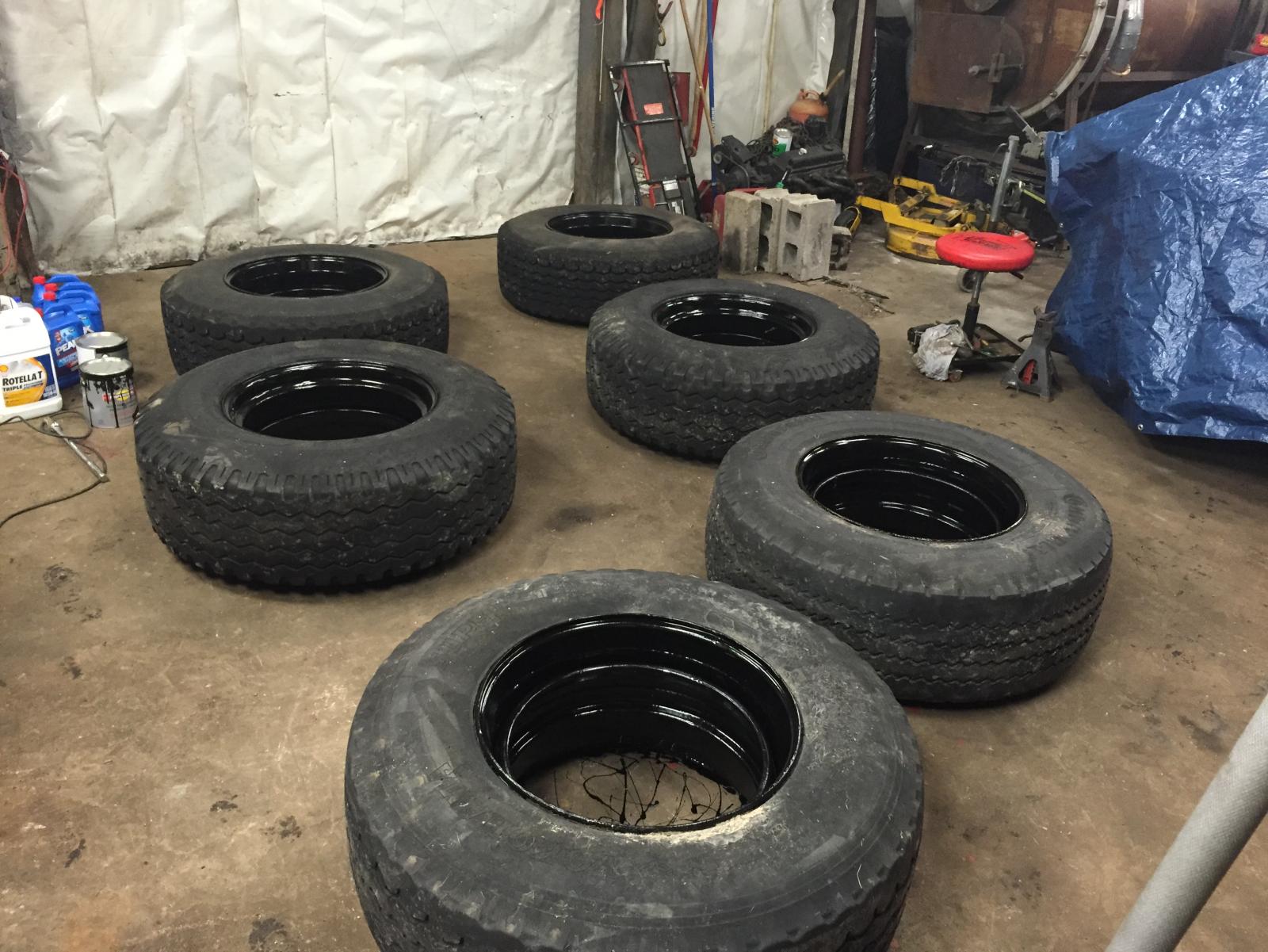

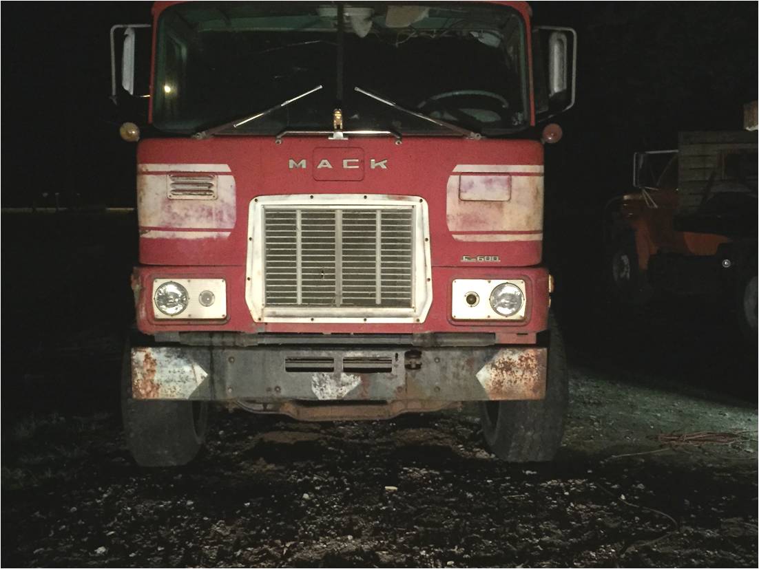

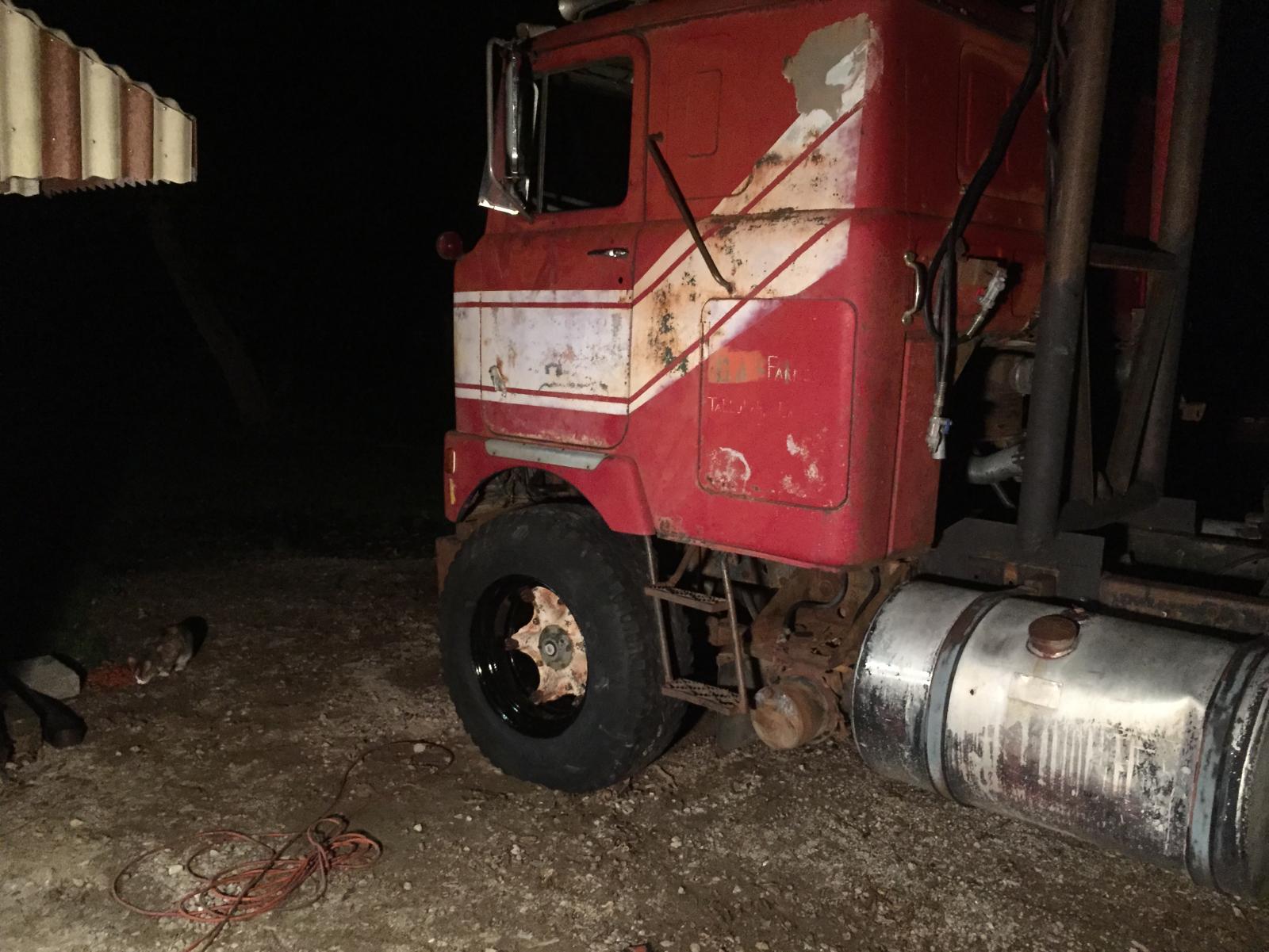

My first set of rims didn't have enough off set and hit the tie rod end. Then up popped a set of six with 385/65r22.5 tires on craigslist. It turns out it is 3 pairs each with a different offset. So now I had a choice and I chose the most offset (something like 5.5" from outside of rim to clamp ring) so I could have a "step" of sorts with the tire. Got them mounted up and clears everything by at least 2 inches. I'll have to wait to see how it drives till I get my oil lines replaced. Anyone know of any downside/ dangers with running this set up? -

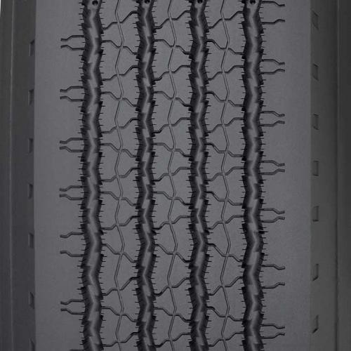

I have a source for the 8.25x22.5 rims for the change over so that is covered. The tires were on a motor home that was stored indoors. Despite being cheap on some things I don't want to have to worry about tires coming apart or rotting from the inside. At his price it was awfully tempting to take the cheap route. But I'll just bite the bullet and order 8 brand new Samson 11r22.5 GL293D (open shoulder tread) from Chicago Tire. At $2,730 on my door step I don't think that is to bad. I considered retreads but on a truck that doesn't go 10,000 miles a year I think I want the newest caseings I can get not some already half through their life. Also with the recent posts about the bandag failures on here I would trust a retread about as much as a 10+ year old tire.

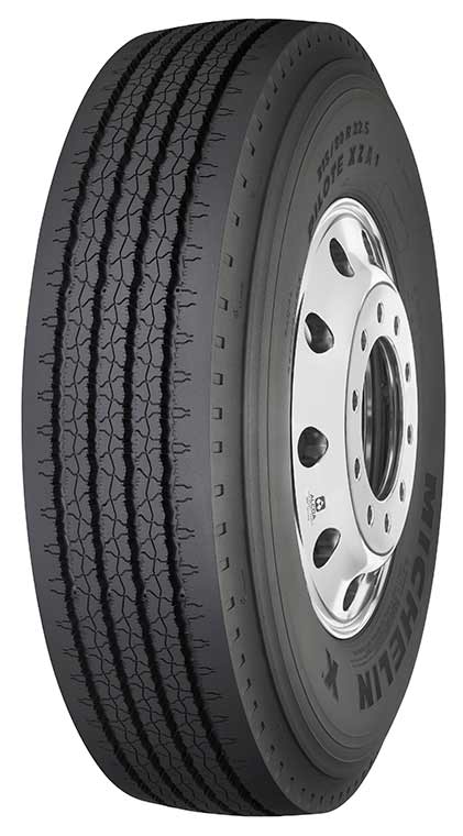

What is the opinion on Michelin Pilot XZA1 295/80r22.5 152/148m tires as drive tires? I can get a set of eight with only 30,000 miles on them for a steal. I figure they would at least be better than the ancient 10.00-20's that are on my truck now.
