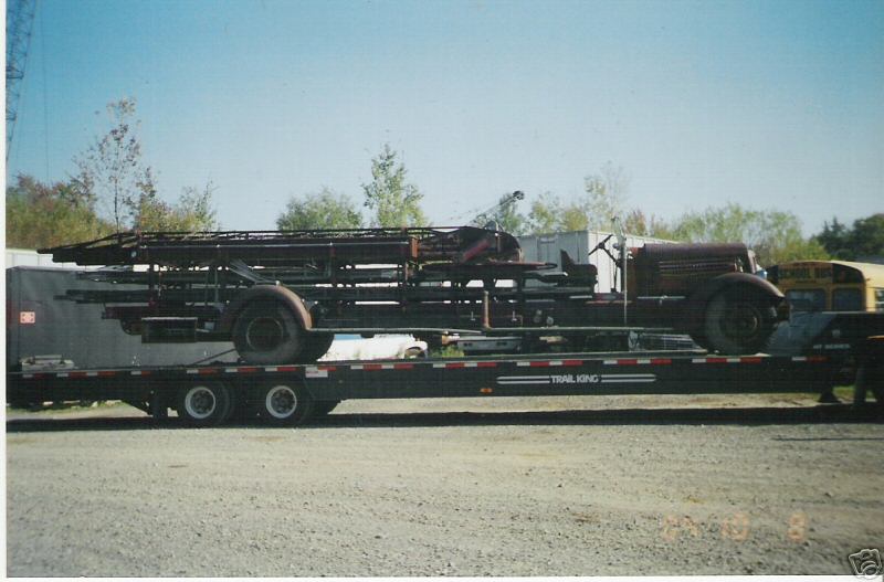

  2. Well it looks like we will have the truck here soon. Carl Cook, who got it for me out of Syracuse will be bringing it on in! He is in Punxsutawney, PA. and has stored it for us He also has a red "B" :bmod1:

  8. Man, thats a tall order, seeing all those people. It'll take you a week to get straightened out and back to normal. When you get to Carl Cook's place, be sure you go in daytime. you can't find it at night!
