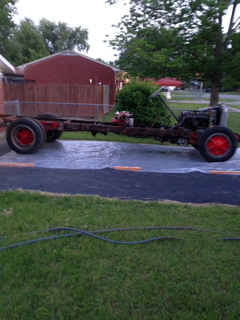

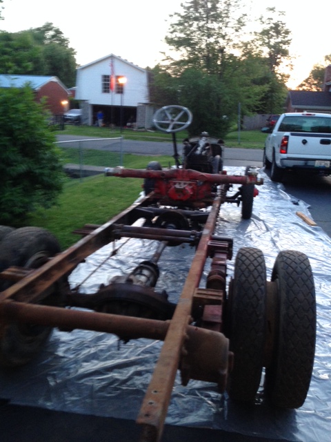

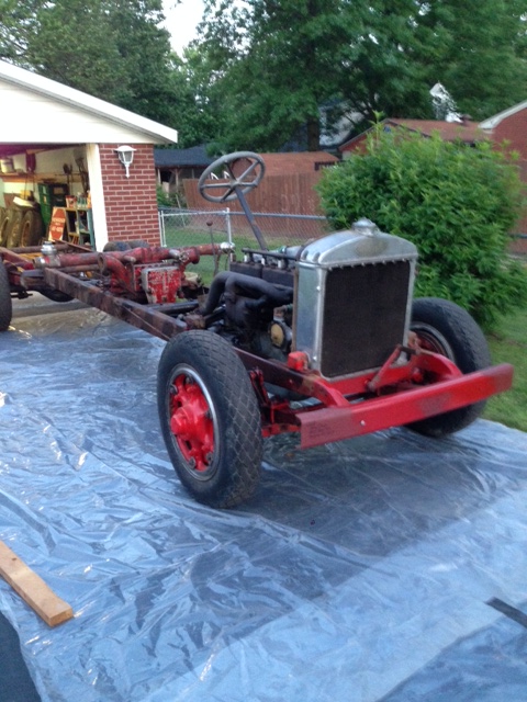

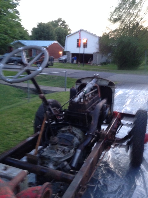

  16. I finally got the frame stripped down to bring outside to clean and start to paint. First time it has been out of the garage in 5 years.
  17. BILL HIRSH (hirshauto) make a good paint for frames and i think works better than POR15. Available in spray, quarts, gallons. Is located in Newark, NJ and has been in business a long time 1-800-828-2061 Seems to hold up good on frames
