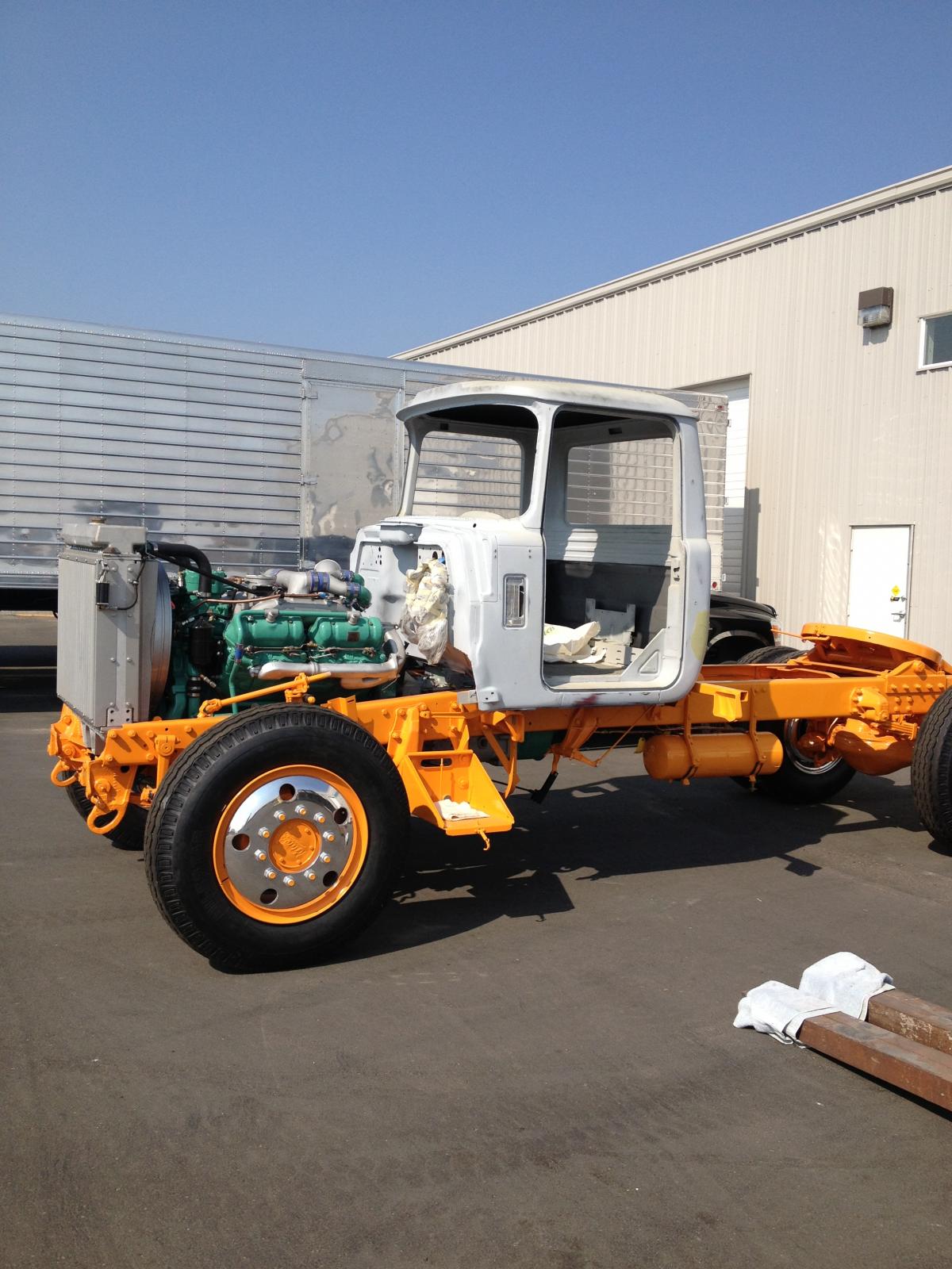

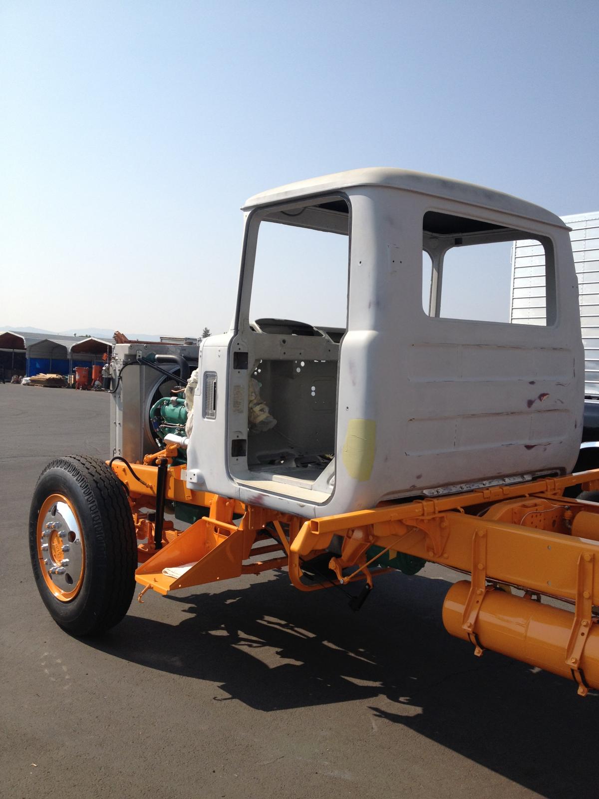

  13. I thought I had a thread on the R719LT that I am restoring but could not find it so I am using this one where I posted before. I had a later model R cab to use..........but anyone ever seen one that still had the steel dash in it like this one?
  14. I thought I had a thread on the R719LT that I am restoring but could not find it so I am using this one where I posted before. I had a later model R cab to use..........but anyone ever seen one that still had the steel dash in it like this one?

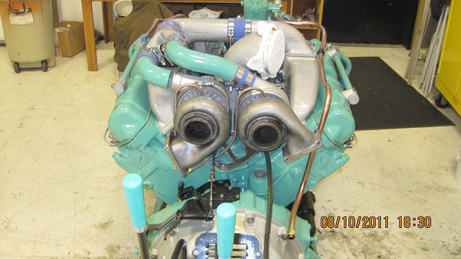

  15. Mack V8 Diesel Engines.dochere is where I get my V8 stats. It came from Don at Mack Museum. Does seem to low on the ENDT864?

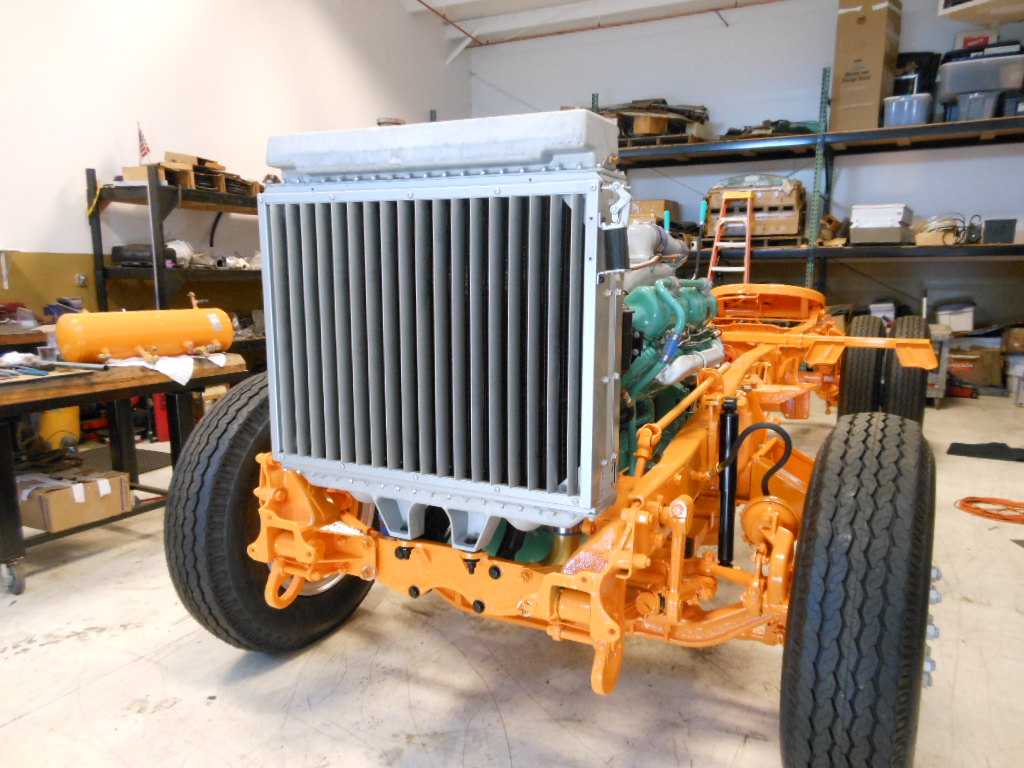

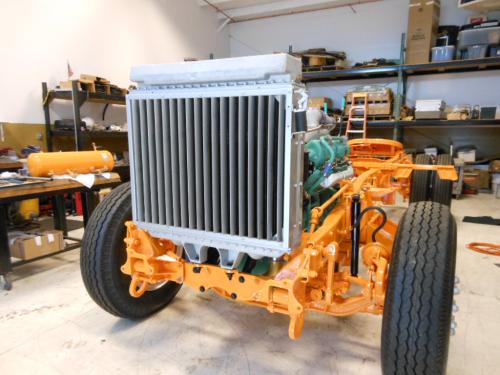

  16. Here is an ENDT-864. According to Mack only 34 were built and ranged up to 350hp. I found many of the parts I needed from Chalmers in PA. I am waiting on the turbos to be rebuilt and that has been a real slow deal. They are garrett but Mack customized the fans. Finally found a guy who had parts and knew about them......after all of these years!!! But he is up in age and you dont trot them old horses. So here I sit waiting.
