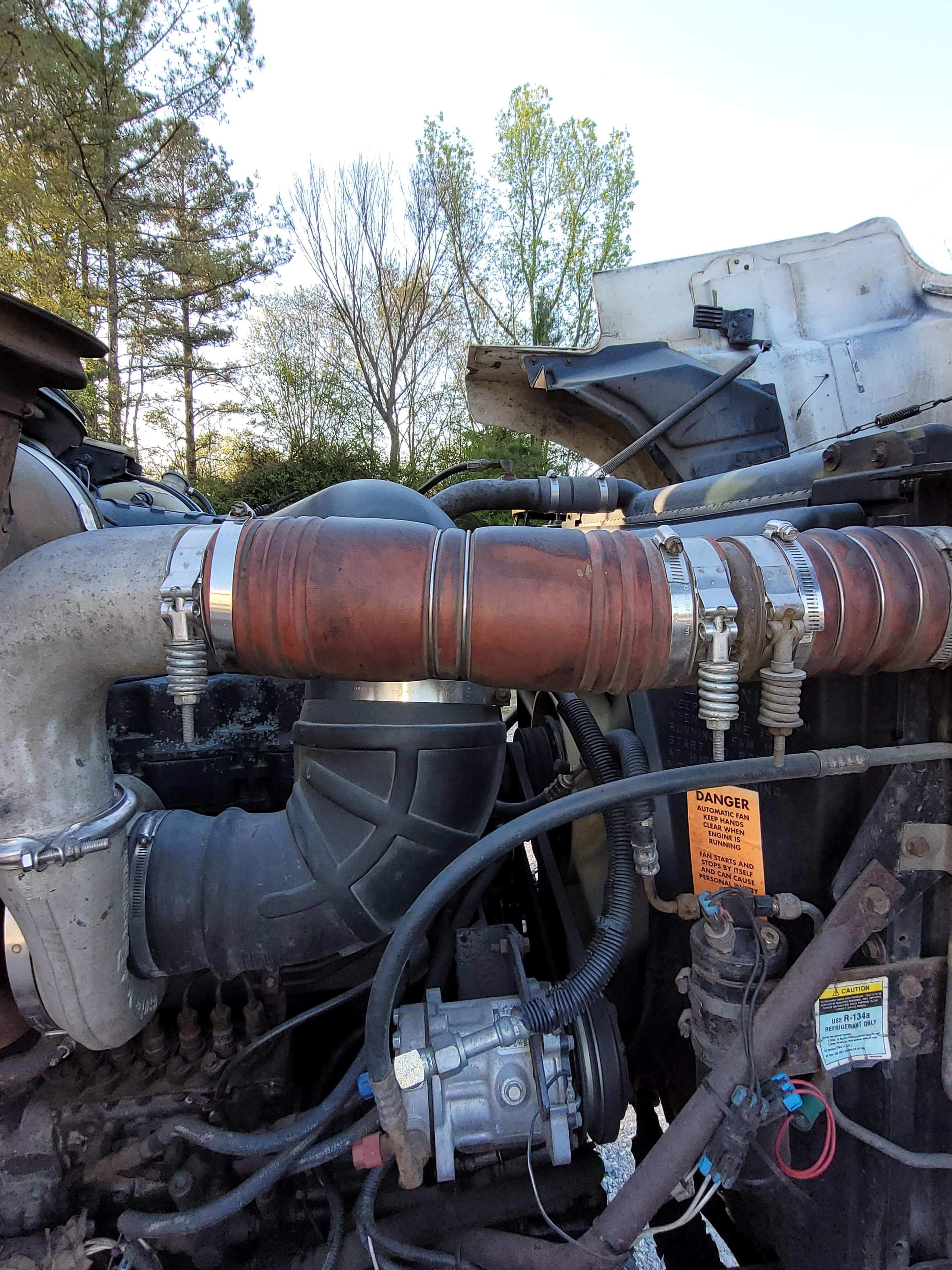

  1. Thank you very much. I think I'm loosing boost there. We just finished putting a new egr cooler on and the boost has been down a few pounds.

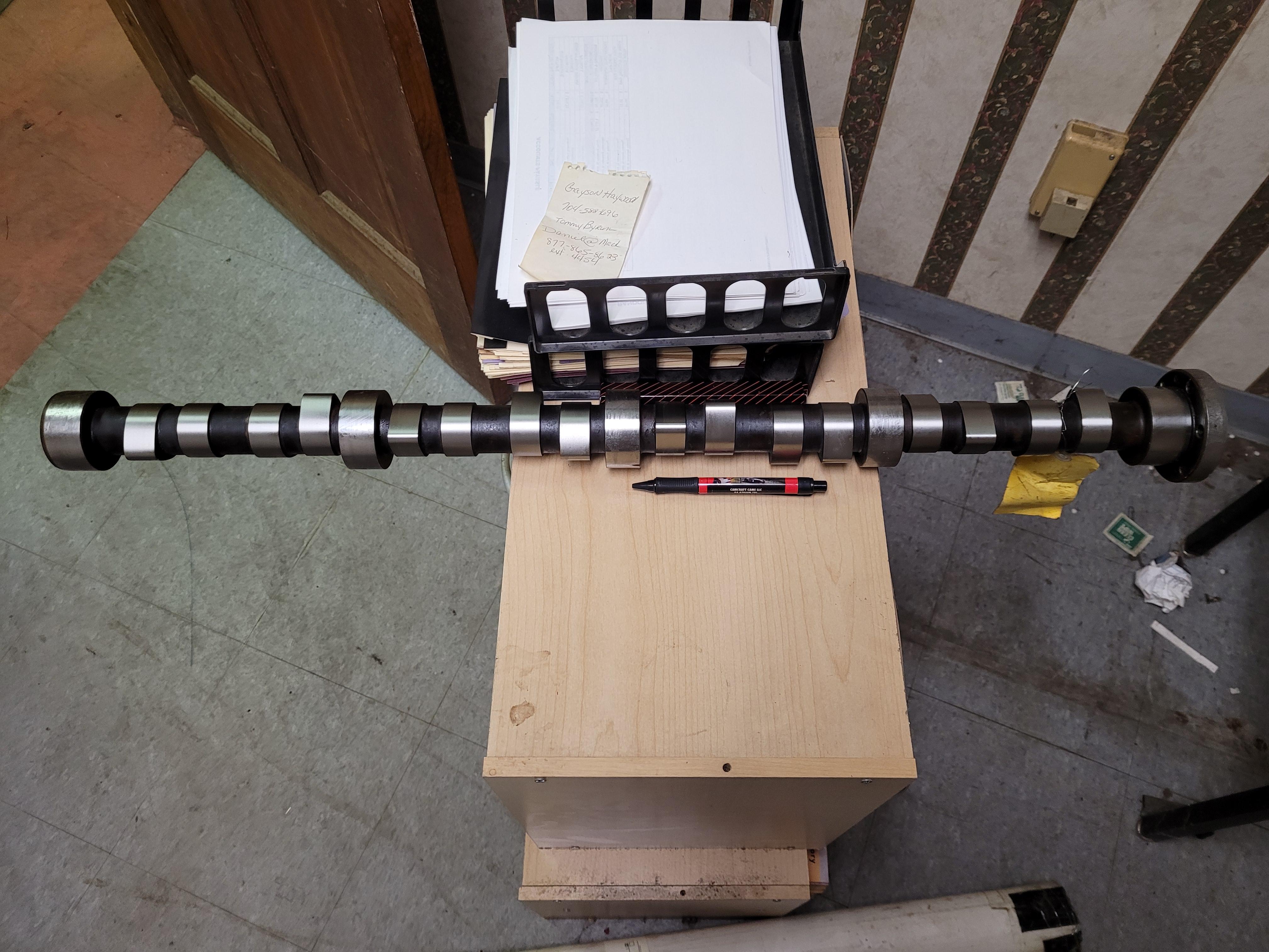

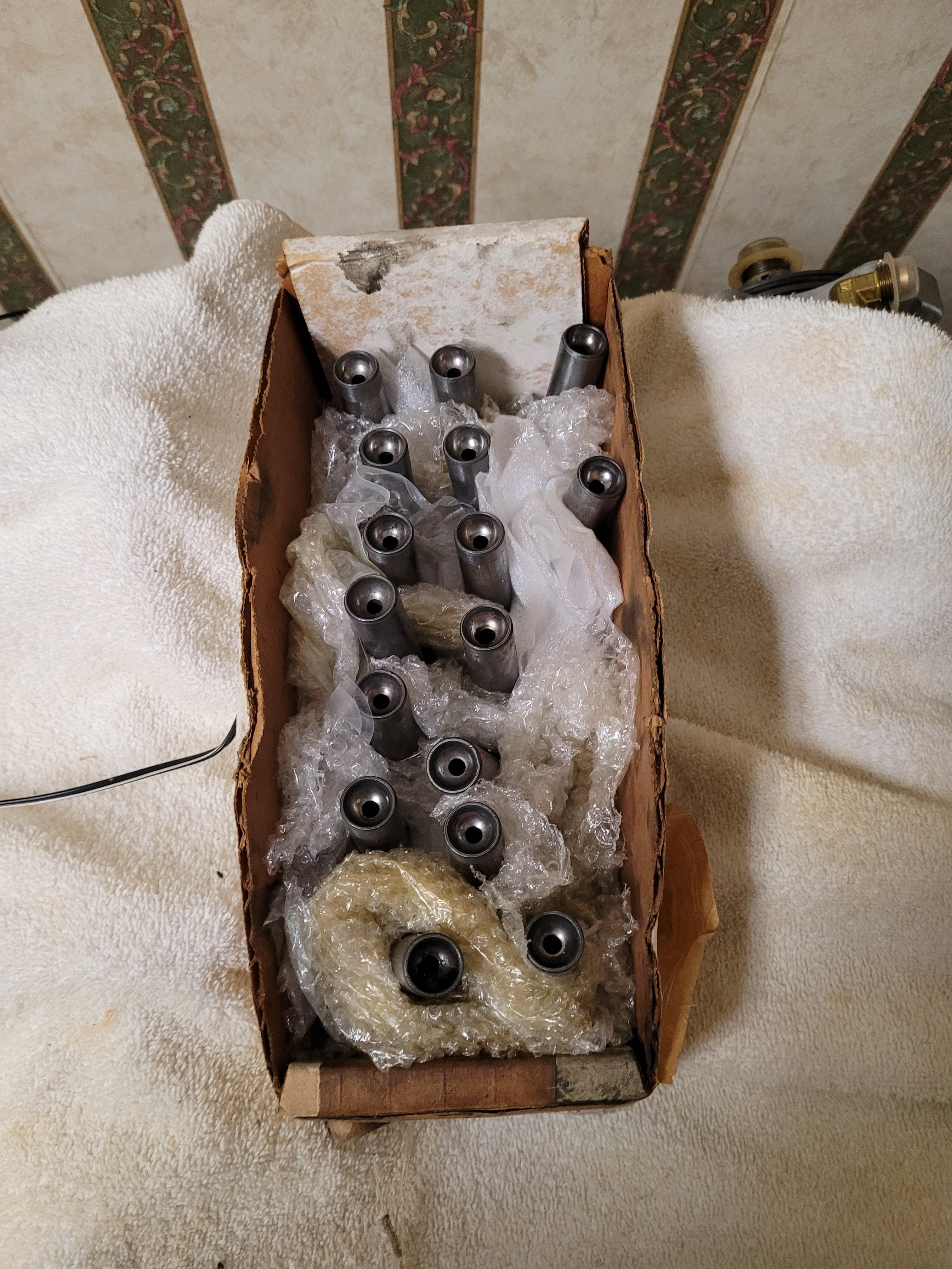

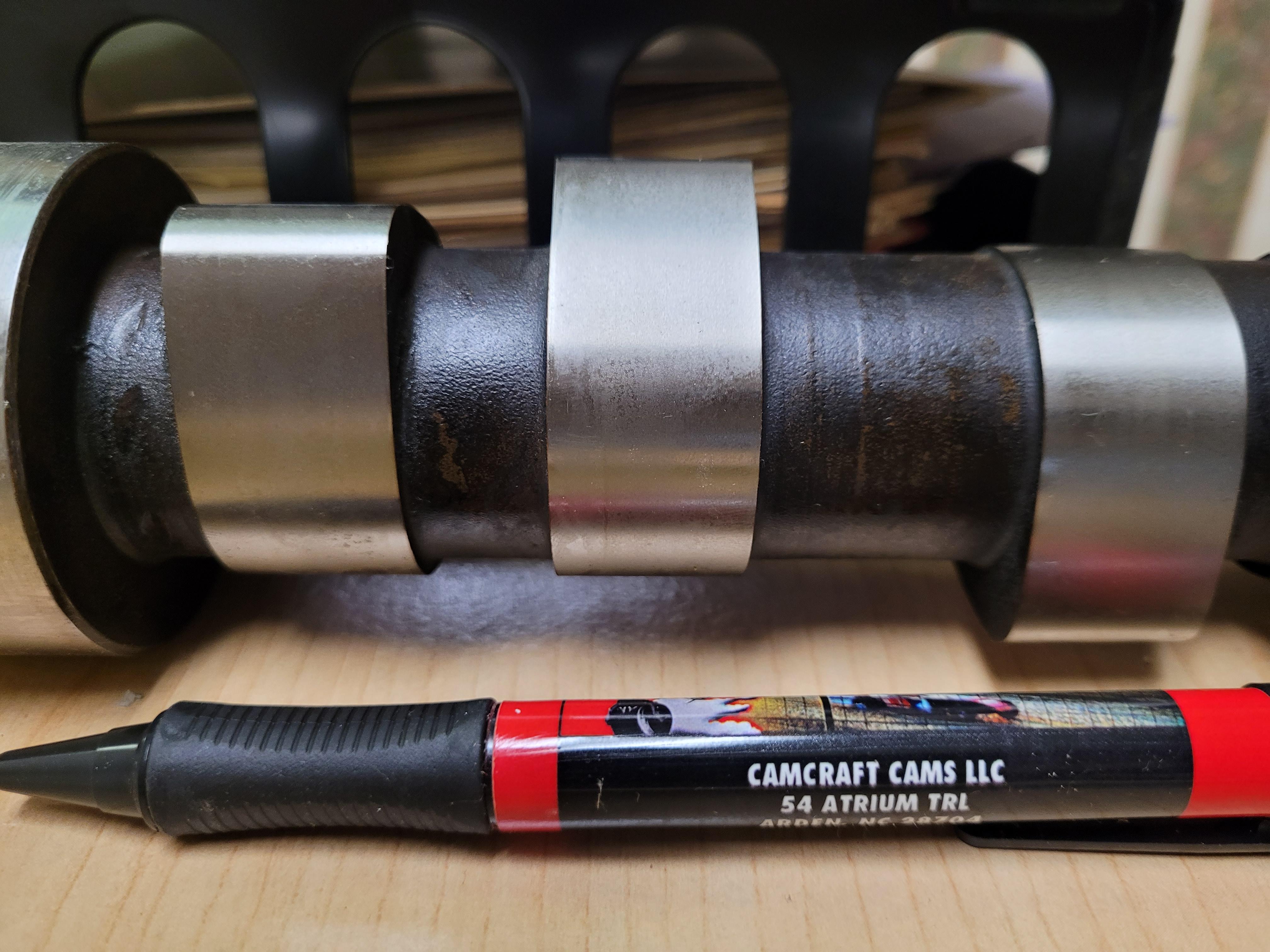

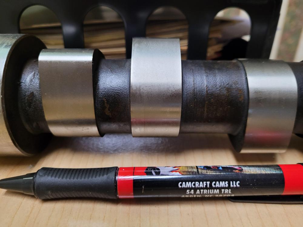

  8. Used cam and lifters out of a 1990 E9500. Professionally reconditioned by Camcraft in Arden, NC. Located in Rock Hill, SC. Make offer. 803-984-0696.
