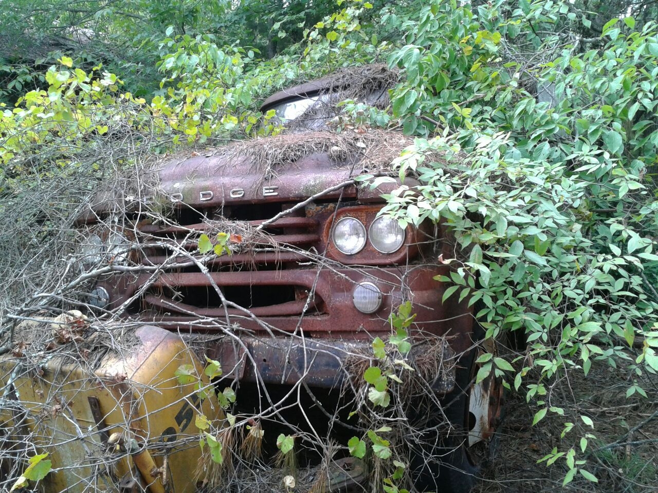

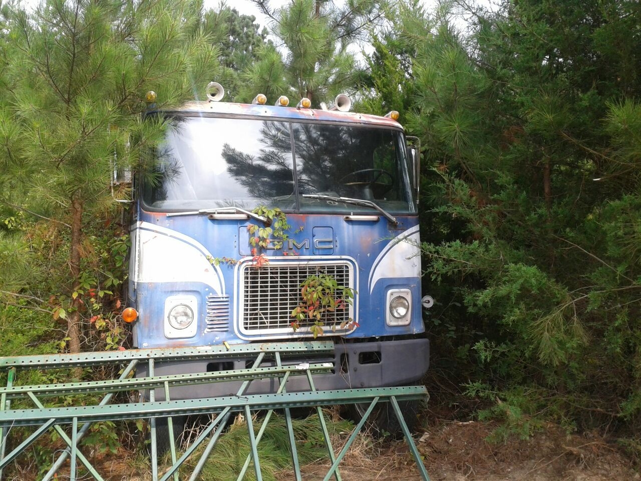

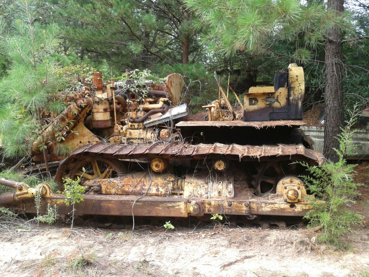

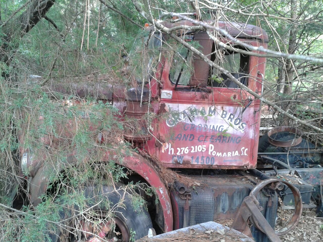

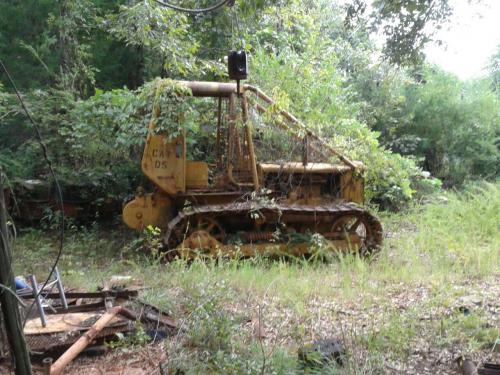

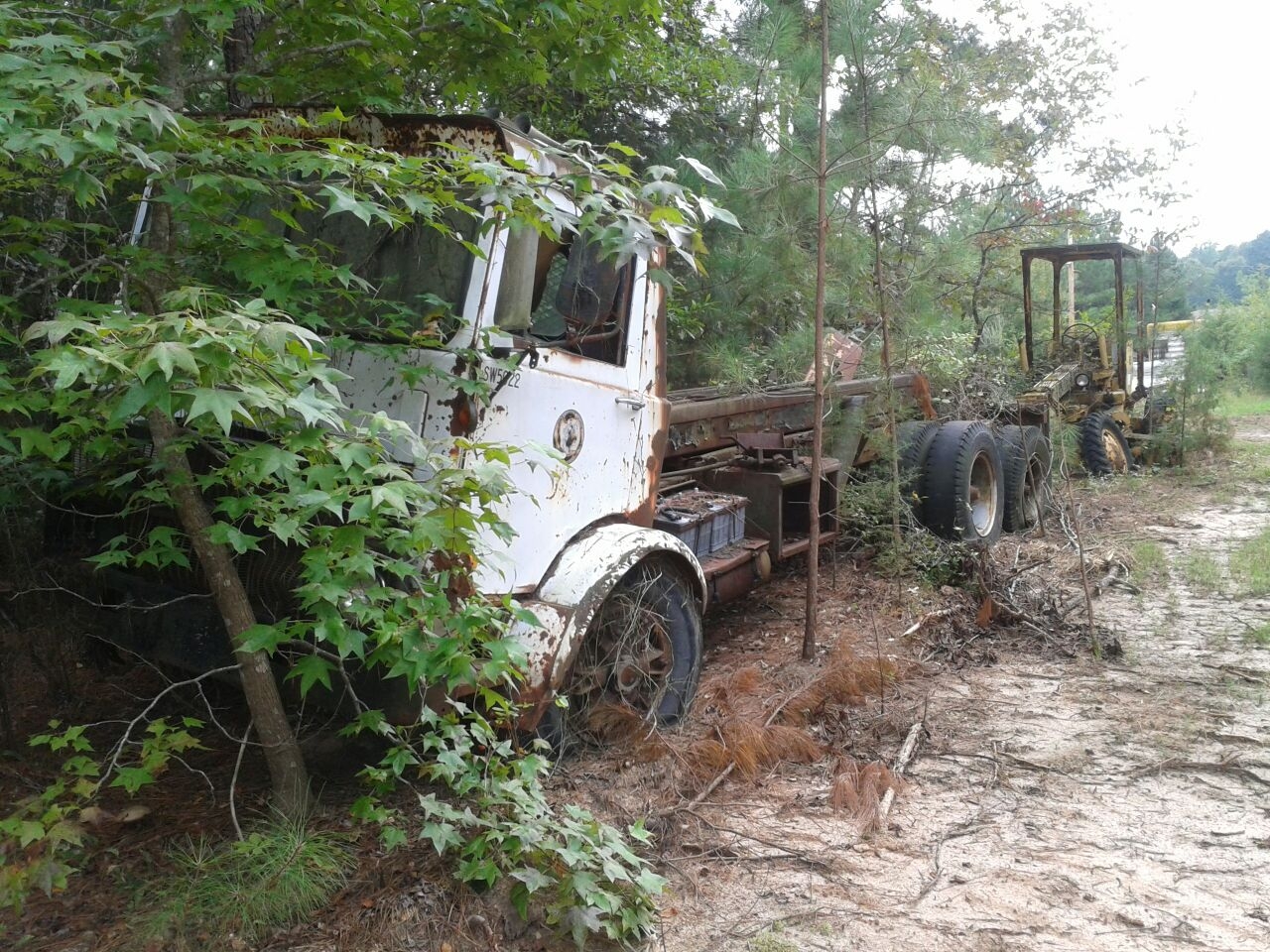

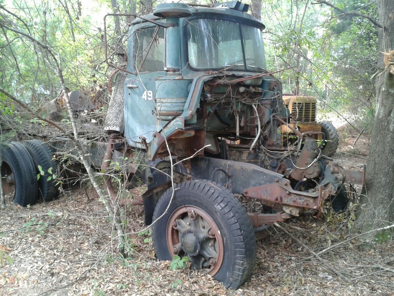

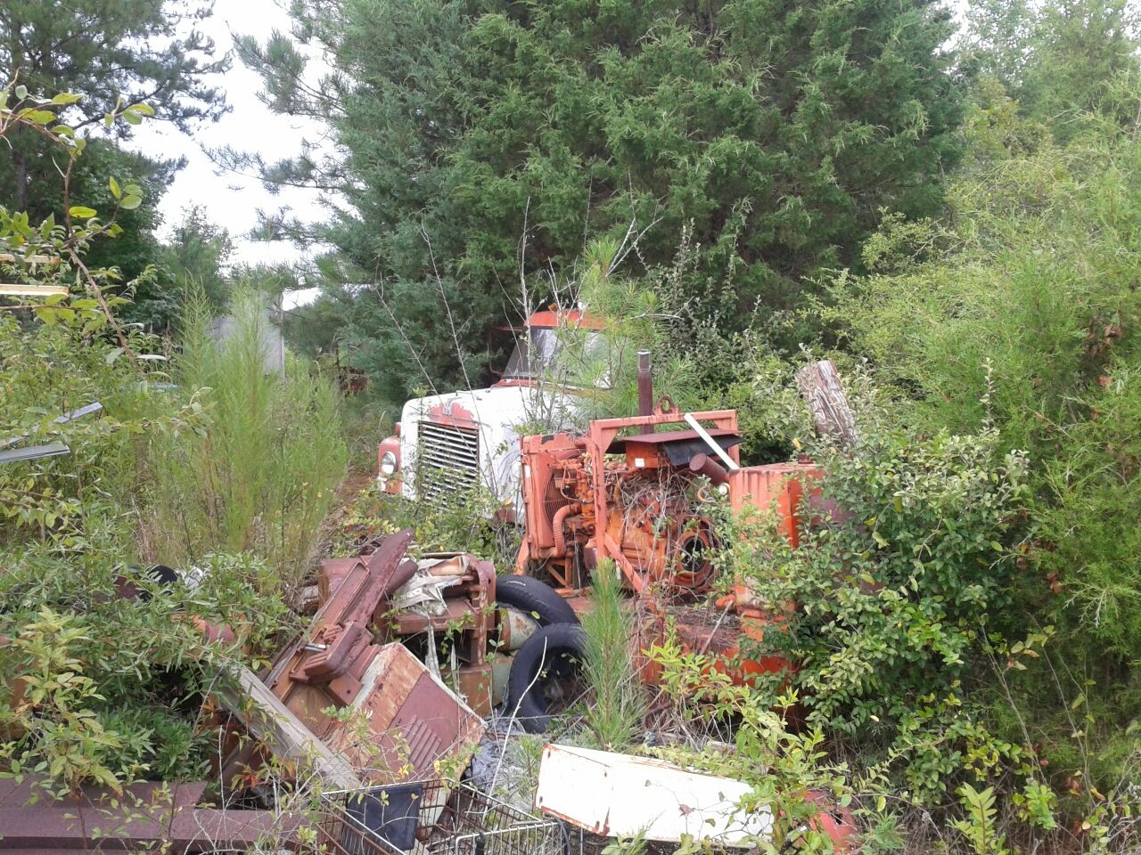

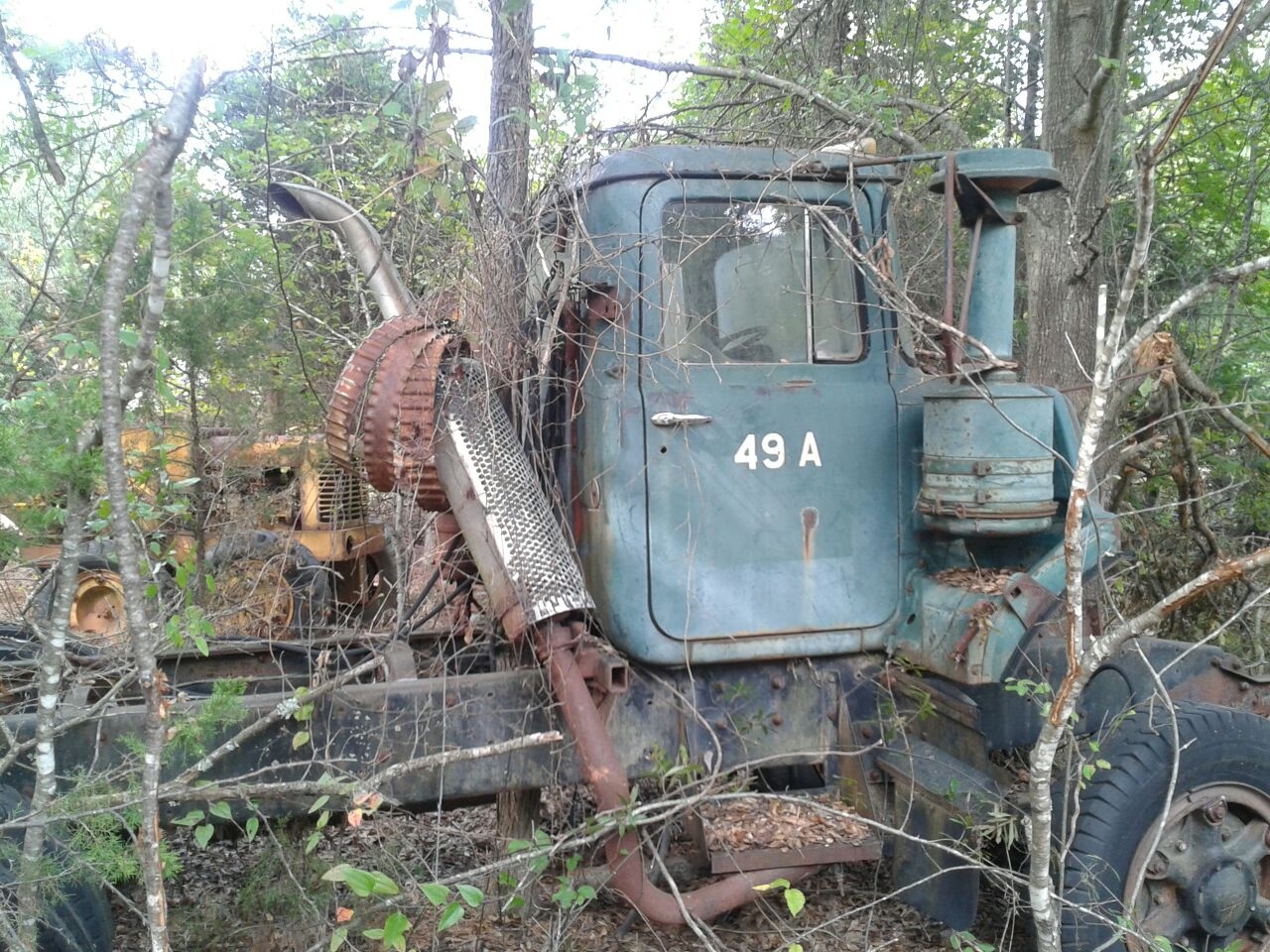

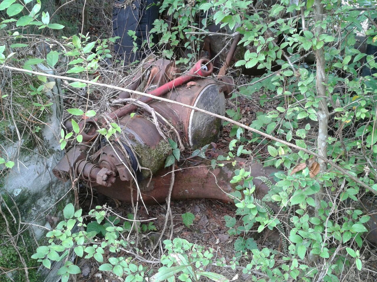

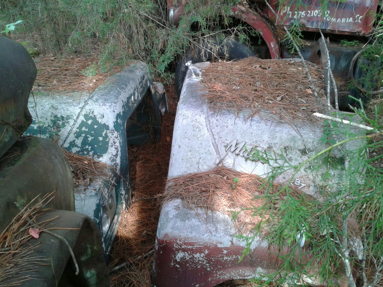

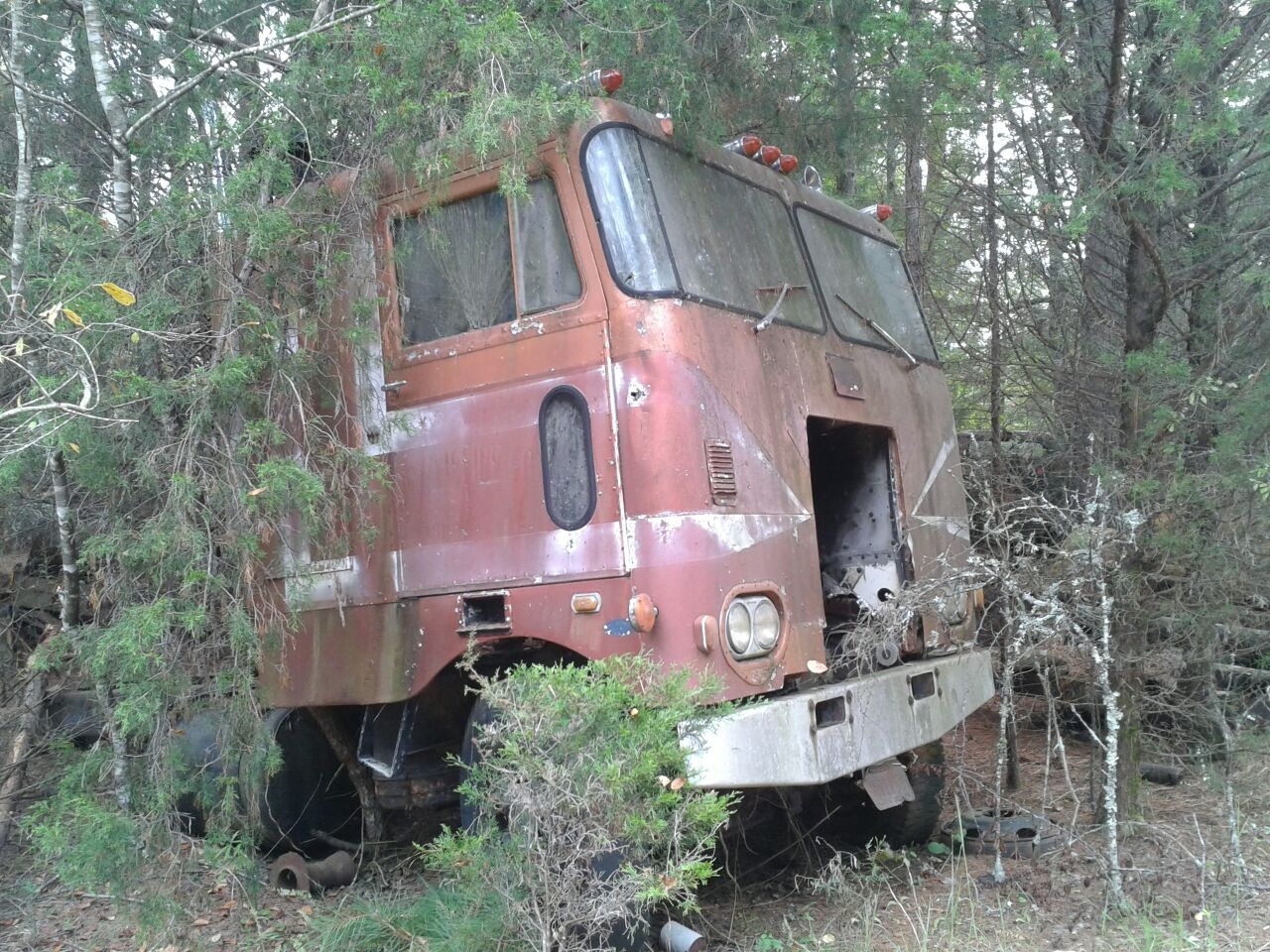

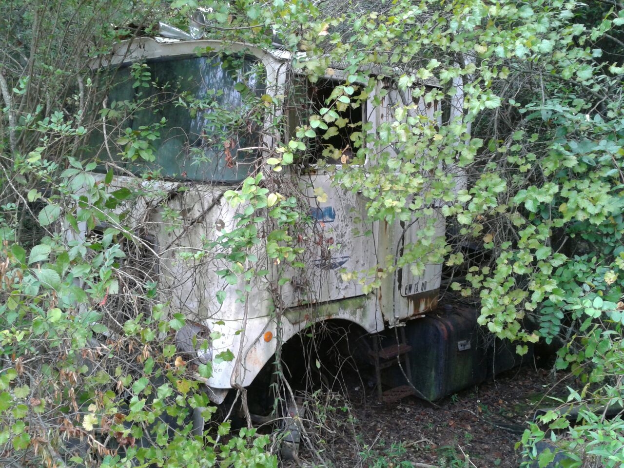

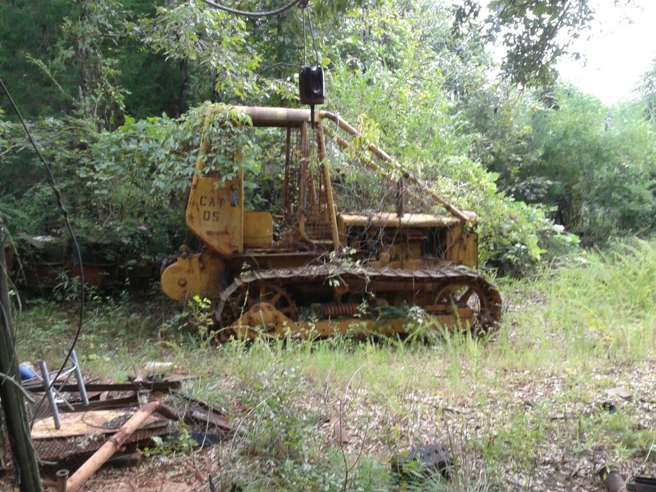

I had more time today to play with the computer and post these pics right. Hope ya'll can enjoy them a little better. The DM does have the pot belly chassis, my pic just doesn't show it very well. There are several sets of Mack boggies sitting around. Hope ya'll can open the pic of the 78 R model. It was the first thing I noticed when I pulled in the guys yard. He asked me if that truck looked familiar. It was one of my dad's old R's he bought back in the late 80's. It came out of the Texas oil fields. Dad sold it to a local logger and this fellow bought it from him. This is for Brocky. The man's name is Dale Lawson but I don't have any contact info on him. All I know is he lives in Pauline, SC. Mr. Lawson said he still has the U model with the 865 V8 over at another farm. He said his dream was to restore the DM one day.
Hope this works. I'm not very computer literate. I delivered a load just south of Spartanburg SC today and found some cool old stuff sitting in the woods. Check out the DM with the tree growing up between the frame rails. It has a set of 52 or 54 rears. Found the hood sitting down the way with another hood the owner says is for a U model. Check out the V8 emblem on it. The GMC Astro has a 318. I think the White is a 8000 or 9000. The hood emblem just said White Diesel. The F model is a single axle. The roll off cabover is a Mack but I'm not sure of the model, but it has 44 rears. I'm not sure of the model on the IH truck or the Dodge. lawson equip.zip
