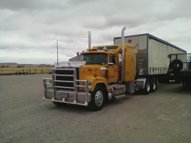

  5. I took some chains just in case but luckily I didn't have to use them. There was still a lot of snow on top of Togwotee Pass and over on the Sisters.

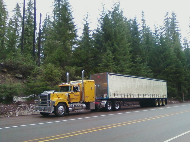

  7. Just got back from Coos Bay, OR. I've been to Canada and the west coast now, have I achieved Supertrucker status yet?

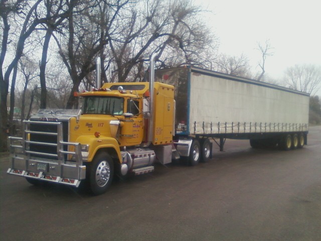

  18. Well I'm not a physics major but does it not stand to reason that cabovers are more dangerous than conventionals because there is nothing in front of you to absorb energy in a crash.

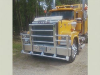

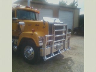

  19. I sharp paint job makes a truck, but the graphics are not my thing. I agree about the visor. The fiberglass oem visor makes those trucks just like they make an R model cab. I started to put one of those R model stainless steel visors on my Superliner years ago, but got talked out of it and I'm sure glad I did! I bought a cowcatcher instead, trying to protect my investment. I would not give those Trick My Truck guys free rien over my truck either. My truck would be built to my spec, it's got to work for me. I've seen several of those trucks in the last year or two and all were falling apart and beat all to pieces.

  24. I want a set of snorkles to replace my bonnets on top of my external breathers on my Superliner. I put the cowcatcher bumper on back in the summer and I think the snorkles would really look go. It will give it the Austrailian look. And of course they need to be chrome or stainless. If anyone can help with some part numbers I would greatly appreciate it.
